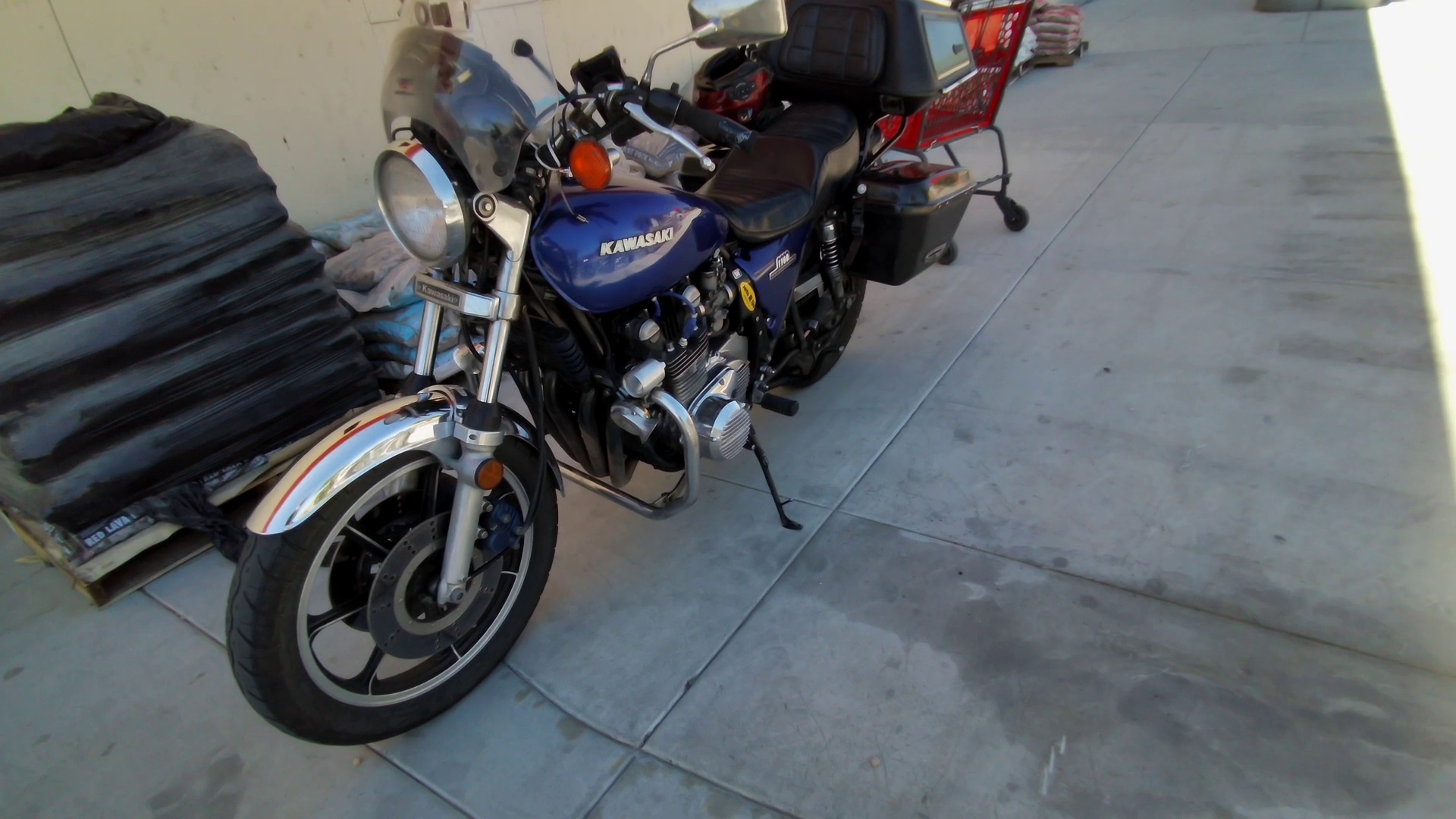

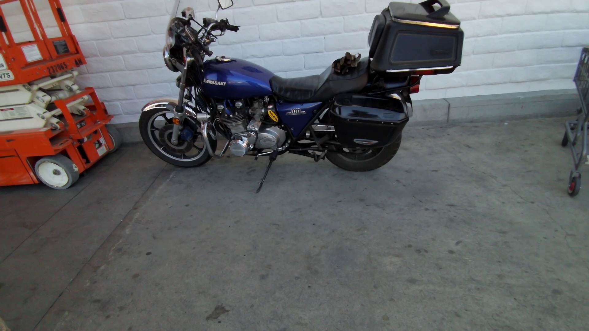

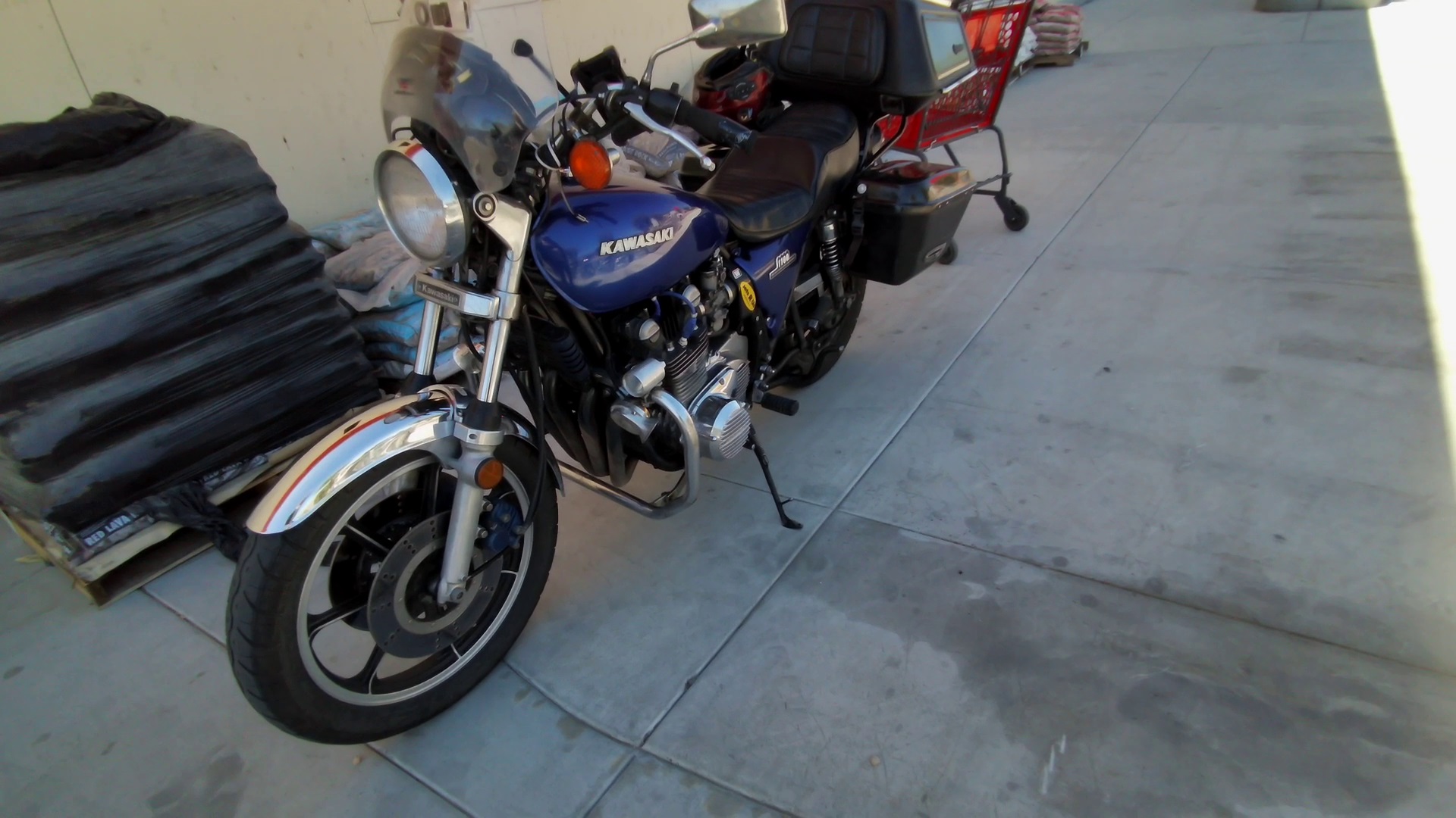

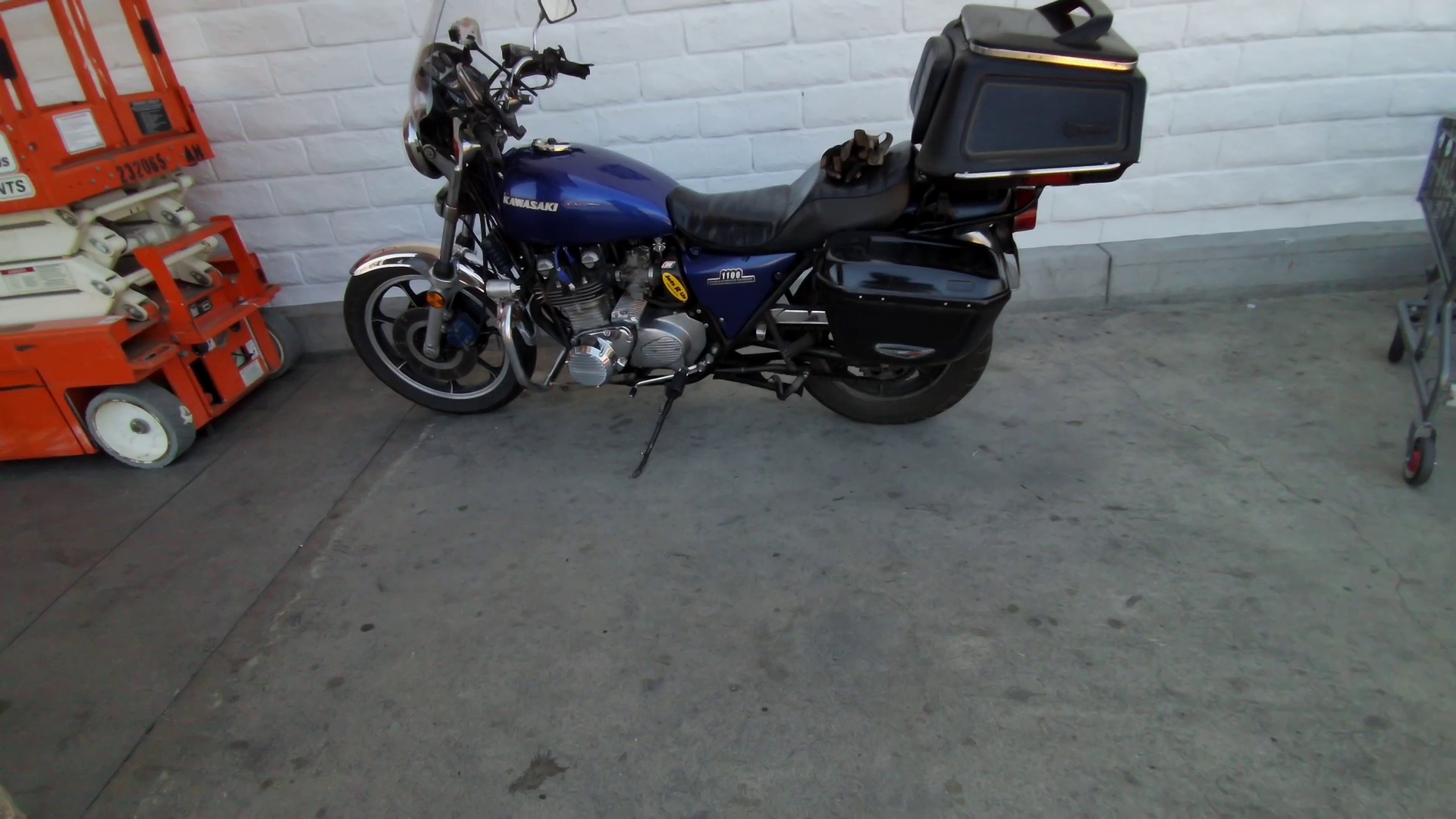

This is my Z1 after the wreck June 13 1986 on a Friday it has a salvage title So I might as well get all the goodies I wanted when it was new. Sure it's a Franken bike but it's mine and I wouldn't have it any other way.
When asked if I would sell it the look on my face shuts them down PRONTO.
In my retirement I'm "RIDING THE PISS OUT OF IT."
