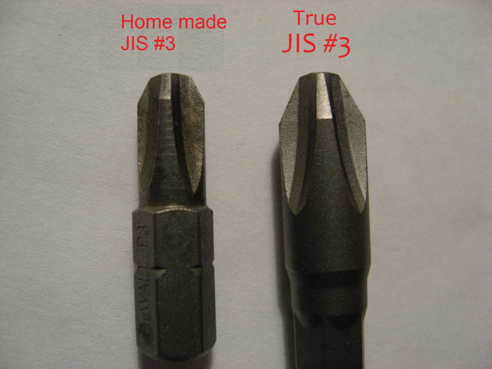

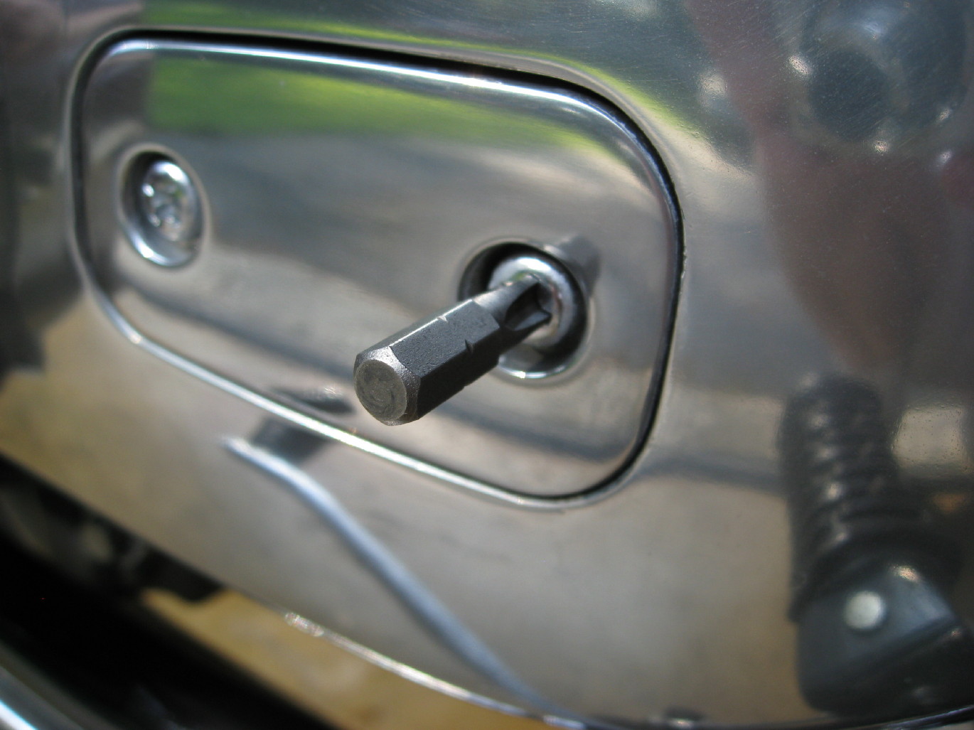

The screws on Kawasaki motorcycles that look like Phillips screws are not Phillips screws. They are Japanese Industrial Standard (JIS) screws.
Phillips screws are intentionally designed so the screwdriver bit will cam out as the screws are made tight. This was done to aid the manufacturing process. Using a Phillips screwdriver on a JIS screw is a problem because the JIS screw profile is different than the Phillips screw profile (see first picture below).
JIS screws have a different profile than Phillips screws, and this difference is intended to prevent the JIS screwdriver from camming out. This different profile was built into the design of the screw AND the JIS screwdriver. Using a Phillips screwdriver on a JIS screw is a problem because true Phillips screwdrivers will deform a JIS screw as it is tightened of loosened because they do not properly fit the screw.
Unfortunately, the folks in Japan have redesigned the screws used in their industry. The new screws are not the Phillips design and are not the original JIS design used on the KZ, but they are still called JIS. Unlike the original JIS screws used on our KZ bikes these new “JIS” screws accommodate pointed screwdriver tips similar to Phillips. The first picture below shows the Phillips, the original JIS, and the new JIS screwdriver tips.
Using a Phillips or a new JIS screwdriver on a KZ screw is a problem because neither the Phillips nor the new “so-called” JIS screwdrivers work well on the old style JIS screws. The good news is that Phillips screwdriver tips can be easily made into the old style JIS screwdriver tips by grinding off the pointed tip of the screwdriver (see second picture below). With a little patience, the modified Phillips screwdriver tip can be made to fit the KZ JIS screw extremely well (see third picture below).

Good info 650ed. I would also like to add that not all Philips tips are the same. I find some that fit JIS screws quite nicely, and others that cam out even after grinding off the tip. I have one favorite philips that works better than my JES screw driver. Philips tips do vary between manufactures.

Apparently there waas once a Japanese governing body that determined whether tool manufacturers could call their screwdrivers JIS. That governing body no longer exists, which is why Vessel (for one) no longer refers to their screwdrivers as JIS. From what I've read, a lot of the manufacturers that call their stuff JIS are really making regular, often low quality, phillips screwdrivers.
With all that said, I love my Vessel screwdrivers and won't touch my bikes with any of my "regular" phillips screwdrivers.

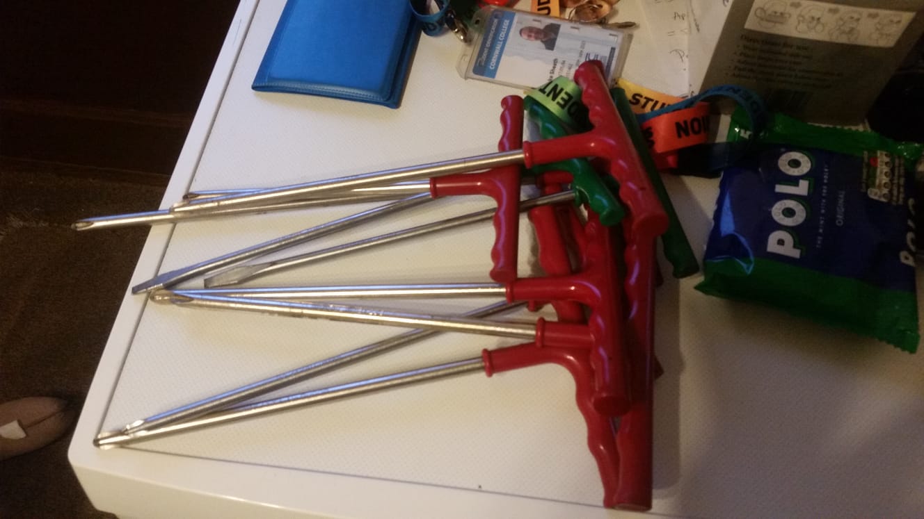

I have a nice collection of drivers for my 1000st, the Vessel T handles are very handy, made well and strong, I have a few toolkit drivers, a few Kamasa Jis drivers and this Laser set that I've found a stock image of do the job nicely too!

I love my T handles, they're super tough, no handles have any scratches or nicks and they provide a good amount of torque

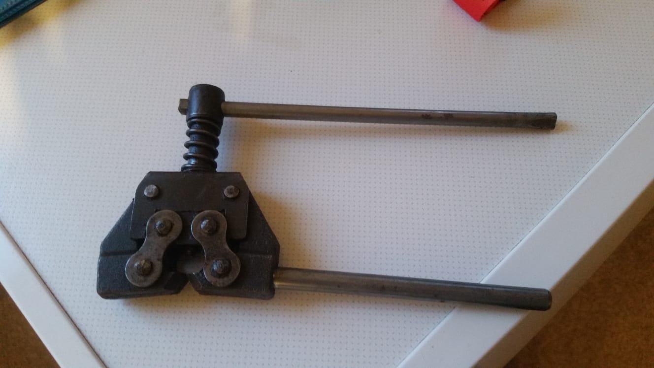

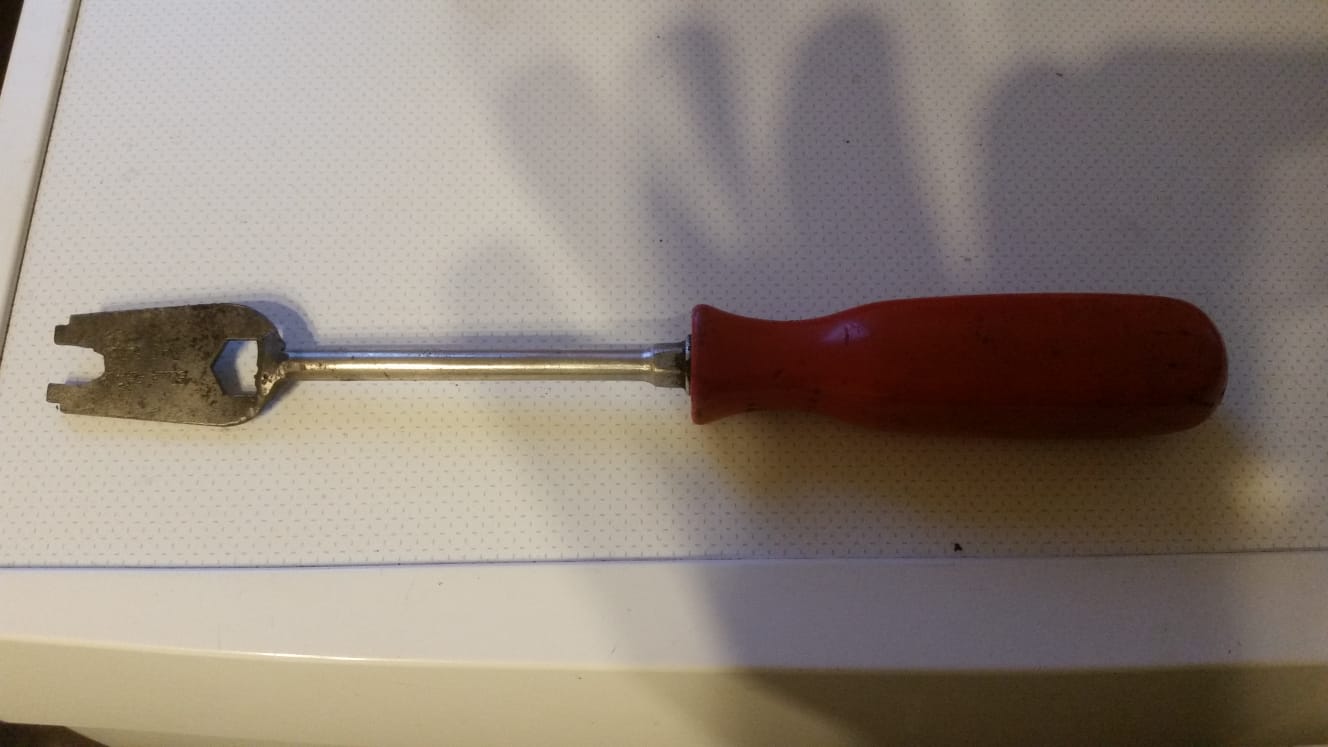

While we're on the subject of tools, here's two that I got in a big lot and I have no idea what they're for! The screwdriver handle one seems to be home made! Can you guys shed any light?
