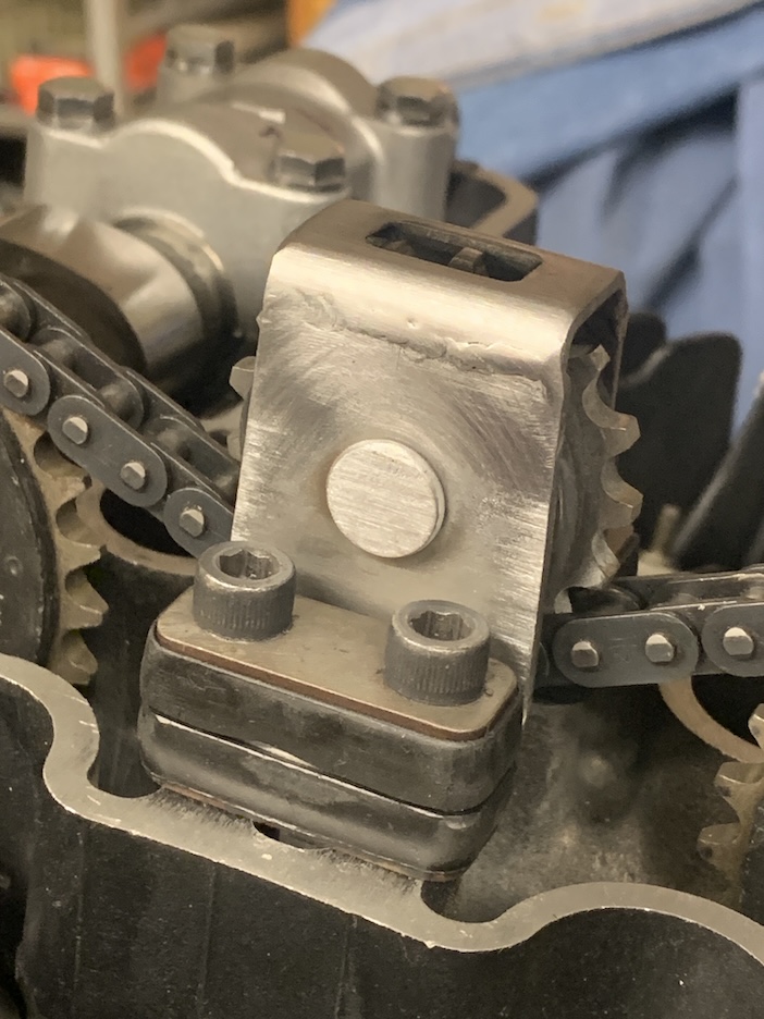

I was able to get back on this today after I cut my grass, stinking hot and humid here!
I had to remove the crank case catch can that was strapped under the frame back bone tube. This gave me room to push the cam cover up.
This is the extent that the cam cover could lift up, locked in there by the very top of the center idler bracket.
No amount of wiggling, jiggling, or bashing is going to get it up and over that bracket. My only recourse was to remove the idler so I put the crank on the "T" mark 1&4 just to be on the safe side before I removed it. As long as the crank does not move I should be OK.
I suspended the cam cover with a small bungee cord and proceeded to remove the top idler.
I removed the bolt and cushion assembly one side at a time being careful not to drop anything into the oil pan.
Once removed the cam cover came out to the side as normal, then I also removed the gasket so I can work on the cam end plugs. So now I have a procedure to get that cover off, its not that much extra work to take the center idler on and off. It would be easier if I fabricated billet shim blocks for the idler bracket. It not a emergency at this point and probably something I can do over the Winter.
It was too hot to continue so I packed it in for another day.

Since the center idler is off I am going to measure up the spacer blocks and get myself a drawing done of those parts to machine so I can replace the stock units with some APE inspired blocks.

I'd be interested in a set of those solid blocks when you get to them next winter. I re used the old rubber ones and steel washer plates when I upgraded to the liska idler pulleys last winter. If you want to make some to sell, let us know what you come up with for a price per set. I'm sure there are several others here with Z1's or KZ1000's who would also be interested...

Is there any reason why you can't replace the lower damper with a piece cut from some 2mm nitrile sheet (or something similar) then shorten the sleeves and bolts accordingly ? I suspect you may need to add 1 to the pin count on the chain between the sprockets then dial in with your slotted gears (I suspect it would not be feasible without slotted sprockets)

25 Jul 2025 05:39 - 25 Jul 2025 05:51It looks like you did a "chop top" on it to lower it by about 1/8", I could lower mine by making the lower shim blocks thinner than the top blocks.
What was your issue that you had to do that mod?
