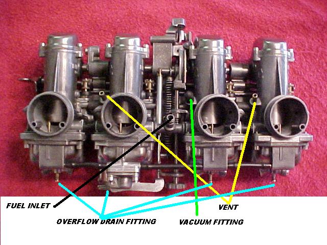

As to vents and vacuum ports on the vm 26 or 28 they work like this.
Keep in mind that some sets so not have the accel pump and some have 2 fuel inlets instead of one. Some do not have the vacuum port on #3
