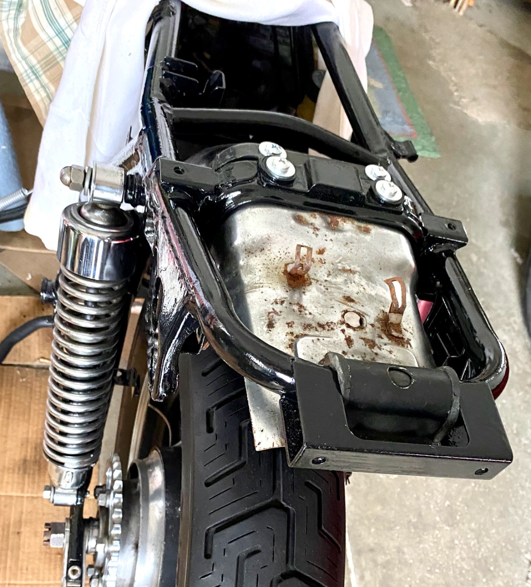

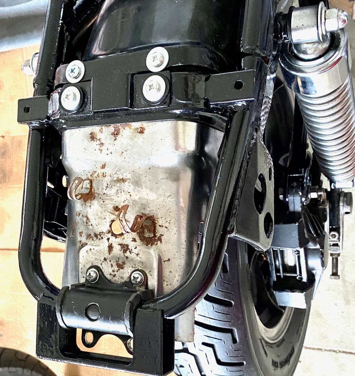

Butchery and shear madness from teenagers. I cut my teeth on British sports cars from the 1960s, and not one improved in my young hands!!
The 77KZ1000 did have a good rear fender and tail light, but the previous owner need it for another project, so I'm left with the "bobbed" beauty.
I had a used fender and tail light lined up in Toronto, 600 km round trip, but the seller vanished.
I'll look for a "For Sale" section in KZRiders

27 Sep 2023 15:28
z1parts.net/z1-900-kz900-kz1000-rear-fender-35022-072/
www.diablocycle.com/Kawasaki-Z1-KZ900-an...r-Fender-Chrome.html

I bought a nice used Z1 (or maybe KZ900) rear fender on eebay last spring, $40US plus about $10 for shipping. They come up pretty regularly, some nicer than others for reasonable money. Seen a few tail light brackets too, but not too often.

Z1 parts has a lifetime guarantee and they have a clearance item
z1parts.net/z1-900-kz900-kz1000-rear-fender-clearance/
z1parts.net/kawasaki-1/
