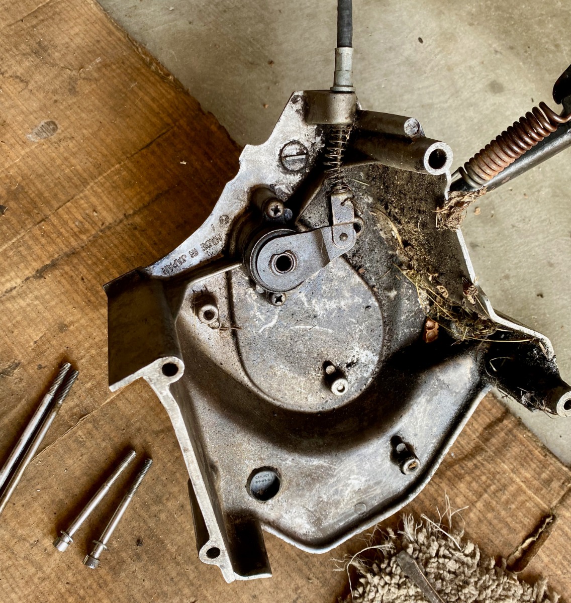

Next I'll do a little work with the output sprocket and clutch throwout mechanism. I think the inner cable is rusted to the outer cable, as the lever has no travel and hits a hard stop.

After 40+ years of a stiff clutch I switched to a late model clutch setup. No more binding worm drive plastic POS. I also broke down and bought a needle bearing pusher for inside the clutch basket. The bike now has the pull of a 350 and no more clutch drag.
I suspect that's what was causing the 2nd gear shift dogs wearing out.
All good now.

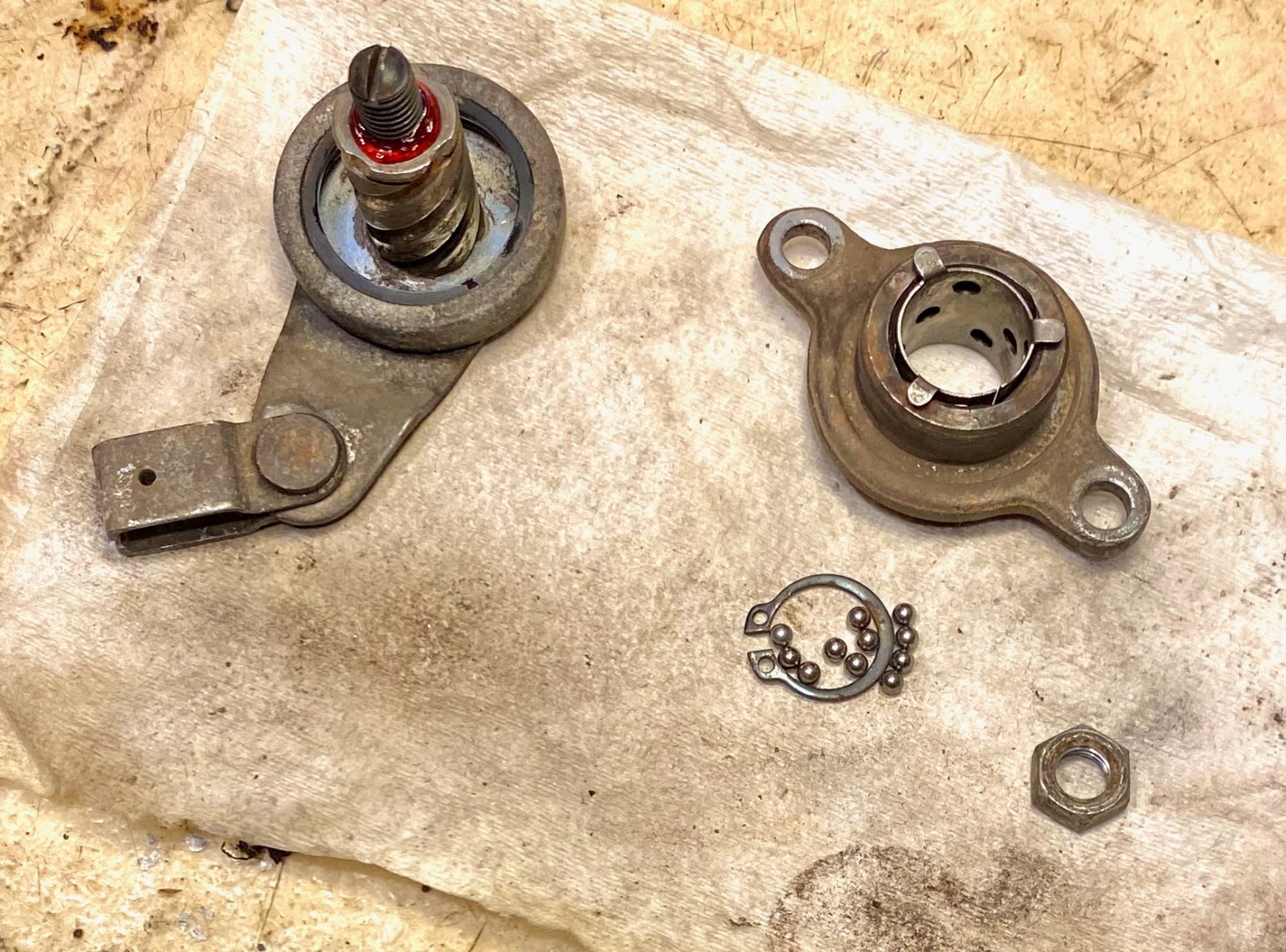

It looks like I do have the updated clutch pressure plate lift mechanism with the helical ramp ball bearings. Disassembled it, cleaned the bits, and reassembled it with some nice smooth grease. Can't say I've ever serviced or seen a helical liner ball bearing assembly before.

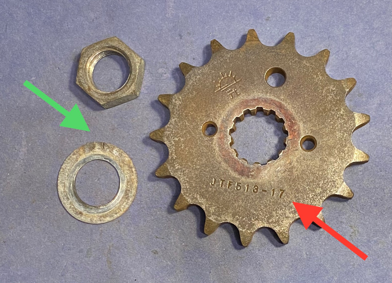

Cleaned up the front sprocket a bit, and it's a 17T 530 for sure, and with the 41T rear is a bit higher ratio than I'd like. So maybe a 37 or 38T rear. The washer looks like it has a tab to bend over, but I cannot tell where this tab would locate. See green arrow.

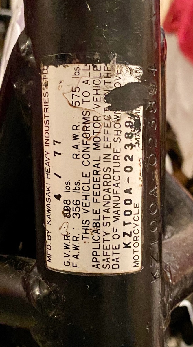

And the headstock VIN sticker is as clean as it'll get. Some cable friction has damaged it.

The tab on the washer is supposed to be bent at 90° and the correct sprocket has a small hole close to the center splines that it fits into. That sprocket looks like a Honda part with the two threaded holes on each side of the splined hole.

Maybe I'll make a soft steel washer with bolt holes for those "Honda holes", then fold up the washer against at least one of the nut's flats.
In addition to some Loctite.

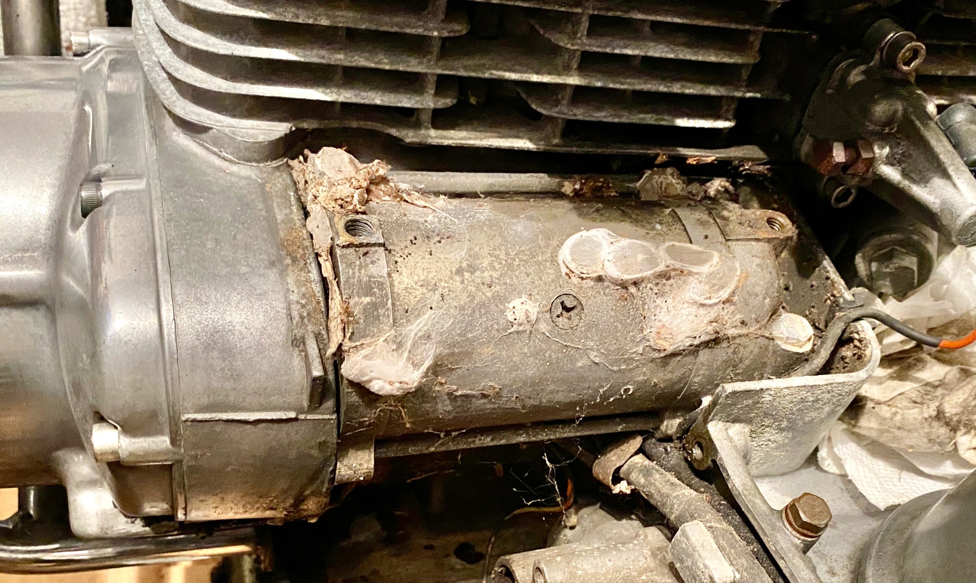

Perhaps that starter motor would benefit from removal and service. I'll have to vacuum out the extensive spider colony to have a better look.

South wind brought some warmth to the unheaterd garage, so I did a little more dismantling.
Needed to remove the rear mounted cam chain tensioner to get the starter motor out.
And I pulled the points plate and mechanical ignition advance.
That'll give me some indoor work for several days.
Please do comment on what you see in the pictures, along with any type of advice or updates.
Thanks.

Hi, Disassemble your starter motor, clean everything and check the carbon brushes!

18 Jan 2023 07:52Good preventive maintenance advice. Please mark the aluminum end caps and the steel body to assure correct “clocking” upon assembly. Also the armature shaft has very thin shims, take care to note placement, again to assure correct assembly.Hi, Disassemble your starter motor, clean everything and check the carbon brushes!
