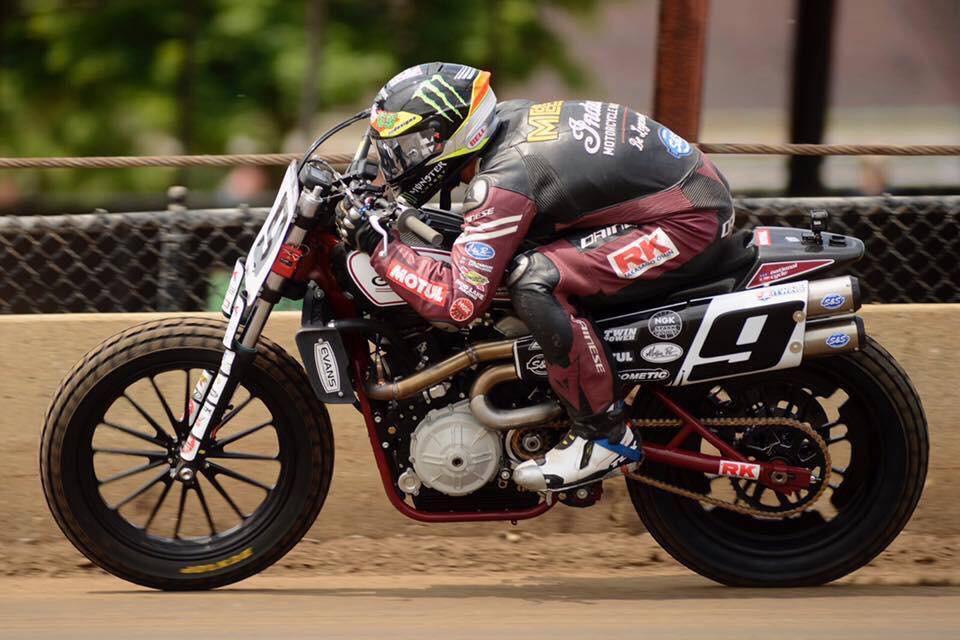

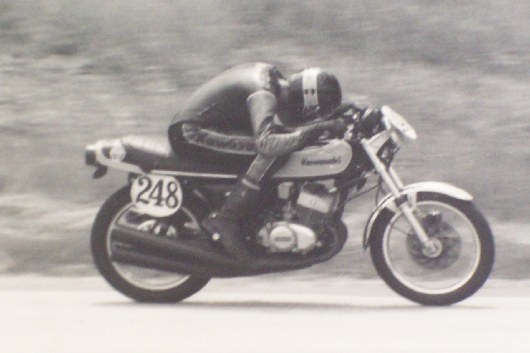

You might pick up a few MPH if you learn to tuck in like the flat track racers do. Get your body as close to the fuel tank as you can and place your left hand on the low part of the handlebar or better yet, grab on to the fork tube!!!! Tucking in and grabbing the fork tube on my 400 sure helped my top speed by a few MPH!!!!!

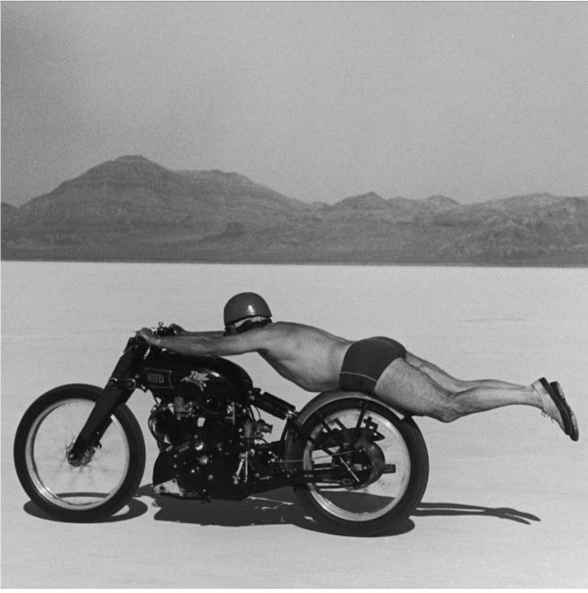

That pic of Rollie Free suggests some good advice. Loose weight, both bike and rider. Look carefully at the rules to see what you can race without and what you can replace with lighter weight components. Can you skeletonize parts without sacrificing safety?
Streamlining within the rules will help, though I am not sure a swim cap is the best way to go.
If you can loose a few pounds of body weight, that will be free horsepower.

If I lost any more weight the bike would have to go down the track without a rider.TexasKZ wrote:
