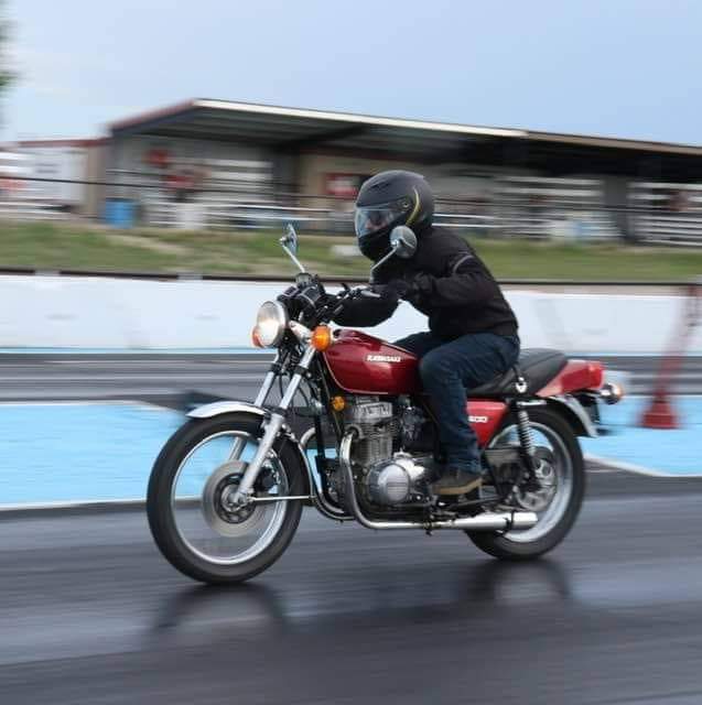

I raced my 1978 KZ400-B1 all season and was running consistent 16.8, bone stock. Managed a third place finish for the season. Even though it's my slowest bike, my friends and I now refer to the 400 as "the race bike."
Although I feel like making the other guy wait at the tree for 7 seconds has been part of my success, I'm looking for some recommendations to make this thing run a bit quicker down the strip, without changing the looks of the bike too much. Low 16s would be incredible. One idea I've seen is adding a toggle switch to turn off the generator when racing.

The dished seat and lower bars would help your torso act less like a sail as you go down the strip. :-) You might consider a small bikini fairing to clean up the aero a little.
You mentioned rearsets. In the action shot you posted, what is supporting your left foot? It appears to be too high for the stock pilot peg and not far enough back to be on the passenger peg.
The 400 likes to spin, so let it: VM30s would be a good start, and you can give them large-ish main jets for strip use. Not sure what sort of exhaust is on there now - appears to be stock headers and aftermarket mufflers - but what goes in must come out so you'll need to pay attention to that too.
Years ago when I took my (non-stock) Super Beetle to the strip, I took the end cap off the SuperTrapp muffler. In theory I could have put it back on... Basically I'm suggesting mufflers that have a removable baffle or something you can take out while at the strip and then put back in to ride home.
Also think about gearing. Not sure what your sprocket tooth counts are, but going a tooth smaller on the front and/or 2-3 teeth larger on the rear will help it pull harder but at the expense of higher highway RPM.

To be honest tighter fitting clothes would probably reduce your times more than the mods you have mentioned by reducing drag
Agree with Wookie58 ^^^^^ .    Also, lower & narrower handlebars would help.  Not sure if a dished seat would be of value, as it might prevent you from sliding back to achieve a more aerodynamic position.  You need to get your torso down low, as best as possible, elbows tucked in.  Do the rules allow you to remove the rearview mirrors?  Anything to lower your drag coefficient will help.
Also, what gear are you in when crossing the finish line?  For lowest E.T. you want to be revved out in your highest gear on the top end.  And, make sure that you add enough teeth on the rear sprocket (and/or remove teeth up front) so that you're truly on the top of the powerband.  You don't want to be crossing the line halfway into powerband  and still accelerating.
And, I'll take @urankjj advice on fuel one step further.  If available, try some 100 octane unleaded race gas.  Sounds crazy, I know.  Your motor does NOT need the higher octane rating, for sure.  However, the rate of evaporation is a whole lot faster with the race gas, giving a cooler charge to the motor.  A simple experiment to perform which might give a surprising improvement.
