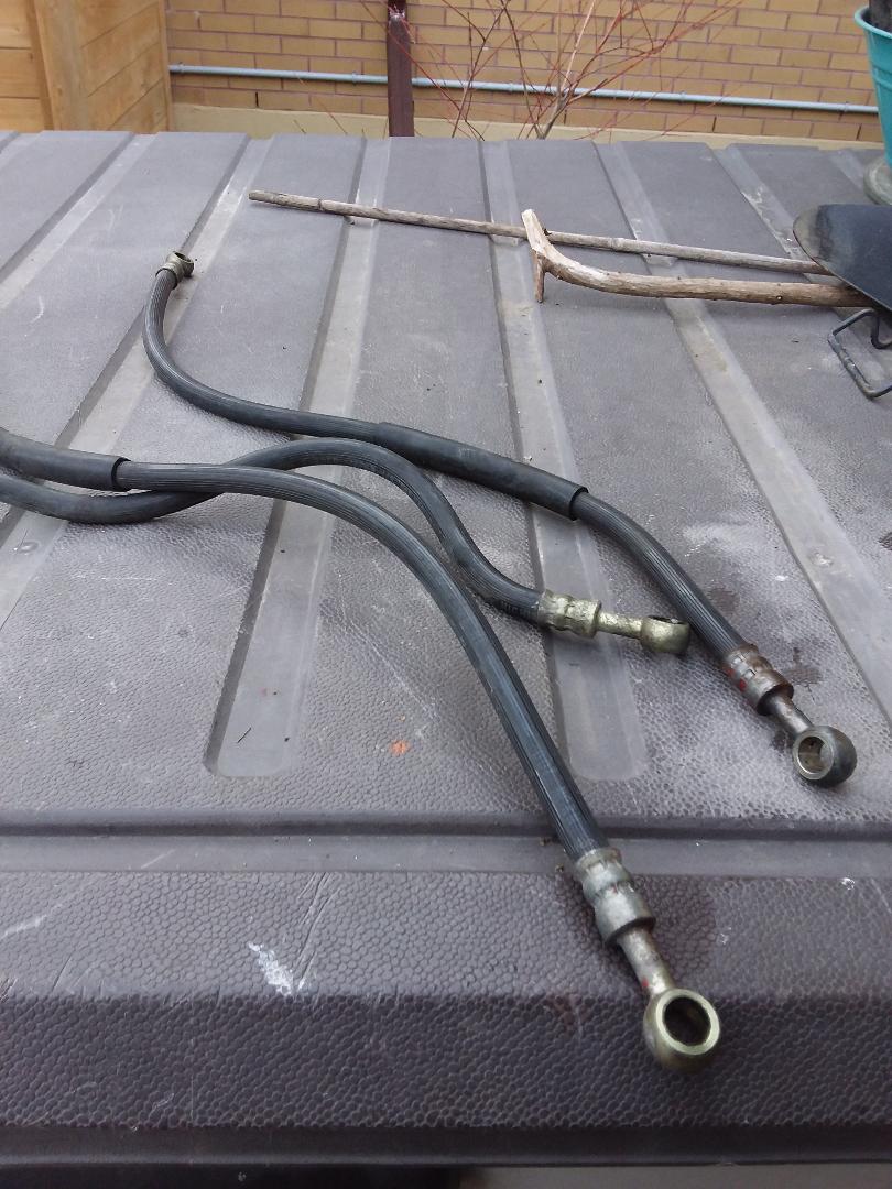

If the old brake lines look like this then chuck em. I'm pretty sure the banjos are crimped and not reusable.

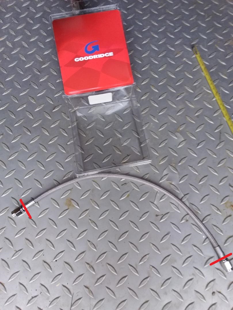

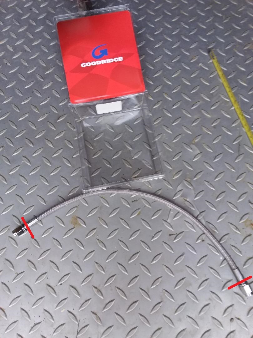

Just a note on measurements. The line in the pic below is a 14 inch line. It is 14inches from red line to red line.
I got those Z! Ent Goodridge SS lines plus banjos plus washers (they are in the Fatbook) from my local shop who I like to support and I cleaned up and reused the old banjo bolts - Fatbook bolts have different - Harley?- threads..
I like those lines. Everything went together very well and braking is much improved.

19 Jan 2024 12:14If the old brake lines look like this then chuck em. I'm pretty sure the banjos are crimped and not reusable.
