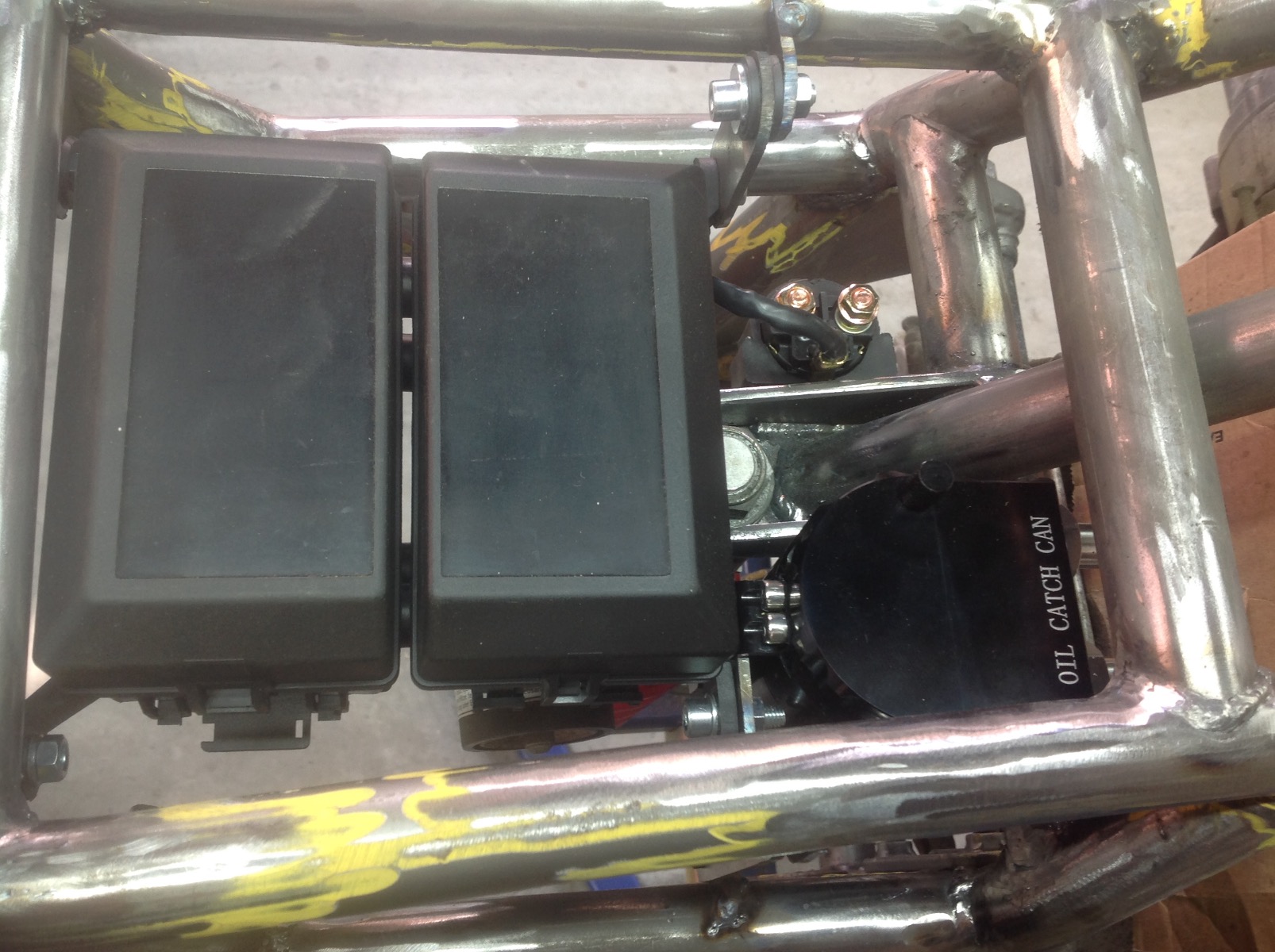

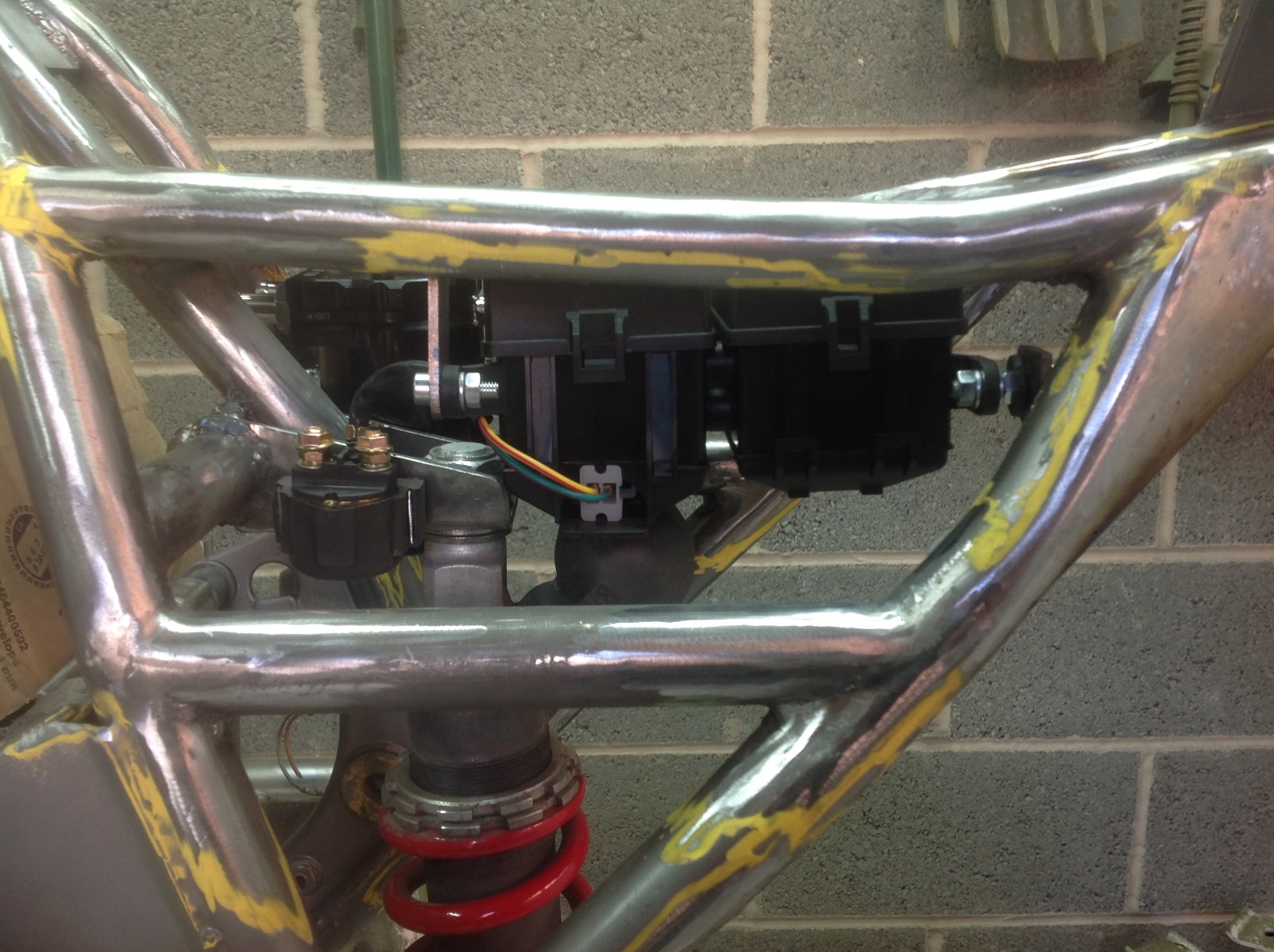

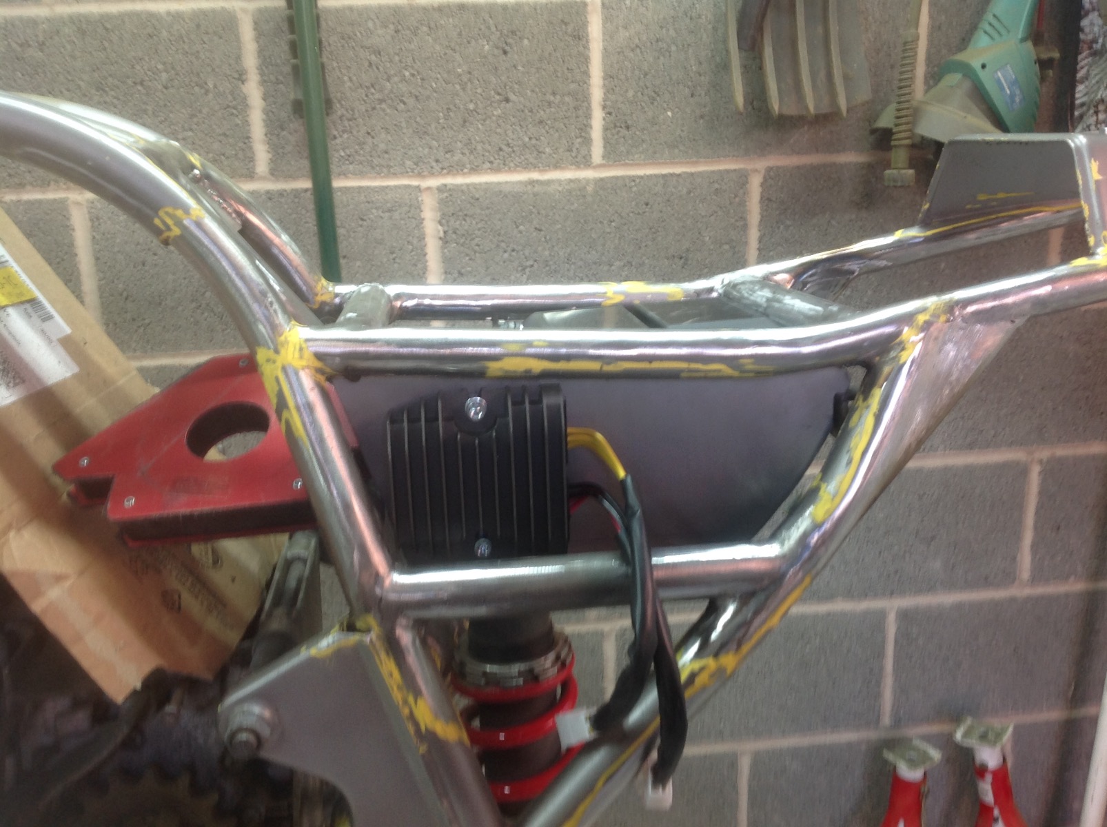

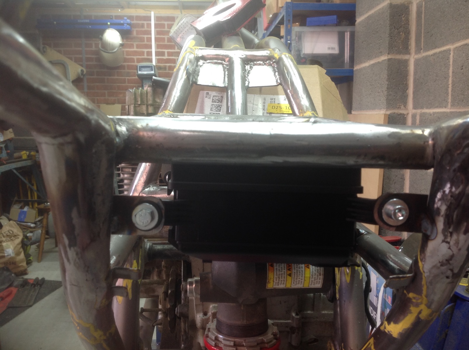

So after last Sunday's arse kicking I have made some headway today (brake job on the wife's car yesterday) it look's like you can indeed fit 10lbs of s¥*t into a 5lb bag. breather catch tank, elec boxes, starter solenoid and RR all mounted. I have used rubber mounts as relays and electronics don't like vibration (it cracks soldered joints) Really happy with progress so far, six weeks in and next spring still looks realistic for completion

10 Jul 2022 13:26
Nice and neat mate! gsxr1100 rear shock?
- Posts: 6744
- Thanks: 4255
Re: And finally, Wookie's 82 begins !
10 Jul 2022 13:53Shock is GSXR1000K, I am using 600K swingarm and linkage so decided to go all "K" as it was made to work together. I went for the 1000 shock as the swingarm is longer so hopefully being on the shorter 600 swingarm with less leverage should help compensate for the additional sprung wheight of the KZNice and neat mate! gsxr1100 rear shock?

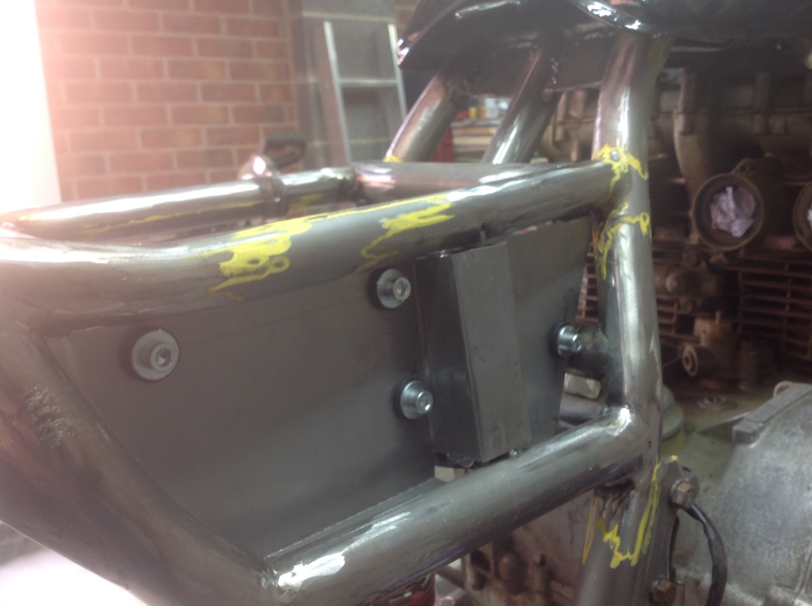

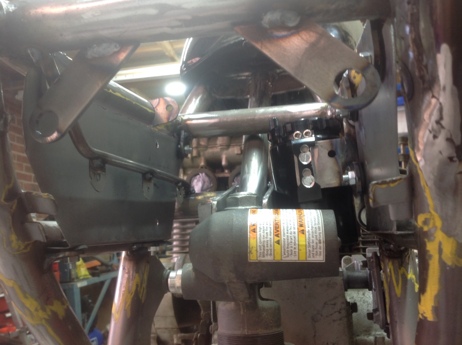

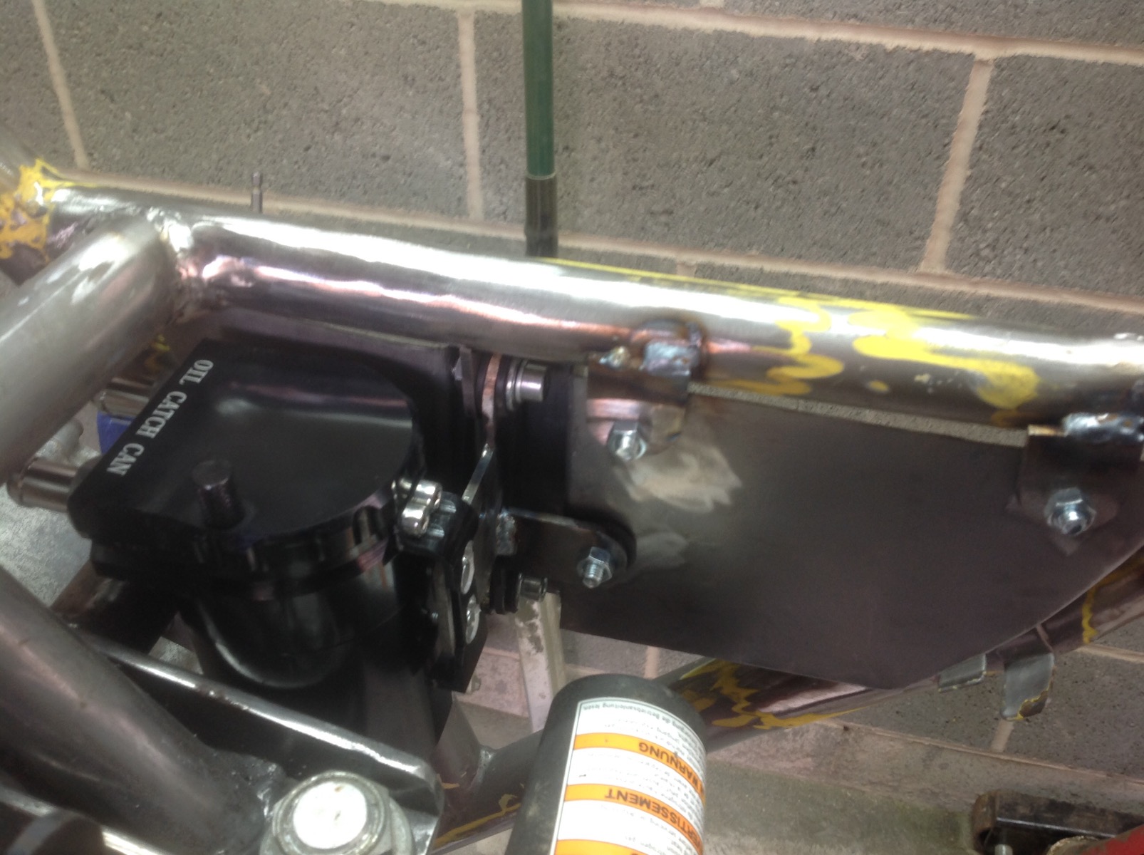

And so here endeth another day of procrastinating, filing, sawing, grinding, drilling and welding
I find this stuff heavy going as I'm no fabricator (I'm too cheap to pay somebody else to do it) but it needs doing and the fun stuff should be just around the corner. Have re done the rear fuse box mounts as I didn't like the first attempt, finished the mounts for the left inner side panel, fitted a rail to carry the wiring harness, made the right inner side panel (this was a PITA as it had to go round the catch tank mount) and finished the mounts for that side too ( don't worry about the welding, I will go over everything and finish weld the tacks when it is stripped down to a bare frame)
