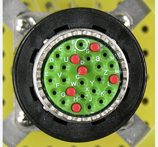

Hey Guy,
On the connectors without a wire installed, do you use a dummy plug to block water entry? That was a requirement in the aerospace industry that I used to work in. Without a plug, water can enter through holes in the rubber sealing grommets inside the connectors.

29 Sep 2025 09:58
In aerospace, plugs like these are used. Sometimes, depending on the connector, the plug is installed from the backside.

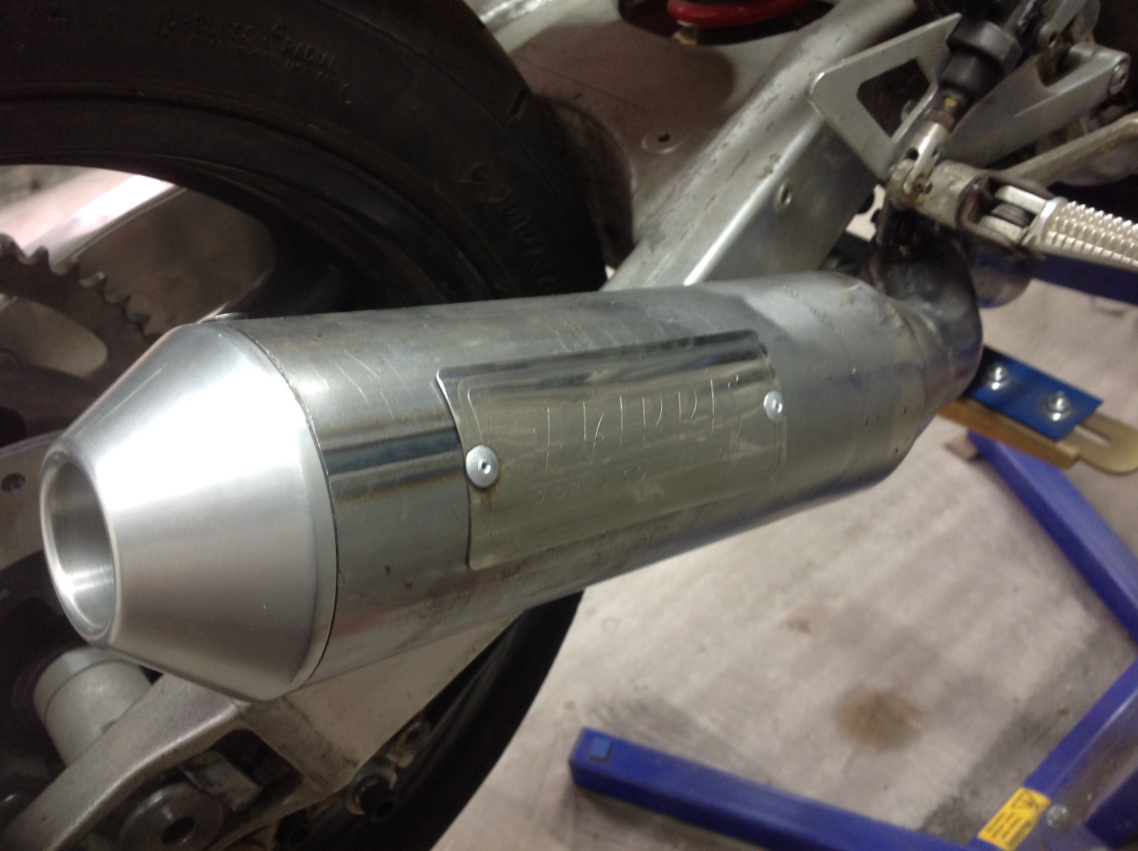

I bet a titanium megaphone system would look mighty fine on this build.
japan.webike.net/products/26227084.html?...tm_campaign=20250929

01 Oct 2025 13:12It's a nice looking piece Texas but the exhaust train has left the station. I will stick with what I have for 1/10th of the priceIf somebody at Harris is bothered by having the company name on that exhaust system, they should be taken out back and slapped severely.
I doubt seriously if the company ever produced something that nice.
