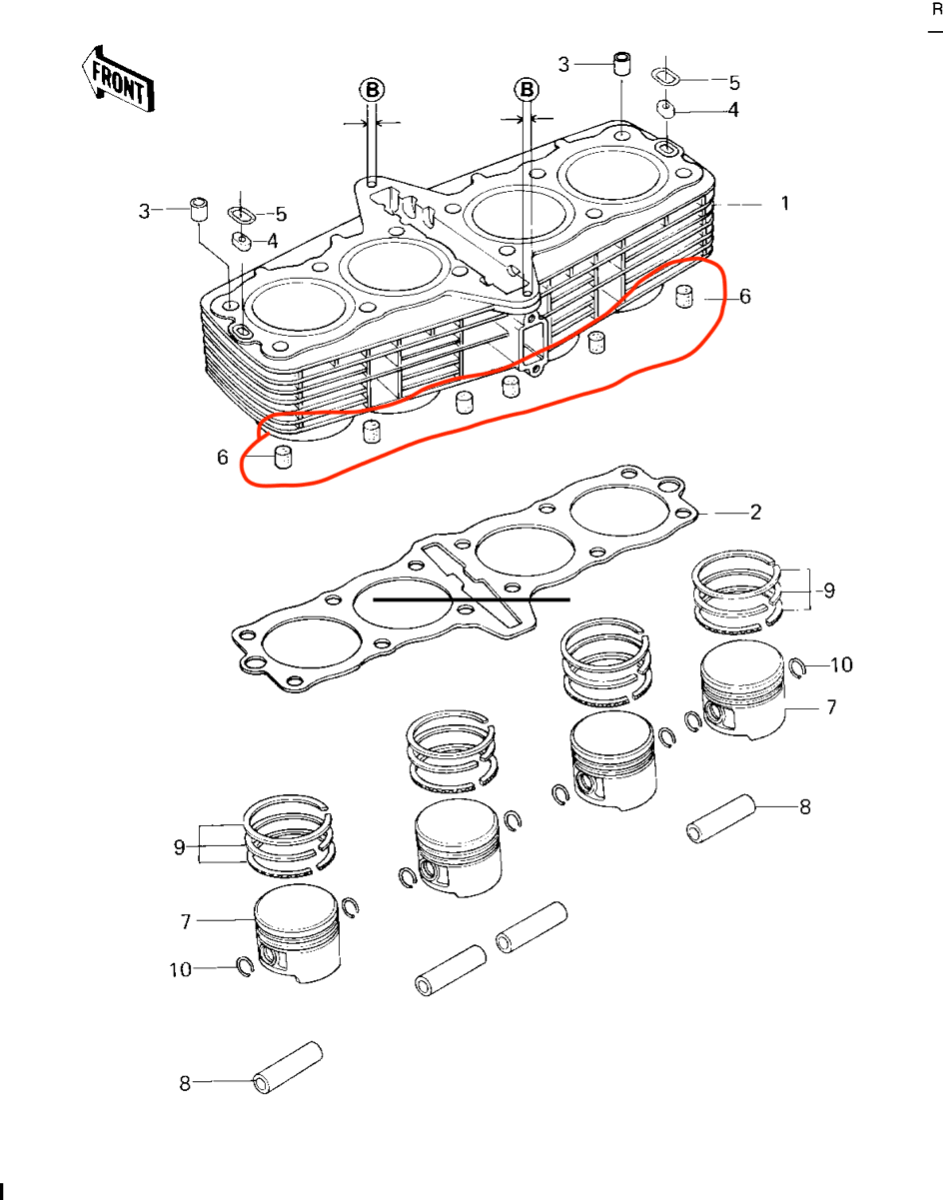

HELP...HELP...so im ordering gaskets and pistons to put her back together, I ran across this part, circled in red. Partzilla called it a dampener plug #92066-1016 and it shows 6 of them? My motor didnt have these on it...is it missing these then??

They are not needed, and of questionable functionality.

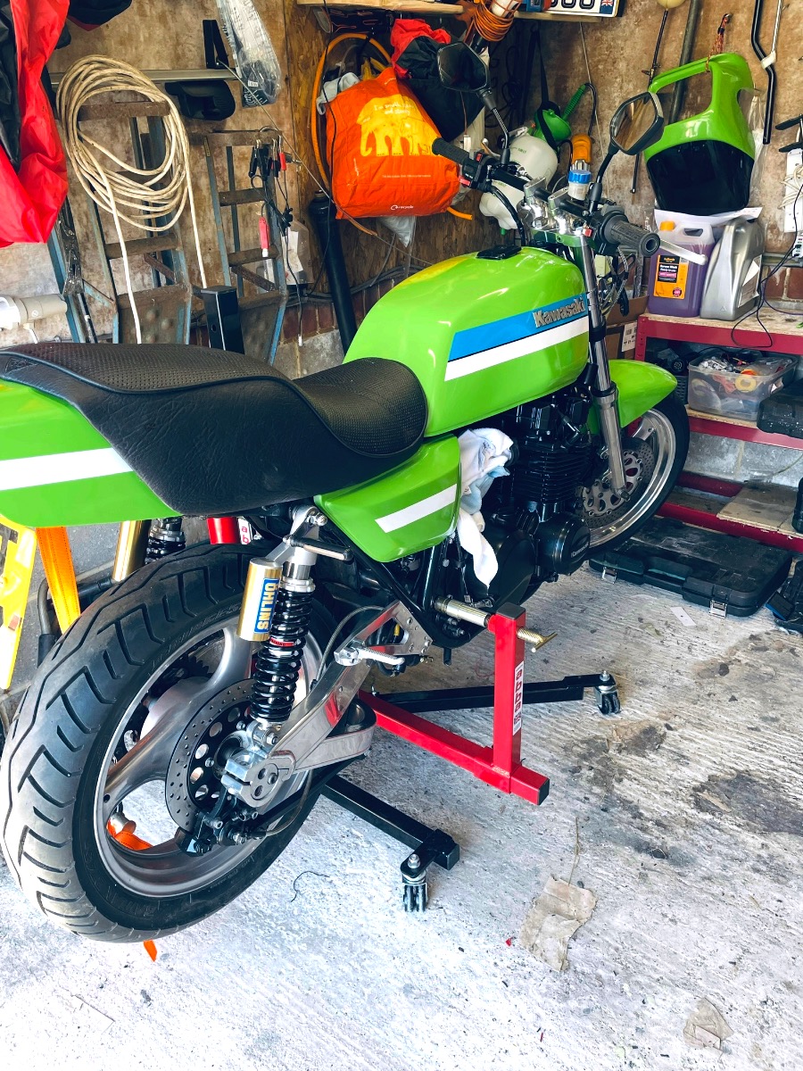

- @Martingg58
- Posts: 3
Re: 1982 GPZ 750 Easy restoration...psshhhhh, right!
11 May 2025 22:50
I got one of these as a project also looks can be deceiving. It has a bandit front and rear end. Carbs were damaged and could not get a replacement set so went fit a bank of mikuni rs flat sides hand to make up a set of spacers to clear the cam chain tensioner. LH foot rest mounting had been damaged and a bodge repair made so sorted thatThe rear sprocket was also bodged to fit so tracked down suitable sprockets and chain..Looking at the electrics they had been so hack about so got the Ferret to rewire it as that’s what he does. Then it was off to Stewart’s to have the cabs set up and a once over. More trouble as no crank case gasket used to reassemble so leaked oil when it was started. The black paint used on the engine looked nice but washed off in areas from the oil leaks as normal rattle can paint looks to have been used. Once the cases were off the main oil seals were seeping so they had to be replaced. Now waiting on the engine to be paint to be stripped off and the engine repaired in a suitable paint.
