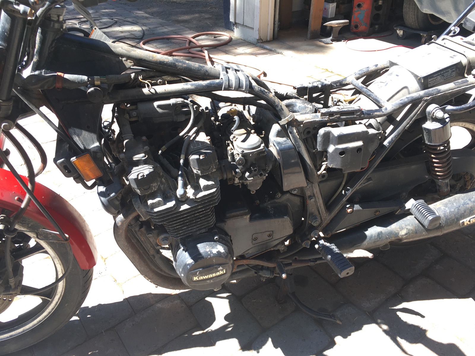

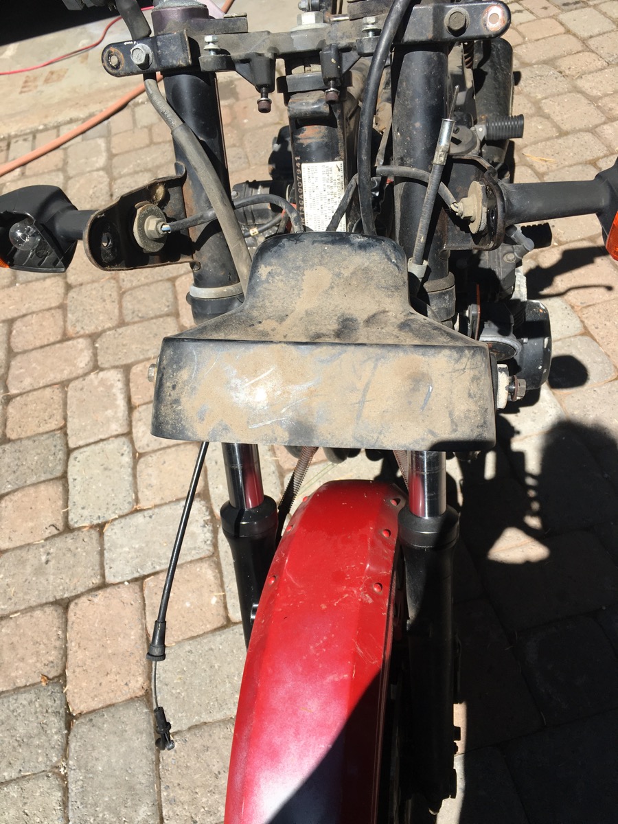

So this is the story of my 750...neglected and put out in the weather! As we all do I was doing some late night shopping, damn marketplace, last year when I ran across the 750. I had been looking for one for several years and was excited. The pictures looked horrid, and the seller was less than amicable to send more pics. I knew at that price I needed to jump on it. During our late night texting, trying to get more info. the seller out of the blue texts, "Come get it tomorrow and $400 its yours!" So I loaded the ramps in the truck and early morning drive over to the valley to nab her! As I approached the house I see two young, early 20's men sitting on the steps with the bike sitting in the driveway. As we chit chatted about the bike I was looking at a complete, including the stock exhaust 1982 GPZ 750, that at some point, the seller didnt know its history, said he got it in a trade and was going to use the motor in a go cart...ughh! So quickly I had the ramps down and the bike loaded for the agreed price. I wasn't about to haggle for the price and it being almost, missing the dash plastic cover...grrr, complete. I smile shake his hand , hand him the money and proceed to tell him how rare this model is since they only were done for one year in this style...and with the history lesson over, I zip back over the hill to stash her away till I can start the restore...which is were we are now. Thought Id document the journey along the way to glee some wisdom from you wizards of the Kawi kingdom!

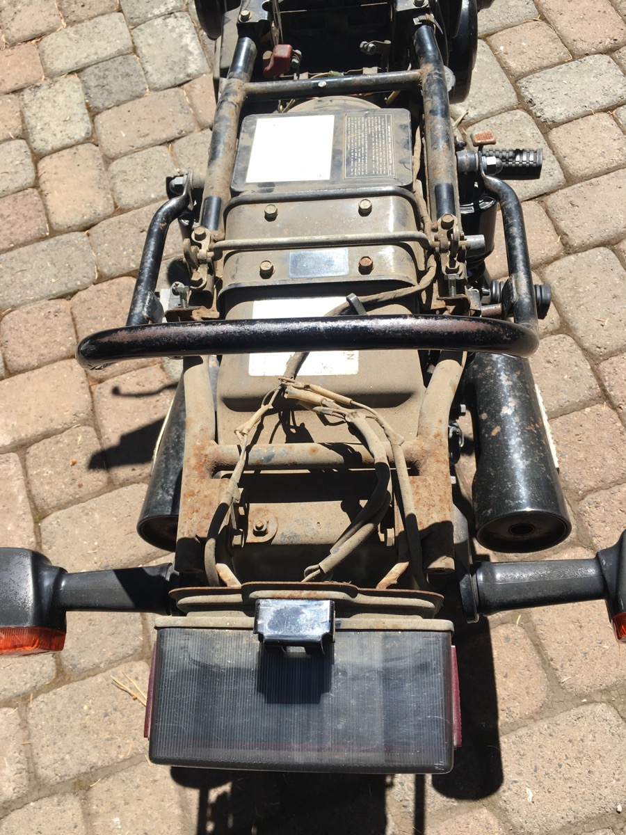

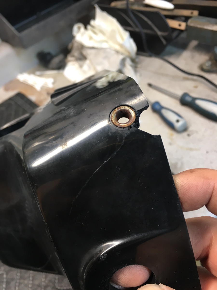

So the following morning I unload the 750 and give her a good once over. Well, as I hoped, she was all there but in need of some TLC, but not so bad as to warrant a nut and bolt tear down...pshhh, sure. I cannot see any tampering as far as modifications, which these poor girls suffered by the hands of the uncaring. By my assessment, Im thinking, rebuild all the obvious systems...brakes calipers, master cylinders, forks, chain and possible sprockets, tires, seat upholstery, and slight upgrading as we did back in the day. Definitely needs a Kerker, maybe jet kit or Keihin CR carbs, Dyna ignition, swingarm /calfab, rear shocks..Ohlins maybe. Anywho, I needed to finish up my 89 GSXR1100 I was building and then Id jump on her... I know, booo hisss. But I loved the 80s! The only issue I saw was, I think she probably lived somewhere near the coast as there was corrosion on alot of things, not deep rust through type, but corrosion that could lead to a full frame off restoring...well see. Need to crack the carbs to check them, get a battery and see if she starts...fingers crossed!

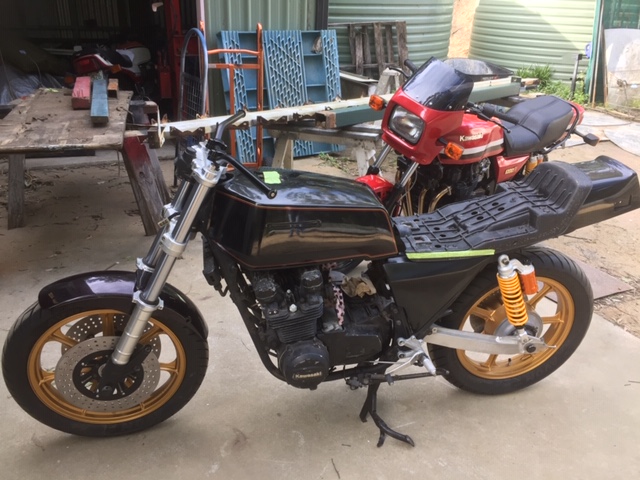

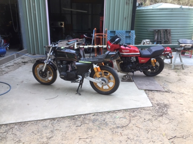

Thats awesome. I checked your story out before I posted mine as it encouraged me to. Thats going to be an awesome tribute. Ive got an ELR tribute, not a clone since that pisses off the purists, that im going to start as soon as ive collected some additional parts. Its going to be built off an 82 LTD 1000 i found locally. In my research Kawasaki built the frames for all the models mostly the same except at the back area, where if you look, the either installed a hoop for the LTD or whatever design for the other models. I already did a trial fit and you can see how it works. I have an 82 GPZ rear 18" rim and just need forks from the year thats bottom mounted and not leading mounted. I read muzzy even said to use KZ cop tubes since they came with a thicker wall diameter to stiffen the front!

I'm using 18 inch wheels on mine, the front is off a Z1300, 2.15 x 18 and the rear is off a Z1000p Police bike, 2.50 x 18. I also have a set of wider 17 inch rims I may use later on..

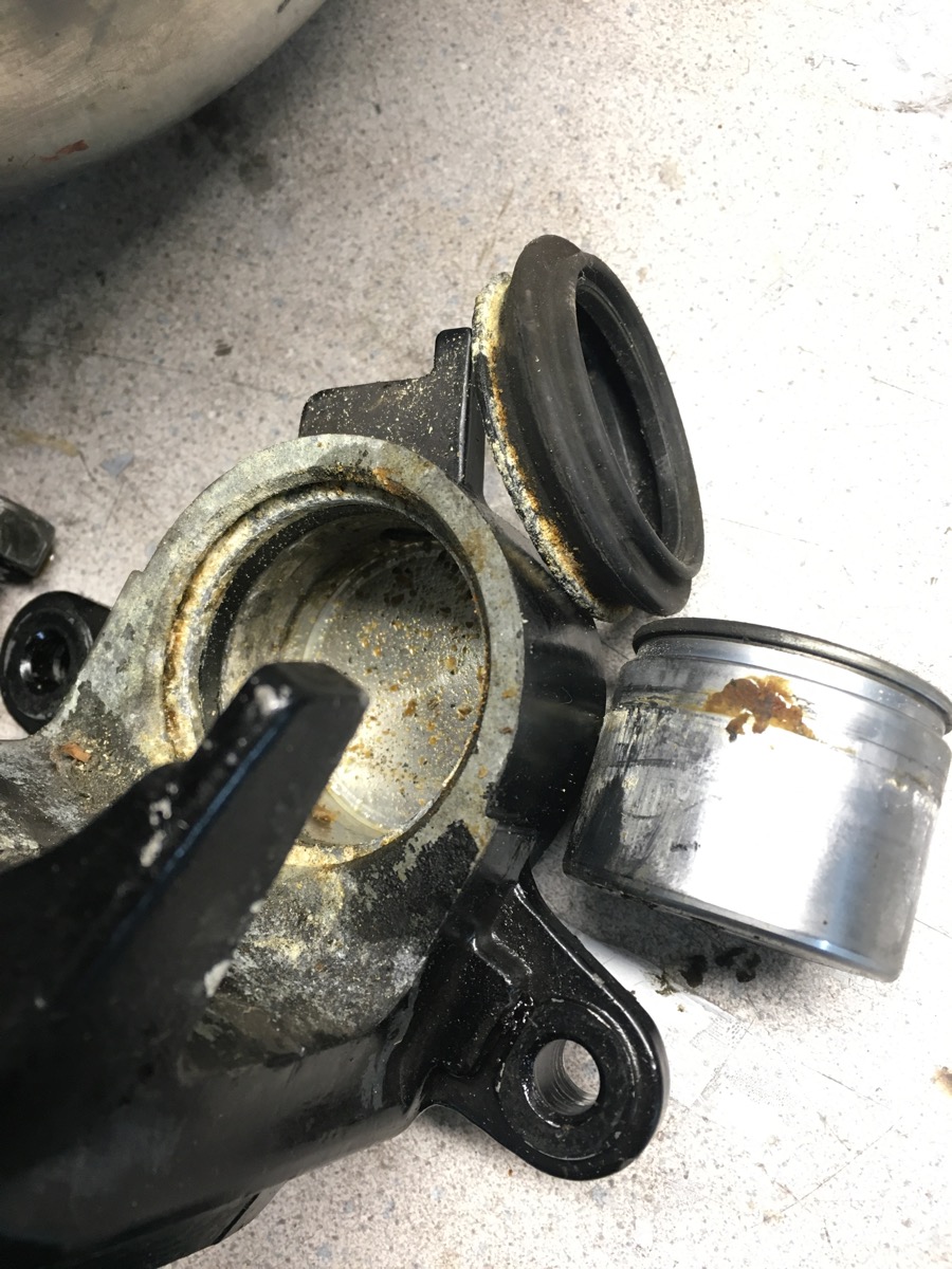

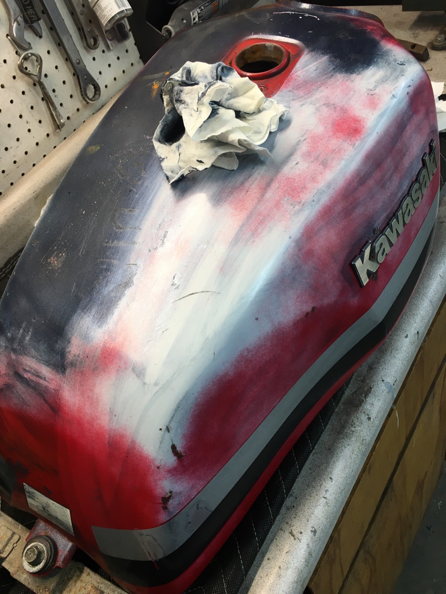

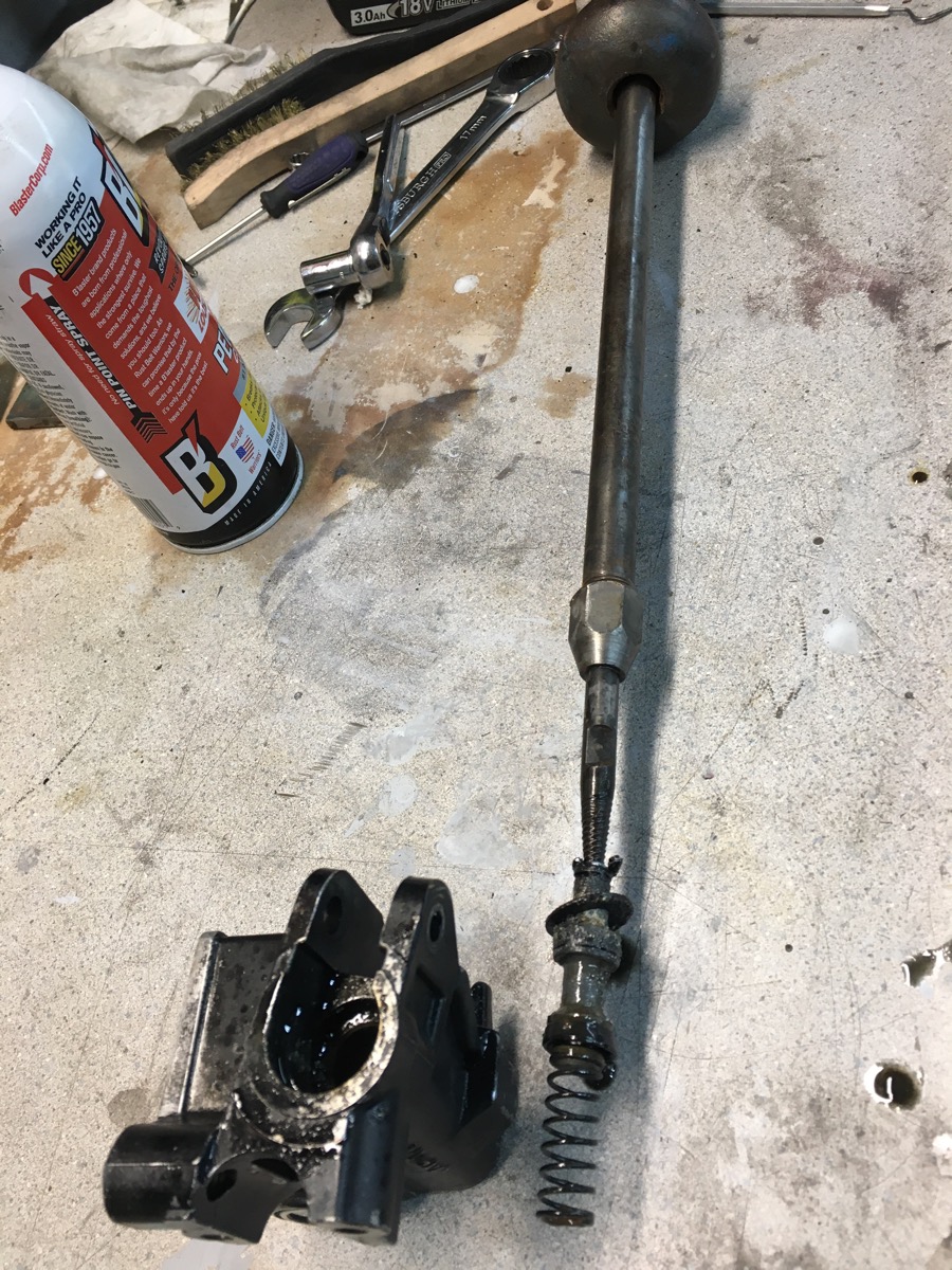

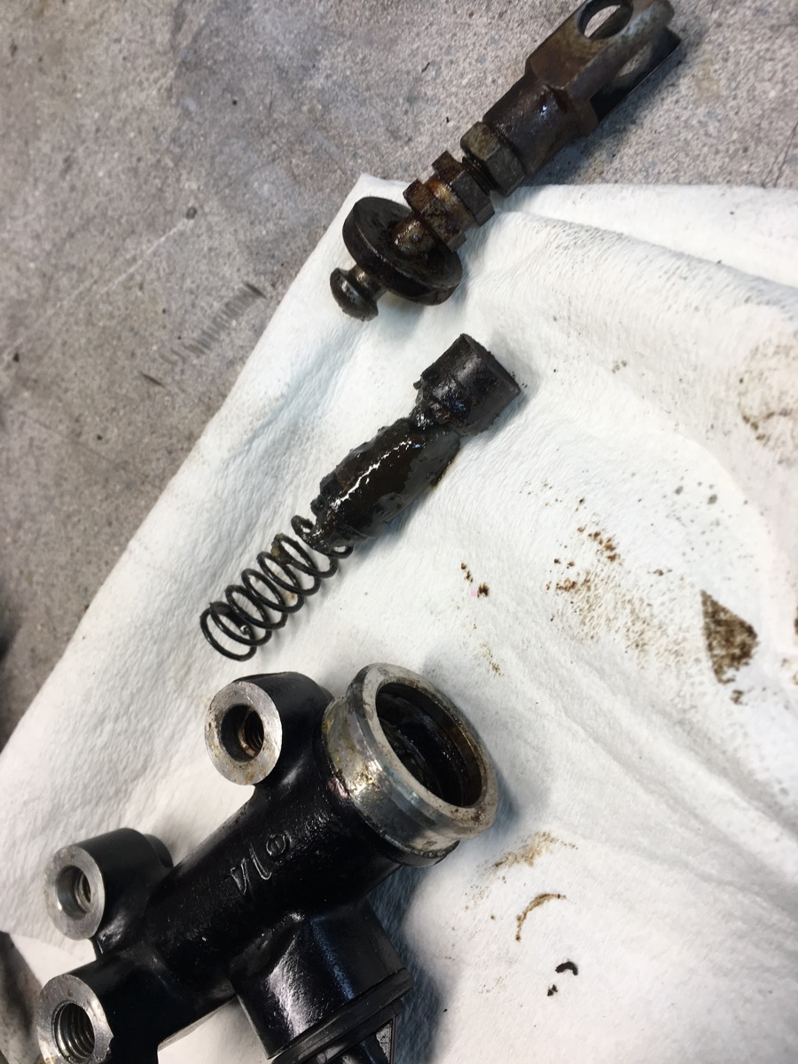

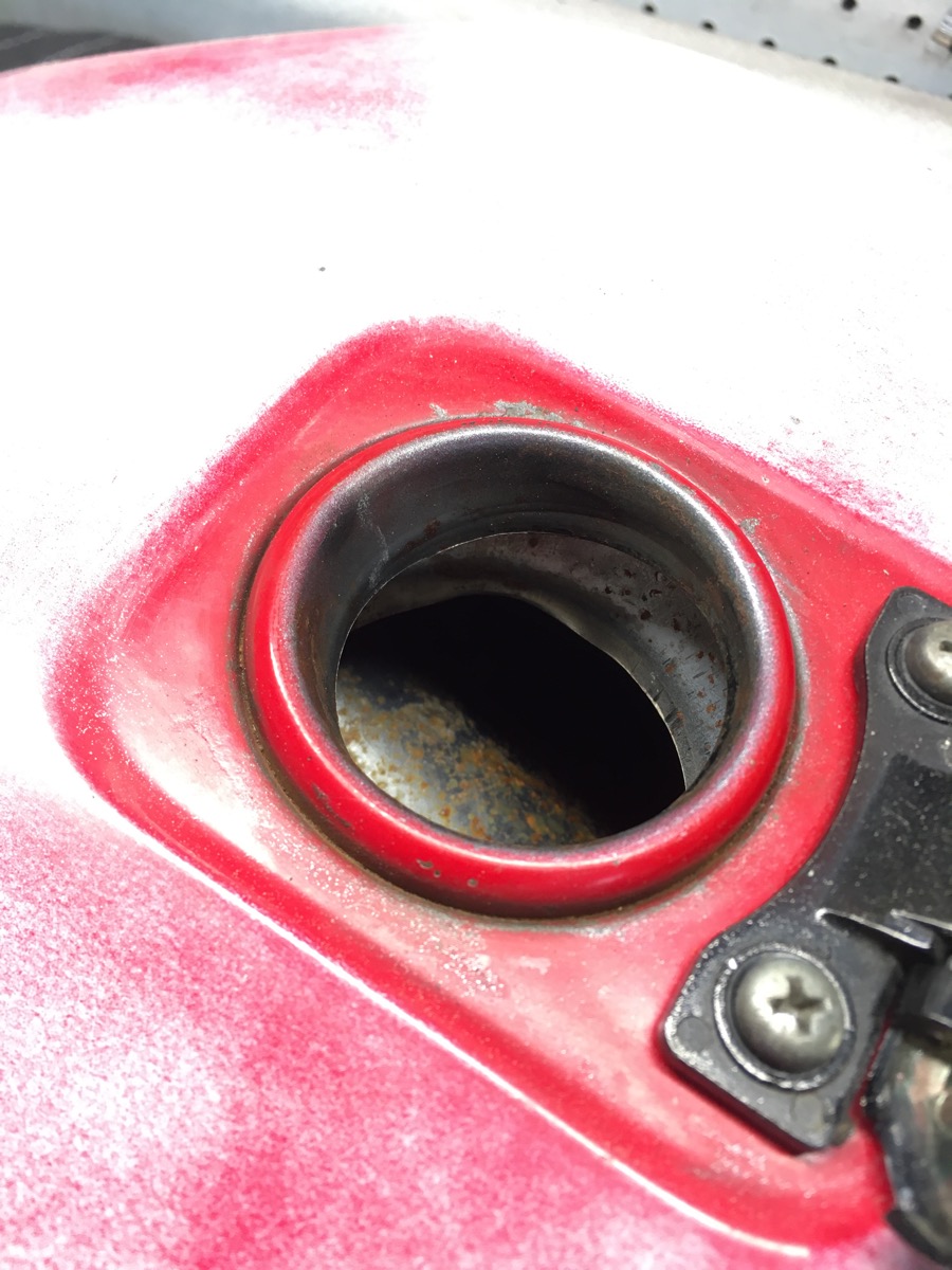

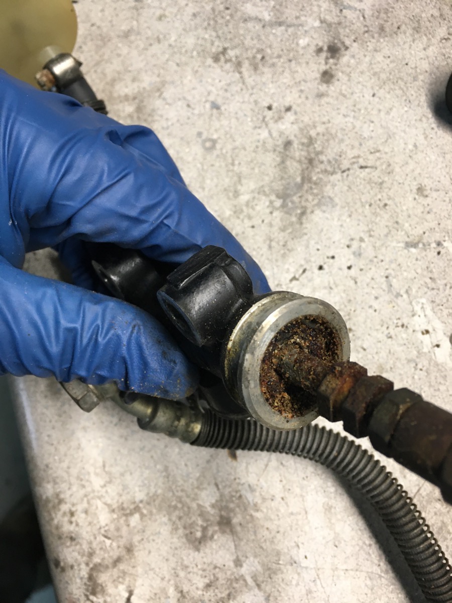

Day 2...started with cleaning the tank with rust rescue, works amazing. and rebuilding the petcock. The fuel sender/level indicator wasn't working and the gasket was hard as a rock, so ordered a gasket and will try and fix the sender. Hopped onto the brakes as you can see, they did want to play nice, I literally had to use a slide hammer to remove the piston on the master cylinders. Cleaned up the primary sprocket area and didnt need to order a sprocket since the stock was fine...for now! And had my first casualty. While trying to remove the rear brake lever from the peg base...she broke...ugh. I tried everything from penetrate oil to heat and then in the press she went...snap. Thank god you can find these from other models on fleabay!
