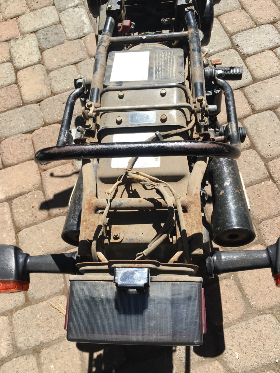

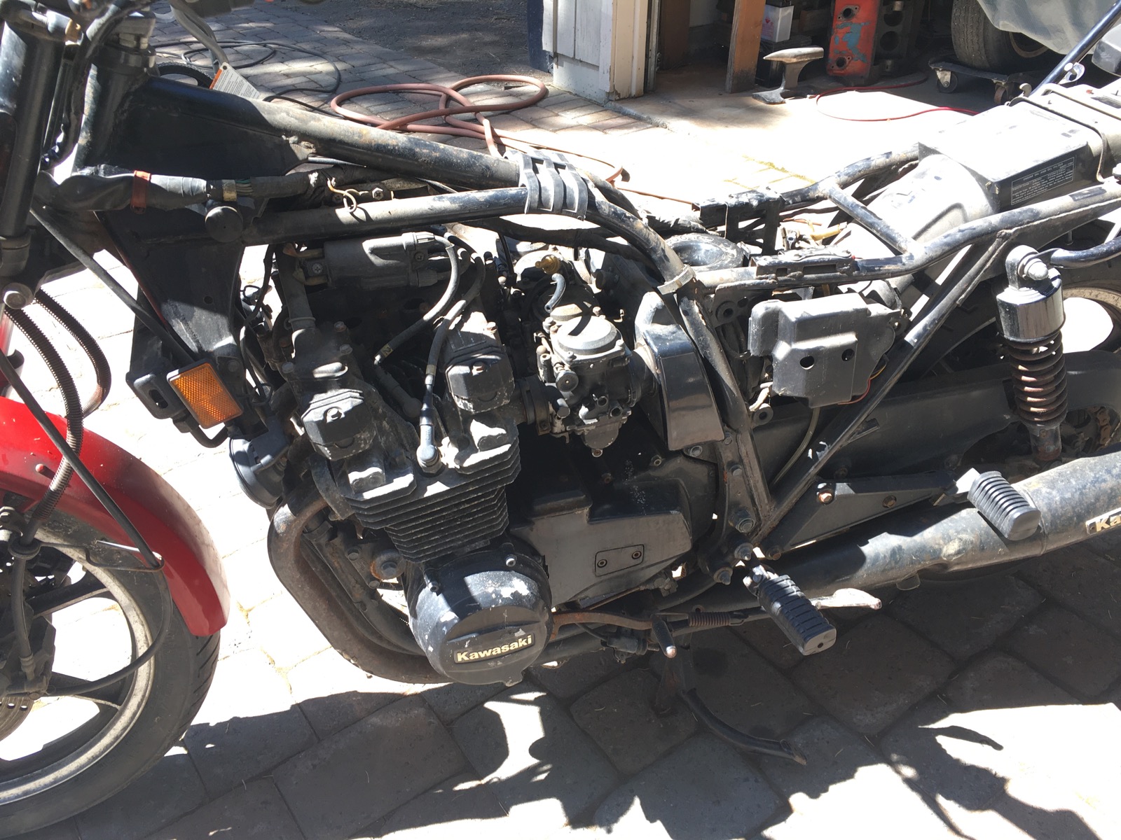

So the following morning I unload the 750 and give her a good once over. Well, as I hoped, she was all there but in need of some TLC, but not so bad as to warrant a nut and bolt tear down...pshhh, sure. I cannot see any tampering as far as modifications, which these poor girls suffered by the hands of the uncaring. By my assessment, Im thinking, rebuild all the  obvious systems...brakes calipers, master cylinders, forks, chain and possible sprockets, tires, seat upholstery, and slight upgrading as we did back in the day. Definitely needs a Kerker, maybe jet kit or Keihin CR carbs, Dyna ignition, swingarm /calfab, rear shocks..Ohlins maybe. Anywho, I needed to finish up my 89 GSXR1100 I was building and then Id jump on her... I know, booo hisss. But I loved the 80s! The only issue I saw was, I think she probably lived somewhere near the coast as there was corrosion on alot of things, not deep rust through type, but corrosion that could lead to a full frame off restoring...well see. Need to crack the carbs to check them, get a battery and see if she starts...fingers crossed!

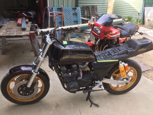

Hi Mike, I'm turning my 750 into  moriwaki tribute bike kinda thing, GS1100 swingarm, 45mm showa front end, 810 kit, leaving the BS34 carbs but installing a stage 3 dynojet kit and lots of other goodies, they are a great little bike..   Covid has slowed things down a bit but its slowly getting there...

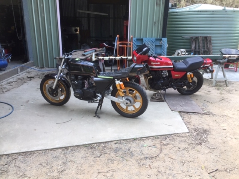

Thats awesome. I checked your story out before I posted mine as it encouraged me to. Thats going to be an awesome tribute. Ive got an ELR tribute, not a clone since that pisses off the purists,  that im going to start as soon as ive collected some additional parts. Its going to be built off an 82 LTD 1000 i found locally. In my research Kawasaki built the frames for all the models mostly the same except at the back area, where if you look, the either installed a hoop for the LTD or whatever design  for the other models. I already did a trial fit and you can see how it works. I have an 82 GPZ rear 18" rim and just need forks from the year thats bottom mounted and not leading mounted. I read muzzy even said to use KZ cop tubes since they came with a thicker wall  diameter to stiffen the front!

I'm using 18 inch wheels on mine, the front is off a Z1300, 2.15 x 18 and the rear is off a Z1000p Police bike, 2.50 x 18. I also have a set of wider 17 inch rims I may use later on..

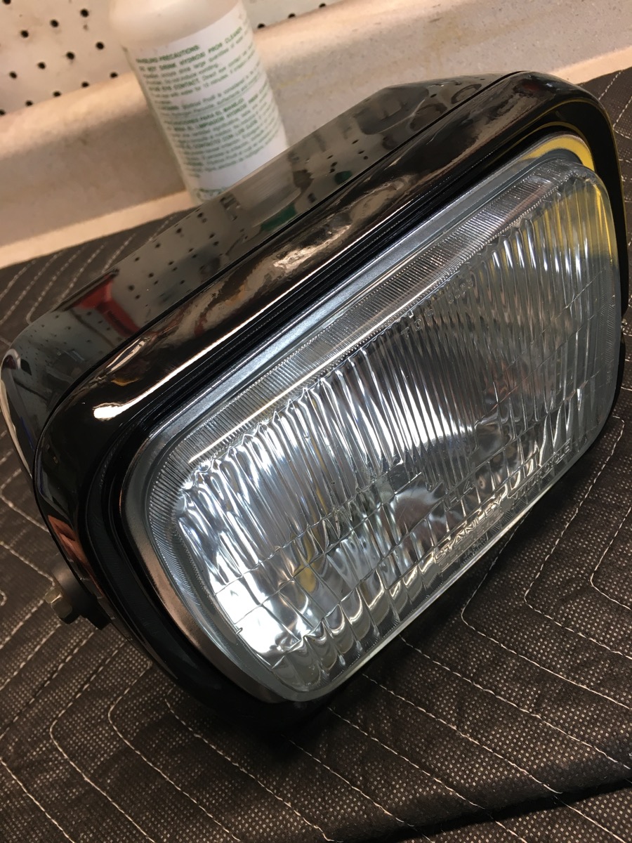

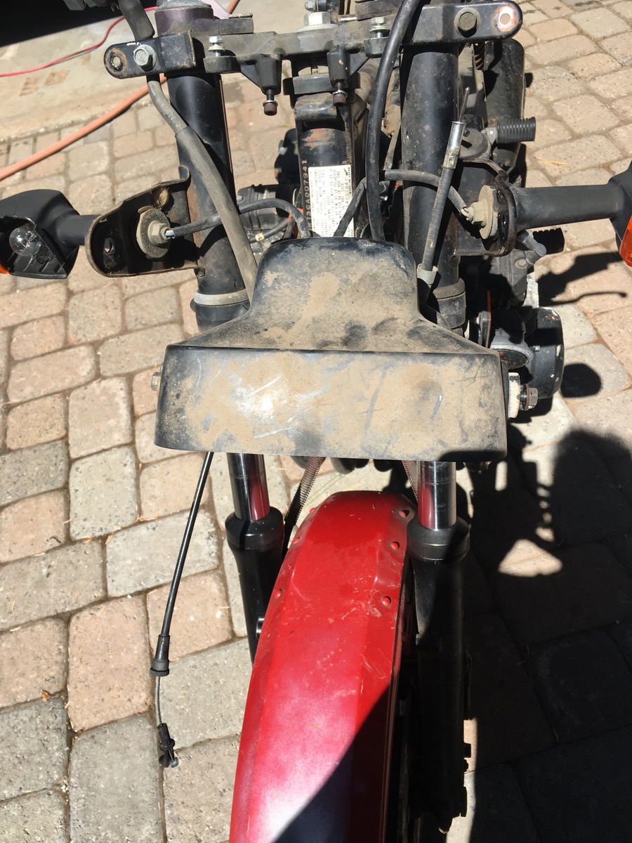

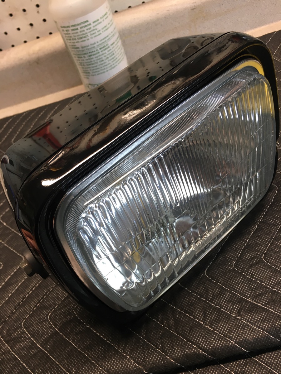

Well I decided to pull the 750 out of storage as I wait for decal masks to be made for another bike and start assessing and ordering the small things like rebuild kits for calipers, master cylinders, chain, tires, carb rebuild kit, ignition switch and battery. All the brakes were locked up and clutch also...She was definitely left outside and had a lil rust in spots, but not bad. I turned over the motor at the crank by hand so she wasn't frozen...yeah!  I started on looking for broken parts to do little fixes...ie the headlamp, as we all know is unobtainium, while I wait for the parts!

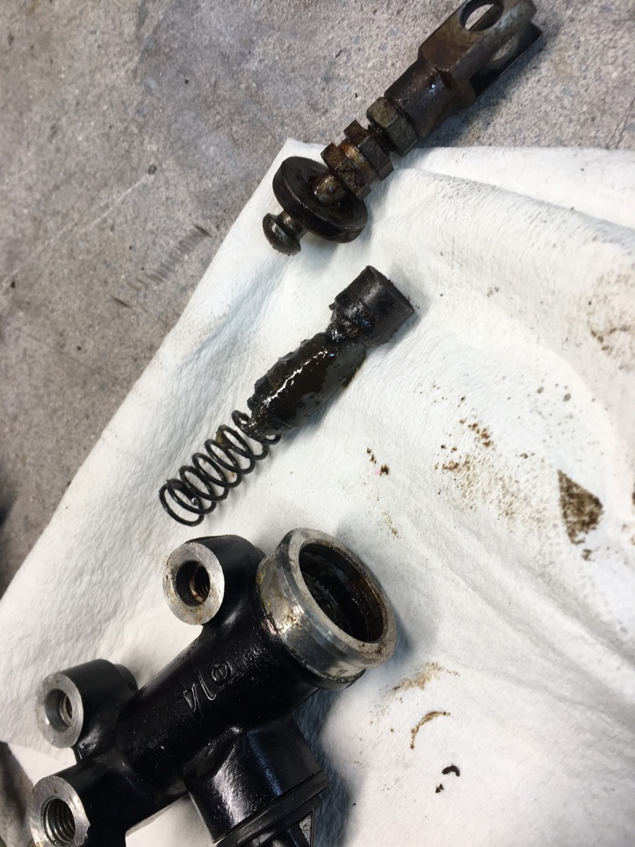

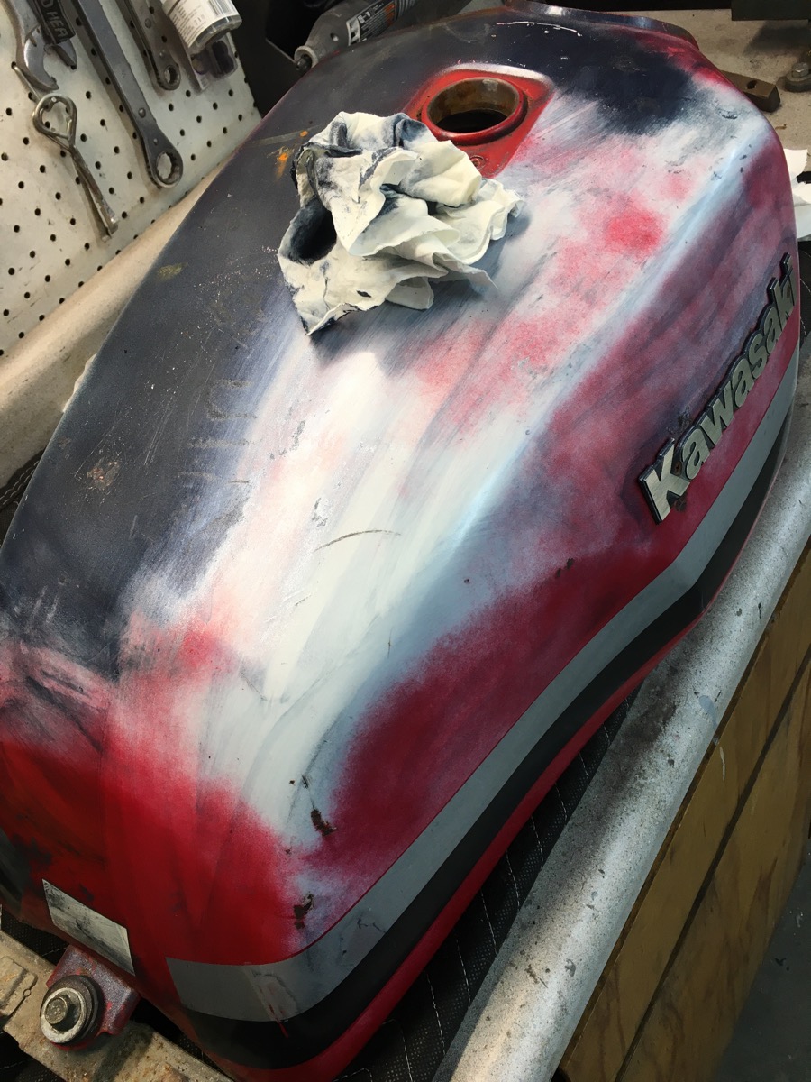

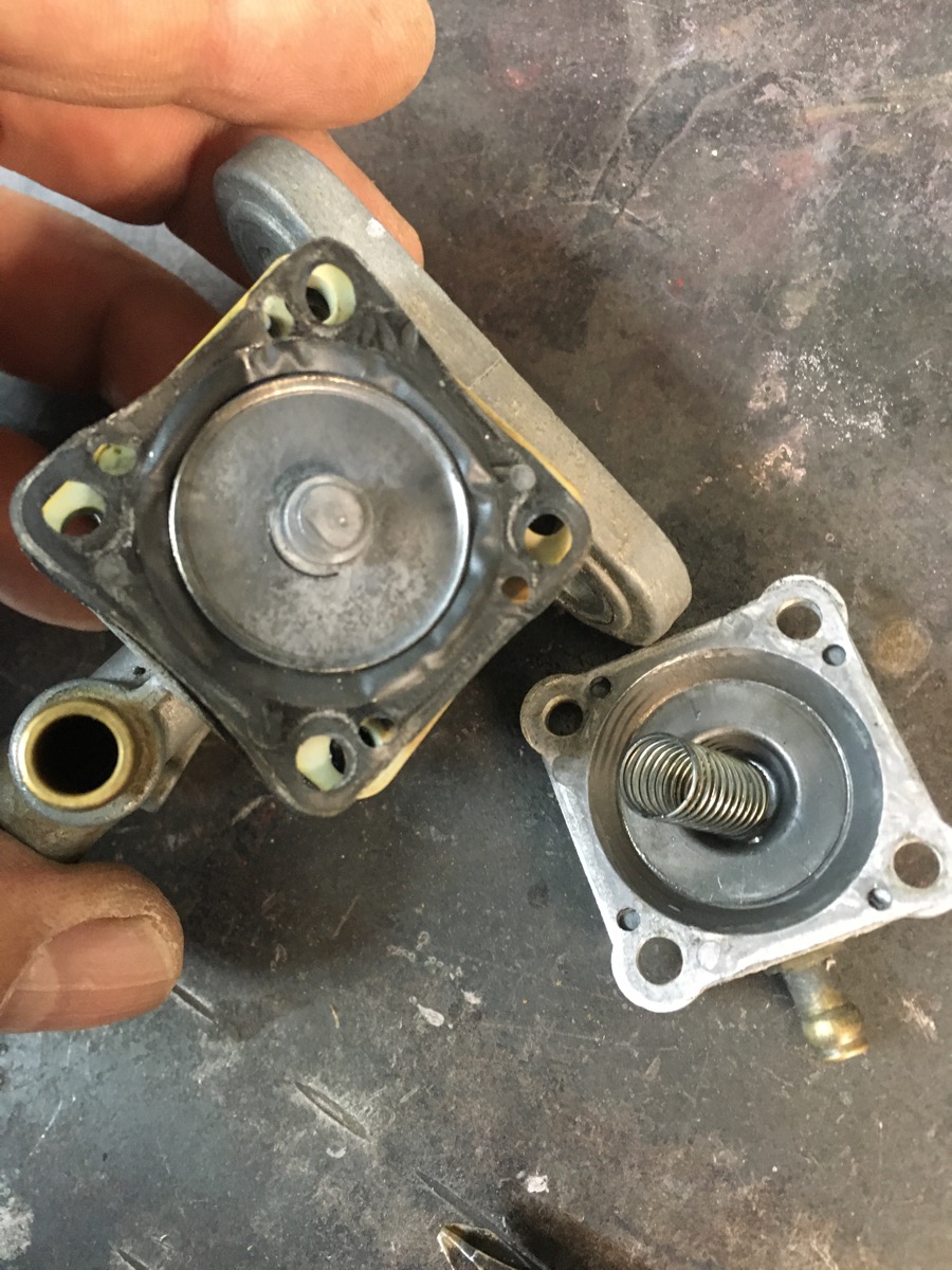

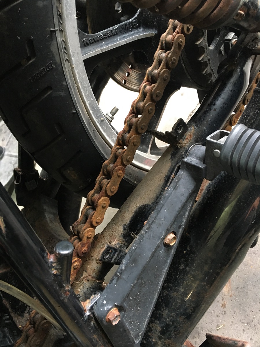

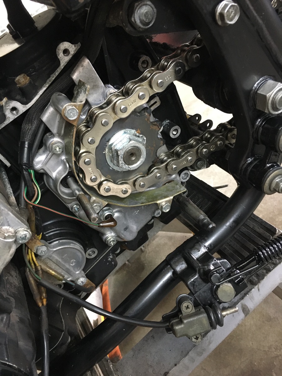

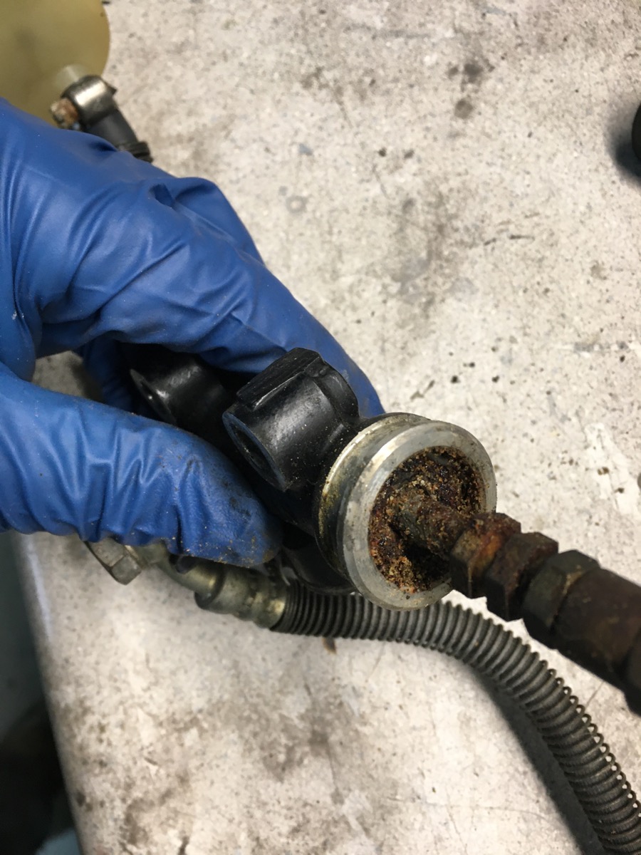

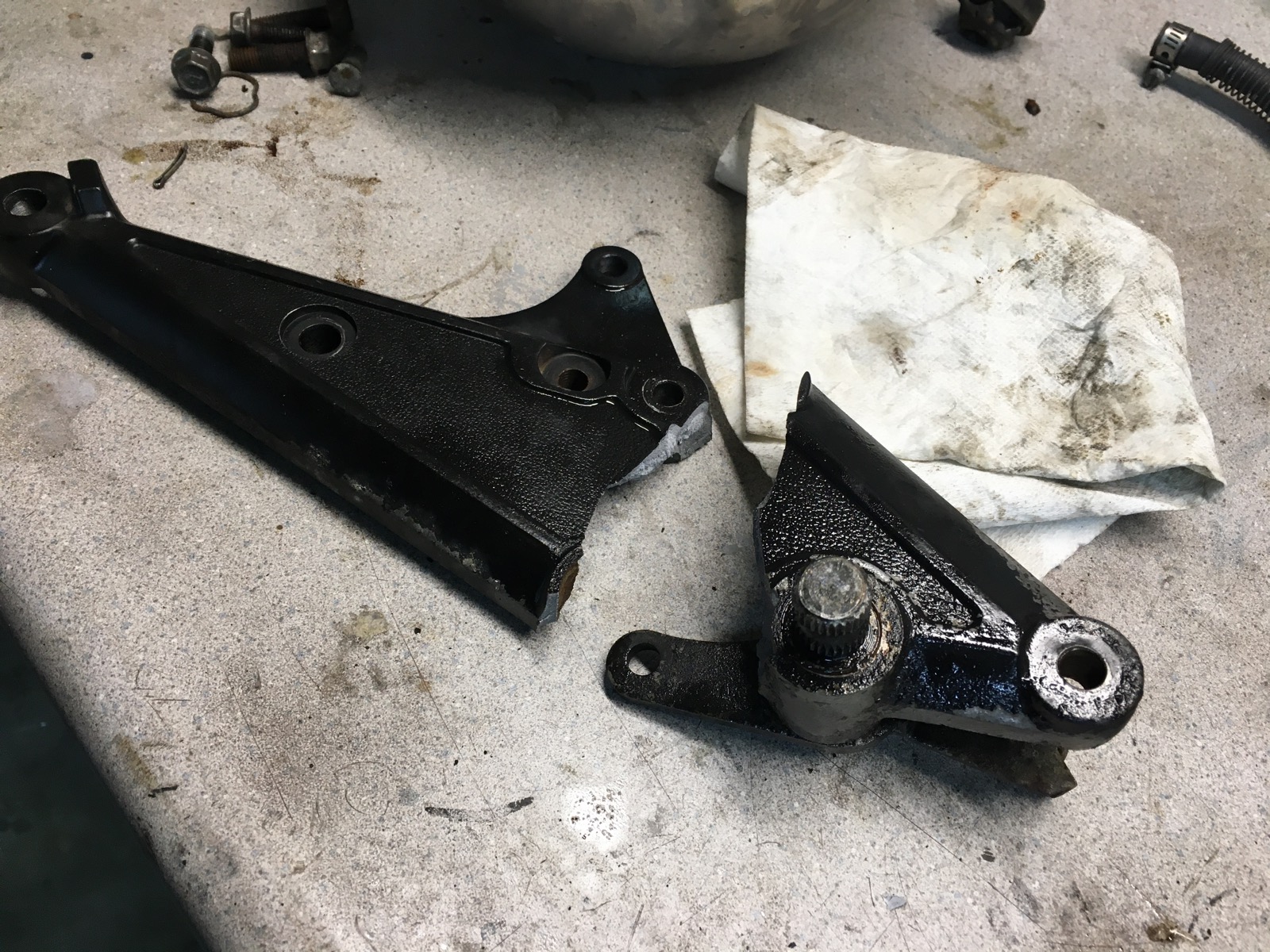

Day 2...started with cleaning the tank with rust rescue, works amazing. and rebuilding the petcock. The fuel sender/level indicator  wasn't working and the gasket was hard as a rock, so ordered a gasket and will try and fix the sender. Hopped onto the brakes as you can see, they did want to play nice, I literally had to use a slide hammer to remove the piston on the master cylinders. Cleaned up the primary sprocket area and didnt need to order a sprocket since the stock was fine...for now! And had my first casualty. While trying to remove the rear brake lever from the peg base...she broke...ugh. I tried everything from penetrate oil to heat and then in the press she went...snap. Thank god you can find these from other models on fleabay!
