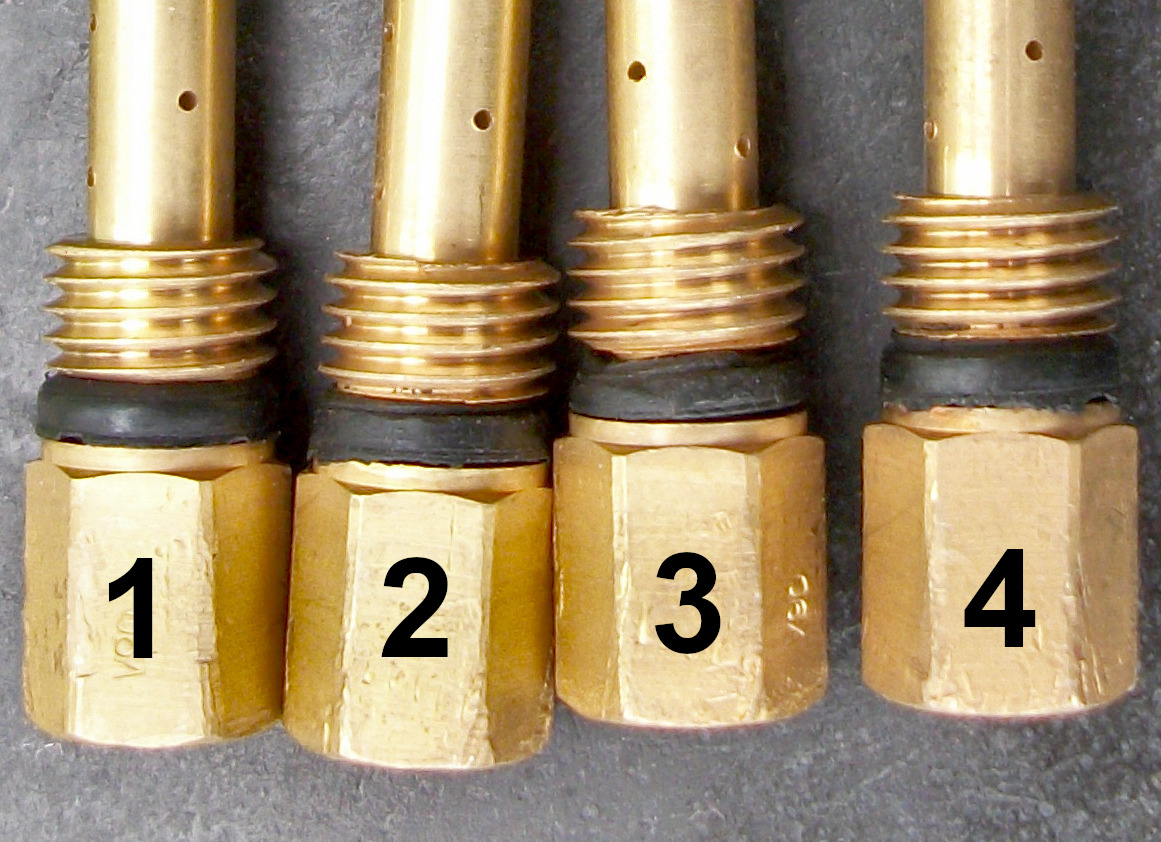

Pattern ones are cheap and they are the same as the Z650 also carb intakes are cheap too,put a new set on the Z500 a few years ago, make carb refitting a breeze. While they are out get some 5mm x 2mm virton o rings for the emulsion tubes they may have gone hard, depending on milage also emulsion tubes can go oval, mine did after 69000 miles.
No3 was worst. Plug check will tell you

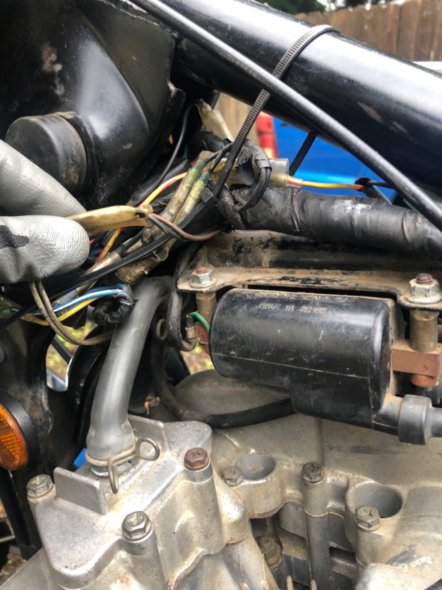

Inspired—and now armed with a can of contact cleaner—I dove into the spaghetti. I (again, stupidly) forgot to take Before and After photos, but it was a bit of a rat’s nest under there. So I somewhat-methodically took apart and cleaned each connector, and attempted to make some sense of the wire routing, at least so things like the blinker relay and the headlight-failure doohickey unit weren’t bouncing around on the top of the swing arm anymore.
Here is a dramatic reenactment:
I found a few dodgy connections and a couple of bad grounds between the regulator/rectifier and the fuse box, as well as some jiggly connections to the ignition coils. I cleaned and tightened what I could find. It started up but was running on three cylinders. Cylinder 1 gave me a nice healthy Zap, but Cylinder 4 still wasn’t sparking, and I didn’t pursue matters beyond that.

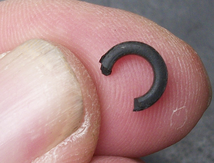

Today I topped off the oil, looked for leaks, and tried to get to the adjust the valve needle clips orthisopically, a la Allen Millyard. But I opened up the #1 carb and immediately chickened out.

I finally, finally, finally, (finally!) bit the bullet and replaced the original points with a Dyna S ignition. I tapped in to the new Executive Main circuit (see previous post) for the power. My original coils are still within spec, so I’ll keep them in there until Something Terrible Happens.
The other day I put the thing back together and fired it up. Hooray! No smoke! No electric burning smell! So my new ignition circuit/Executive Main/transistor ignition updates work! I didn’t fuck anything up!
And after draining/refilling the bowls and re-priming the fuel line, it fired right up and (after a short warmup) it settled into the smooooooooooothest idle ever. Lovely!

Running hot = running lean = lift needle valve up a notch = teeny weenie little circlips springing off into the remote corners of a dirty, ill-lit garage.
Another question: Is there a way to get to the needle clips without pulling the carbs again, or….?
