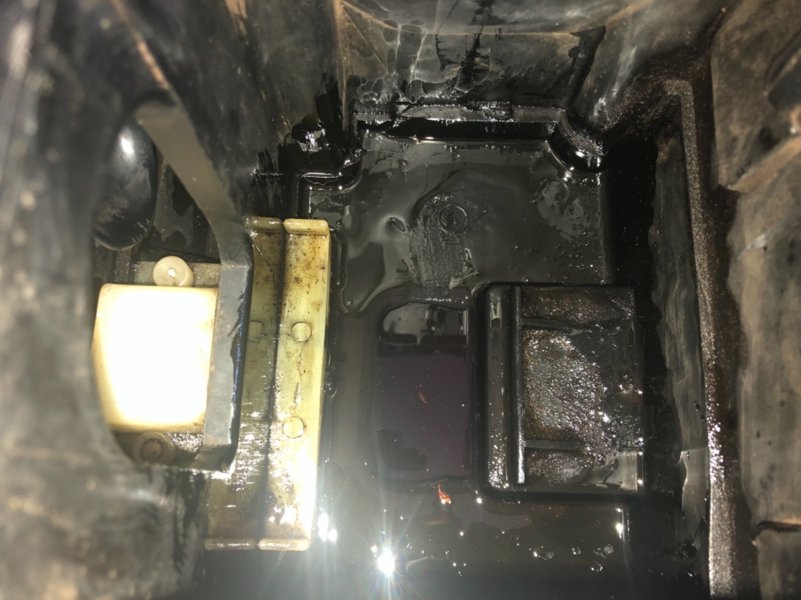

So I’ve hit kind of a what-do-I-do-next moment. It’s an Existential Motorcycle Moment. The good/done so far:
I’ve done some preliminary splicing and so on, and the wiring at least looks intact and original. I’ve taken apart and cleaned/greased the left handlebar switch assy, and made good progress with the chrome.
I added another canister of grease into the swingarm fitting; still nothing coming out the ends. I’m starting to get worried, and I’ve run out of grease.
Somebody’s been inside the carbs recently; among the spare bits was one of the air box mounts. (But not the other one.) Like a shelf mount from IKEA, only overbuilt in Japan. (It is kind of a fun game: Where Does This Bit Go?) Vent lines are missing, as are a couple of the Absurdly Expensive Intake Trumpet Collar Springs. www.partzilla.com/product/kawasaki/92081-047 The drool-lines for the bowls are missing, too, and one or two of them is on backwards. (Just the float bowls are backwards; not the entire carburetors.)

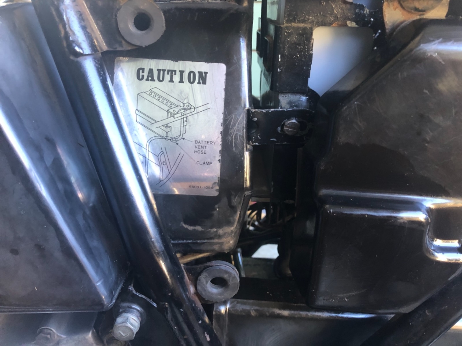

Once I’d at least shoved half of the airbox into alignment—enough to stuff IKEA into the battery box on one side—the trumpets were aligned better with the throats. I can’t tell if they’re still leaking or not.*
*(Answer: probably.)
So it was running fine for a while the other day—other than a too-long chain—but then it started stumbling badly, like it was on three cylinders. This was long after I’d cut back the choke, so it was already warm.
Perhaps something is going on with the carburetors.

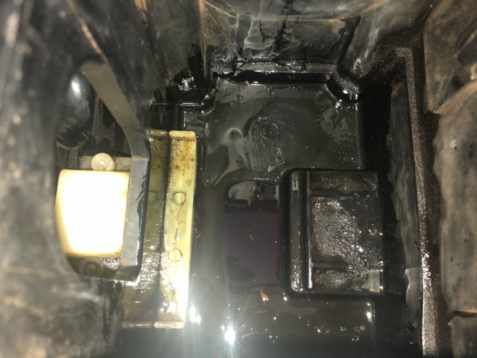

oil in the airbox (but no grease). Mopped it out but it looks like the drain is clogged. Drain goes to…?
Selfie after scrubbing the paint off the mudguard. Because priorities.

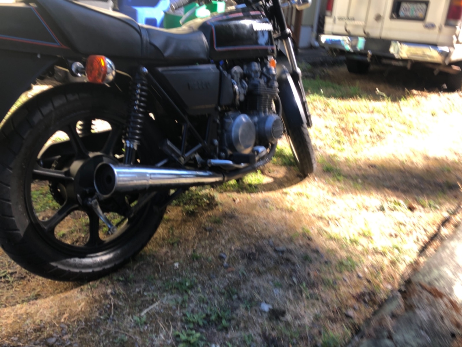

Look! Shiny OEM exhaust! Leaky O’Reilly gasket tape!
IKEA bracket makes for happier airbox.

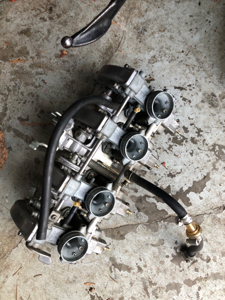

An update:

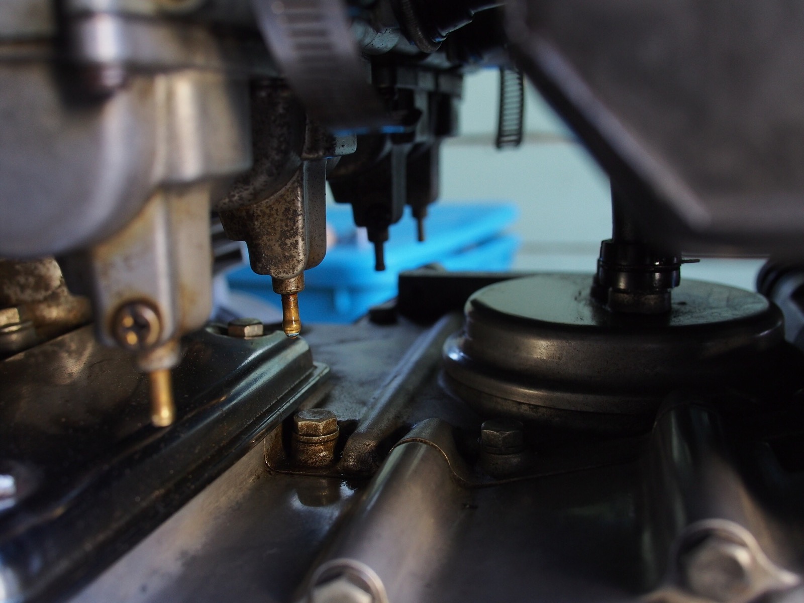

After much hemming and hawing, and uggaing and duggaing, I resected the carbs from the bike.
Wedgy wedgy
Now I’ve got the intake throats cooking in a bath of wintergreen oil and rubbing alcohol.
Squishy squishy
(Hope that wasn’t a bad idea!)
Wedgy wedgy
Squishy squishy
