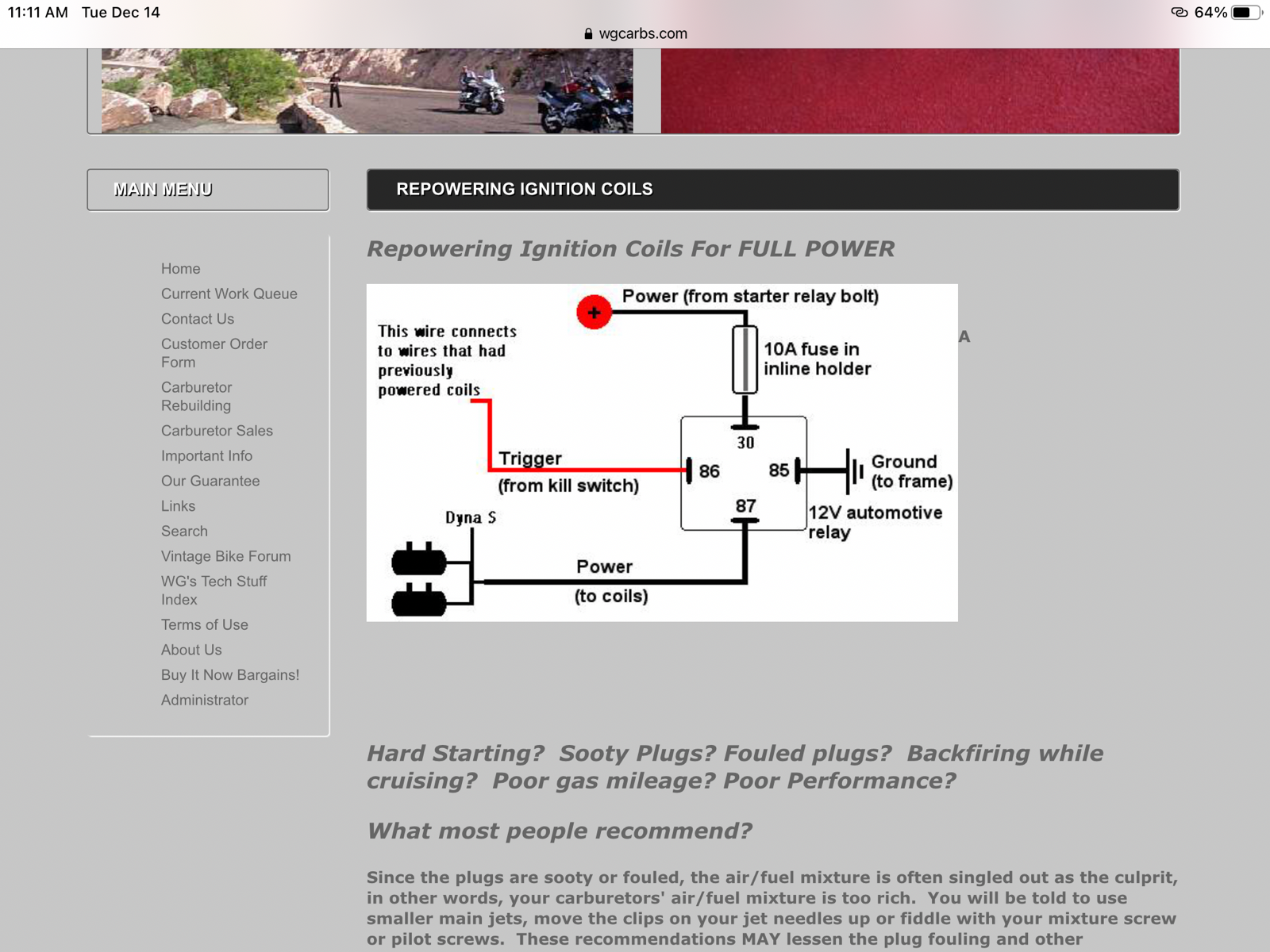

Correct on the brn/wht, and the dual female brown. Extra not needed. Good for accessories.
www.wgcarbs.com/index.php/using-joomla/e...-categories/89-coils
Here’s the Wired George relay schematic

15 Dec 2021 06:15Z1/KZ ignition switches, and motorcycle ignition circuits in general can introduce voltage drop at the coil primaries, reducing spark energy.What is the relay for the coils for? Does it keep the current from going through the handlebar controls?
The relay bypasses the ignition and kill switches, in order to supply full battery power direct to the coils through the NO relay contacts, while still retaining operation of the kill switch. The harness we developed is plug & play, with no butchering/cutting/crimping of any OEM wiring necessary; we just crimp matching bullet and ring connectors the the relay harness and battery power connections, respectively. The relay harness can be simply unplugged from the main harness and coil wiring, enabling the bike to be returned to it's factory original wiring configuration in under ten minutes after the tank is removed.

The Sohc Hondas suffer from similar electrical issues. I think I will solder up a relay for the start circuit on this Z1, seems like a safe thing to do for increased reliability. Thank you all for the great information.

I did the Wired George relay addition to my 1980 KZ1000 and it runs perfectly. I bought a second kit to put on my Z1B but I've never installed it. Maybe this summer.
