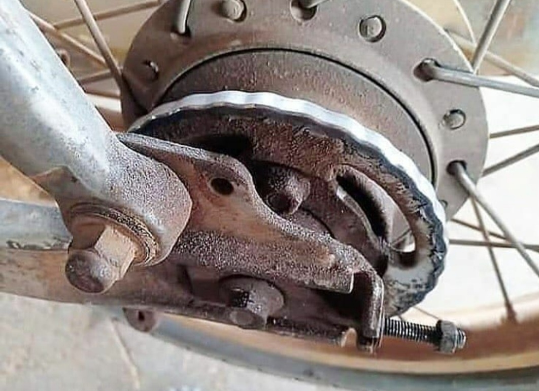

07 May 2021 14:44 - 07 May 2021 14:44That has got to be some kind of recordTook the rust off the chain. Still works just fine! :silly:
