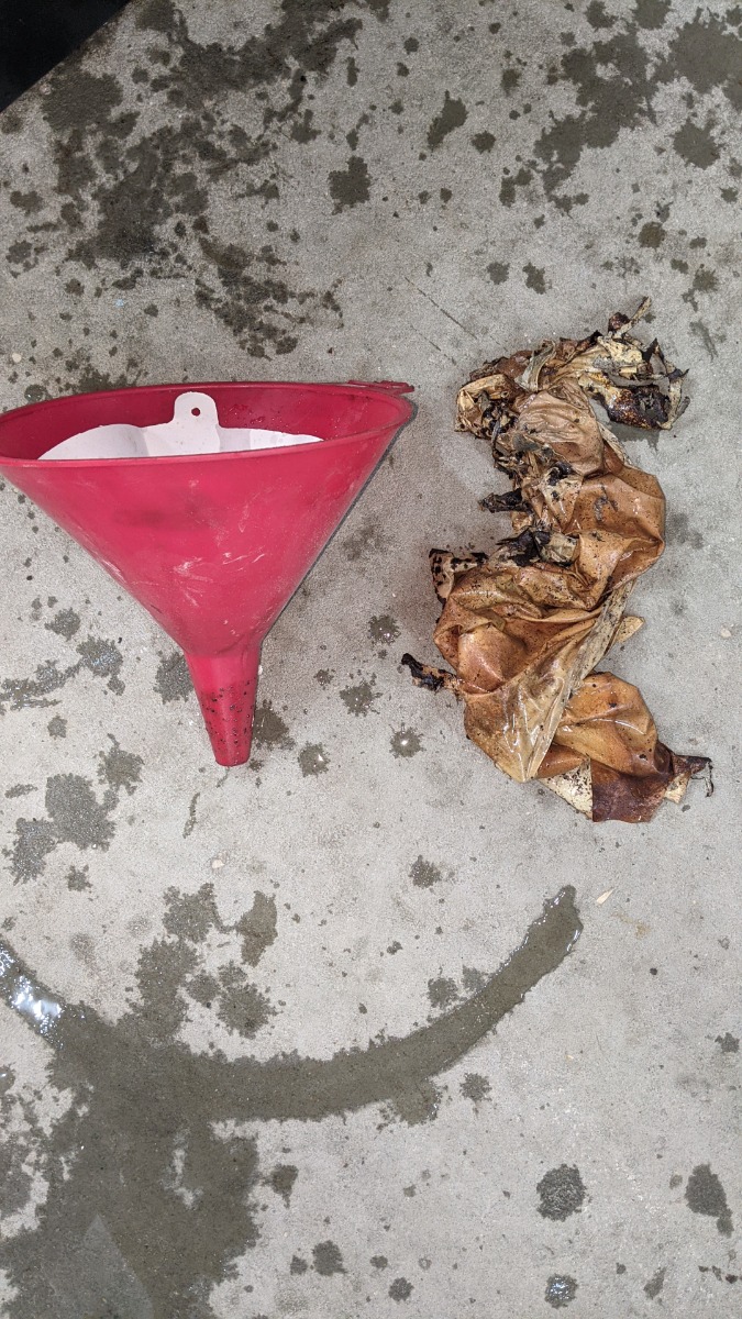

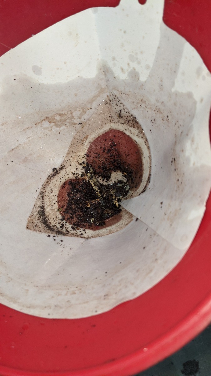

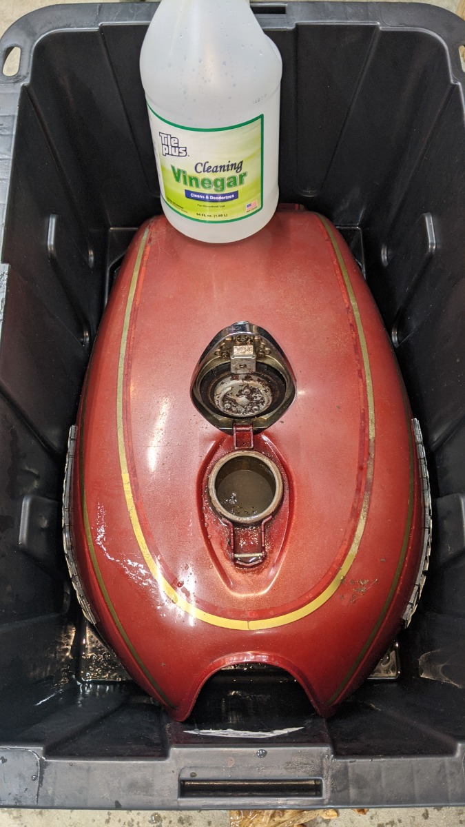

I appreciate all the advice on tank clean-out. Lot's of great suggestions. I'll be honest, I was super curious about the cleaning grade vinegar. I can't believe I've been working on old stuff for this long, and hadn't heard of this technique. So I wanted to try it and I did!
I removed the fuel petcock and plugged it with a rubber expansion plug. Then I put the tank in a plastic tote to contain any leaks. I tossed exactly 30 sharp and pointy construction screws in there for agitation. I filled the tank to the lip of the cap, and let it sit under the workbench for a couple days.
After the weekend, I pulled the tank out, strained off a couple gallons of vinegar in to an oil pan, closed the cap, and shock the crap out of it for about 10 minutes. Then I strained off the rest of the vinegar to inspect the tank. I forgot to take pics of the inside of the tank, but there was a lot of clean bare metal with a bunch of flaky liner bits laying around in there. This tank is really solid, no leaks, no obvious soft spots or excessive rust damage. So I decided the vinegar was doing it's thing. I re-filled the tank with the same strained vinegar, topped it off, closed the cap, and back in the tote and under the bench it sits. Below are the contents of the strainer, and one large chunk of old tank liner I pulled out of there.
I'm pretty confident in the vinegar at this point, I'm curious to see the end result. I used the same vinegar on the chain I'll share in a later post.

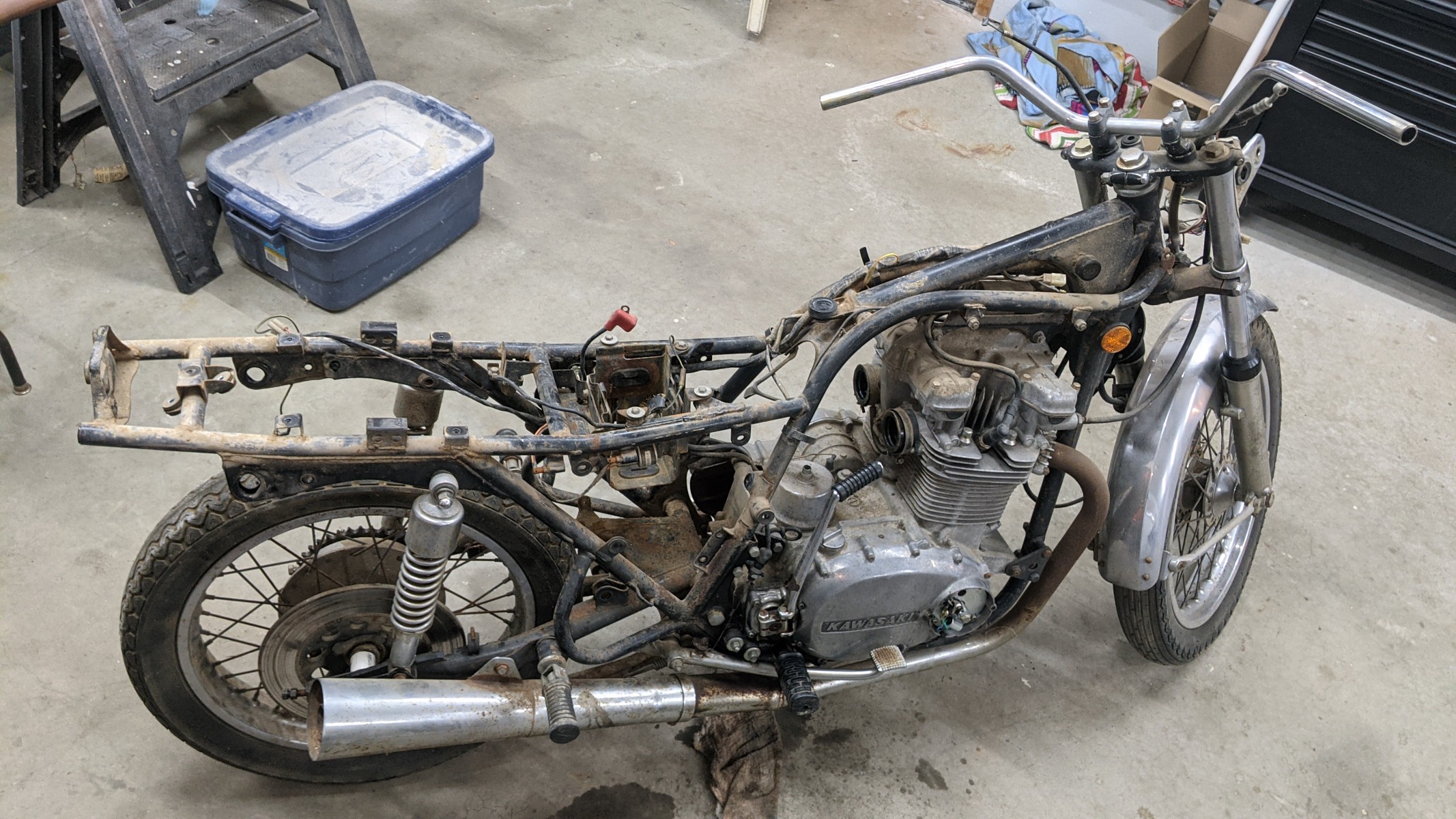

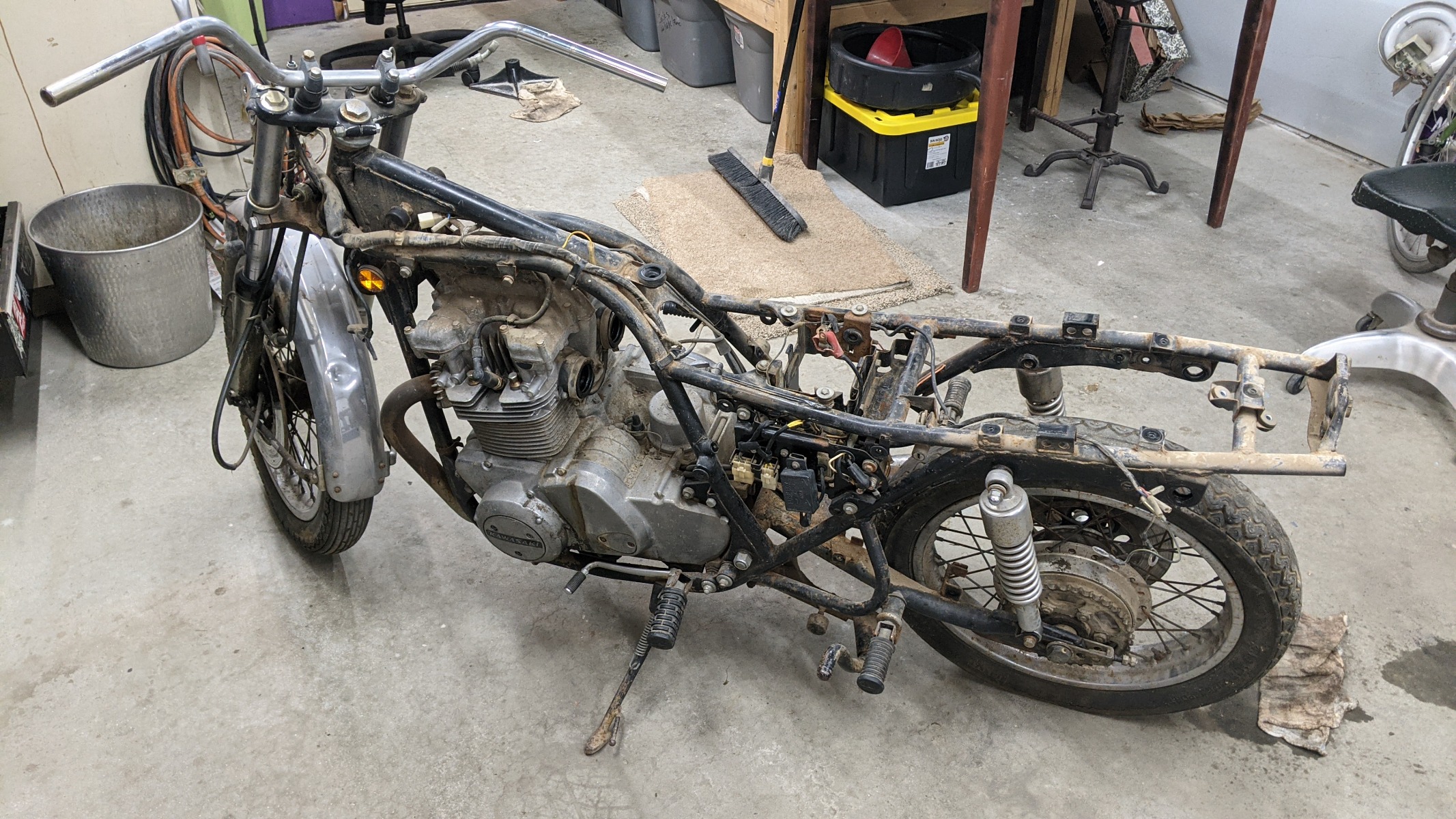

While the tank is being pickled, I decided to move forward and tear things down a little more this weekend.
Pulled lighting, controls, carbs, air box, and brake assemblies. I'll soon be wrestling with each I suppose. I left wiring and electronics in tact in order to get at least the skeleton of this thing to run...

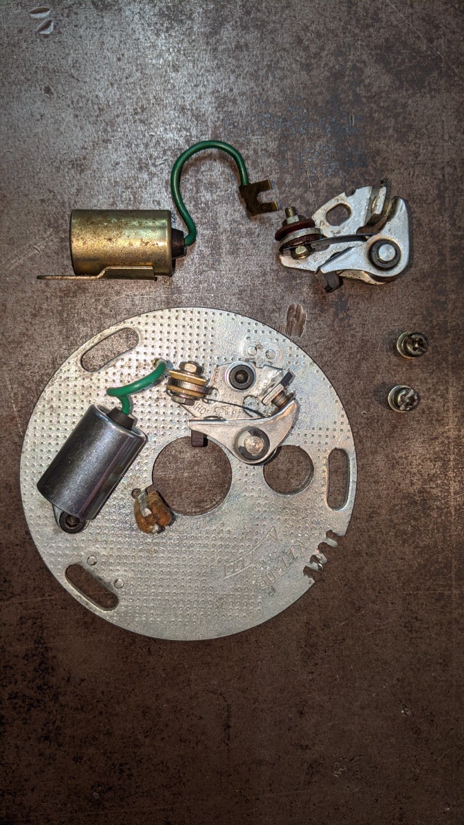

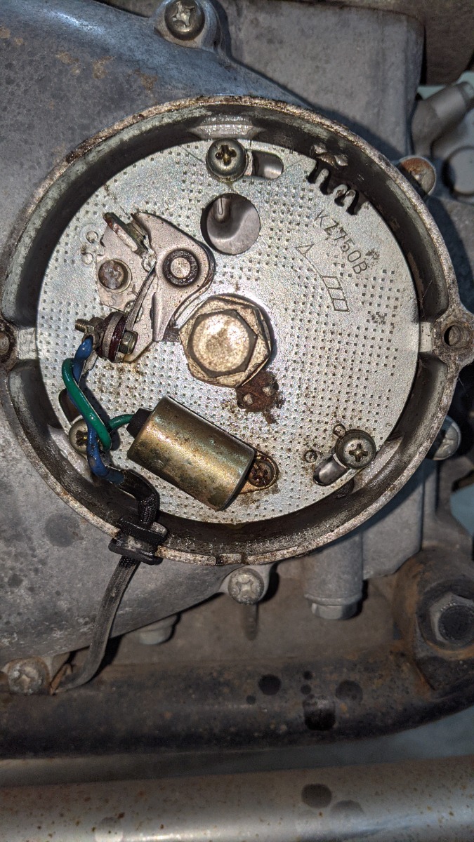

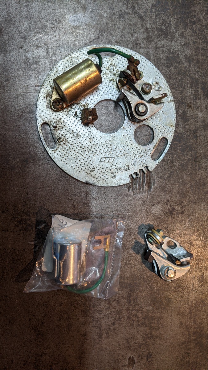

It's the little accomplishments, right?
I got the ignition parts swapped out. Had to come up with replace points and condenser machine screws, but that wasn't so hard. Here's pics. Hooray me!

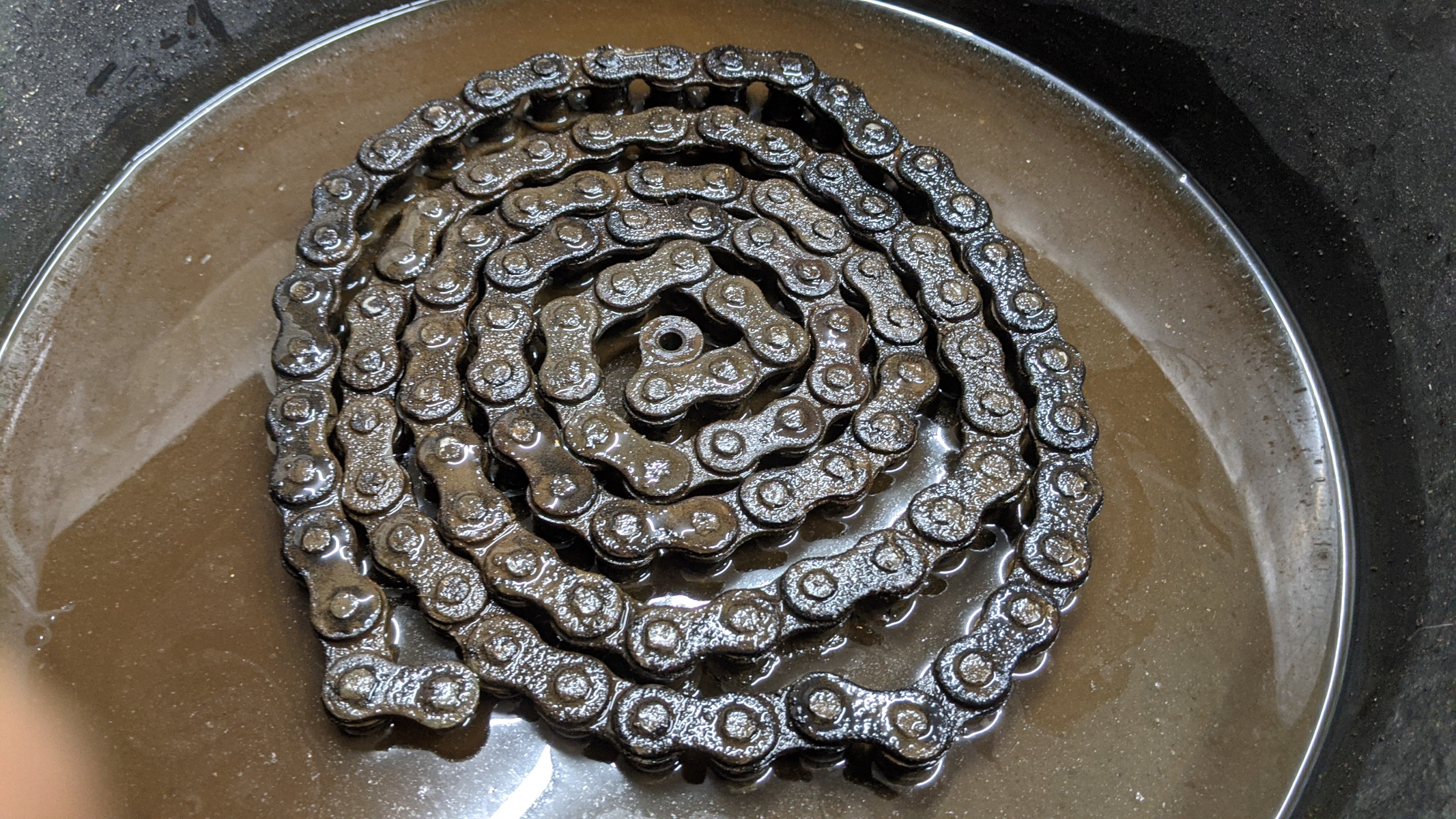

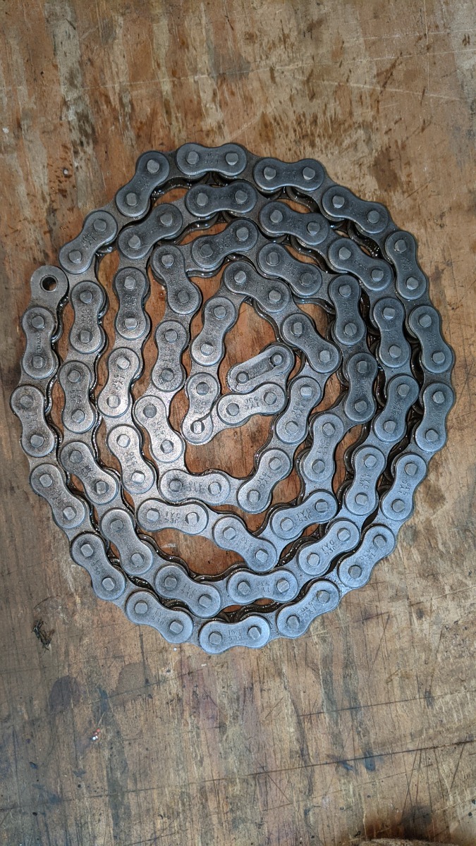

Amongst other things, I pulled the chain from bike. Below the first picture is right after I set the greasy and crusty chain in a shallow bath of the same vinegar I used in the tank.
I filled the pan enough to submerge the chain, and let it sit overnight. After a 24hr soak, some random flipping and scrubbing with a toothbrush sized wire brush, this is what you have.
Even in this condition, there were still a couple stiff links. So back in the bath it goes. It's napping there now and will be until tomorrow. I'll take some pics of the final product. I know chains are relatively cheap, and nice new o-ring chains are nice, but why toss it if I don't have to? The bike is low miles for it's age, the chain shows little wear or any damage from age, if I can clean it up and re-lubricate it, I see no reason not to use it. I'll keep an eye on it. The bike is far from a performance machine by today's standards, and I don't plan on excessively beating on it.
