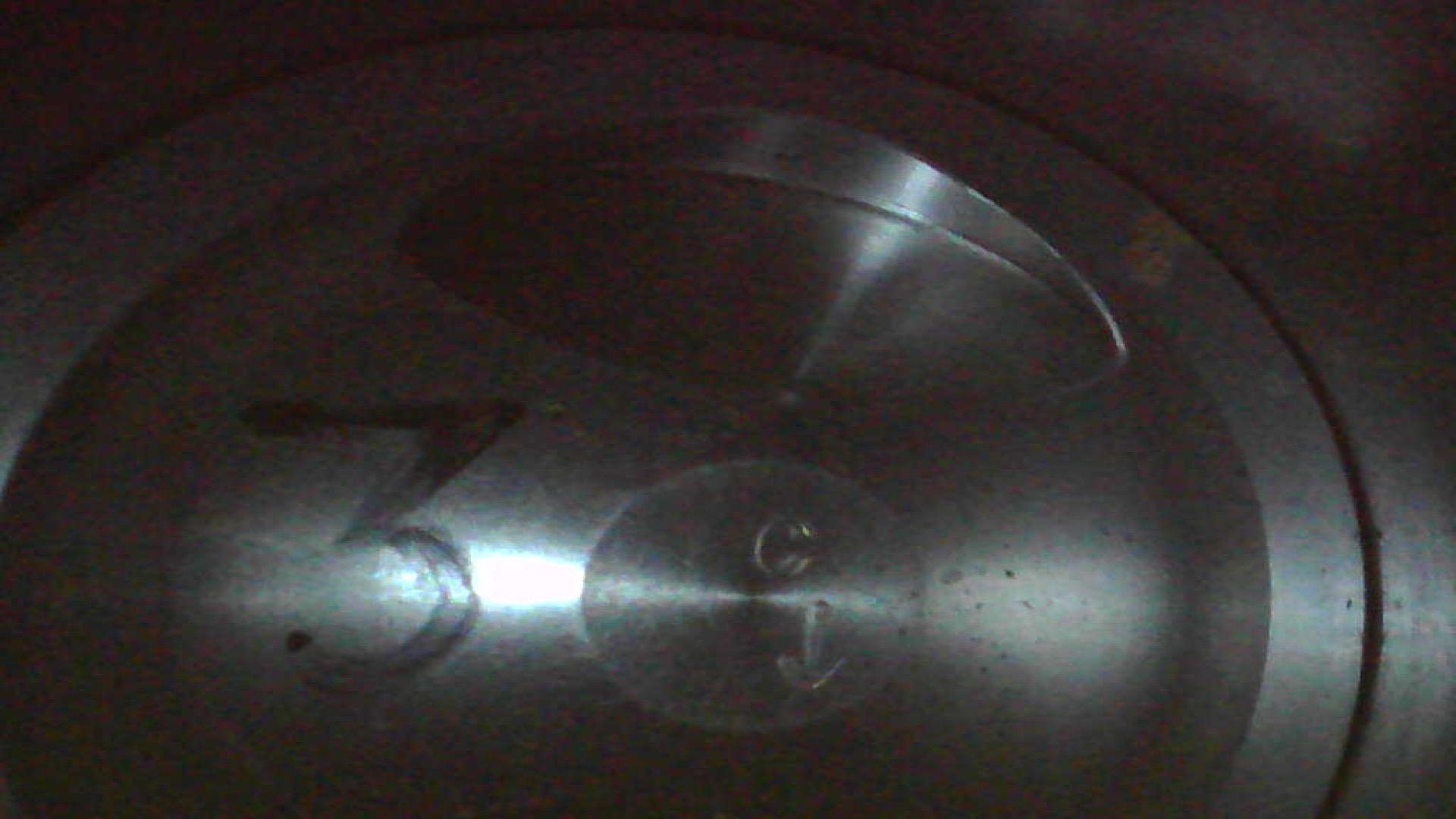

Perusing Facebook marketplace just really paid off KINDA. A 4 hour round trip and $130.00 YES $130.00, just scored me a Z1B 900 engine. Plan was to buy it regardless of condition hoping I’d get at least a good crankshaft out of it. I have to say if this possible I’m disappointed. Turns out the engine is a fresh (unknown years ago) build never fired. Can you be disappointed finding such a deal. Maybe I’m pleasantly disappointed. The goal was to get a crankshaft for this project. So now I wait till the generous member returns home and I can get my crank.
Engine is higher compression pistons. In the photos you can see sharpie numbers 2&3 on the pistons, the fresh cross hatch, ported heads, band new B8eS plugs, and Yoshimura “poppy” cams. I faintly see a B stamped on the cam ends. No clearance ground into either the lifter bucket nor cam cover areas.
