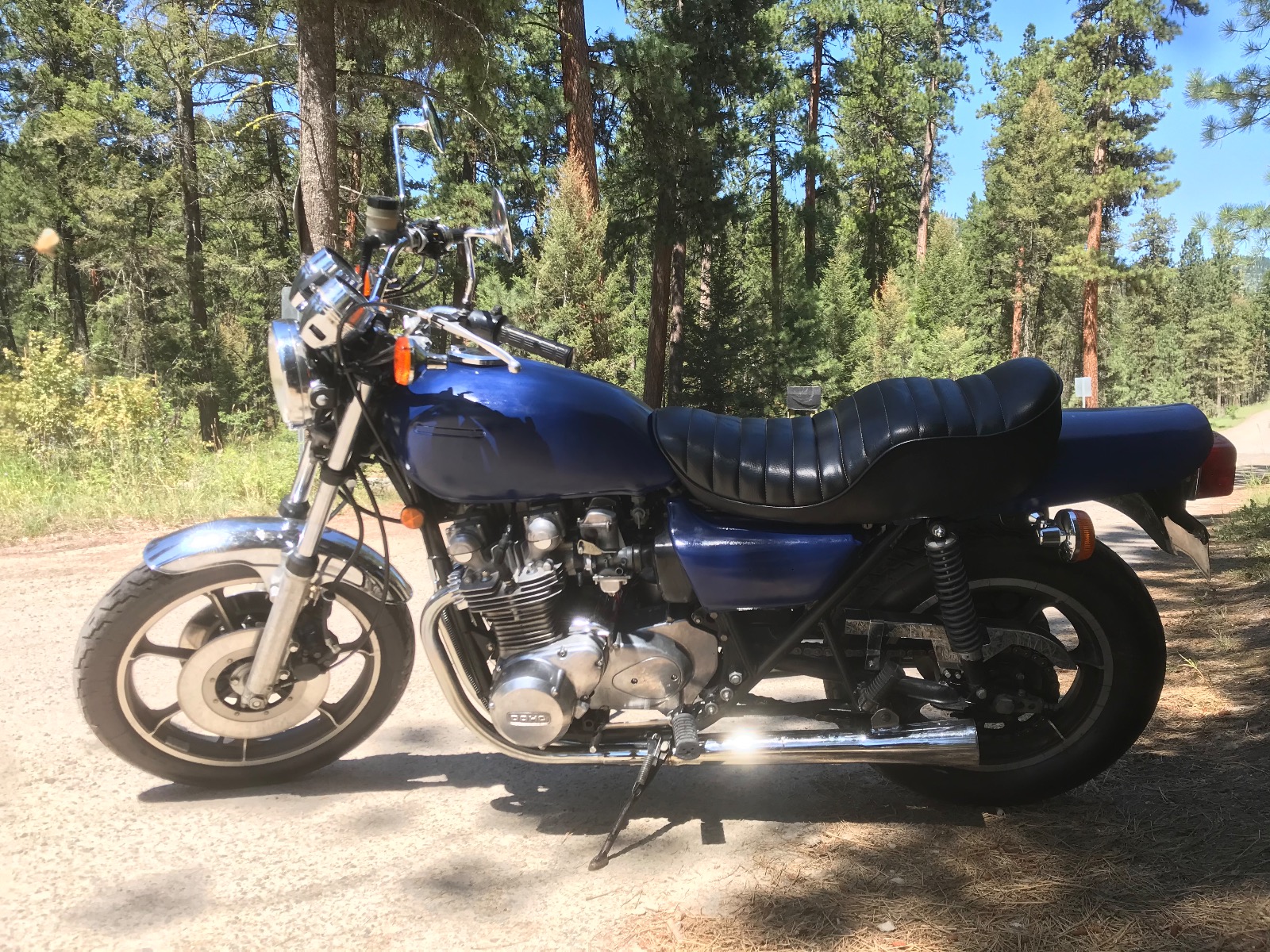

She’s getting really close to earning her badges back
Quick pic of the bike, still haven’t given her a compound/polish/wax treatment yet.

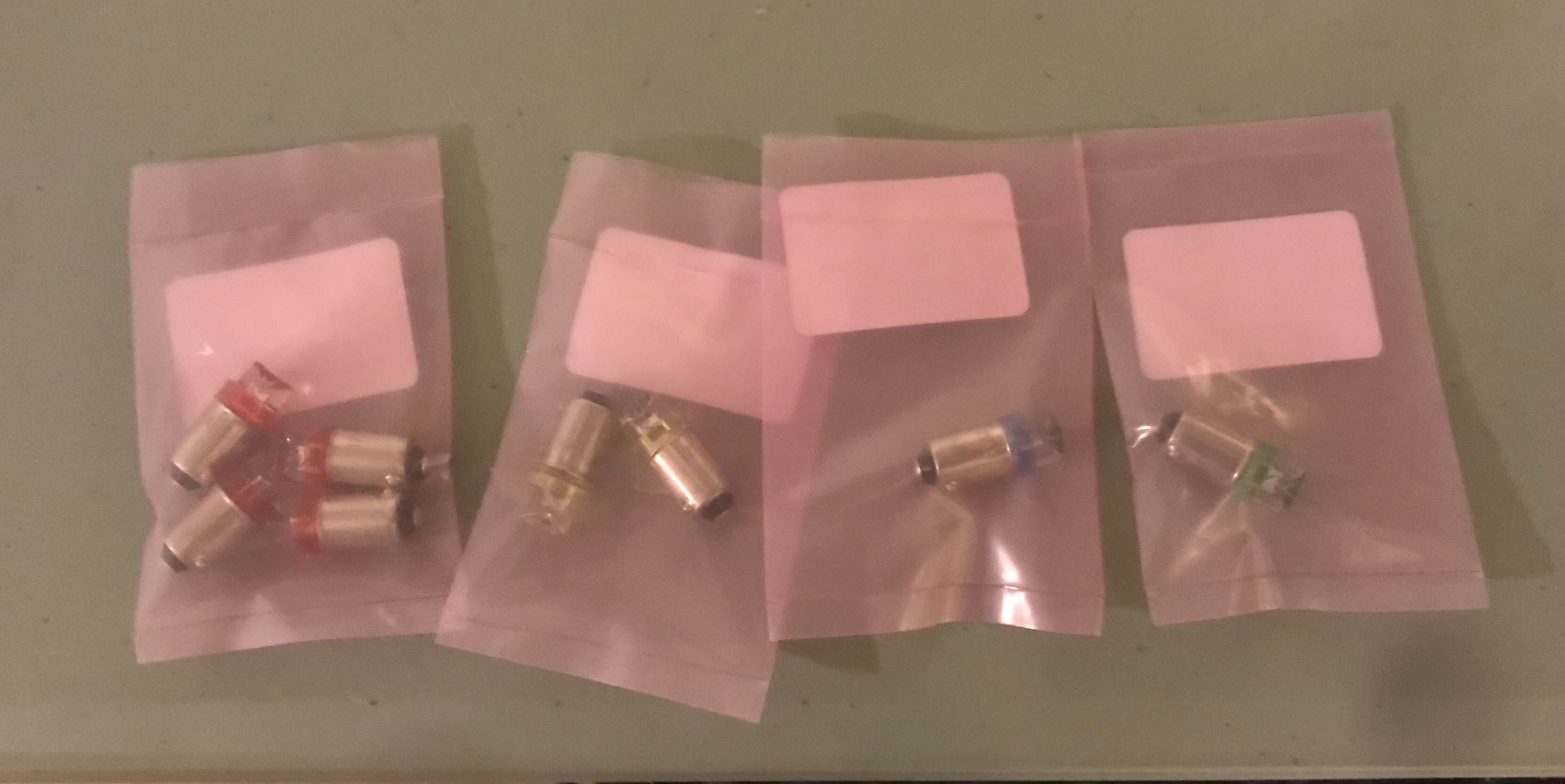

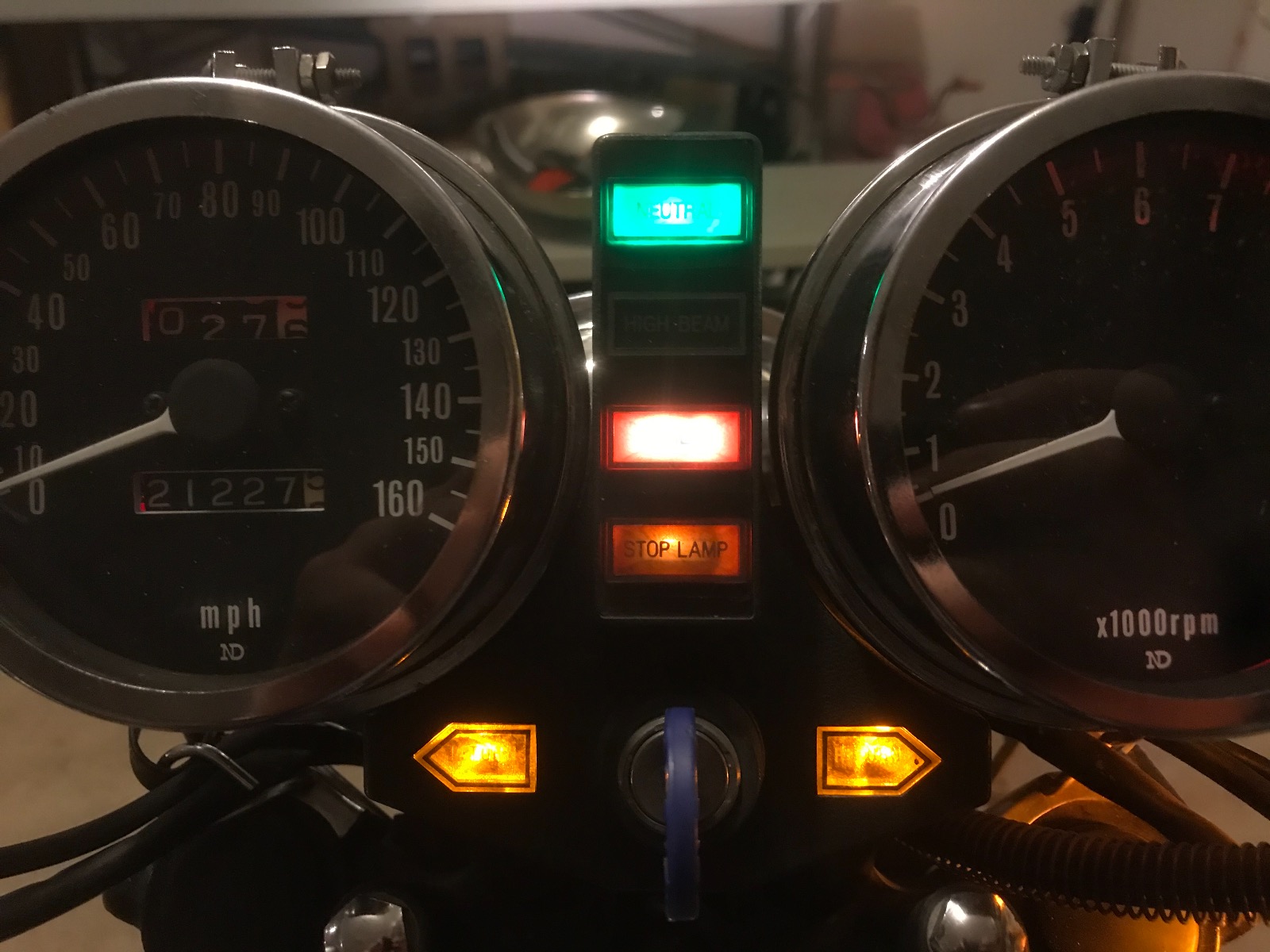

Today was rainy and I just received a shipment of new LEDs for my tach/speedo gauges and the neutral/high/oil/brake lights.
Ordered a few lights with color lenses too.
Ended up learning the joy of the speedo/tach lights, and am really happy that I went with longer lasting LEDs to hopefully not have to open that can of worms again anytime soon.
Ended up putting red lights in the speedometer and tachometer backs, They are subtle but have a nice glow. Matched the neutral/high beam/oil/brake bulbs with the panel lens color.
While I was in there I put a couple amber LEDs on the turn signal indicators.
I’ve left the actual turn signal bulbs, brake light, and headlight bulbs alone as not to mess too much with the amount of power being drawn.
Will have to wait for a night ride to really see how the gauge faces go, but after that job I don’t intend to change them.
(Forgot to turn the high beam on for the picture!)

I ordered them from ‘Super Bright LEDs’ website.
The BA9S bayonet style I ordered are linked here . They come in different colors, and have a 120* beam, and were just shy of $1 a piece.

I just spent last winter converting over to ALL LED's. Just a note of caution, when it comes to instrument and gauge lights, Stay in the warm zone 3000K or they can become to bright and distracting. The 6000K to 7000K are better left for stop and turn bulbs. One other note you can make the bulb appear brighter by using a yellow lens over a yellow/amber bulb or a red lens over a red bulb.
EDIT: Super Bright LED is a great source. Also do you homework on bulb size. I wasted money on bulbs that didn't fit in the center indicator cluster.
