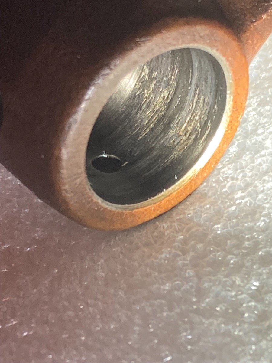

09 Apr 2022 16:34Can you give me some more details one how your cranks were bad. I had to get a different for reasons I don't really want to get into (stupidity) and now I'm concerned...I think we had a wolf in sheep’s clothing here. Look at this guy go. Great work on the 1000. Looking good. I have stalled out on my 76 project looking for a crankshaft. 3 on the bench so far and not one good on. Taking one last chance on used. Another member Wheelhop and I bought some parts in Florida. Wheelhop is driving down the end of this month to pick them up. Fingers crossed.

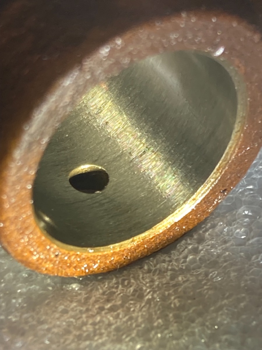

09 Apr 2022 17:04Kay, two of the cranks have bad rod small ends. Galled up and out of spec. The third has notchy bearings. According to Pearson racing it’s commen for a crankshaft that has sat a while. The roller bearings have no inner race, the bearings ride on a machined surface of the crank. The rollers will rust and they will need to be disassembled to properly inspected to determine if the crank surface is good.Can you give me some more details one how your cranks were bad. I had to get a different for reasons I don't really want to get into (stupidity) and now I'm concerned...I think we had a wolf in sheep’s clothing here. Look at this guy go. Great work on the 1000. Looking good. I have stalled out on my 76 project looking for a crankshaft. 3 on the bench so far and not one good on. Taking one last chance on used. Another member Wheelhop and I bought some parts in Florida. Wheelhop is driving down the end of this month to pick them up. Fingers crossed.
Good rod small end
Bad
