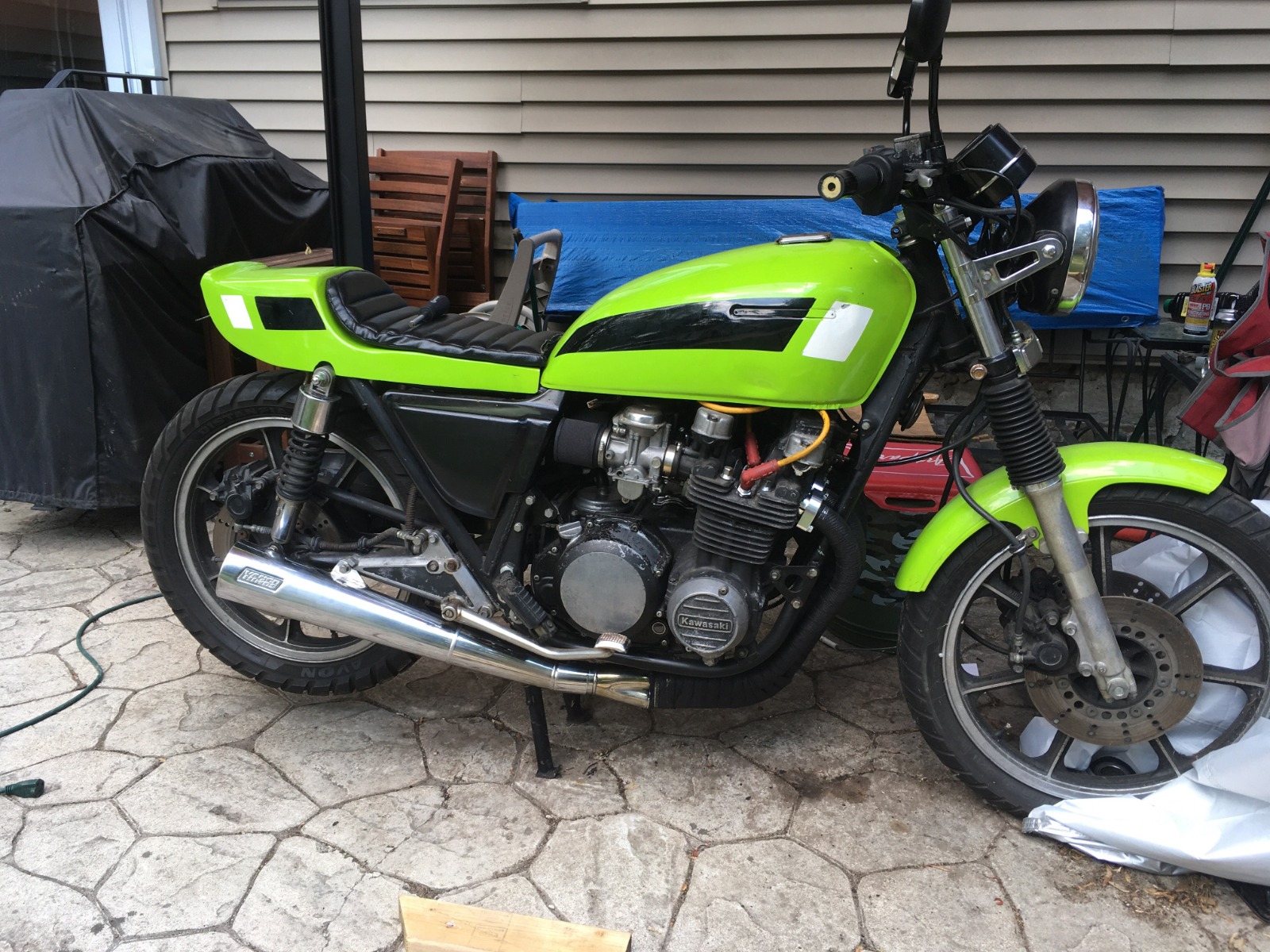

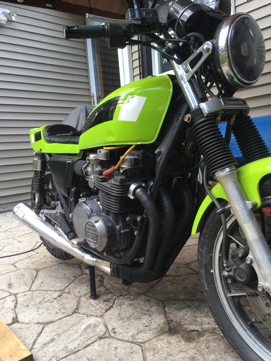

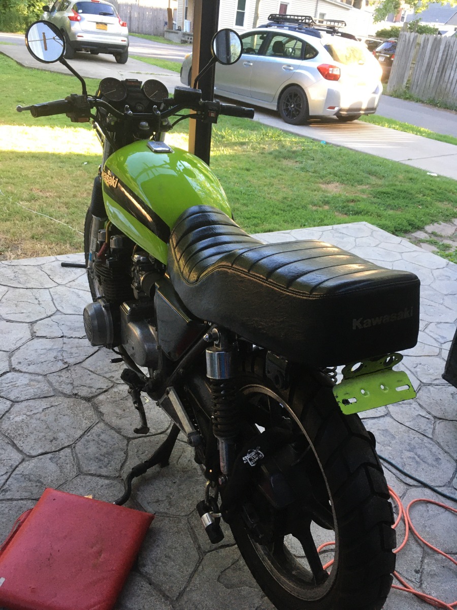

Exhaust re-mount. Happy with how it looks.
Replaced the header flanges with billet aluminums from Z1.

11 Jul 2020 16:39
I am deciding on whether to use header wrap or not myself. Since my project is leaning toward a vintage Superbike theme, I would go with the tan or gray wrap since it looks more like what the racers were using back then. I like your build, and paint scheme, but I have to say it looks a bit incomplete with the existing engine finish. I know how much work is involved with repainting an engine, I am starting down that path with mine at the moment. But the results will be worth the effort. Just my $0.02...

The plan right now is to at least get it rideable before the season is over making some cosmetic modifications along the way, then pulling everything apart and finishing it (engine painting, chassis, touch up body paint) over the winter.
This is a more “as it happens” project thread rather than a retrospective on the finished product.

Re: '82 KZ750-E3 Project - The Green Machine
11 Jul 2020 21:55
I read somewhere the correct way to wrap was bottom up... Help keeps dirt and water out
11 Jul 2020 22:35 - 11 Jul 2020 22:35Mikaw wrote: I read somewhere the correct way to wrap was bottom up... Help keeps dirt and water out
I've read it both ways. From what I understand once the wrap hardens from the heat it shouldn't matter. Only trouble I can foresee running into is debris accumulating in the excess wrap around the very bottom where all 4 join so there's gaps between pipes..... not much I can see to avoid it though.
First time wrapping so we'll see. If it lasts, it lasts. If not, I'll pull it off and just keep the black hi-temp....or maybe bring it back to chrome all the way through.

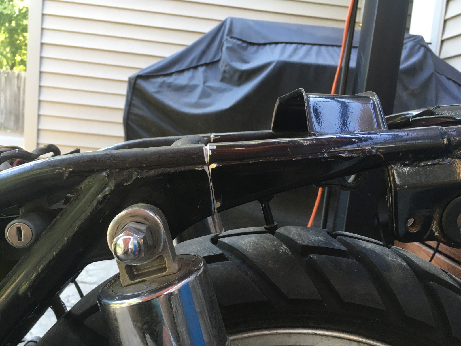

Couple of updates -

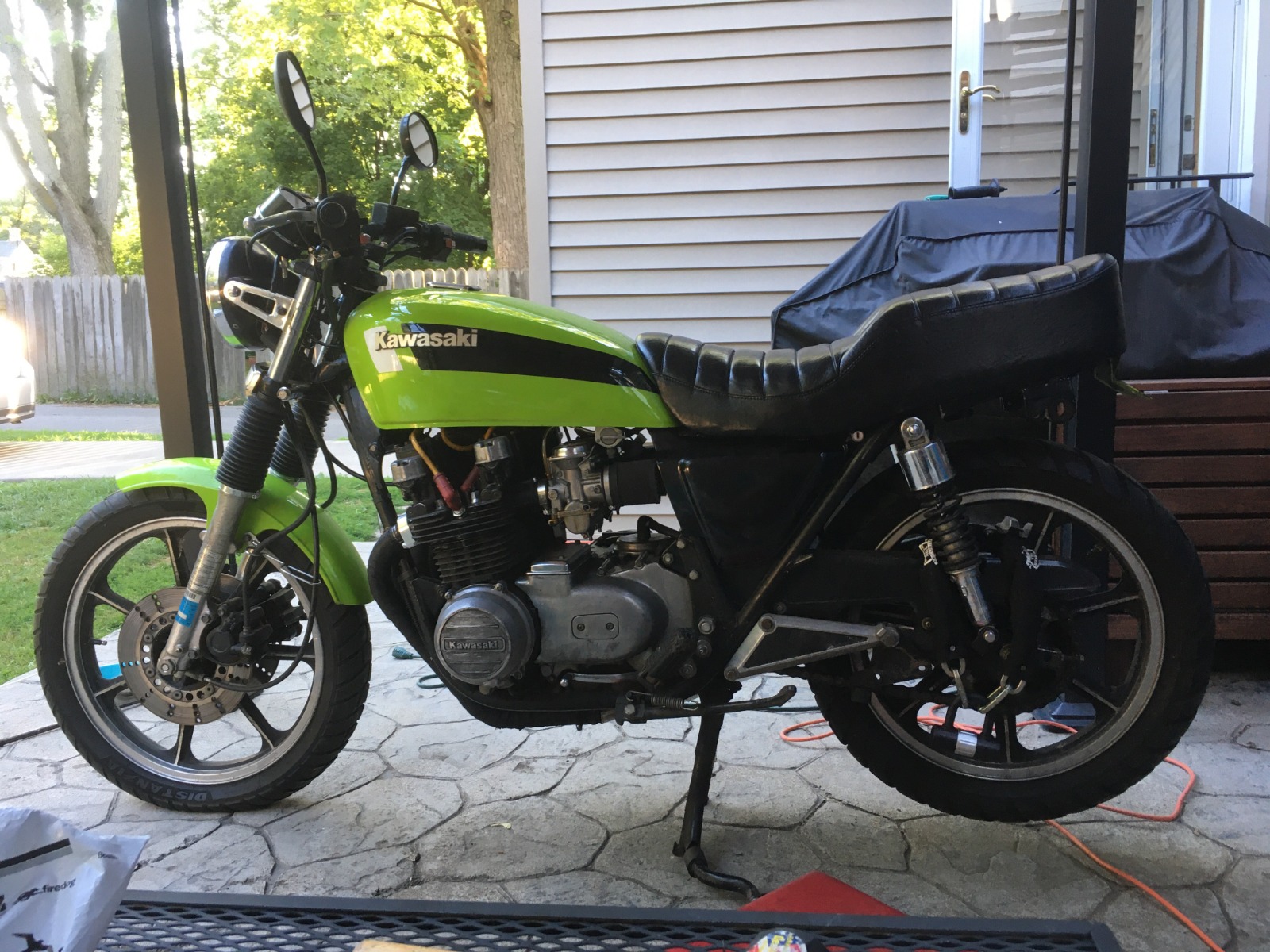

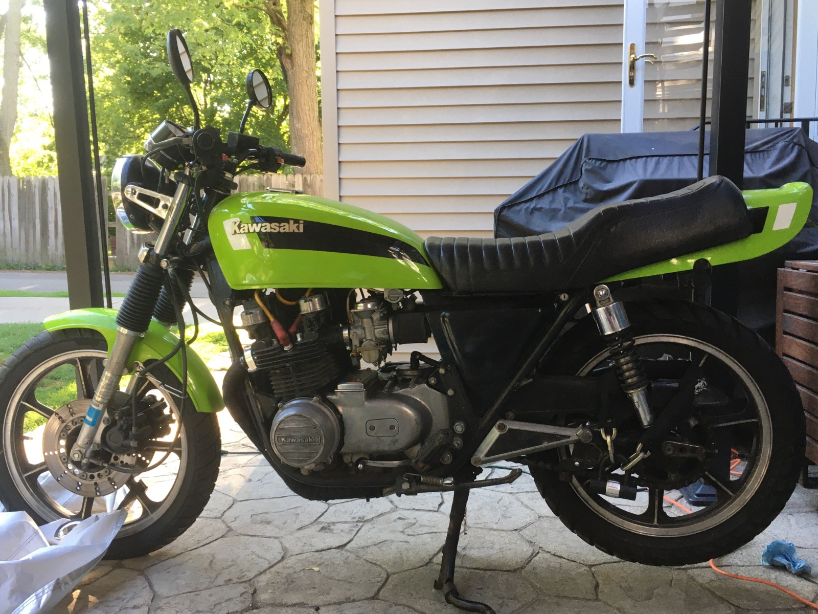

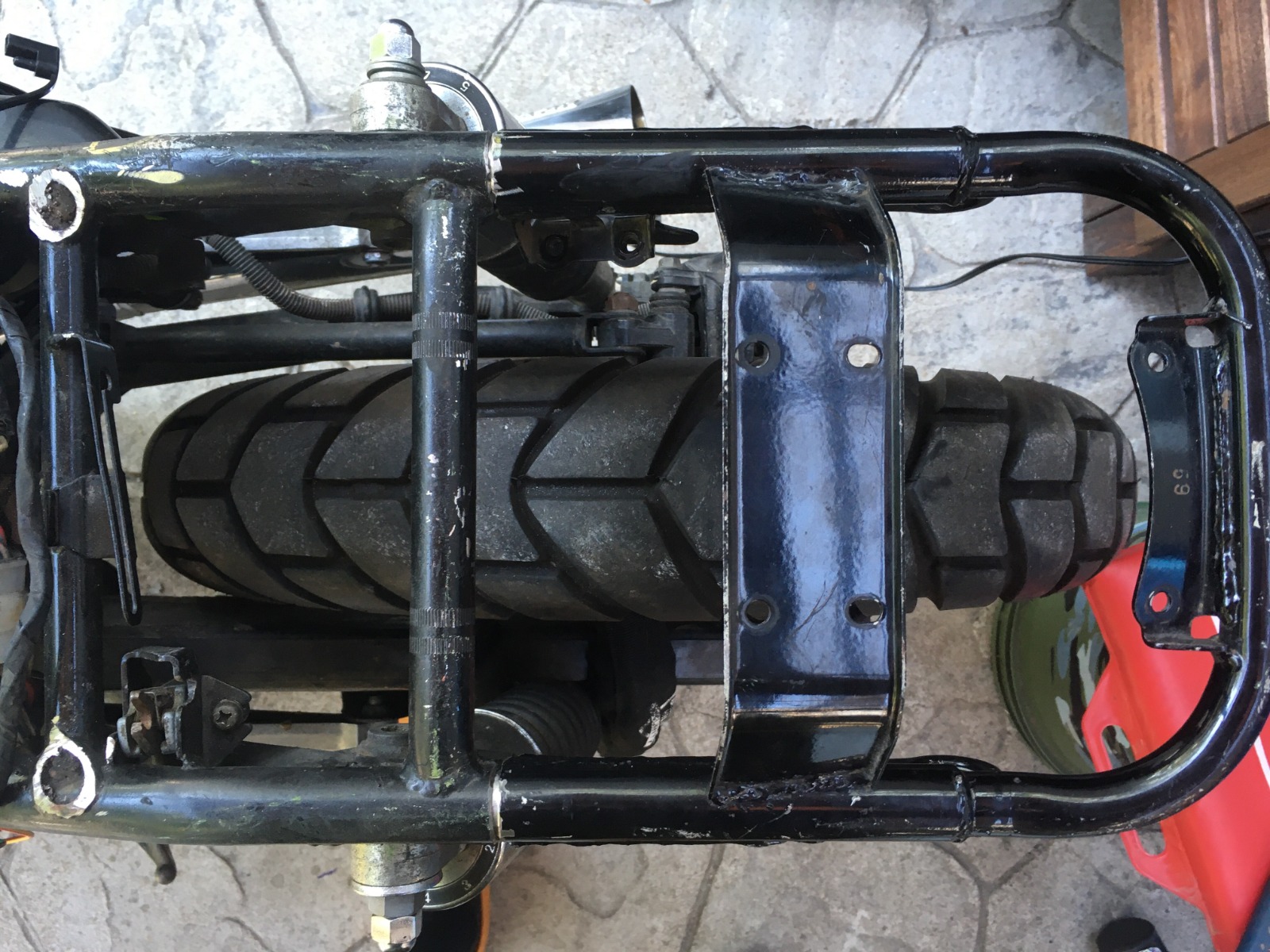

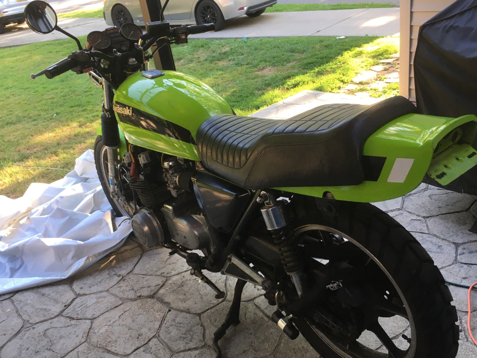

Got the LTD rear end section of my frame cut and lined up to my E base frame and ready to weld on.
Decided to mock up how the bike would look if I decided to keep with the F seat and tail fairing I had - wasn't too bad looking but I wasn't sold on the look. Felt like it made the bike too long up top (and I don't feel like doing a stretch.....right now).
Stumbled upon a compatible LTD seat on eBay and was able to attach it with some convincing at the nose where it rests against the gas tank. Much happier with the second mock up. Will look better once I mount a once piece rear fender in a matching green.
But here it is so far.
14 Aug 2020 17:46
Your frame repair just made my day. Anyone that takes a sawzall to a frame should have their man card revoked!:lol:
14 Aug 2020 18:03Nessism wrote: Your frame repair just made my day. Anyone that takes a sawzall to a frame should have their man card revoked!:lol:
Thanks!I wasn't sure about how the E / LTD would mesh but so far so good. I'm thinking I am going to need to remove that extra cross support just before the original cut so that I can fit the fender.
14 Aug 2020 18:24
I hope you remove all of the paint from the heat affected zone. You can't get the metal clean enough for a quality weld. After you clean it, clean it again...
