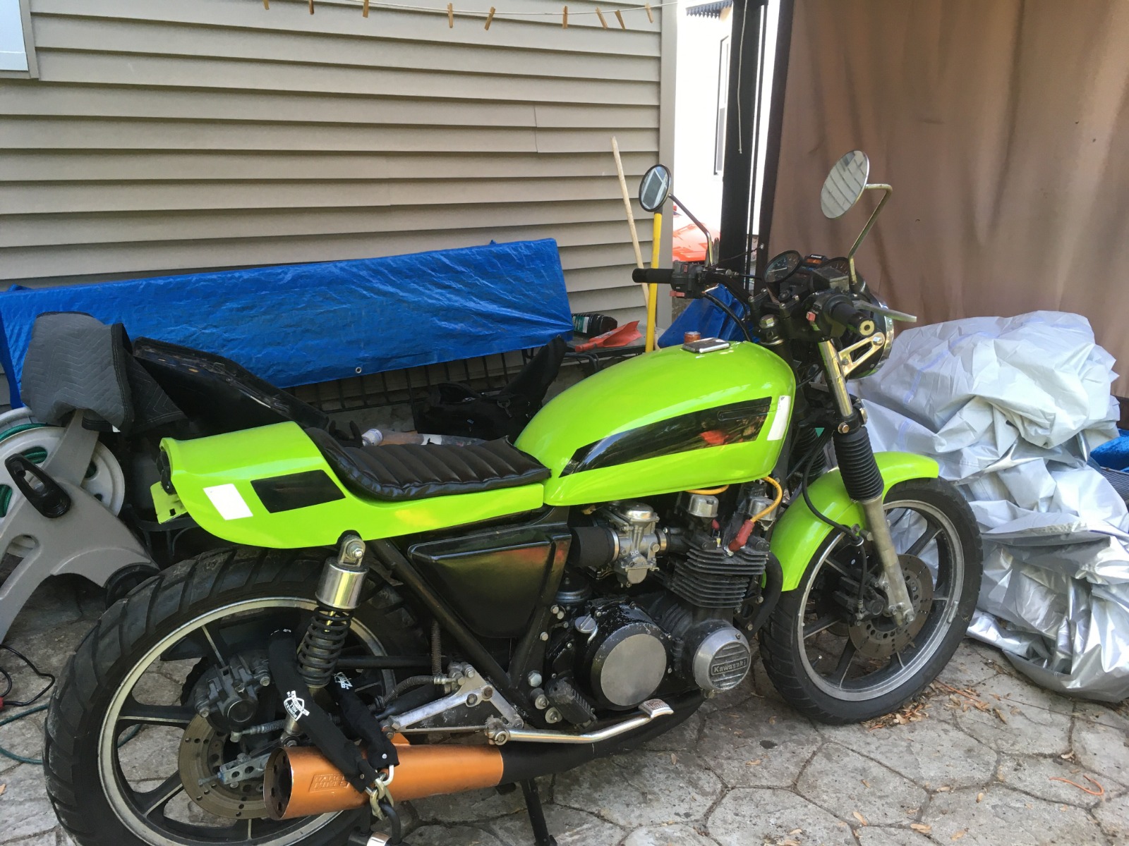

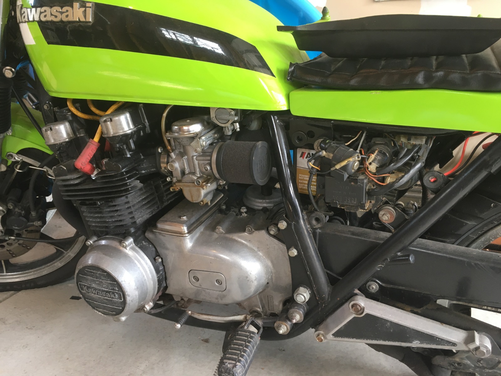

I picked up this 1982 KZ750-E3 from a friends garage a couple weeks ago. This is my first bike, ever. After comparing the current and original odometers, bike has ~19200 miles on it. The plan is to get it running (hadn't been started in ~2 years) and do some body modifications of my own to bring it back to a stock-ish look. Before it was mine it had already been upgraded with pod filters, LED headlight, tail lights, turn signals, and low profile tach- and speedometer. The tail portion of the frame was hacked off just past the shock mounts and welded with a cross bar. A rear fairing was fabricated over the original and the mounting points were modified to accommodate. The seat is thin and "fastened" to the fabed bodywork with glue and velcro (I shit you not) that has since melted and failed.
I've gotten it to start and run for 8-10 seconds, after lots of carb cleaner and starter fluid spraying.
Killed my solenoid, will be replacing.

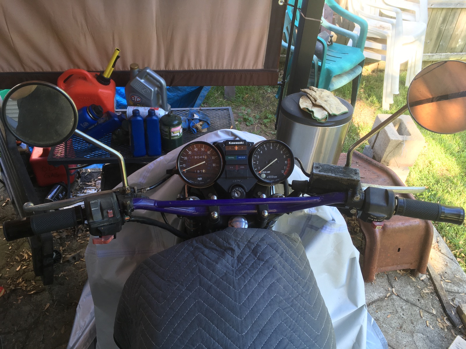

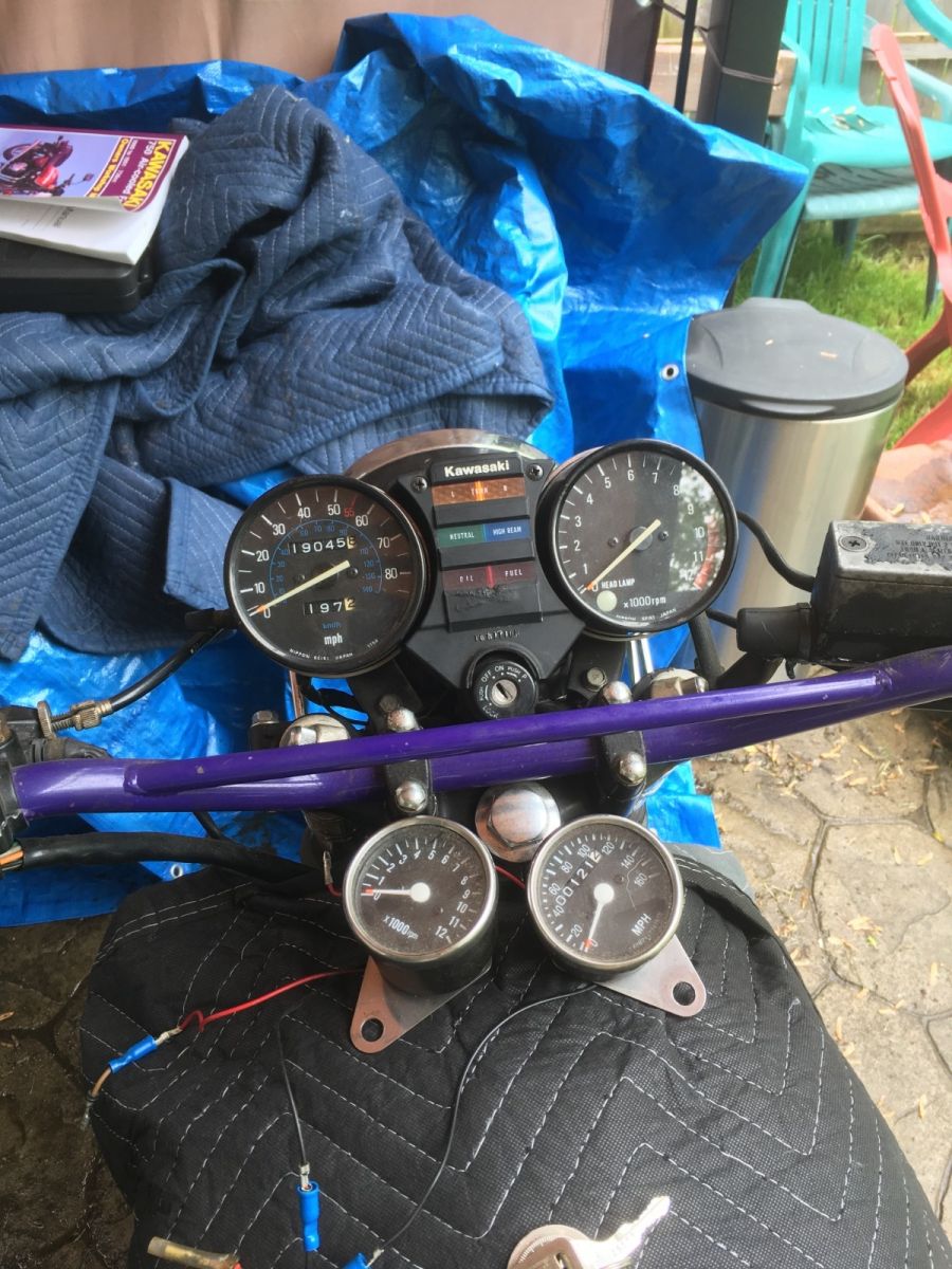

The guy I got it from gave me a box full of original and spare parts he had laying around, so I reinstalled the original tach/speed display because I like bulky things with lots of lights (was also my first foray into the mess that is the wiring).

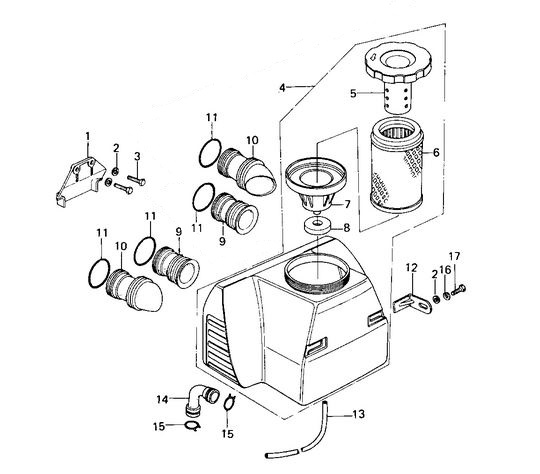

@650ed in your "not so humble opinion" how big of a deal would it be to revert back to the OEM airbox (which I have in the box)? I'm assuming not as easy as just sticking back onto the carbs as they were rejetted to accomodate the pod filters. I am open to any and all advice because I really do want to learn as much as I can and enjoy getting the most I can out of this bike!

29 May 2020 19:49Mr_Blonde wrote: @650ed in your "not so humble opinion" how big of a deal would it be to revert back to the OEM airbox (which I have in the box)? I'm assuming not as easy as just sticking back onto the carbs as they were rejetted to accomodate the pod filters. I am open to any and all advice because I really do want to learn as much as I can and enjoy getting the most I can out of this bike!
If you already have the airbox I don't think switching back would be too much trouble. Aside from returning the carb jetting to stock, you would need the airbox to carb boots and the spring rings that hold them to the carbs, the two little metal brackets that attach the side of the airbox near the back to the frame, the little hose that connects the airbox to the engine breather, and depending on whether or not you already have it the round gixmo (#7) that sits inside the bottom of the airbox and holds the bottom of the filter in place. Of course you also would need the stock filter. It sound like you already have the had part (the airbox). I think many if not all the bits an d pieces are available on eBay. The image below may help my description. Ed

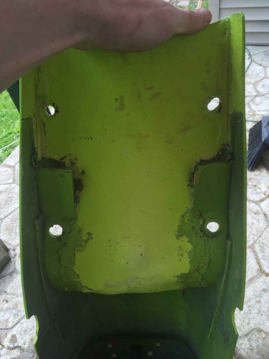

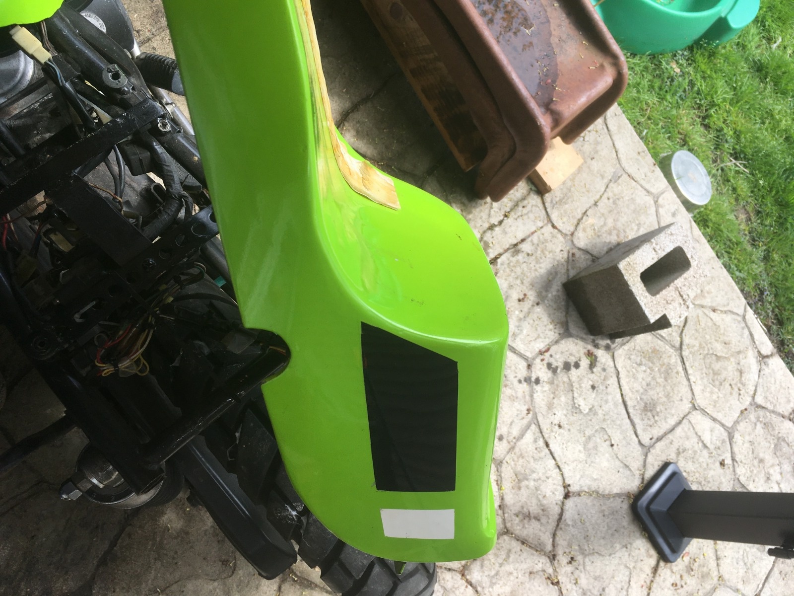

Replaced the purple handle bars with black Emgo Superbikes. Found a 750F seat on eBay, have the dampers, hinge pins and what not ordered. I did some of the “aftermarket” mounting points for the old seat and cowling. Also have a rear cutoff section of frame on route as a donor for the mounting points and support that we’re cutoff.

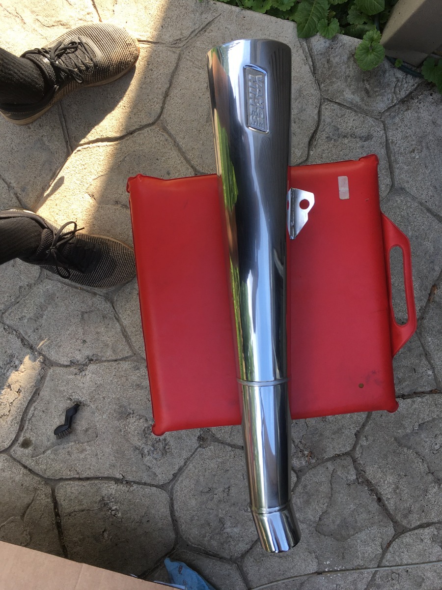

09 Jul 2020 17:12Next step in the project was modding the exhaust while also fixing a leak at the header (found out only two of the headers had the copper gaskets in place >_<
Previous owner (or previous previous owner) had spray can'd the Vance & Hines exhaust orange....I don't know why. But some aircraft grade spray on paint stripper took care of that and brought it back to OE chrome - much better in my opinion. Tried to decide what to do with the down pipes. Did some research on exhaust wrapping, the pros and cons.
Decided to do it, if only for cosmetic purposes only. Some said it helps keep heat away from the rider, but the pipes are routed such that they aren't close enough to my feet/legs for that to be an issue (at least I don't think). Then there's the camp that says it helps keep excess heat from coming back to the engine (and by doing so increasing horsepower). I don't necessarily buy into that, but if that truly is the case cool, its a plus in my book.
I think it looks cool. It's my first attempt at it. I'm sure I made some mistakes. The ladder ties I used seemed pretty shitty....hard to tighten securely enough without excessive coercion..... might end up buying some standard screw hose clamps from Home Depot if they fail.
