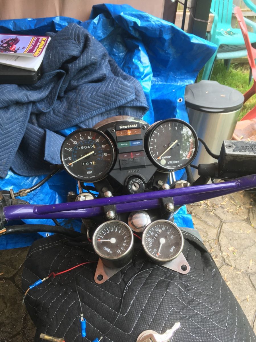

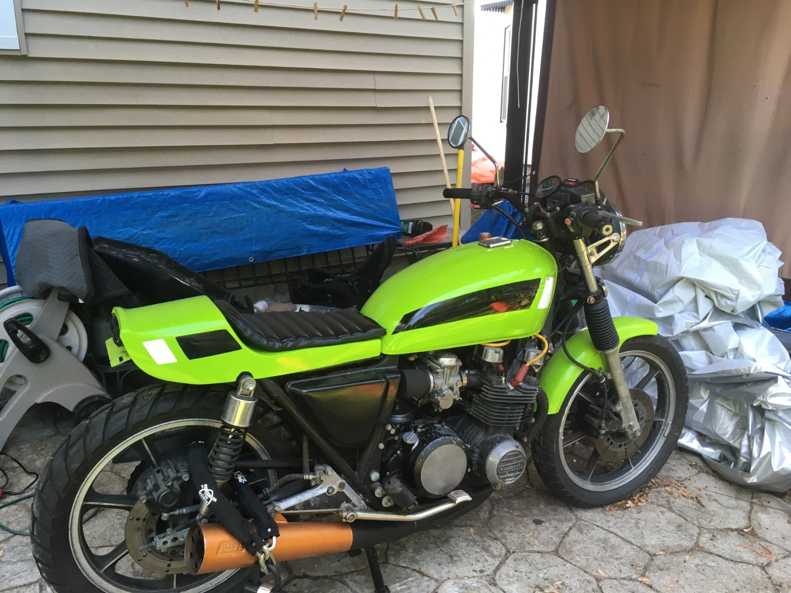

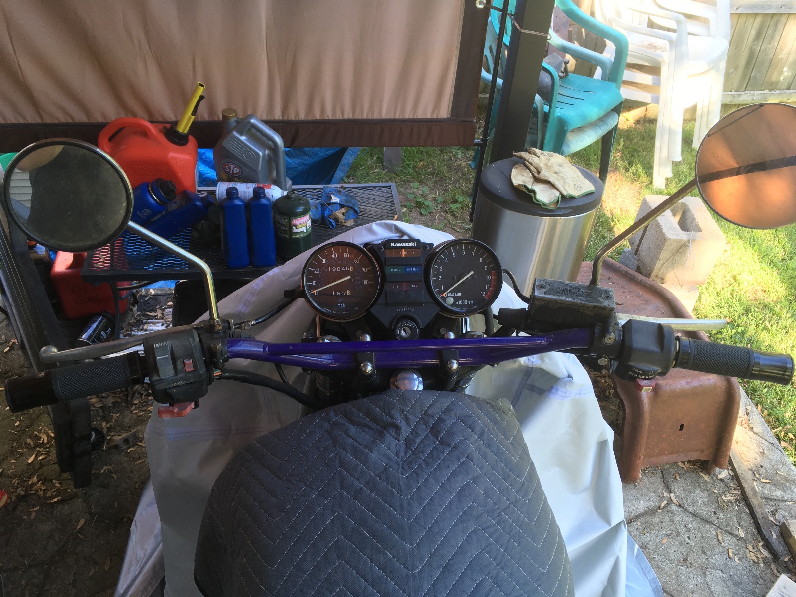

I picked up this 1982 KZ750-E3 from a friends garage a couple weeks ago. This is my first bike, ever. After comparing the current and original odometers, bike has ~19200 miles on it. The plan is to get it running (hadn't been started in ~2 years) and do some body modifications of my own to bring it back to a stock-ish look. Before it was mine it had already been upgraded with pod filters, LED headlight, tail lights, turn signals, and low profile tach- and speedometer. The tail portion of the frame was hacked off just past the shock mounts and welded with a cross bar. A rear fairing was fabricated over the original and the mounting points were modified to accommodate. The seat is thin and "fastened" to the fabed bodywork with glue and velcro (I shit you not) that has since melted and failed.
I've gotten it to start and run for 8-10 seconds, after lots of carb cleaner and starter fluid spraying.
Killed my solenoid, will be replacing.
The guy I got it from gave me a box full of original and spare parts he had laying around, so I reinstalled the original tach/speed display because I like bulky things with lots of lights (was also my first foray into the mess that is the wiring).
Ultimately I plan on keeping the lime green color. I want to put a stock-ish two person seat back onto it so I might find a donor frame cutoff to rebuild the back of the frame. Not sure if I want to keep the tail fairing or if I want to go the minimalistic route with just a rear fender.

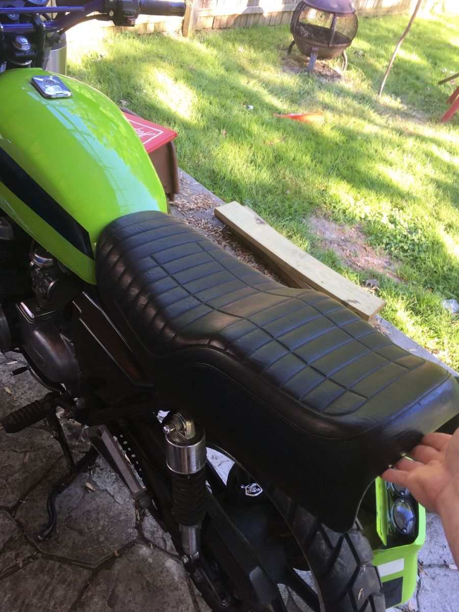

Looks like you have your work cut out for you in regards to that seat. Velcro? Lord have mercy! Finding a decent 750E seat can be a challenge. Same for tanks, but it looks like you are good in that regard.

I found a replacement '81 KZ750e seat on fleabay. Be careful, check the bottom view of the pan. Many said they had "e" seats when they weren't. And the "no rust holes" seat I received had areas completely eaten through.

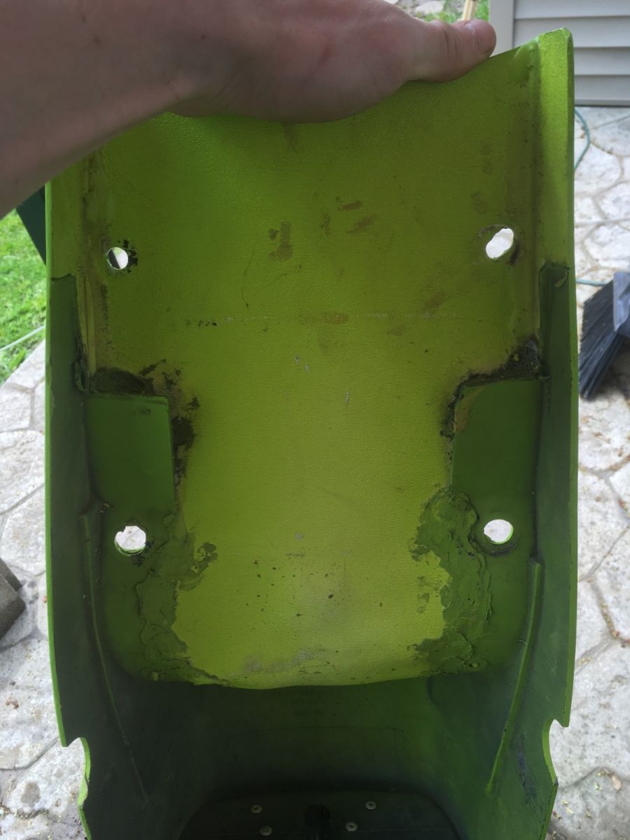

Replaced the purple handle bars with black Emgo Superbikes. Found a 750F seat on eBay, have the dampers, hinge pins and what not ordered. I did some of the “aftermarket” mounting points for the old seat and cowling. Also have a rear cutoff section of frame on route as a donor for the mounting points and support that we’re cutoff.

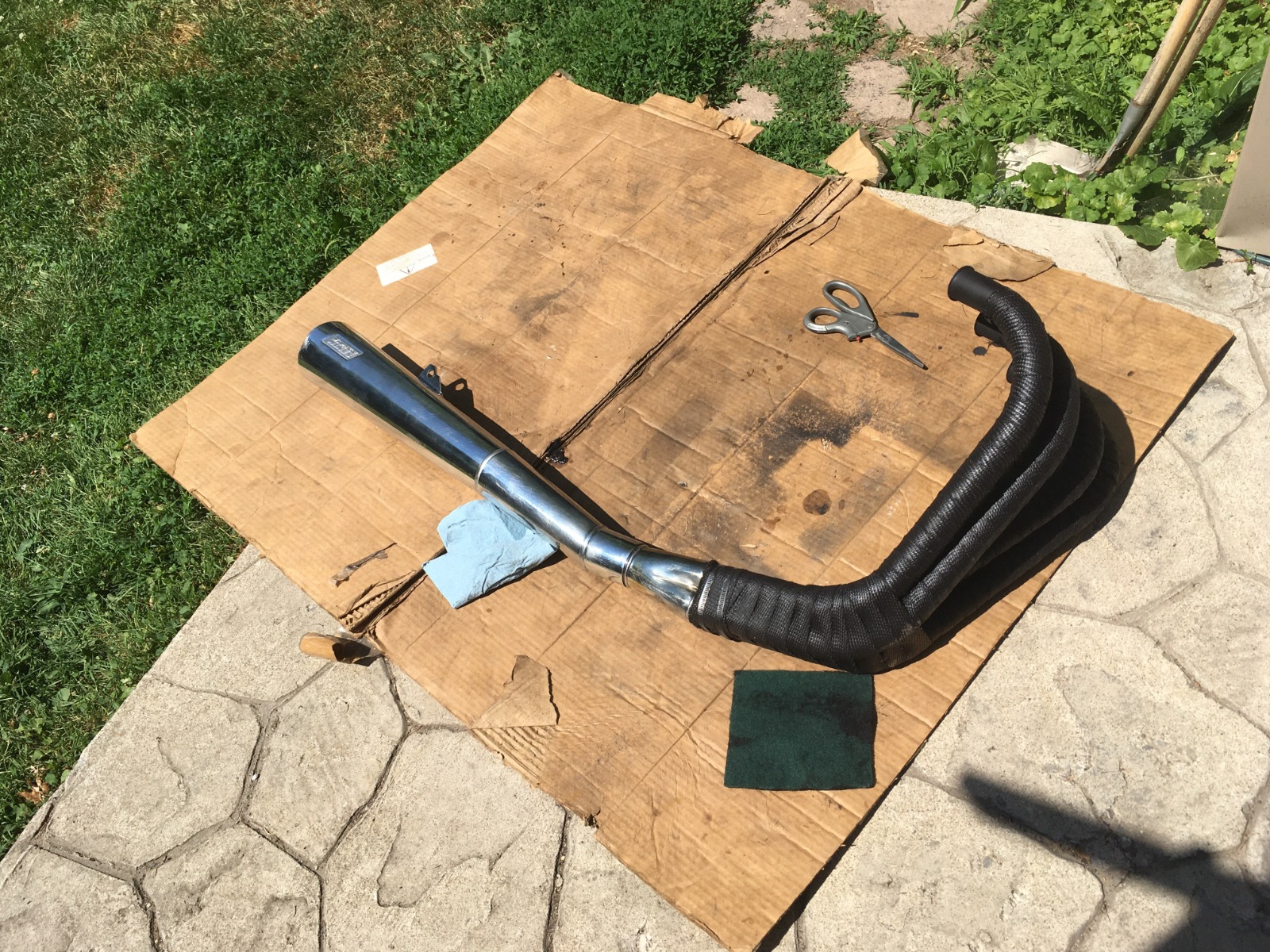

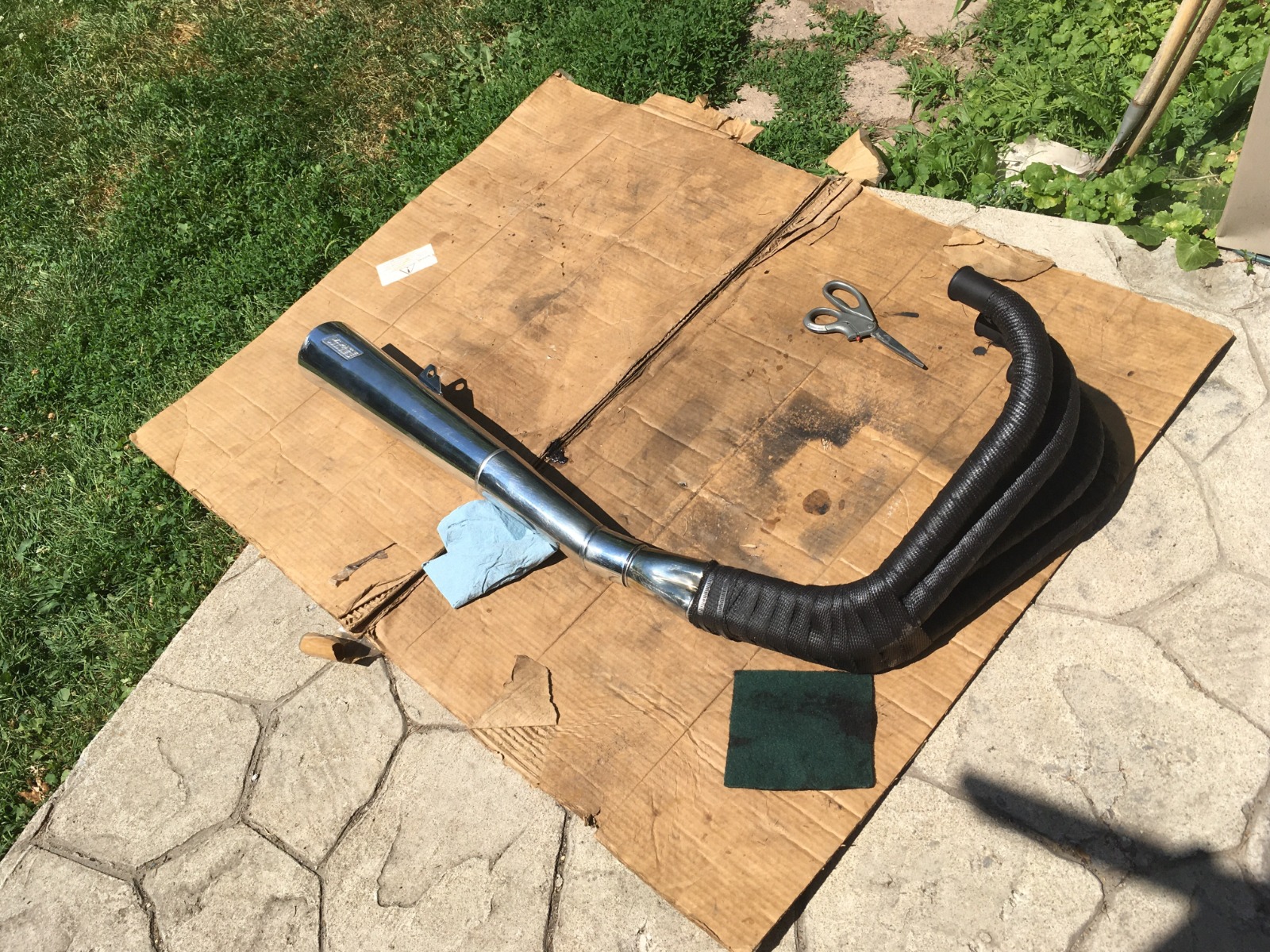

09 Jul 2020 17:12Next step in the project was modding the exhaust while also fixing a leak at the header (found out only two of the headers had the copper gaskets in place >_<
Previous owner (or previous previous owner) had spray can'd the Vance & Hines exhaust orange....I don't know why. But some aircraft grade spray on paint stripper took care of that and brought it back to OE chrome - much better in my opinion. Tried to decide what to do with the down pipes. Did some research on exhaust wrapping, the pros and cons.
Decided to do it, if only for cosmetic purposes only. Some said it helps keep heat away from the rider, but the pipes are routed such that they aren't close enough to my feet/legs for that to be an issue (at least I don't think). Then there's the camp that says it helps keep excess heat from coming back to the engine (and by doing so increasing horsepower). I don't necessarily buy into that, but if that truly is the case cool, its a plus in my book.
I think it looks cool. It's my first attempt at it. I'm sure I made some mistakes. The ladder ties I used seemed pretty shitty....hard to tighten securely enough without excessive coercion..... might end up buying some standard screw hose clamps from Home Depot if they fail.
