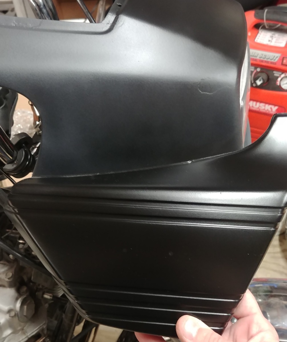

Side covers were painted and cleared yesterday. Tank got another layer of color, and the fairing got 2 layers today. I'm back to work tomorrow (thank god) so updates are gonna be slow (boo).
Now I just have to decide on decals for the tank.

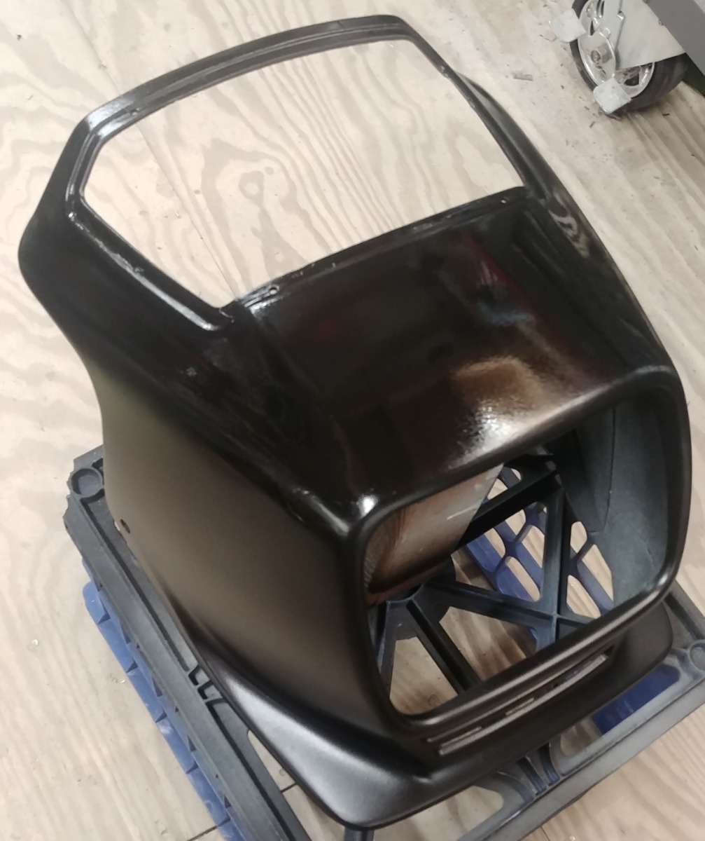

17 Aug 2020 06:58 - 17 Aug 2020 06:59 #833083 by Peanuthead
Replied by Peanuthead on topic 81/82 KZ440 Project RUSTY
I went to clear coat the fairing the other day and found out the paint "fogged" because of the humidity.
Grrrr. Good thing I have more matte black. Waiting for the paint to dry today before I shoot it with clear.

19 Aug 2020 11:26 #833215 by Peanuthead
I sanded off the last coat of paint, sprayed it again, and let it dry. Turned out nicely. Went to shoot the clear coat, the clear coat started to lift. Grrrrrrrrrrr.
19 Aug 2020 14:20 #833233 by Kaylinator
Replied by Kaylinator on topic 81/82 KZ440 Project RUSTY
How long did you give it between paint and clear?

19 Aug 2020 15:08 - 19 Aug 2020 15:36 #833240 by Peanuthead
Honestly, it was like 3 days because of work and the weather.

19 Aug 2020 15:36 #833244 by Kaylinator
I kinda figured. Clear usually needs to be sprayed within 24 hours of base coat, and the sooner the better. I found about 30 minutes works best.

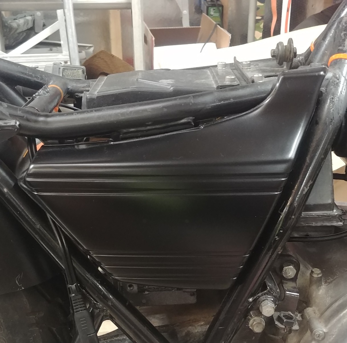

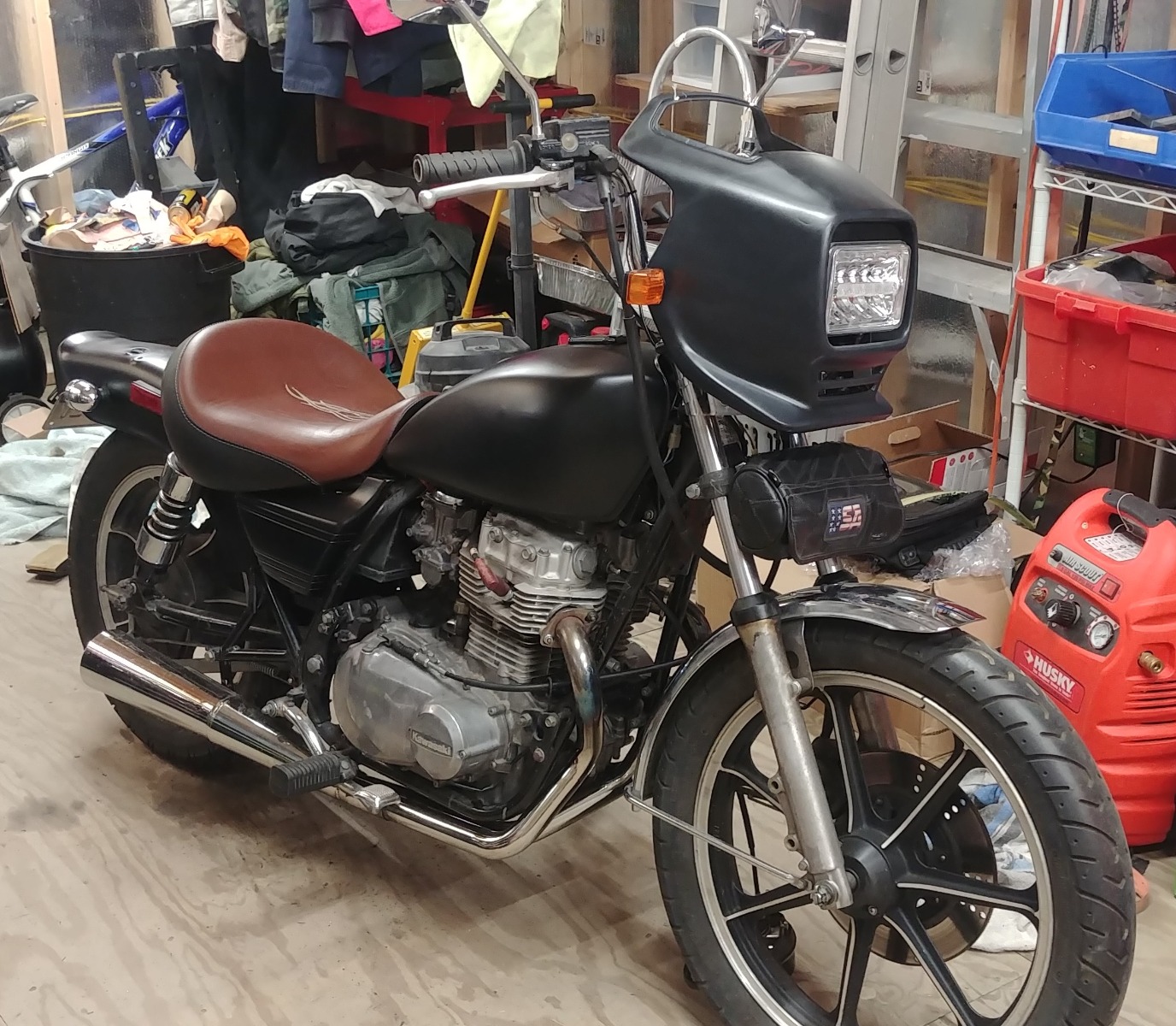

23 Aug 2020 07:18 #833542 by Peanuthead
The paint on the fairing fogged up again. I wish I had an actual paint booth to spray in. Well, another night of sanding and painting. Sprayed the tank again too. Hope to clear them both today. But before I did, I finished making a rear seat mount and mocked everything up. I really love the way this has turned out.
