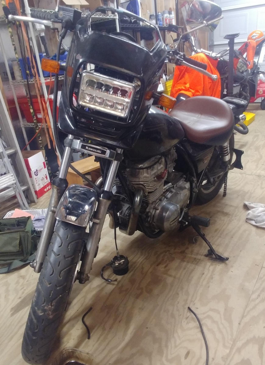

It's alive!!!!!!
Well, almost. I didn't have any fuel line so I couldn't get her to run. But, after sitting since 2013, I'm EXTREMELY happy!
Today I'll be picking up some oil, filter, and fuel line to hopefully take her for a spin ina few days.

She's running!!!! I'm so freaking happy! I do need to rebuild the carbs. Cyl 2 (rt) is leaking from the bowl, have to fix the main fuel line, and set the idle.
And by chance, does anyone know who makes custom speedo & tach cables? The ones I have are too short.

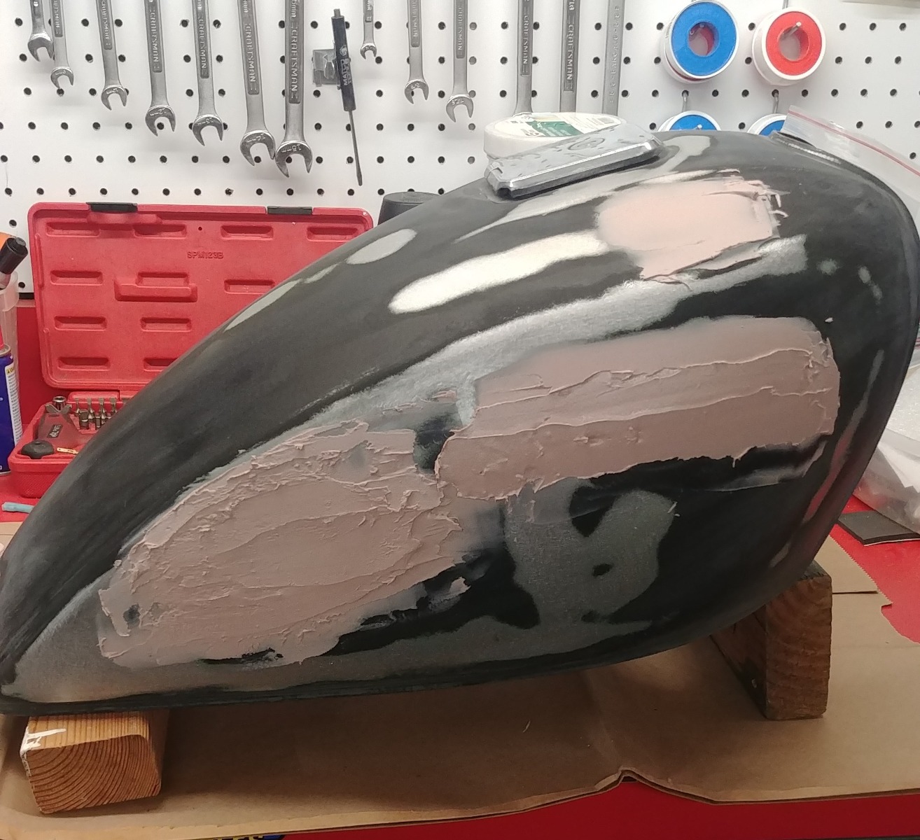

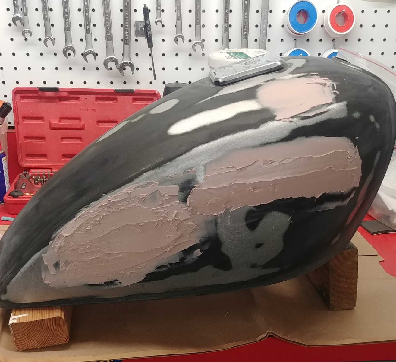

Last night was body work night. I should have used a normal sized spreader instead of the small one for the side of the tank. I didn't take a picture after I sanded but I do need to add another thin layer. More body work tonight.

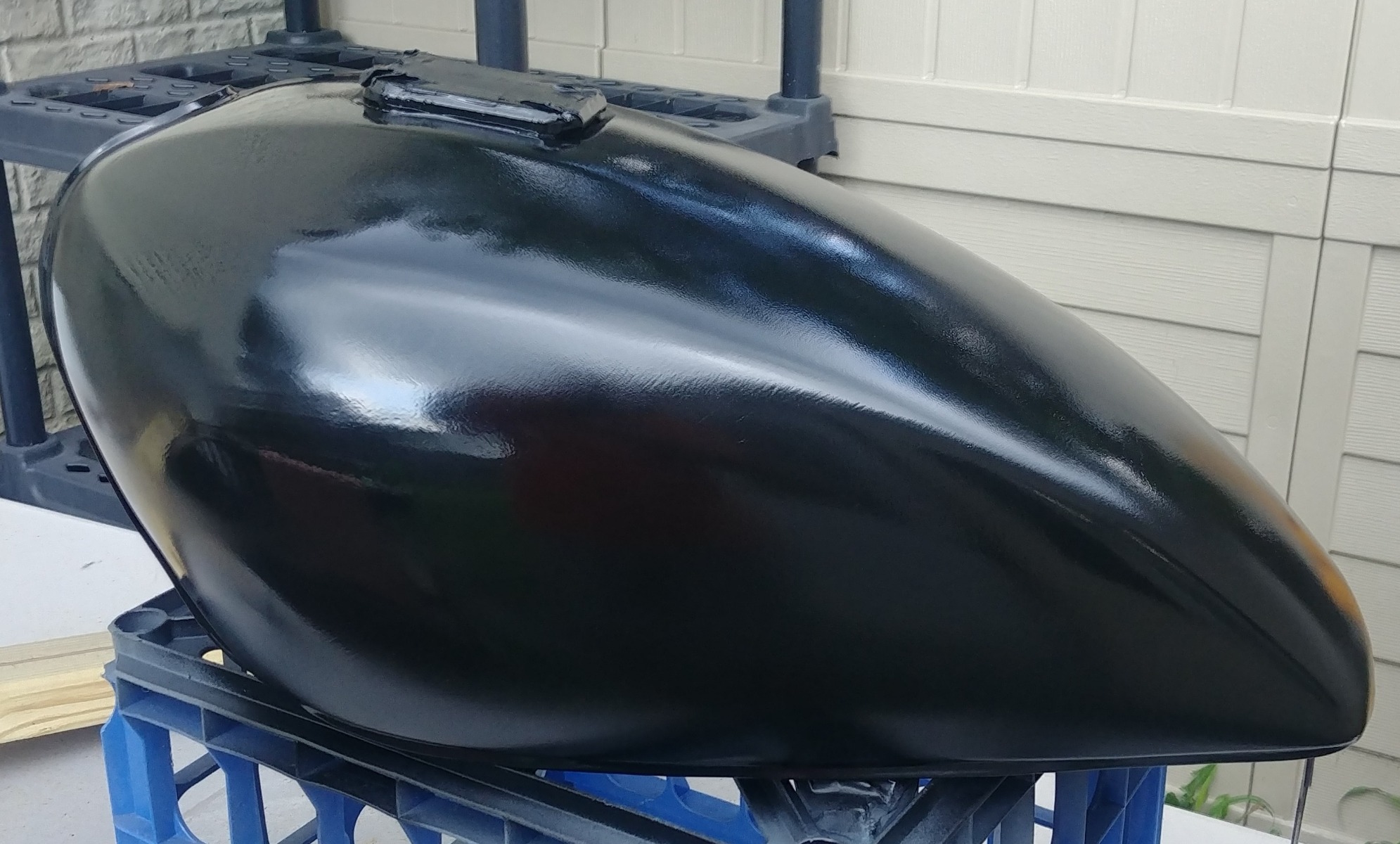

Finished the body work and laid down primer last night. Hoping to lightly sand the tank and a second coat of primer.

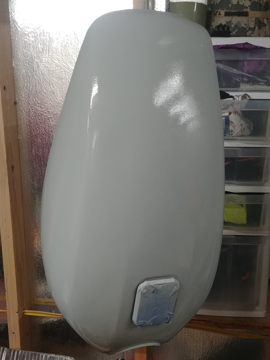

09 Aug 2020 07:41
#832470
So the primer lifted on the entire left side of the tank. A little disappointed at myself but I haven't done body work like this in almost 15 years. So a little extra time sanding and cleaning before shooting another coat of primer. Hoping to do a light sanding then spray the first layer of color. Fairing was prepped for primer last night and the side covers were painted. I think one will have to be reshot because I think theres a run in the paint.

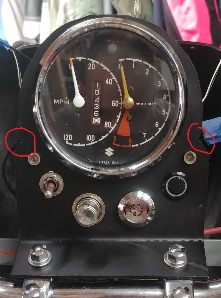

And I'm gonna design a third cluster since I'm not gonna run the Suzuki dual gauge.

Just a friendly pointer here - when making things out of metal, never leave sharp inside corners (see red circles). These are stress risers and cracks will develop. A better method would be to drill a hole and cut tangent to the hole, leaving a smooth inside radius. Good job getting the bike running!

Thanks for the reminder. If I use that set up I'll fix those.

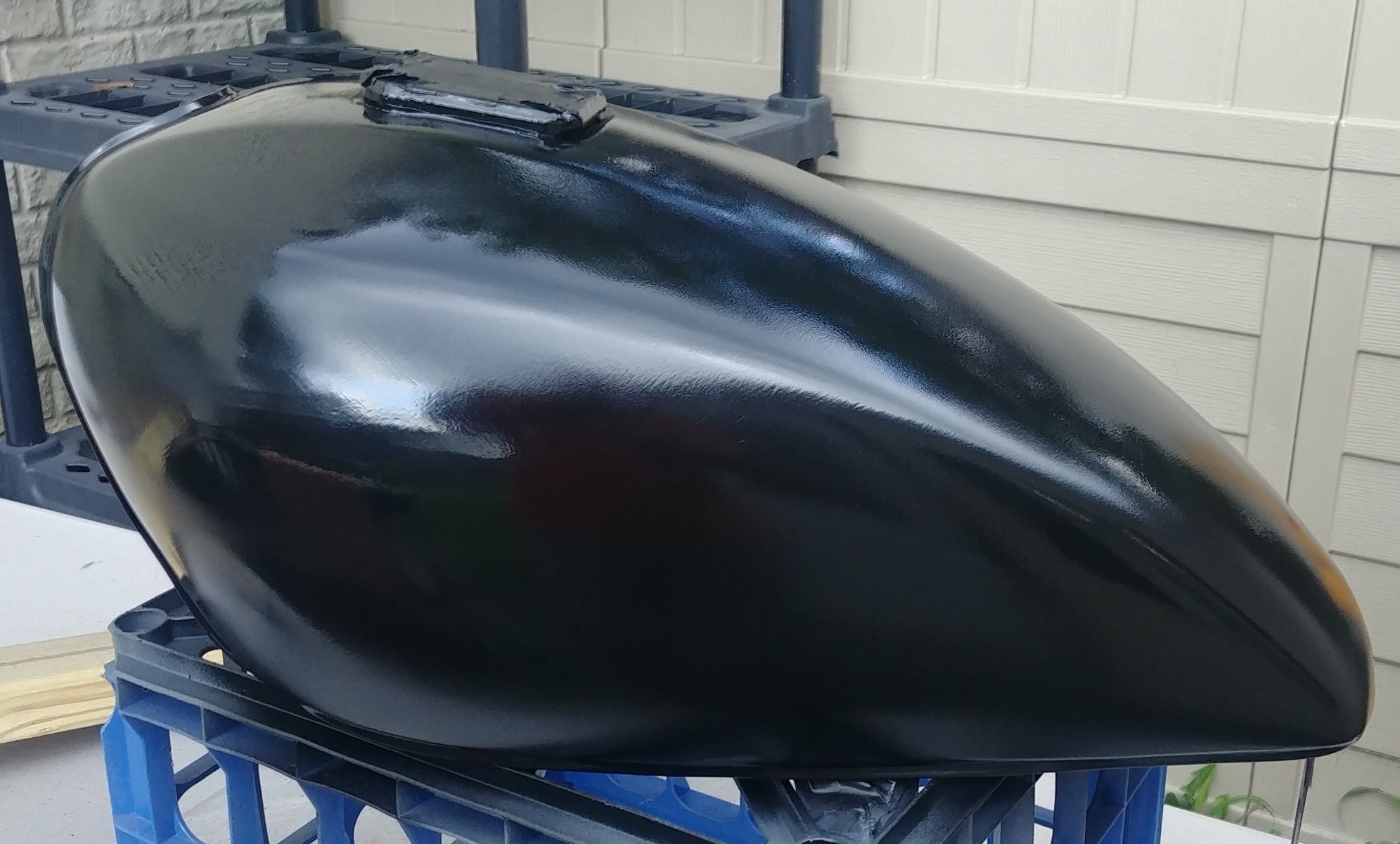

  • Peanuthead
  • Peanuthead's Avatar Topic Author
  • Posts: 90
  • Thanks: 4
Re: 81/82 KZ440 Project RUSTY
09 Aug 2020 13:24
#832498
Rattle can matte black. I need to lay down one maybe 2 more coats then the matte clear before this is done. Side covers look good, so they got a nice coat of matte clear. The fairing is gonna be next.
