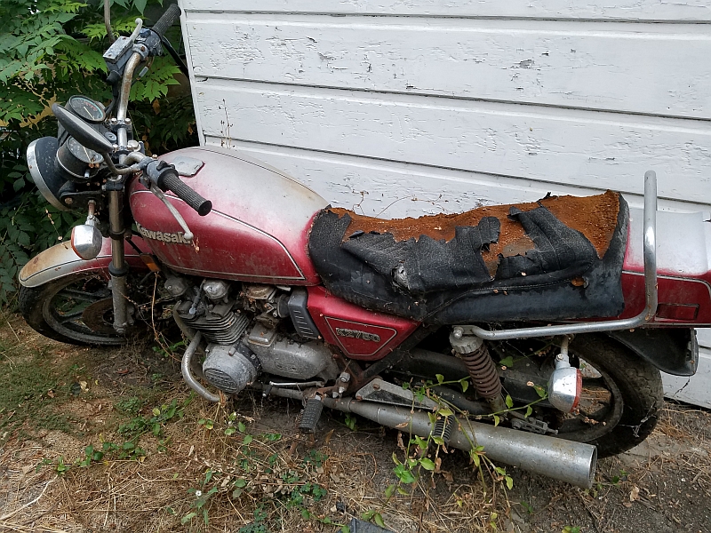

So I pulled my old KZ750E out of a shed that it had languished sadly in for the past several years.
I felt really guilty as I bought this bike brand new and it was like I had mistreated an old friend.
Its also been a few years since I have been active on here and looking through the forums I am glad to see so many of you all restoring and taking care of these bikes.
She is pretty rough but there is life still in the old girl and its going to be put back into safe riding condition again.

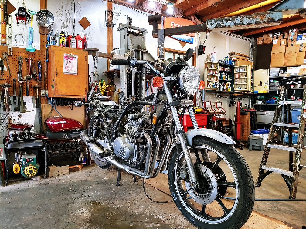

Here she starting the process hanging from my car lift which makes it handy for working on.
Surprisingly or not she fired up with the addition of fresh gas although the carburetors are leaking.
Front master cylinder is pretty bad, the rear flushed out and seems to be working.
Going to need fork seals.

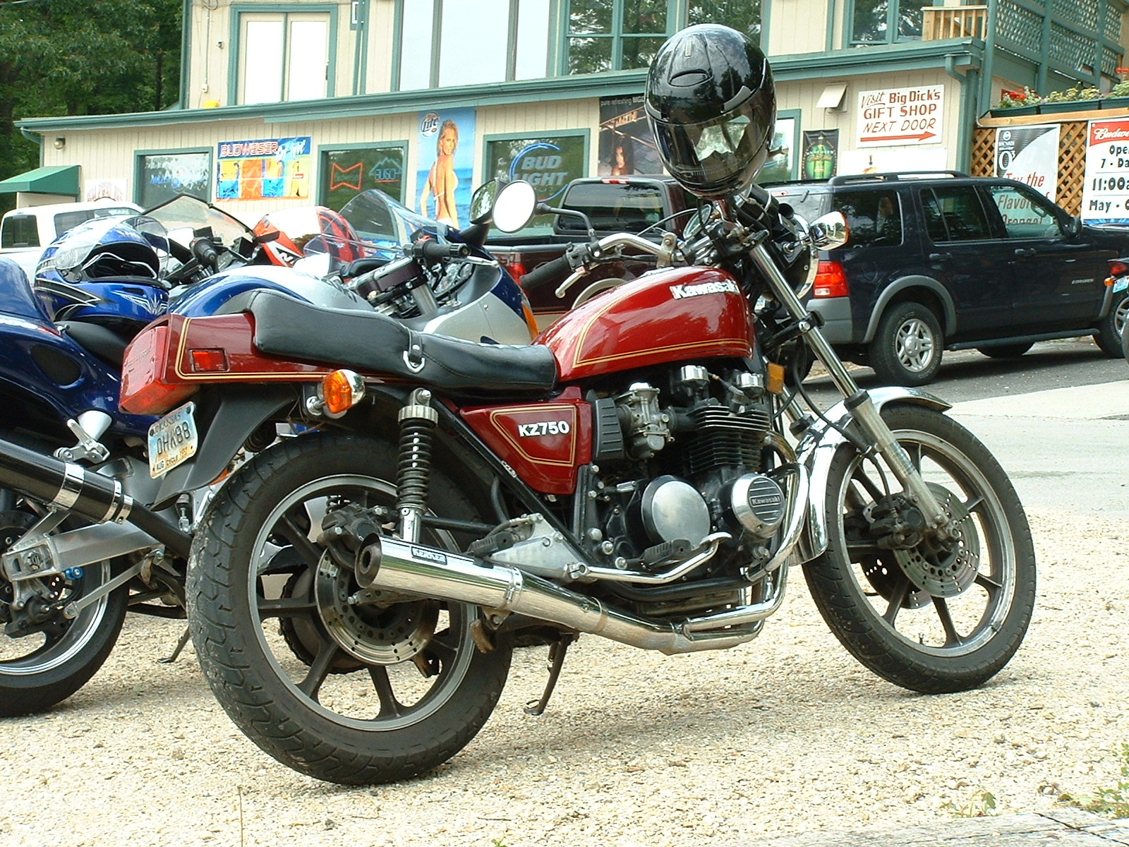

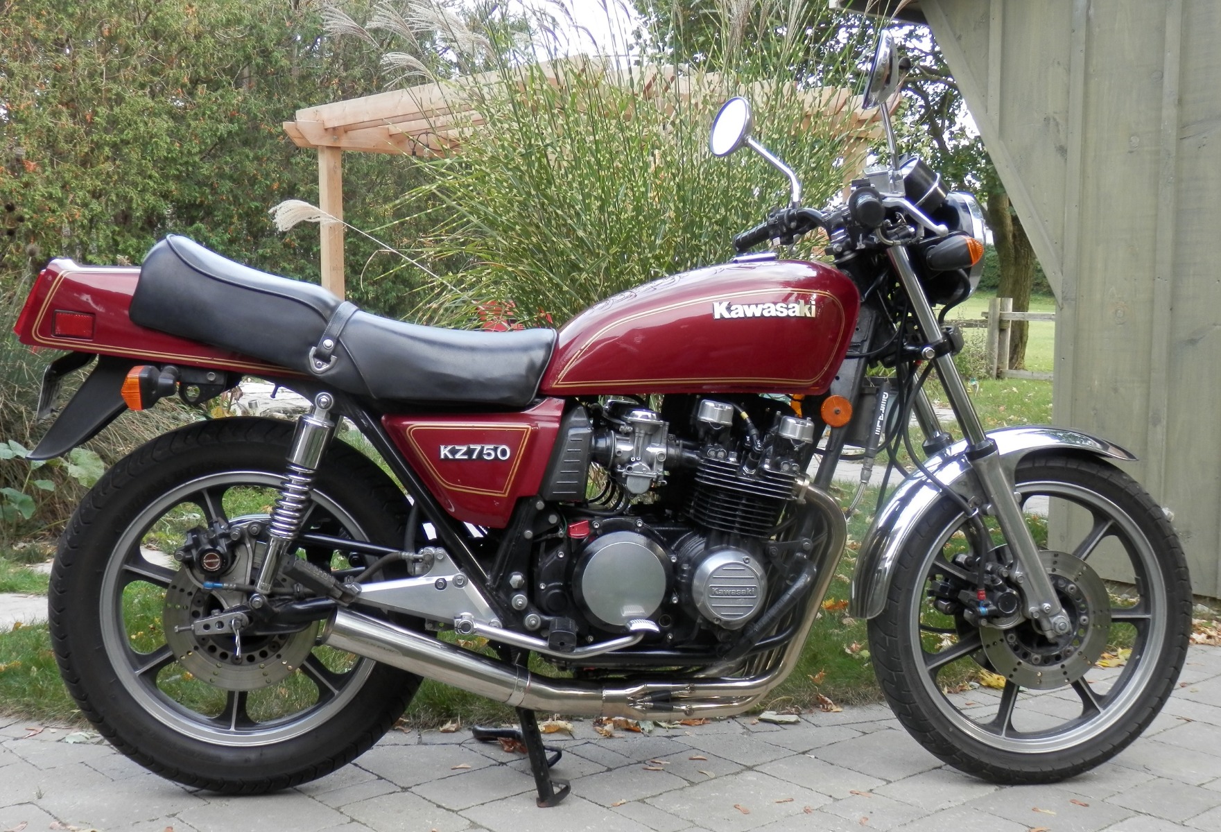

Here is a picture from a few years back when she was a calendar girl here on KZ rider.

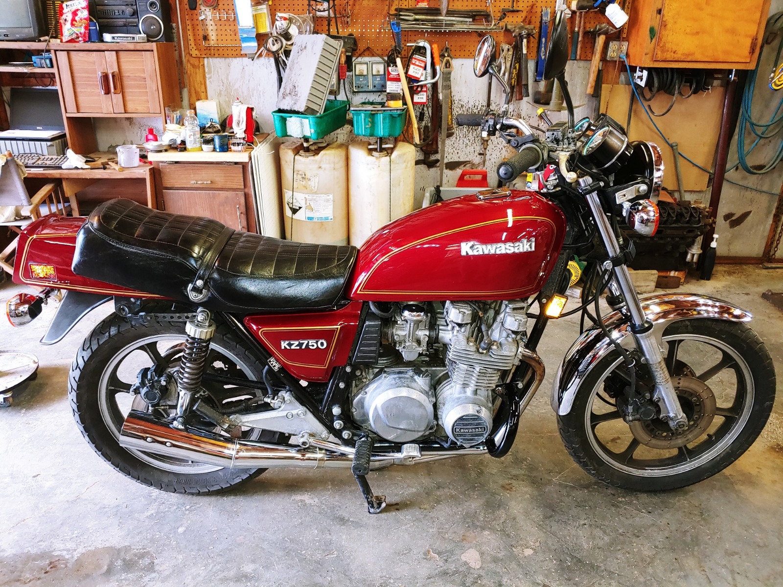

And one from a trip the wife and I took back in 1982 from KC to Colorado.
We have a history and a lot of shared miles...."

Your E1 - third photo - was my model as I gradually made improvements to mine. Almost 90,000 km on it. Last week I cleaned up some electrical, replaced brake pads and did the valve clearances. By next weekend I'll put the battery back in and have no doubt it will fire when I hit the starter button. All going well I'll get yet another year out of it ......... and so will you.

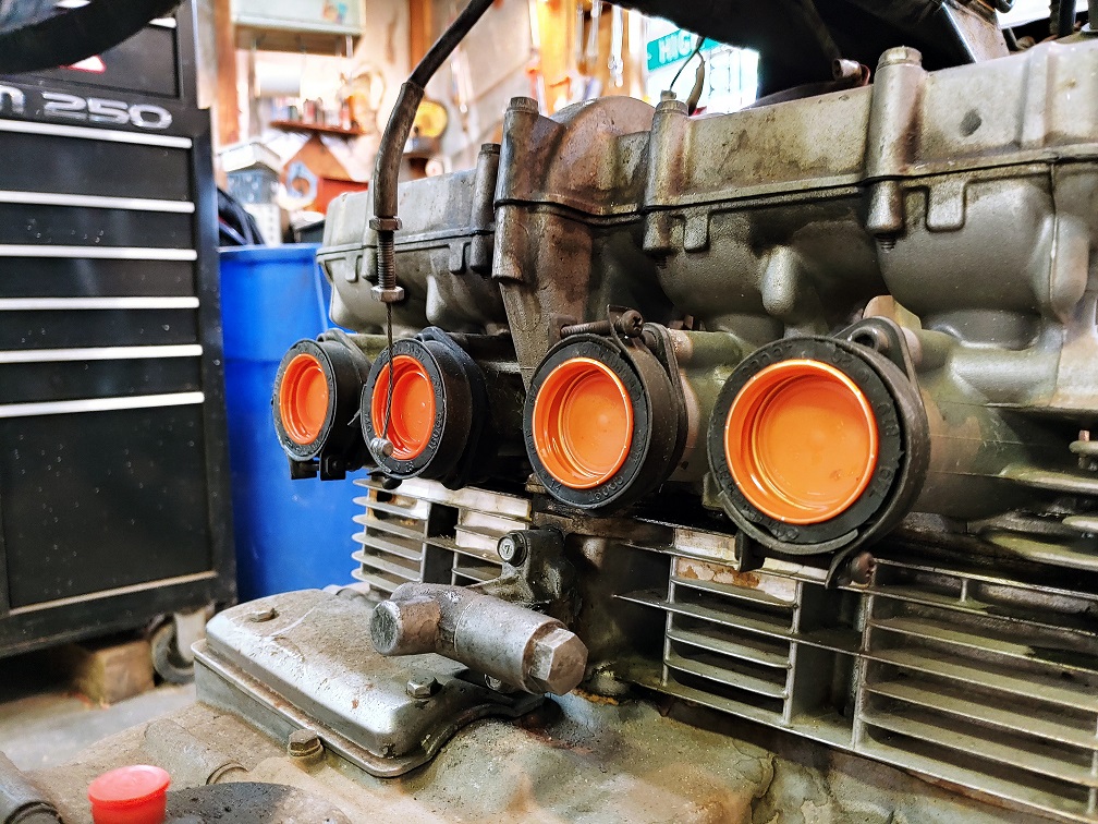

Brief little update and a tip.
Cleaned up and bled both front and rear brakes, seem to be working with good firm feel.
Stripped done and removed carbs, coils, etc.
Pressure washed most of it.
Tip: Gatorade caps fit perfect for blocking off the intakes.
Got most of the parts on order.
I am rethinking the engine tear-down.
This one ran great and I had just done a valve adjustment when it last ran.
My son who also likes this bike is keen to re-ring the original black engine.
So we may leave this one as is, ride it for the summer and rebuild the original this coming winter and install it for next summer.
Either way it should be back on the road by the end of May or mid June!

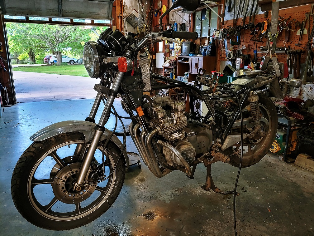

Carb kits showed up yesterday so a quick go through with a couple cans of cleaner.
I split them and replaced the o-rings too as suggested.
Reinstalled them today.
Tomorrow I will start reinstalling the air-box, I always hated that part as the boots are a pain.
Mine are still fairly flexible but a heat gun should help if necessary.
Had to track down hoses and a valve for my old synchronizer tool as it has been so long the originals had rotted and cracked.
Shooting for an extended test ride by next weekend!!

Ok its back together and about to go on its first ride in a long time. Just a short one mainly around the neighborhood to make sure its going to be safe.
Then a quick run up and down the interstate .
Probably just ride it back and forth to work for a week or two before calling it good to go.
That's as much for me as it is the bike as its been 5-6 years since I last rode.
She shined up fairly well but I still have some wheels, cases and other aluminum bits to work on.
It really never ends... LOL
