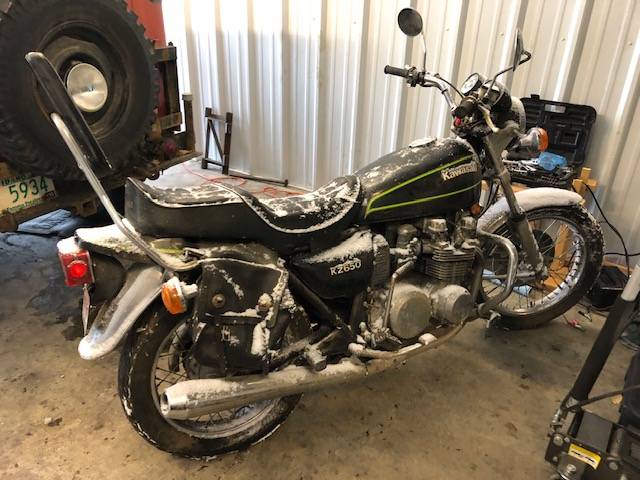

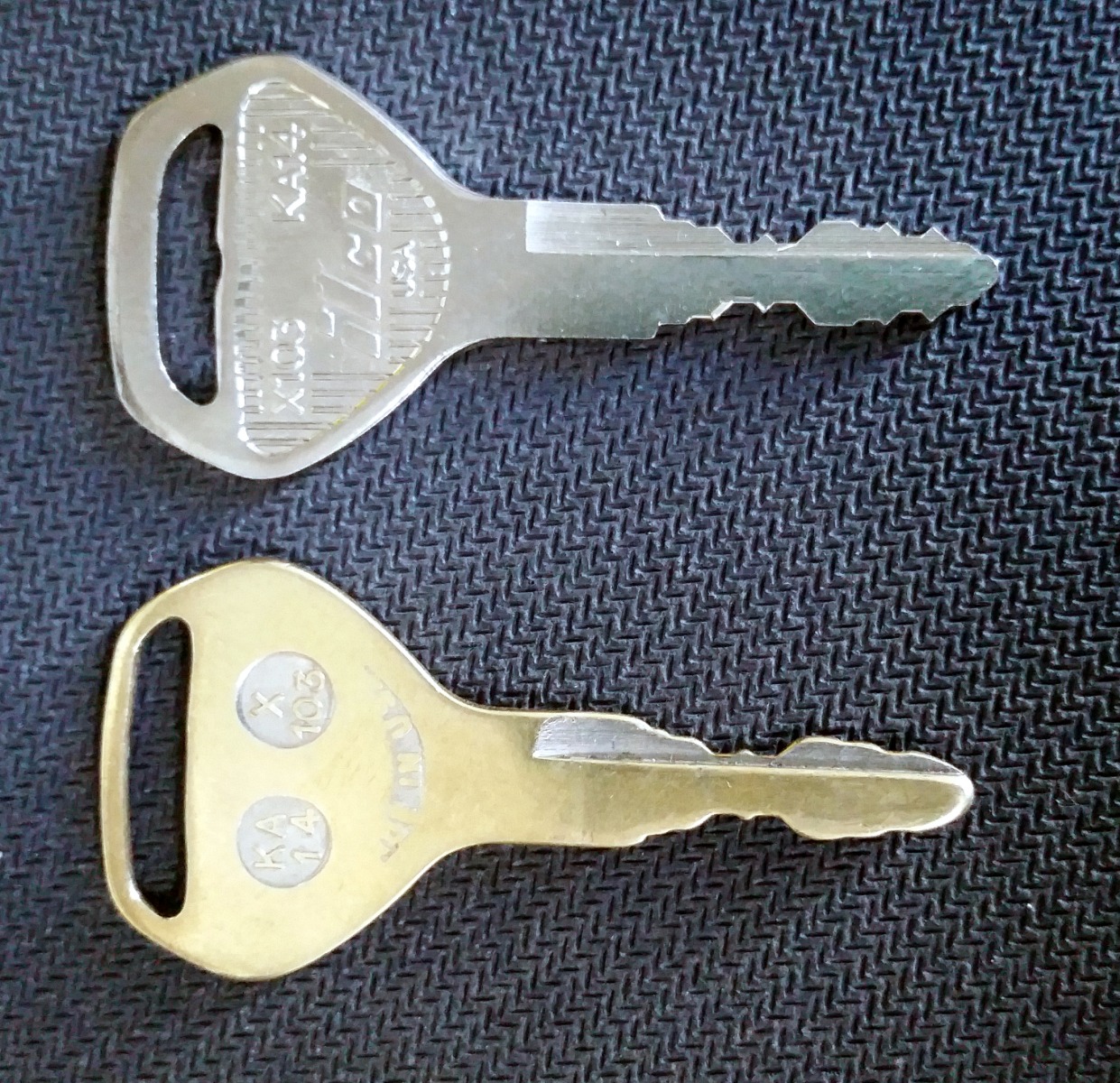

This was a one owner bike. He was a sheriff whose nickname was 'Two Guns". That name shall be passed on to this bike (of course!)He rode the bike until 2008 when he was in his 70s. He passed about a year ago and the family decided to take the bike off the back patio and put it up for sale. I just picked it up last week. It seems pretty complete, and apparently 'ran fine when it was parked'. We shall see. Seat, bar, bags, cowl and tank have been removed. Front blinkers and headlight removed, ignition switch was pulled to get code and a new set of keys were just cut. That made a huge difference in ignition fitment. The old worn key would work with a lot of jiggling, the new one slides in and turns like butter!

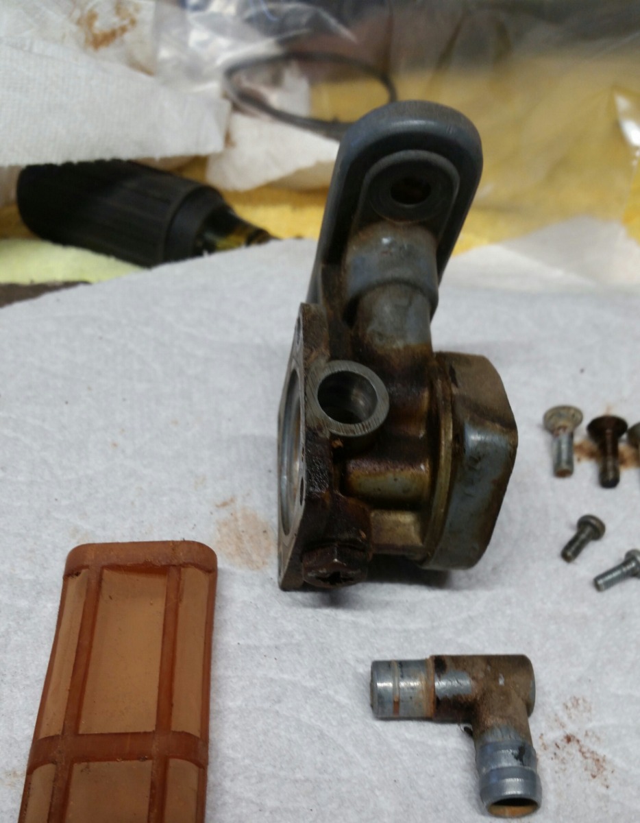

The petcock needs work. The insides are shiny and not pitted, and the gaskets are probably reusable, though I know a rebuild kit is cheap. There are 2 other issues- the fuel outlet piece has separated, and the screen on the standpipe is brittle and broken. I can probably press in a new brass outlet fitting, but can not find just a new pickup screen anywhere. I went ahead and bought a cheapo eBay 44mm petcock for now. I will try to put the new screen on the old petcock down the road when I rebuild it. My goal right now is to get the bike running to address any issues, then go back and make it ride-able and purty.

Howdy. You might be able to clean up the old nipple & re-install w Seal-All or Permatex liquid metal. Some hardware stores carry seal-all. I used the permatex stuff. It comes in a tube & no mixing per se >> apply a small amount to the outside of the nipple & press it in place. This repair was done more than 5 years ago. I also used the stuff to seal a leaky fuel level switch >> they tend to seep around the red plastic piece which is riveted in place.

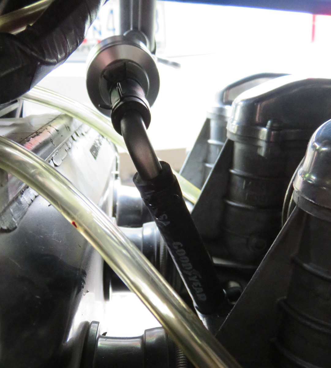

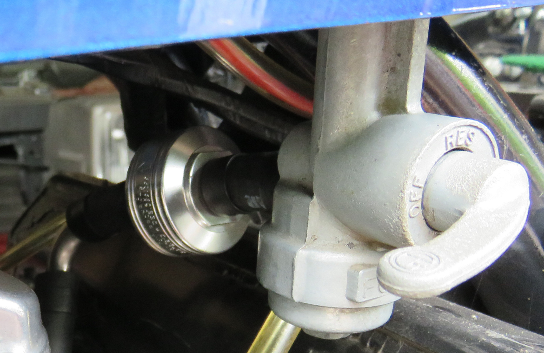

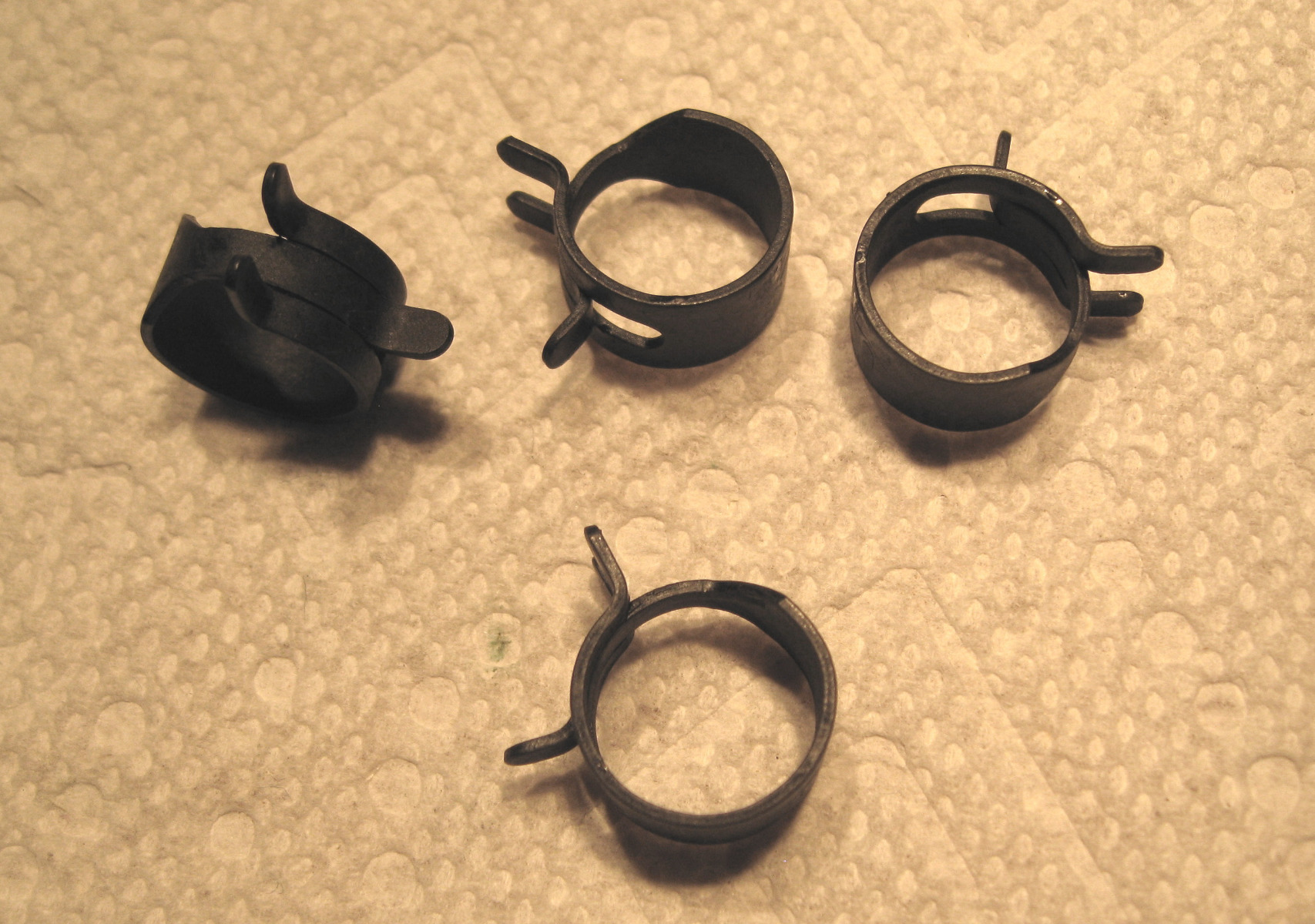

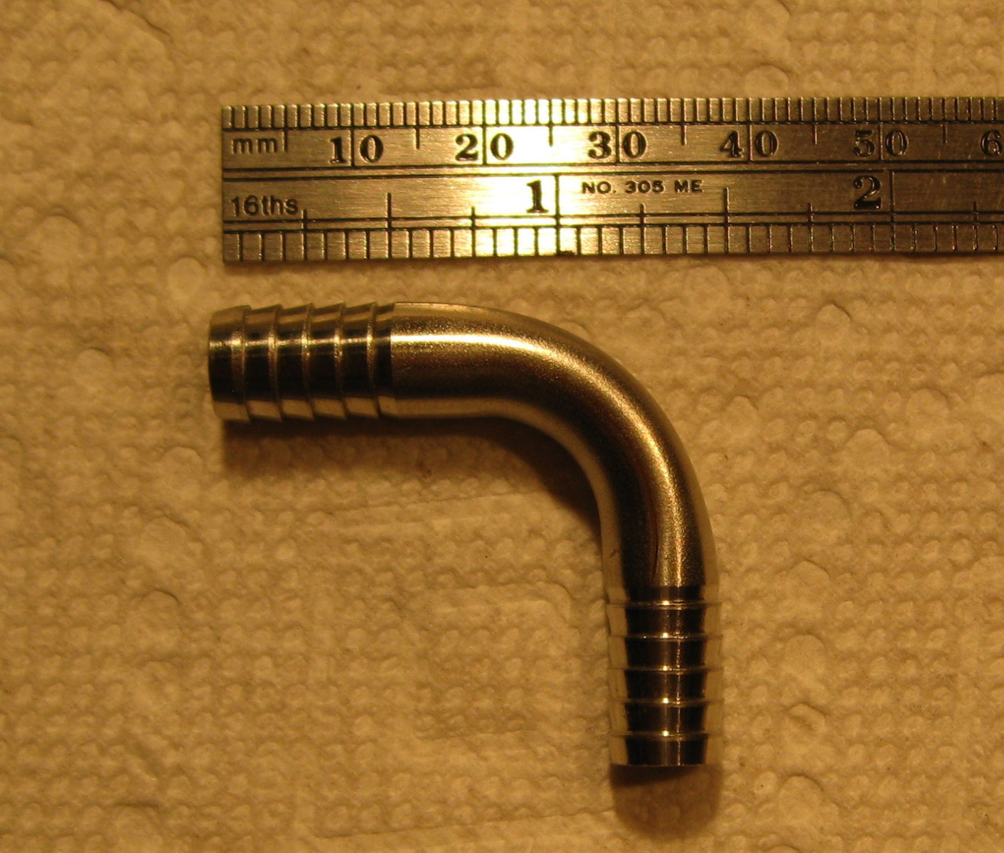

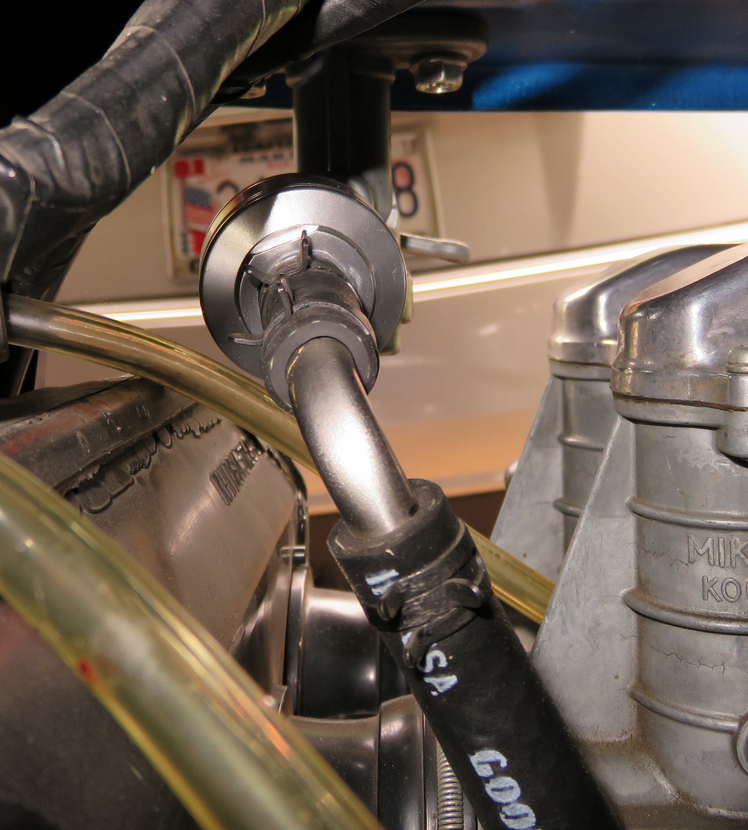

Whether or not you are able to locate a tank fuel filter I highly recommend you install an inline fuel filter. The best one I found for my KZ650 is the Golan Mini Filter. They are not cheap, but one will last a lifetime; I got mine from ronayers.com but other vendors carry them too. They use a stainless steel filter element that can be cleaned. They filter out very small 10 micron particles but still pass fuel at a rate of 6 gallons per minutes – MORE than enough for any bike. They are very small so they fit well under the tank. Also, I used a 5/16” stainless steel elbow to make the bend from the tank to the cabs so there is zero chance of the fuel line pinching. I got it at a place that specializes in propane supplies.
For fuel hose I use Goodyear 5/16" Fuel Hose SAE 30R7 (required 8") Part # 65123. For clamping the hoses I use 5/16” spring clamps. They are a million times easier and quicker to use than the screw type. Some auto stores sell them or they can be easily found on eBay.
One word of warning – having tried numerous fuel delivery setups over the past 43 years the absolute worst product I found is Gates Barricade fuel line. Do not waste your time and money on it as it has an inner sleeve that rolls up like a loose sock and clogs the line when you install it.
