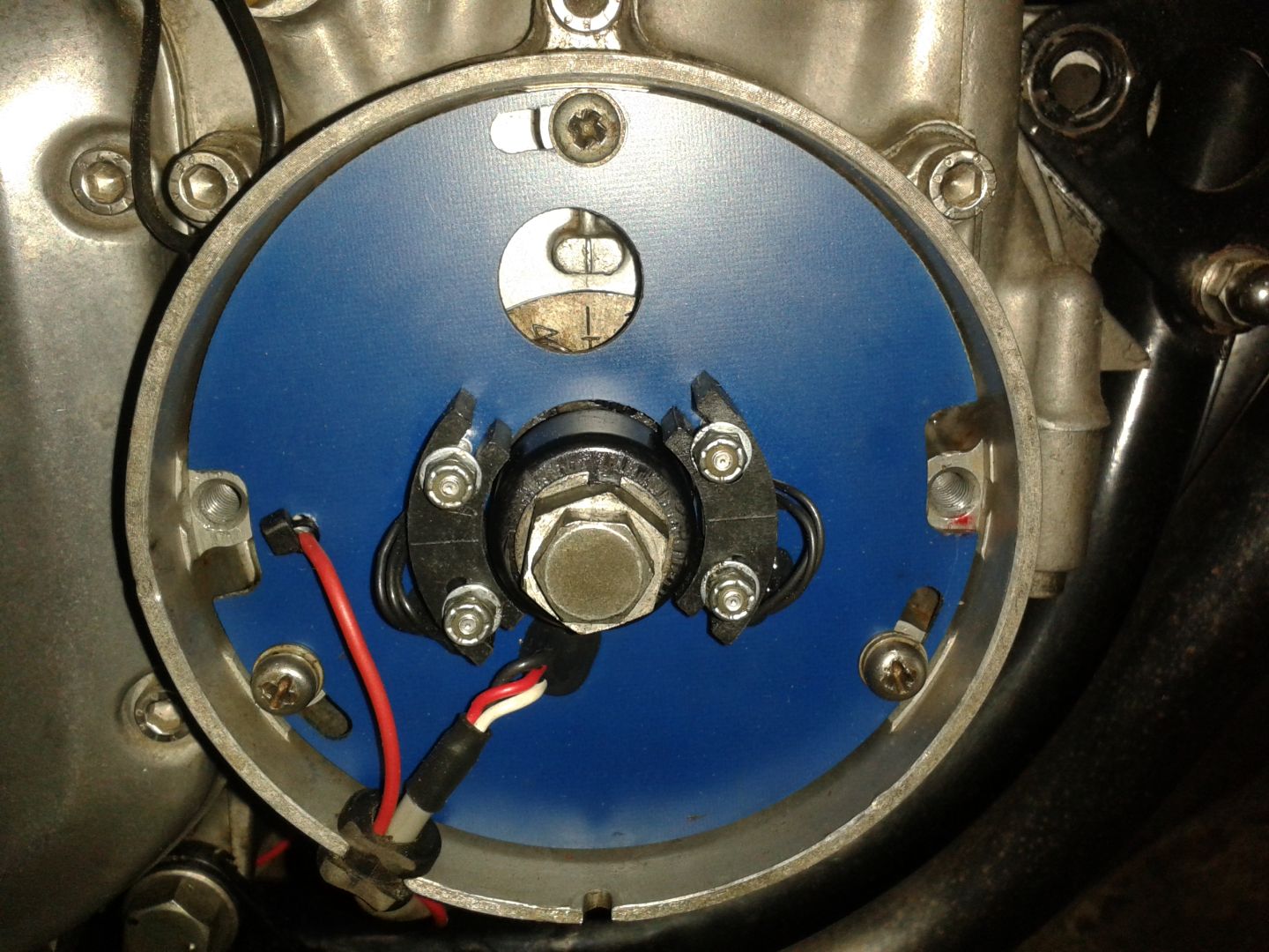

10 Sep 2020 22:46Mikaw wrote:
Super nice. I see you have the same problem I had with my Dyna S. I installed the 3A (I think) Rotor for the Z1900 . The pick up magnet is located slightly different and it put the breaker plate right into the middle of the slotted adjustment. Call Dynatek they sent me to rotor free.
I have the same Problem. Good to know that a 3A rotor will fix the adjustment Problem. But it´s difficult for me to find/get a single 3A rotor here in Germany.
