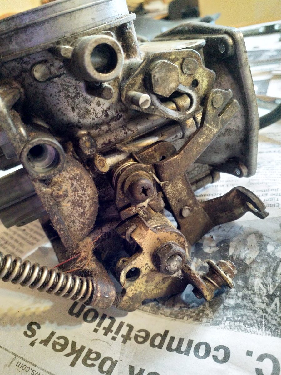

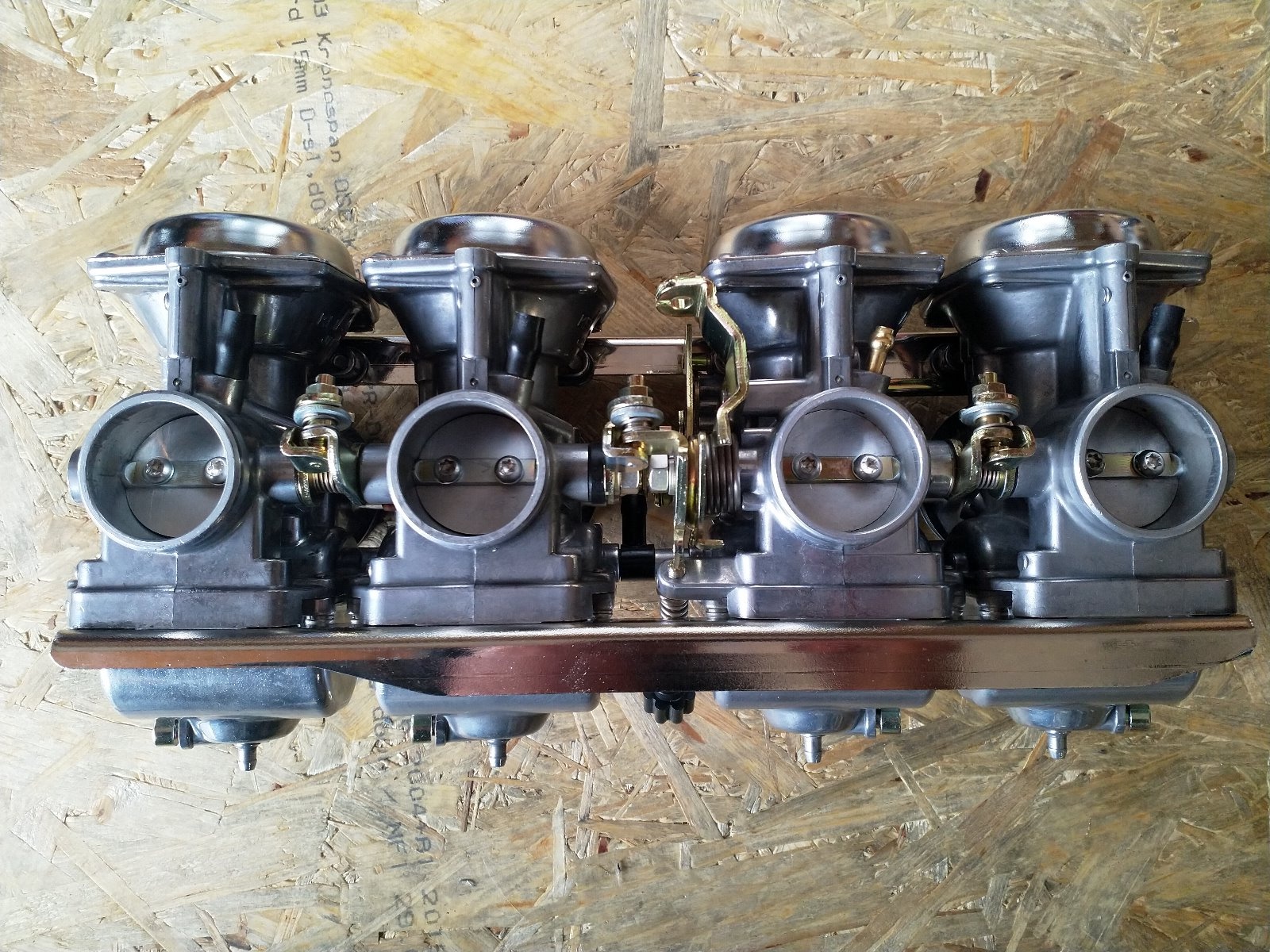

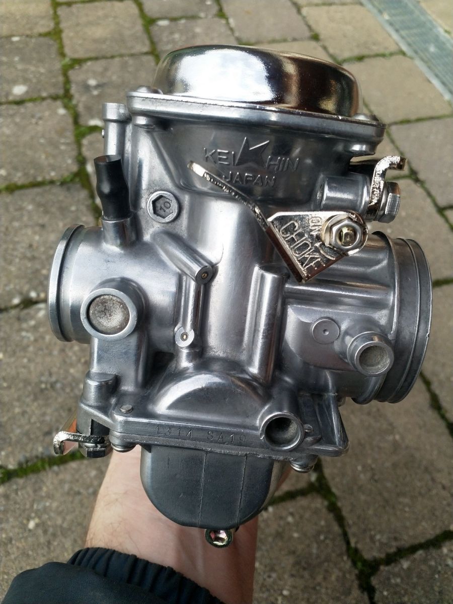

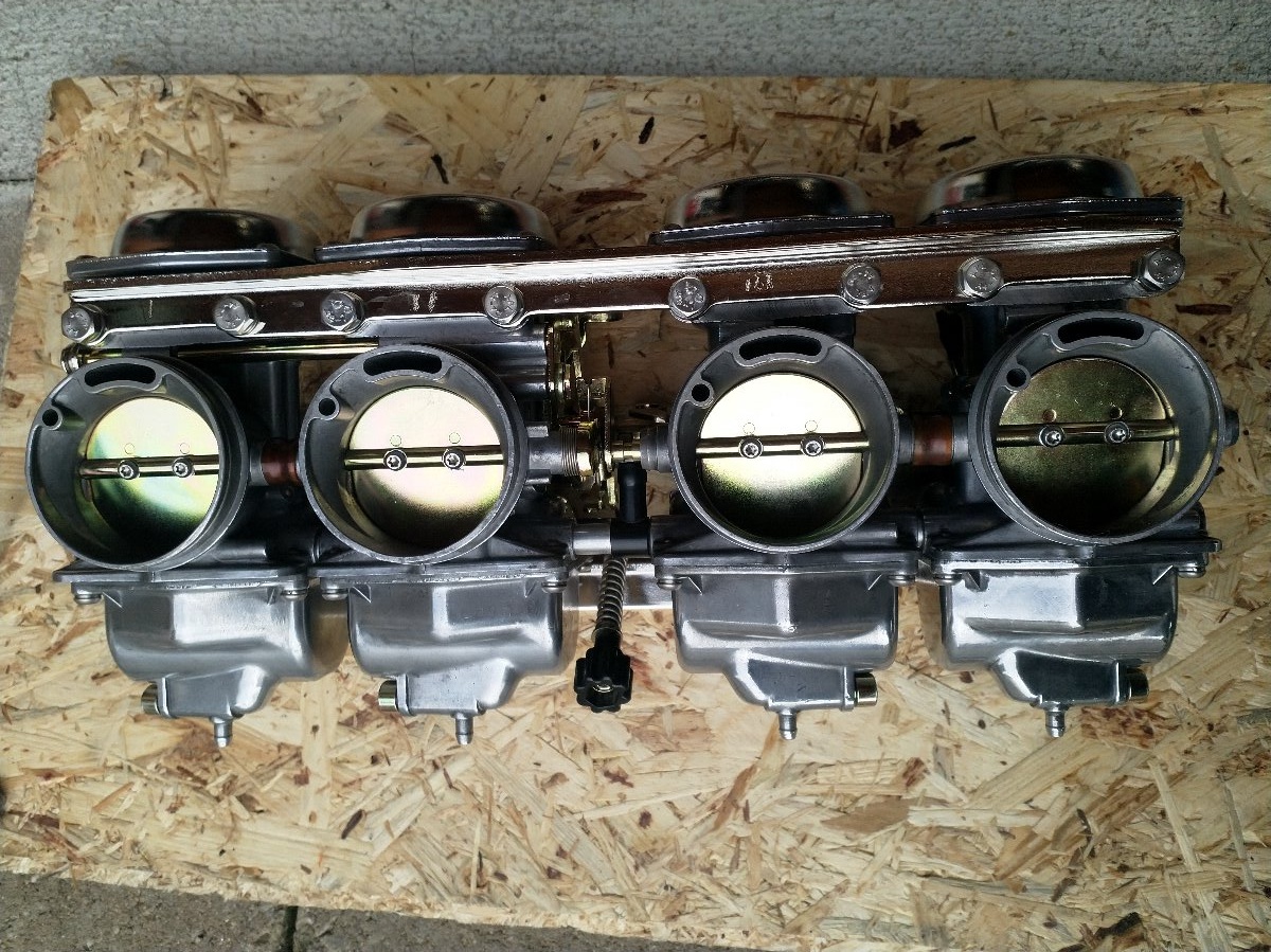

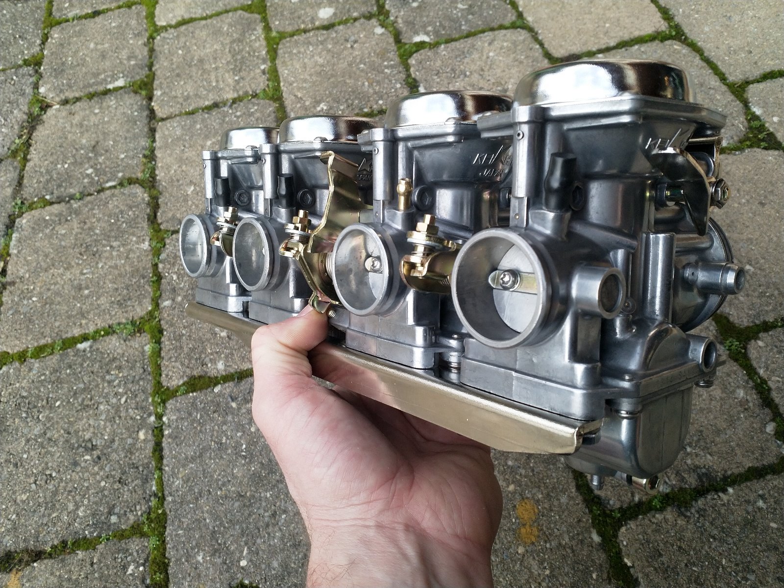

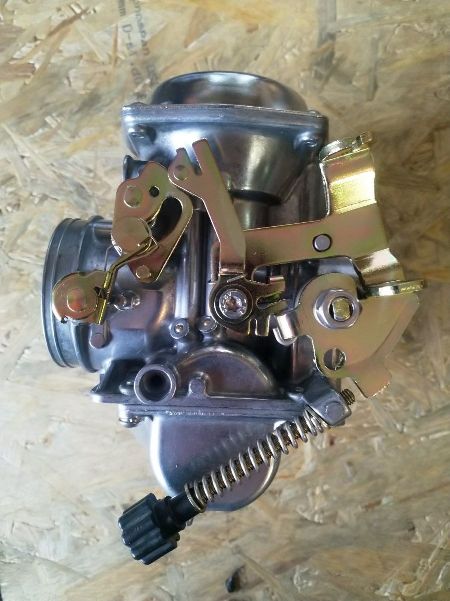

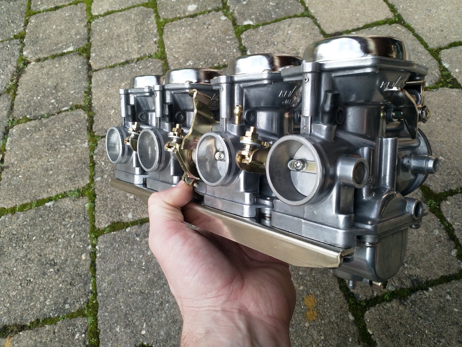

Carbs reassembled. New stock jets, zinc plated parts (choke lever and the two main brackets nickel plated) and new chromed tops. Polished up the carb bodies as I cant stand the matt grey finish. Not the best polishing job but will hit the outside ones with a dremel when everything else is done.
Before:
After:
Before:
After:

Question for you guys about the throttle and choke plates: I used green (2701) loc-tite and lock washers instead of staking. I figure once the loc-tite has cured this will be bomb-proof. Thoughts?
KZ1000 Restomod (
2000 BMW F650GS
2000 BMW F650GS
- jayrodoh
- Posts: 128
- Thanks: 27
Re: KZ750H Restoration
08 Jan 2020 12:34 - 08 Jan 2020 12:34calum wrote: Question for you guys about the throttle and choke plates: I used green (2701) loc-tite and lock washers instead of staking. I figure once the loc-tite has cured this will be bomb-proof. Thoughts?
I've used loctite on all my carbs for the throttle plates with zero issues over the years. Heating a little to remove later (if I ever have to again) beats filing the back of the screws off.
Never used green before but after reading up on its application I don't think you'll have any issues.
Your carbs look great!

Thanks, that's exactly what I wanted to hear
I'm pretty happy with how the carbs came out. Hoping I don't have any issues when I put them to use!

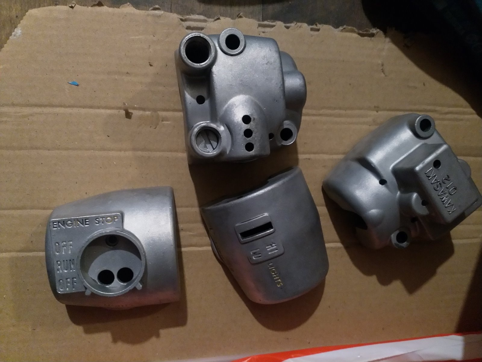

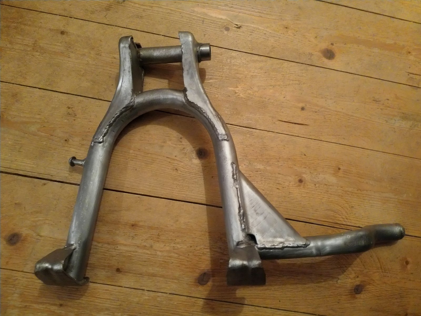

Still waiting on the shims so after checking the float levels today (all good, no adjustment necessary) I blasted the centre stand I found on ebay and the control housings.
I used a really low pressure for the controls (about 2 bar) so that I didn't round off the text. This is the second set I've tried to restore and the edges of the text on the first set weren't good enough to paint (when I sprayed the text white and then sanded the excess, the letters were all wonky). I figured that I may have been a bit extreme when blasting them so took it easy this time, because of this there is still some excess paint that I need to remove manually.

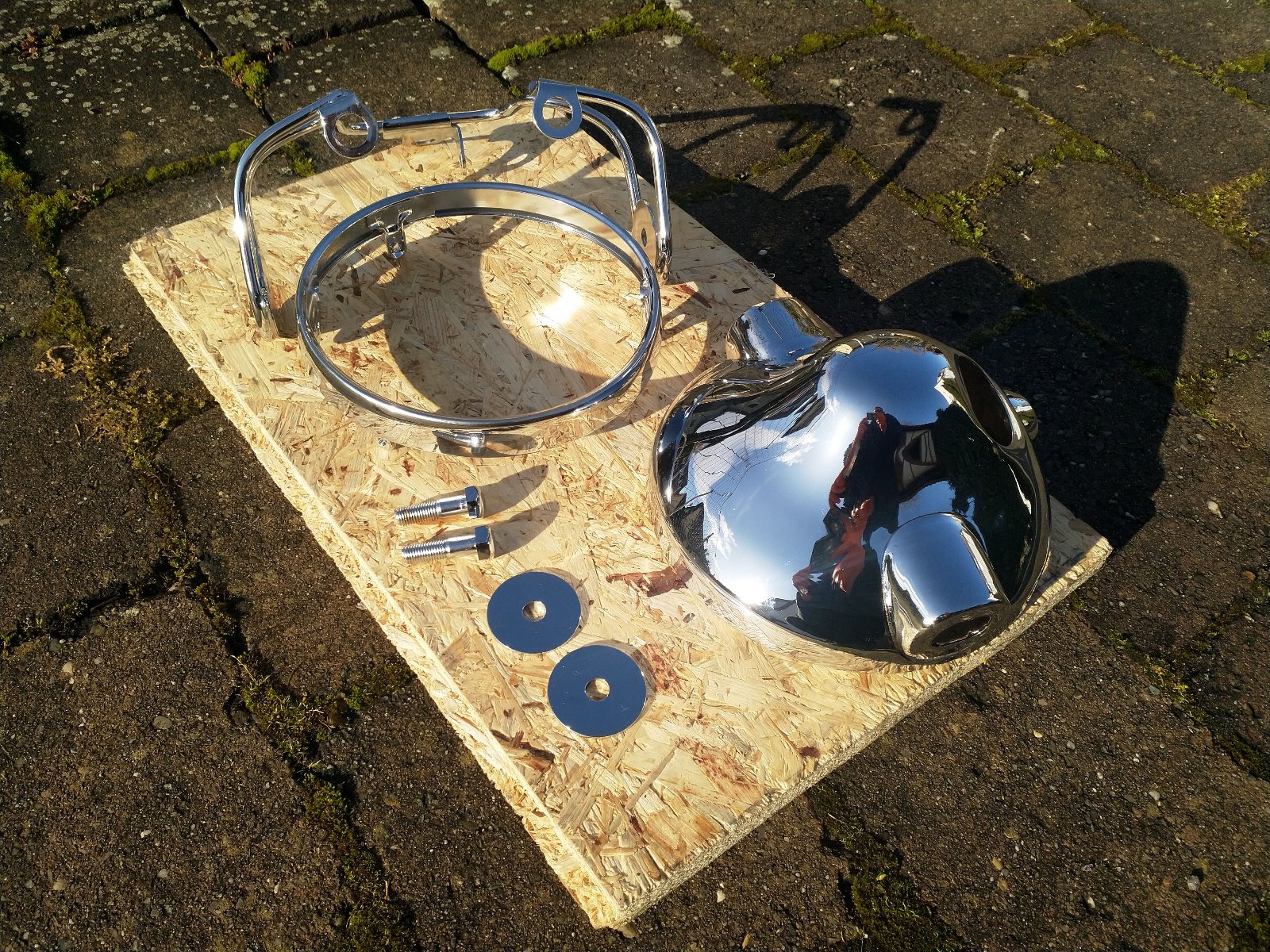

Picked up the headlight parts from getting re-plated yesterday. Look really good and cost me under half of what new parts would have cost (if I could even get hold of them). They even polished up the bolt heads so they look better than new.

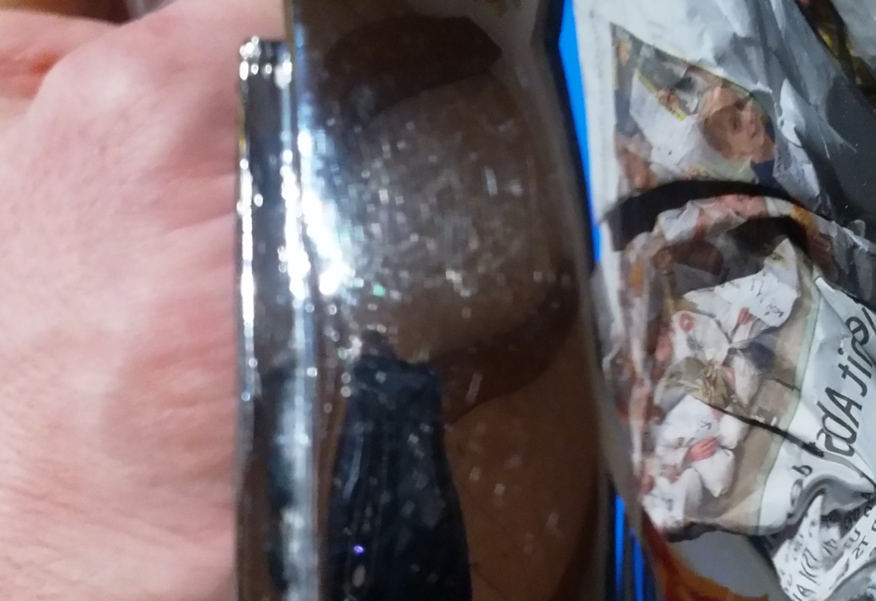

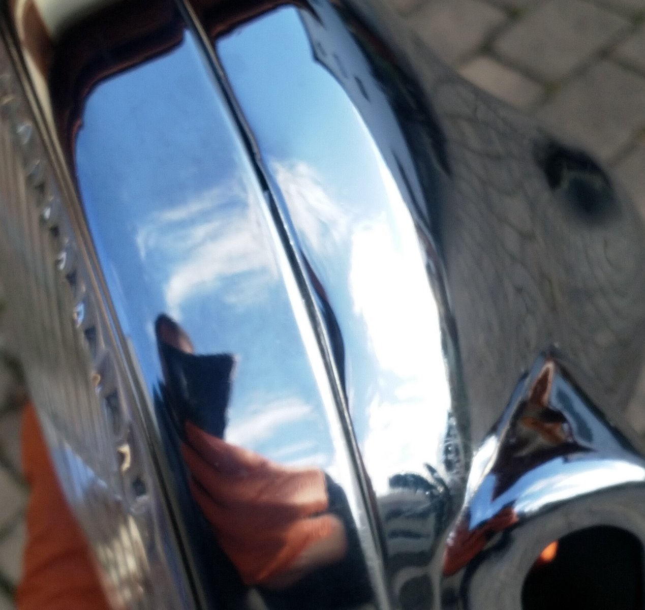

Unfortunately I completely forgot about a dent on the left side of the housing. I meant to hammer it out a bit before I took it to get plated. It was made more visible when the ring was assembled - everything else was perfect so it stuck out. My stupid brain wouldn't leave me alone so I tried to hammer it out a bit. It ended up a bit better but despite the cardboard under the housing I still ended up with some micro-scratches in my nice new chrome. Any tips on how to get these out? Rouge and 0000 steel wool?
