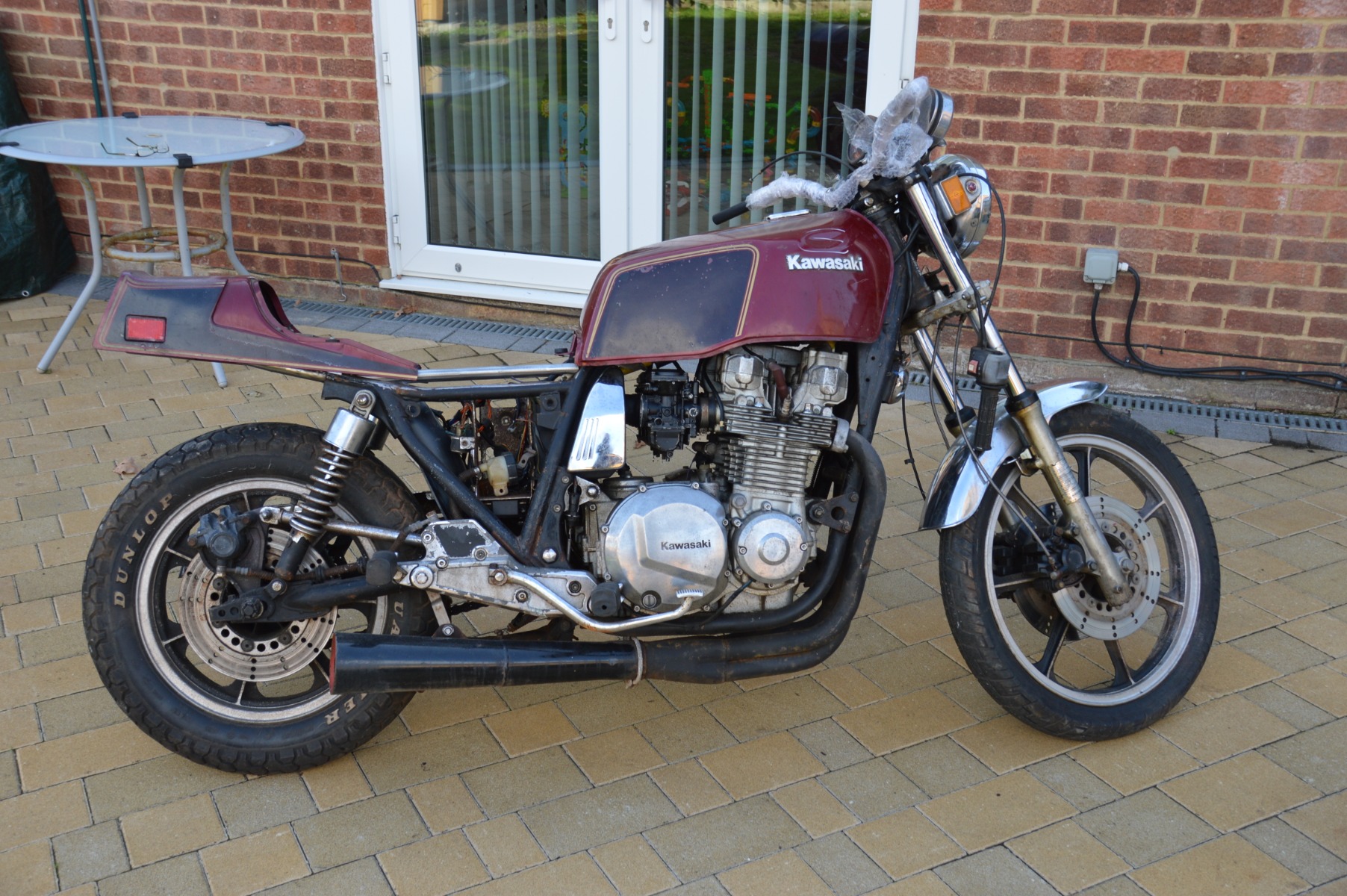

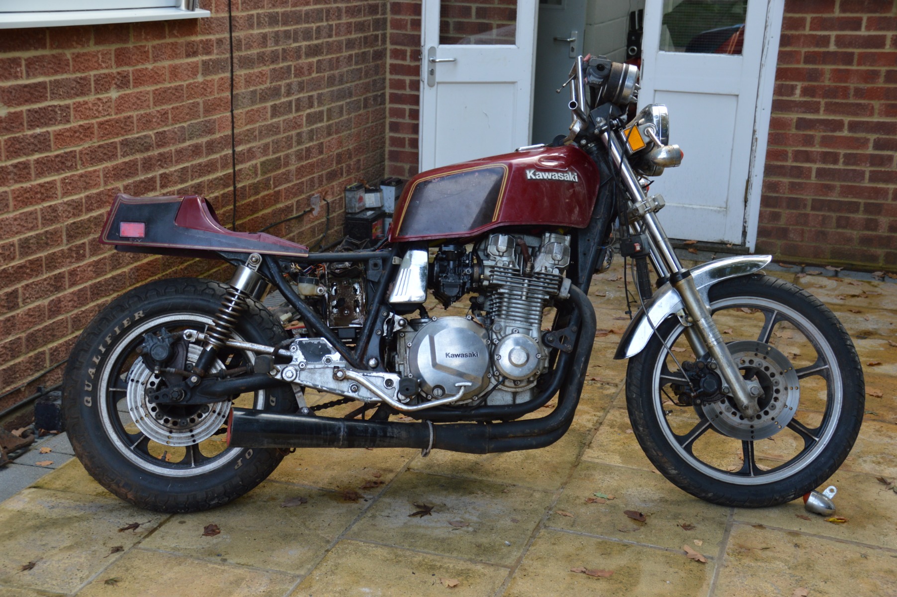

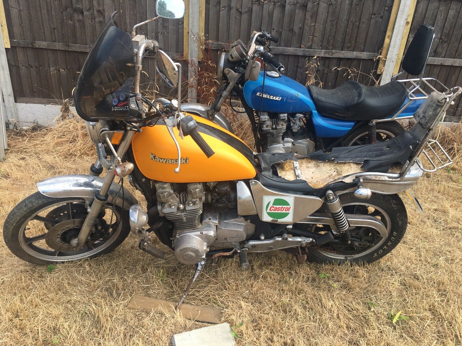

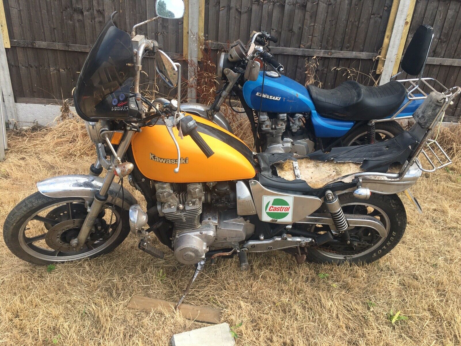

hello after posting about ST fuel tank fitting to CSR frame i thought id better put a post in the projects section about my alleged cunning plan! the bike was purchased via ebay a couple of weeks ago along with the 1000 LTD in the back ground it has been of the road since 1995 but seems to have been kept dry ish. the rats and mice have had a good chew on the wiring and the airbox but other than that its not too bad, the engine turns at least! the plan is to make a MK 3 Z1000 thingy . the running gear will be KZ1000 P, wheels , clocks etc. maybe some rearsets to get rid of the horrid standard foot peg mounts. the plan is to use as much kawasaki bits as possible. first pic shows bike as advertised. some body spent a lot of time making parts from stainless including the side panels!!!! the sissy bar and seat have gone in the skip as have the bars and highway pegs. heres some pics

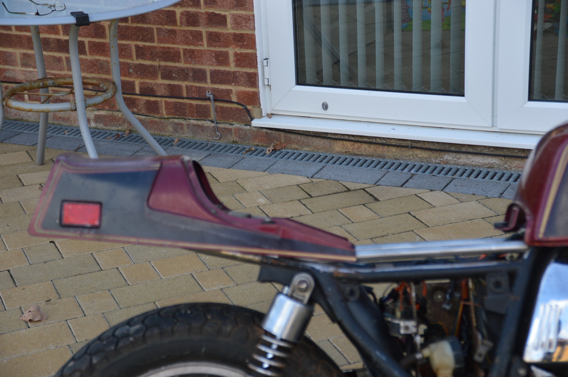

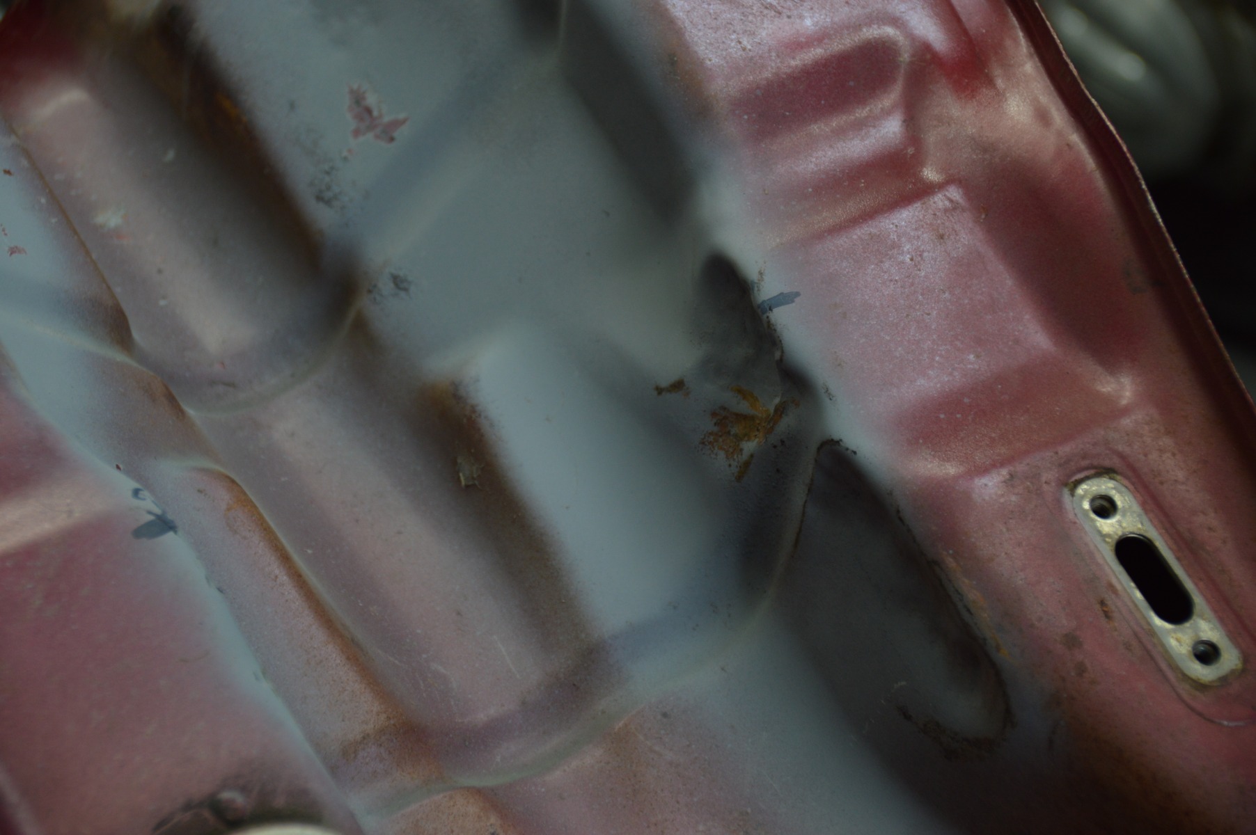

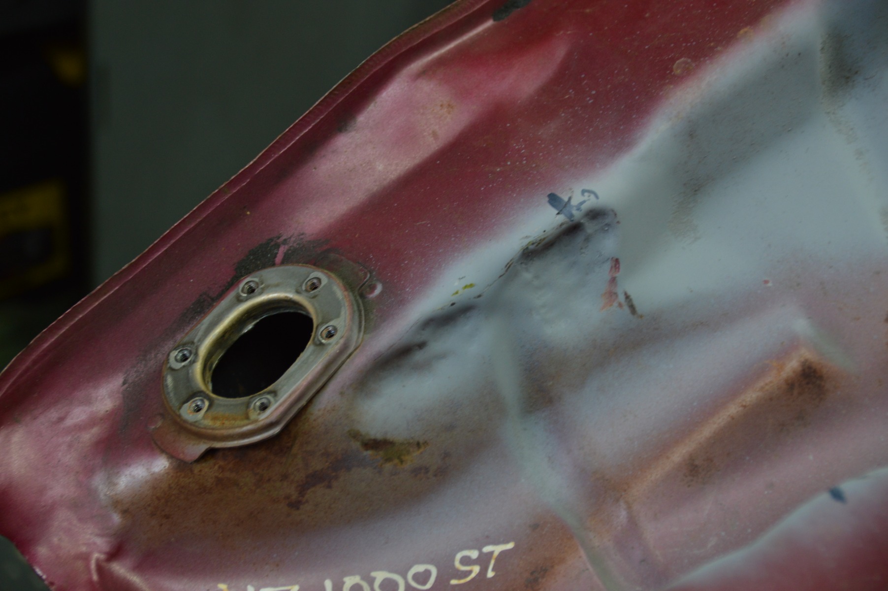

tank fitted without too many issues. coil bracket had to be cut and bent and bit of hammer work on the inside to clear the frame rails. i need to fab up a rear tank mount and redo the front rubber mounts. the fork legs clear by about 6mm, so only just

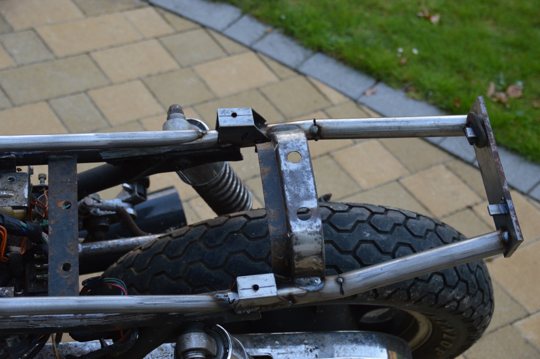

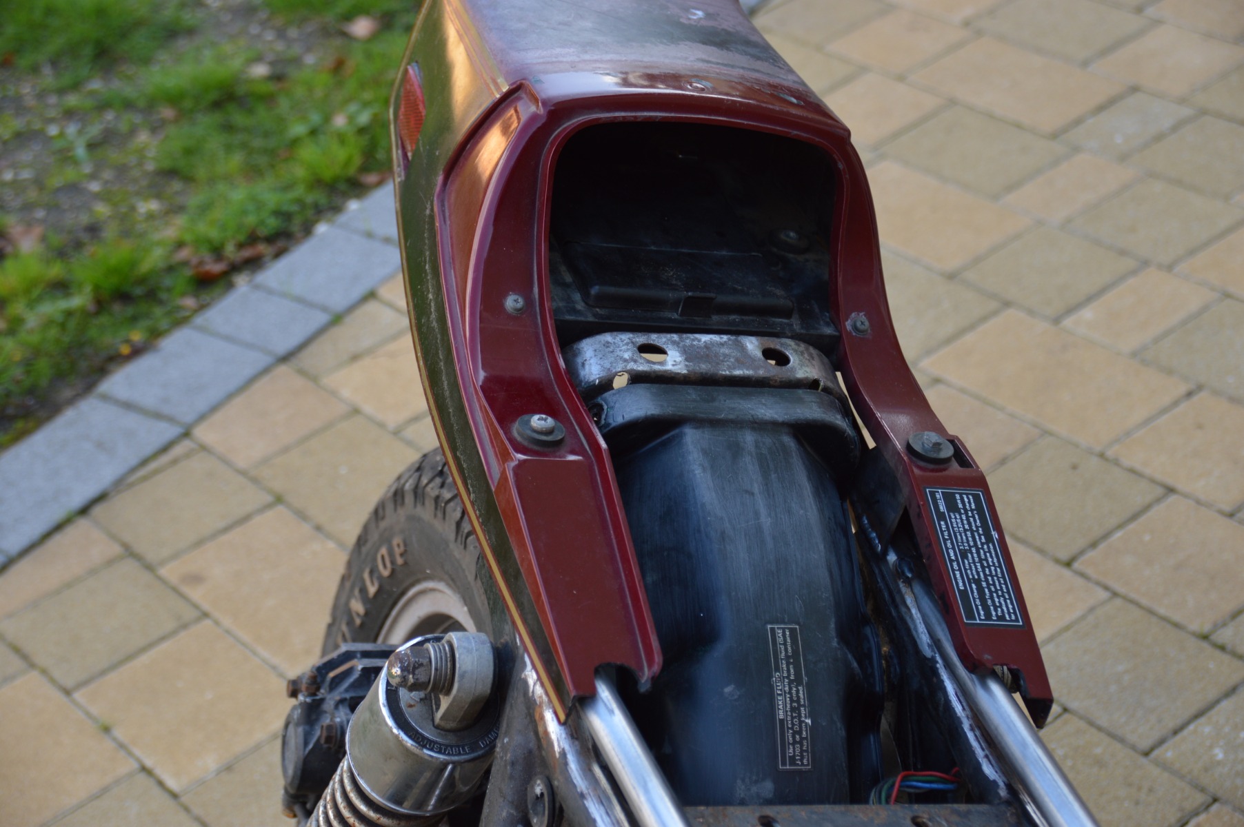

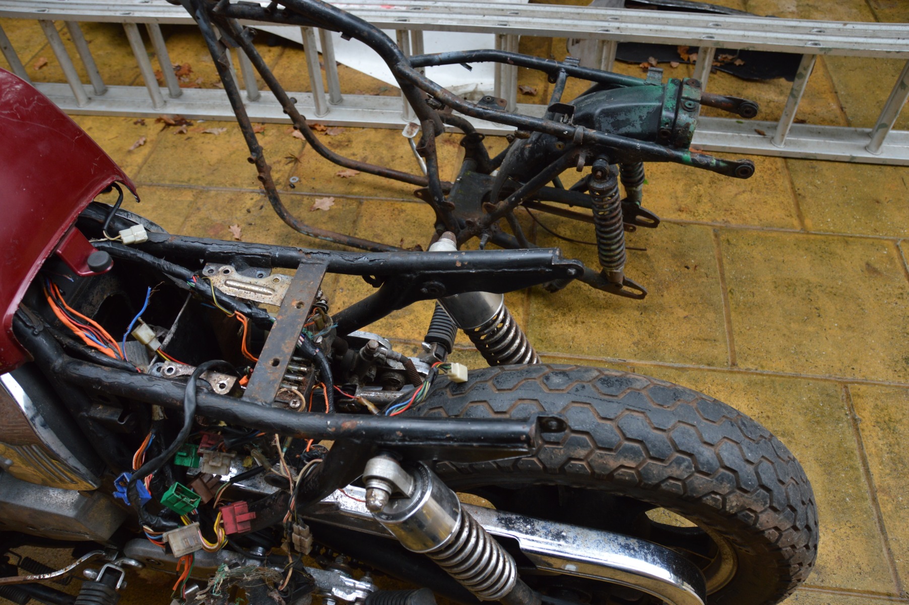

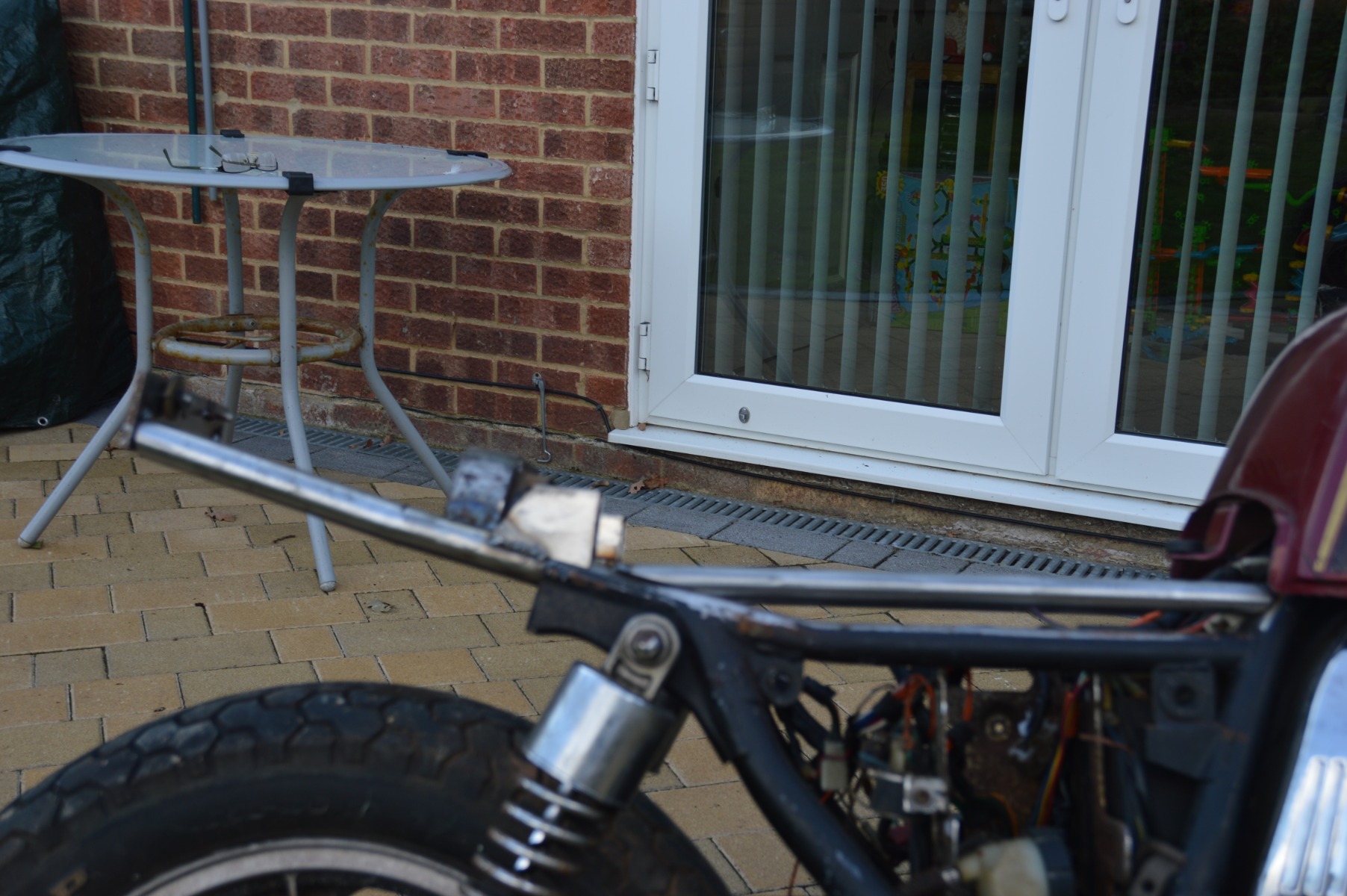

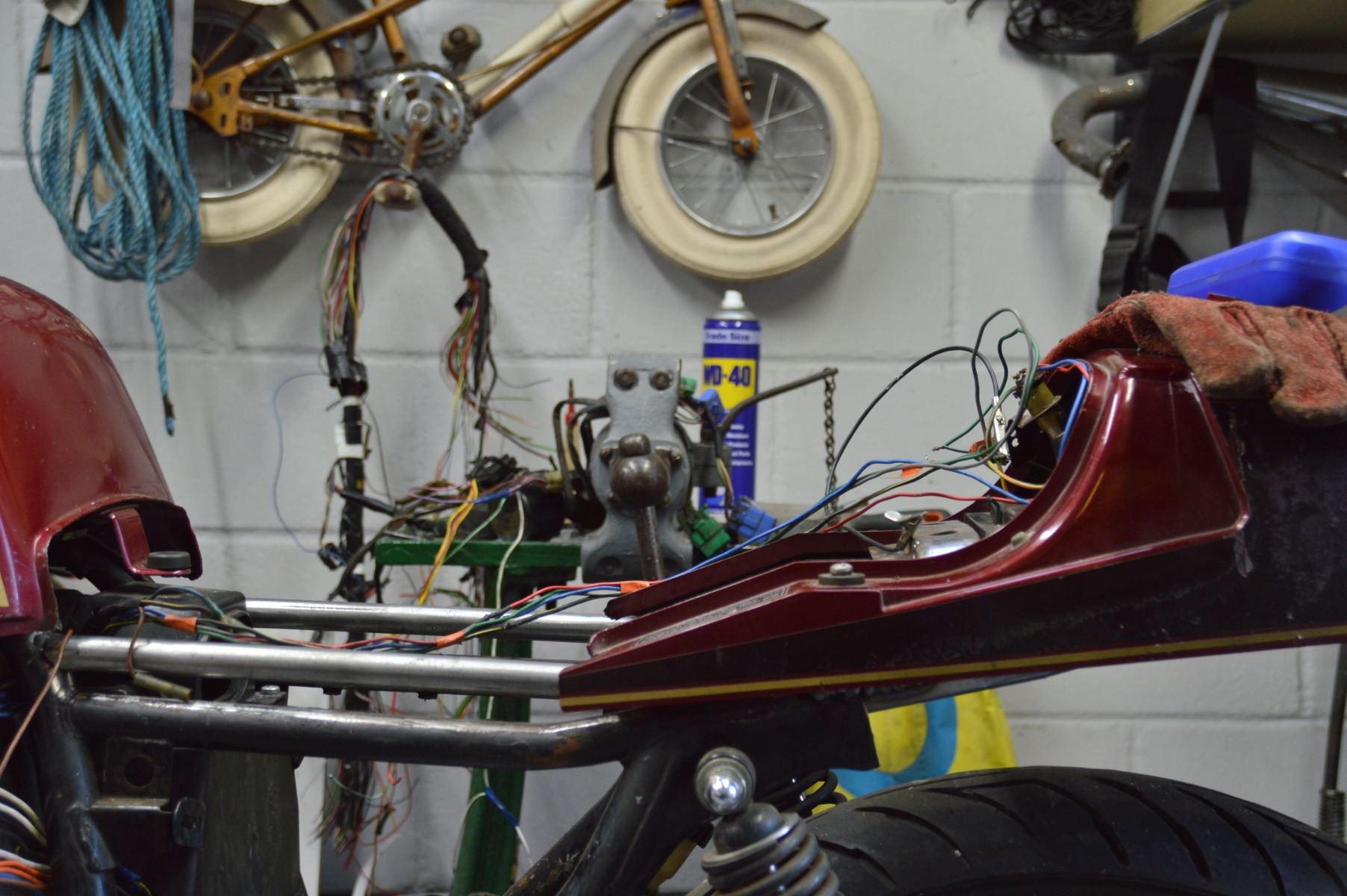

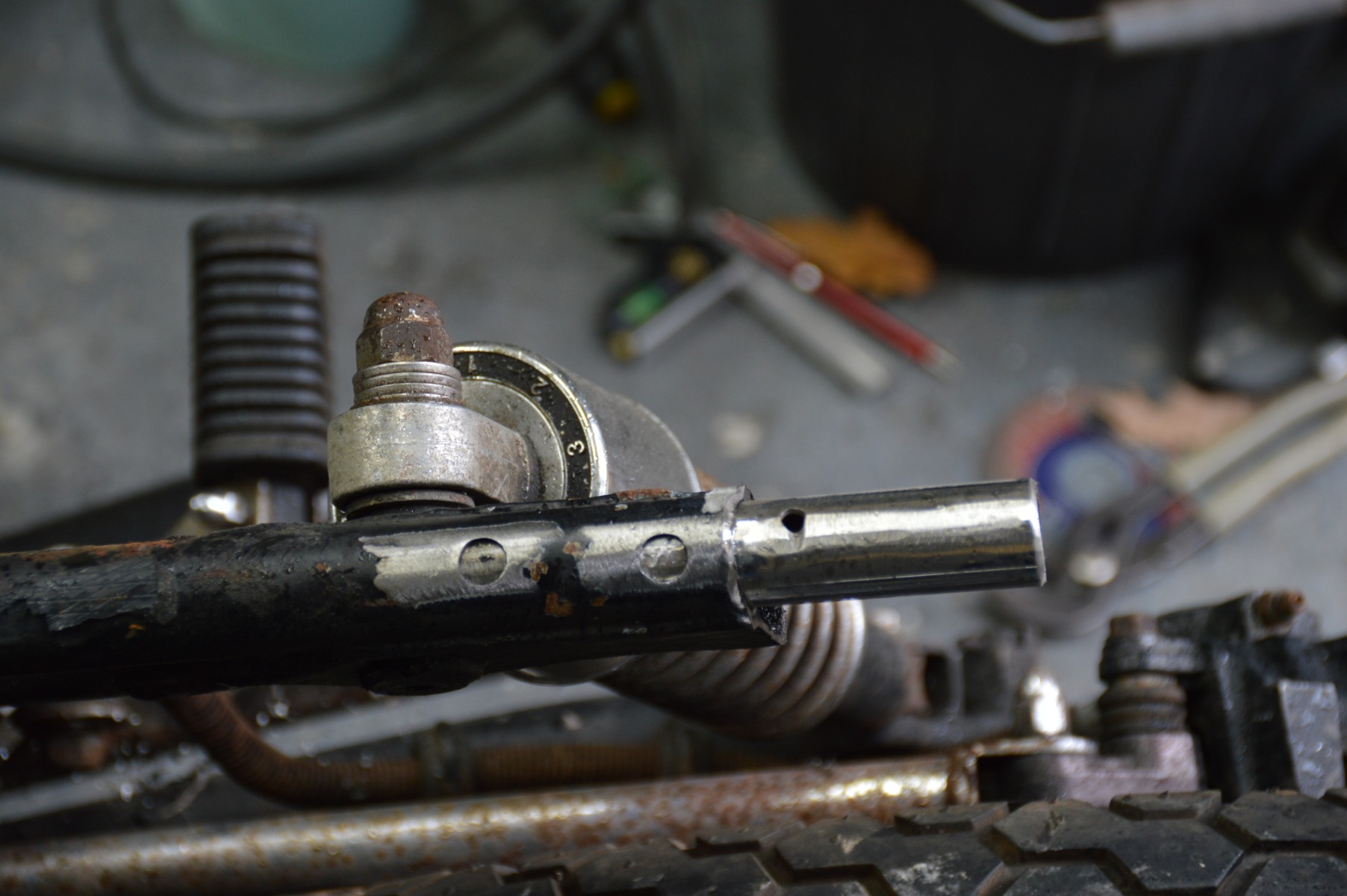

busy weekend getting the rear end back together after a PO cut it off. im sure the handling was great due to the lack of shock brace! work supplied a table for the frame tubing which was the perfect size inside and out,two chair legs for the seat riser tubing and a KZ 400 frame gave up the brace and inner rear mudguard

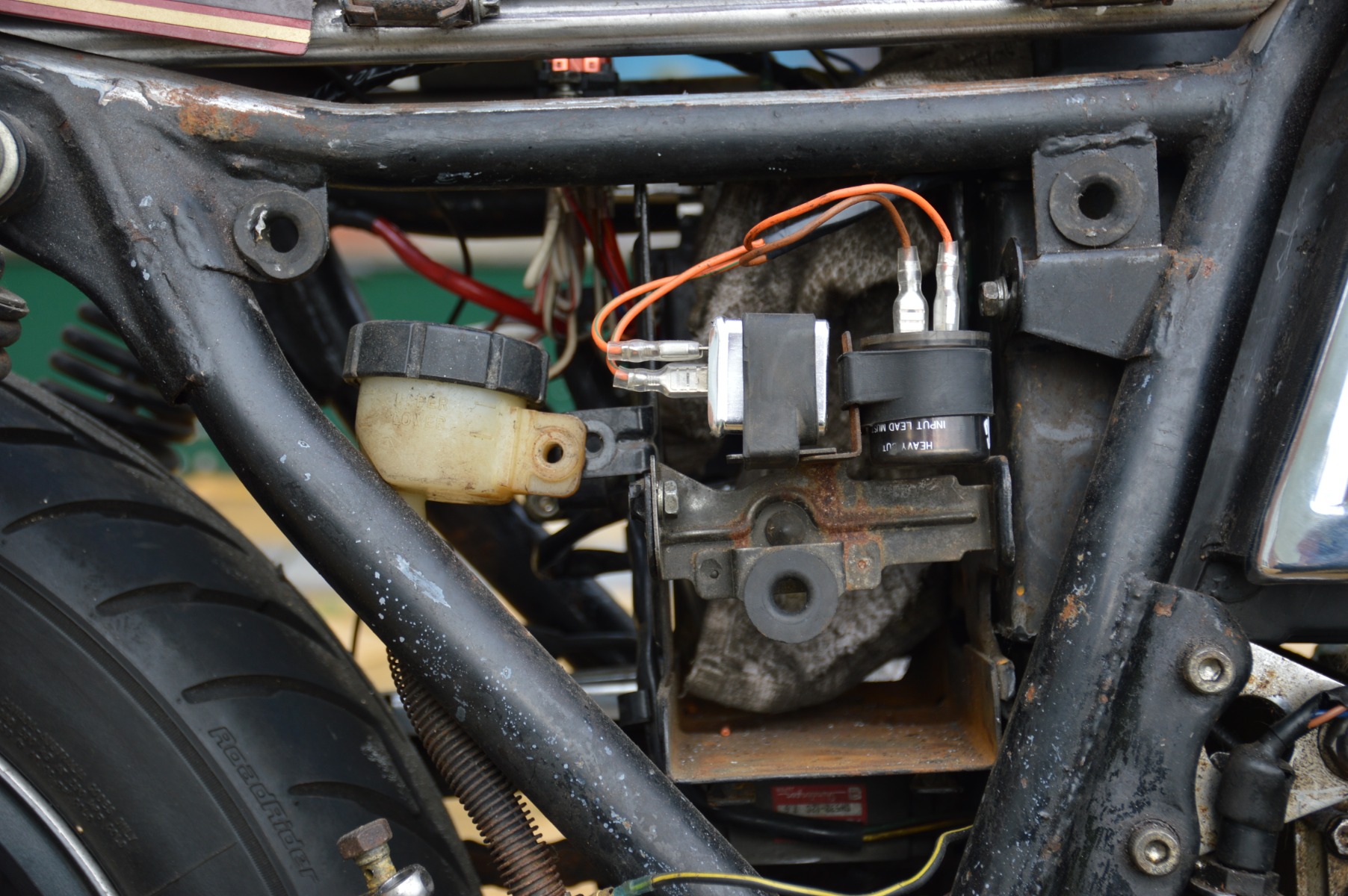

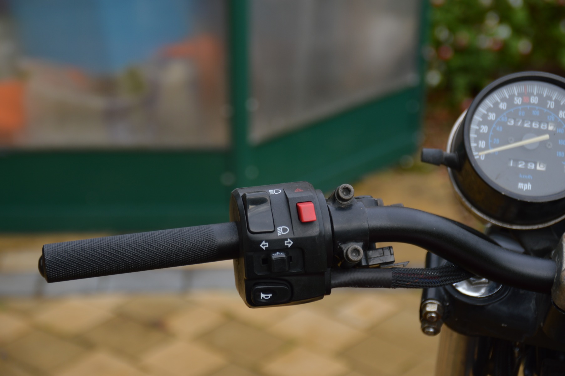

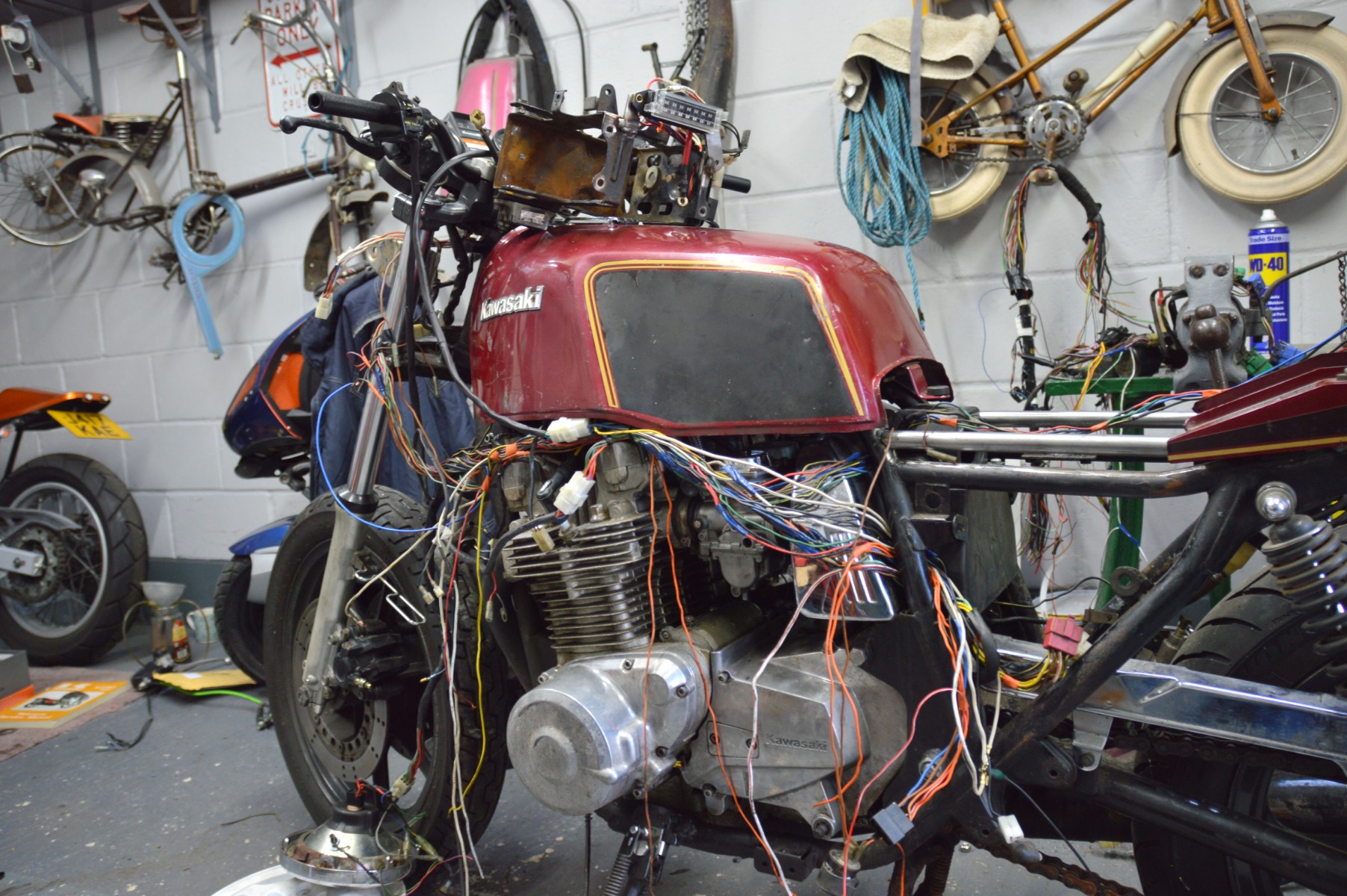

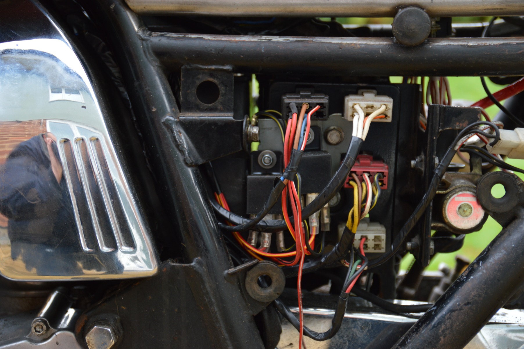

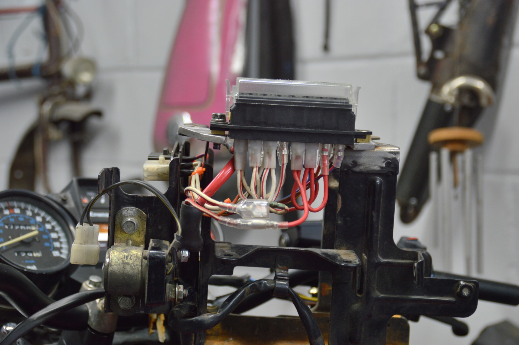

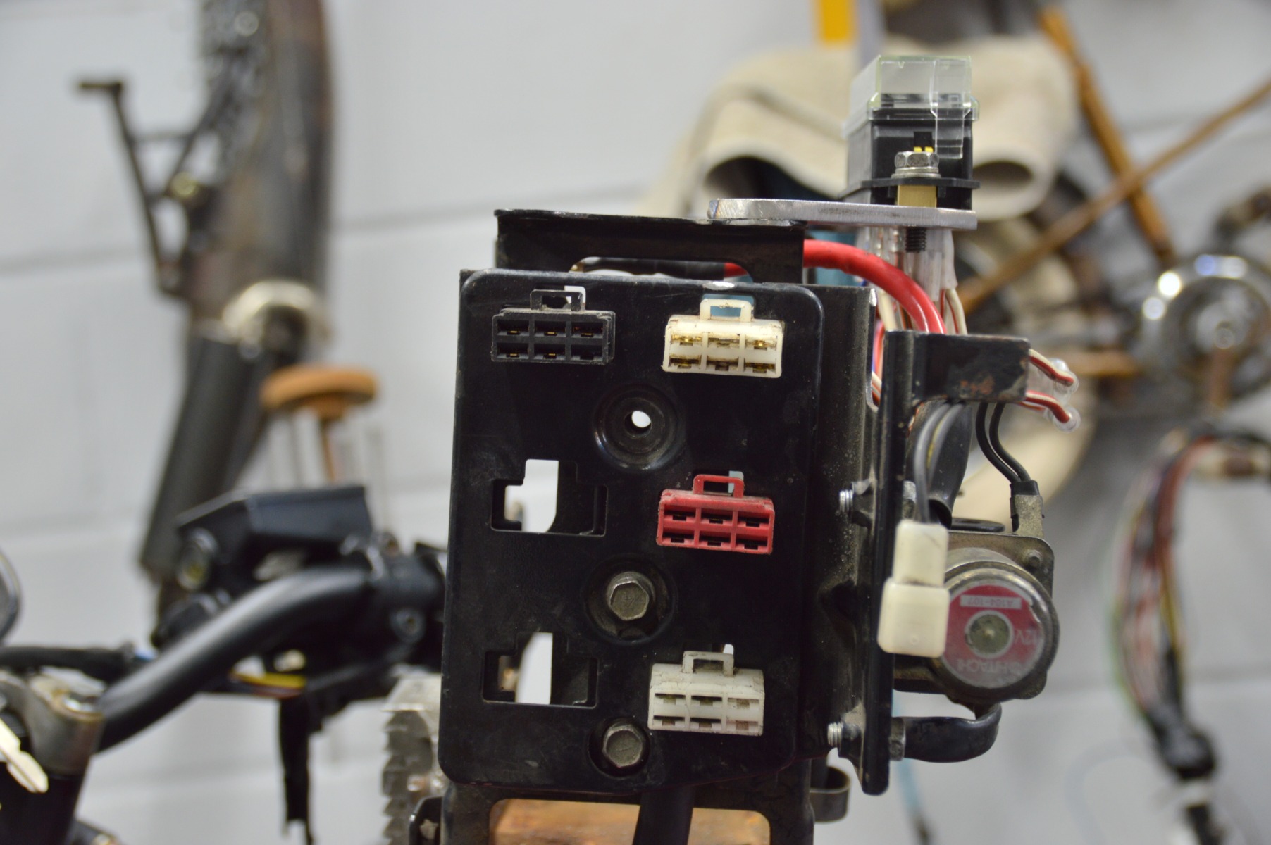

only a bit more spagetti to sort out !! newish switches on the way from an ER6 . two relays to wire in for the high/low lighting i should be able to use a larger bulb for the lights

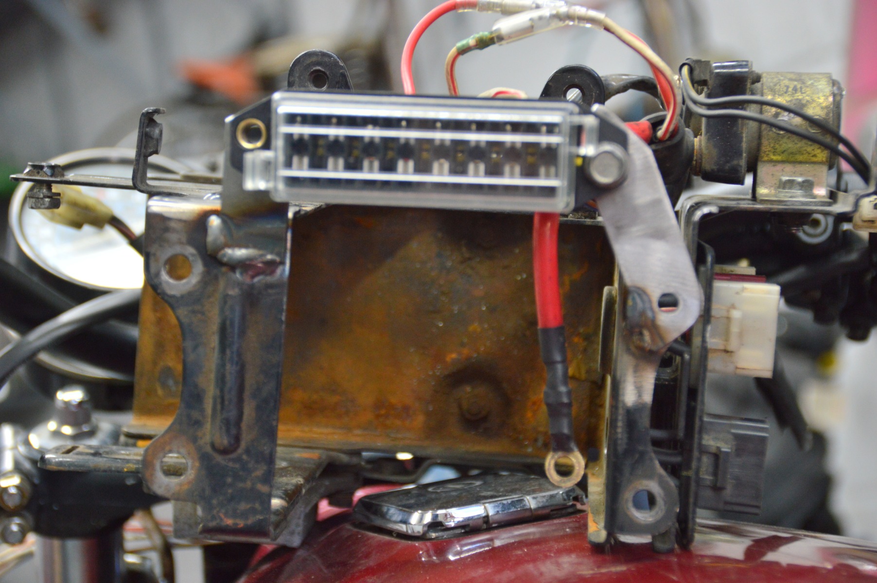

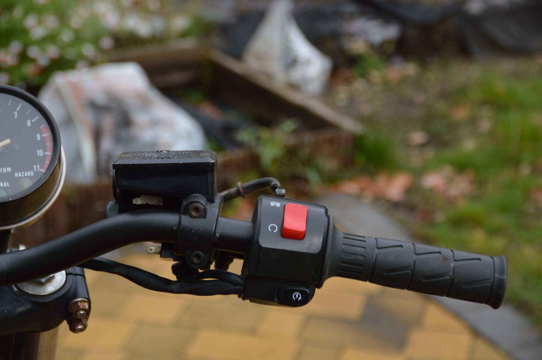

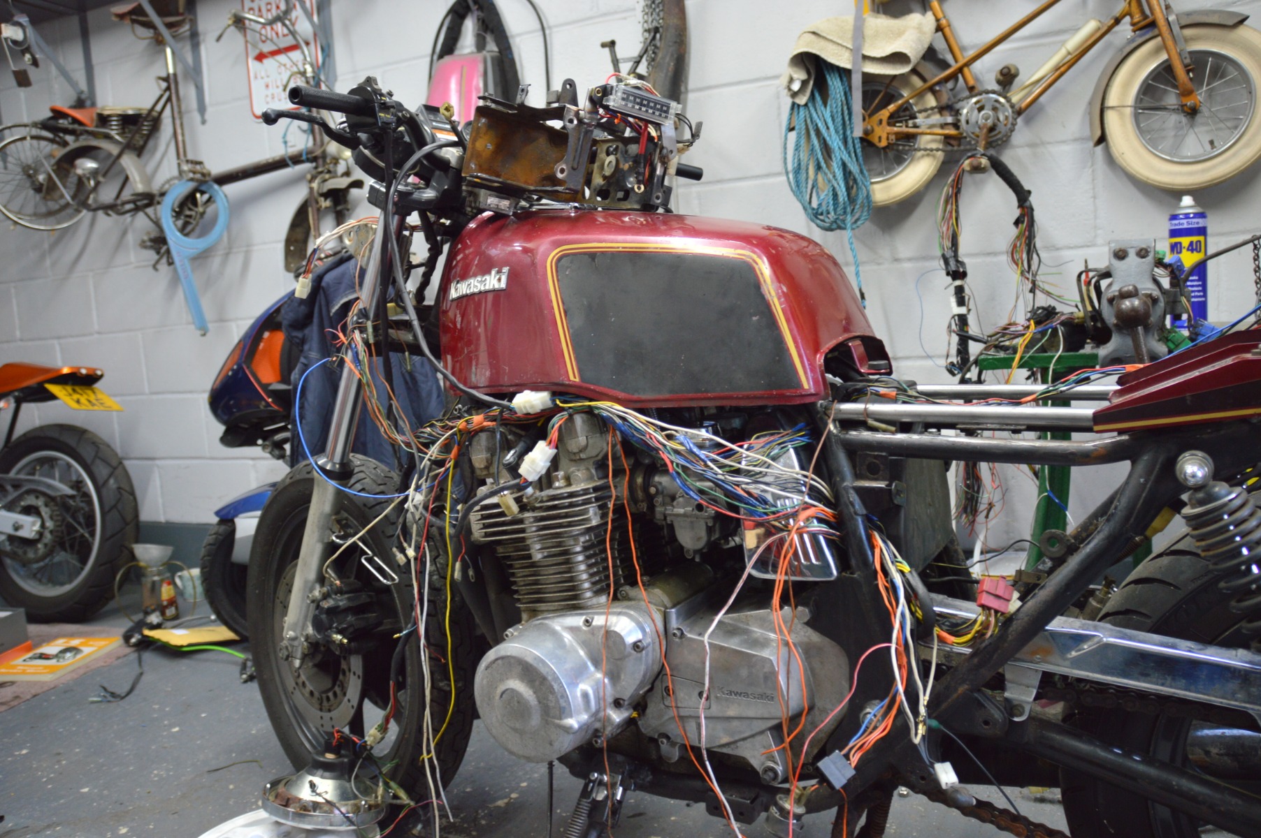

electrics finished, got rid of safety devices and light bulb fail unit thing. two relays added for high/low beam it even got hazzard light which is new for me on a motorbike. swiches are from ER 650 luckily it seems kawasaki havnt changed wire colours so they were not too bad to wire

- perrykz1000
- Have a safe day !!
- Posts: 123
- Thanks: 32
Re: Z/KZ 1000 mk 3
26 Oct 2019 11:49
Great work. I used the ATC type fuses too. Much , much better system.

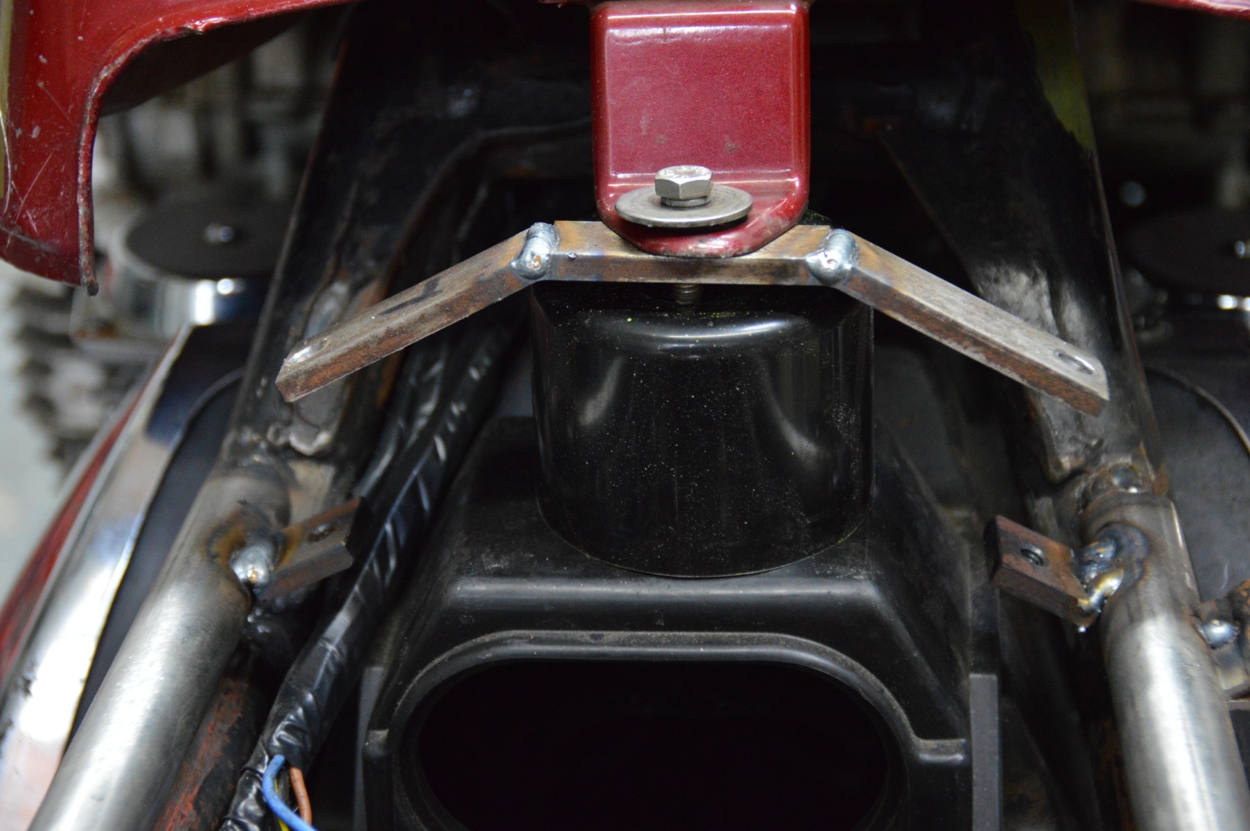

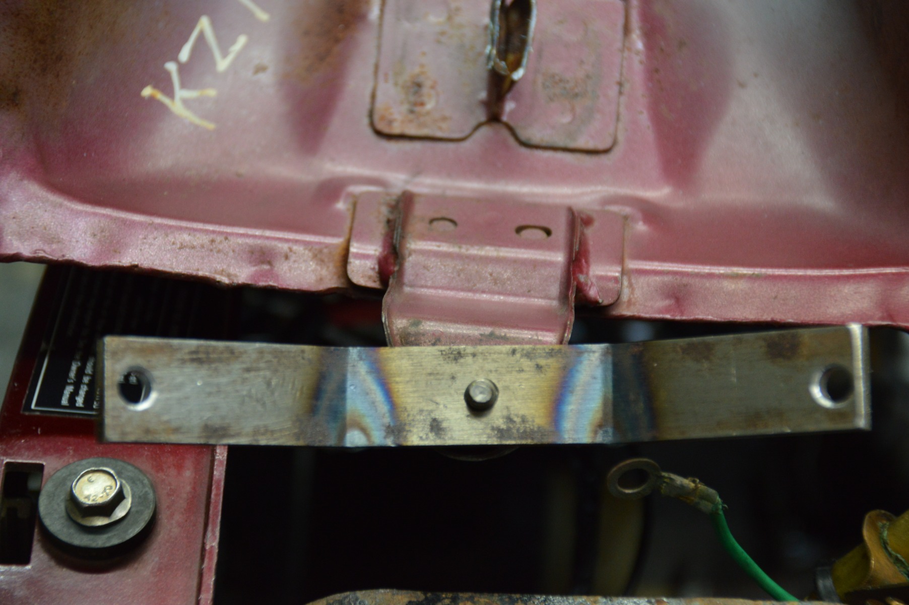

tank fitted without too much trouble and works with the CSR forks and triples and also KZ 1000p forks and triples. a bit of bashing on the inside to clear frame rail at the rear
im going to be using the standard airbox so had to make something up for the rear that could unbolt
