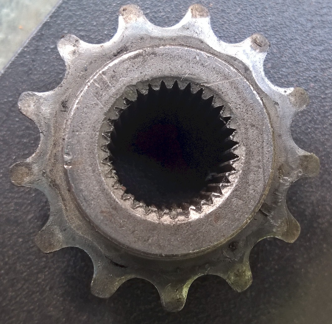

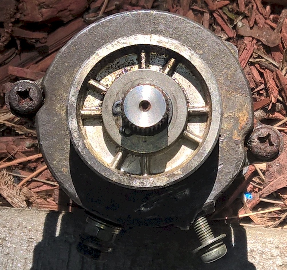

Someone asked earlier this summer about the number of splines on a Kz400 starter. I took some photots and will repost them for anyone searching.

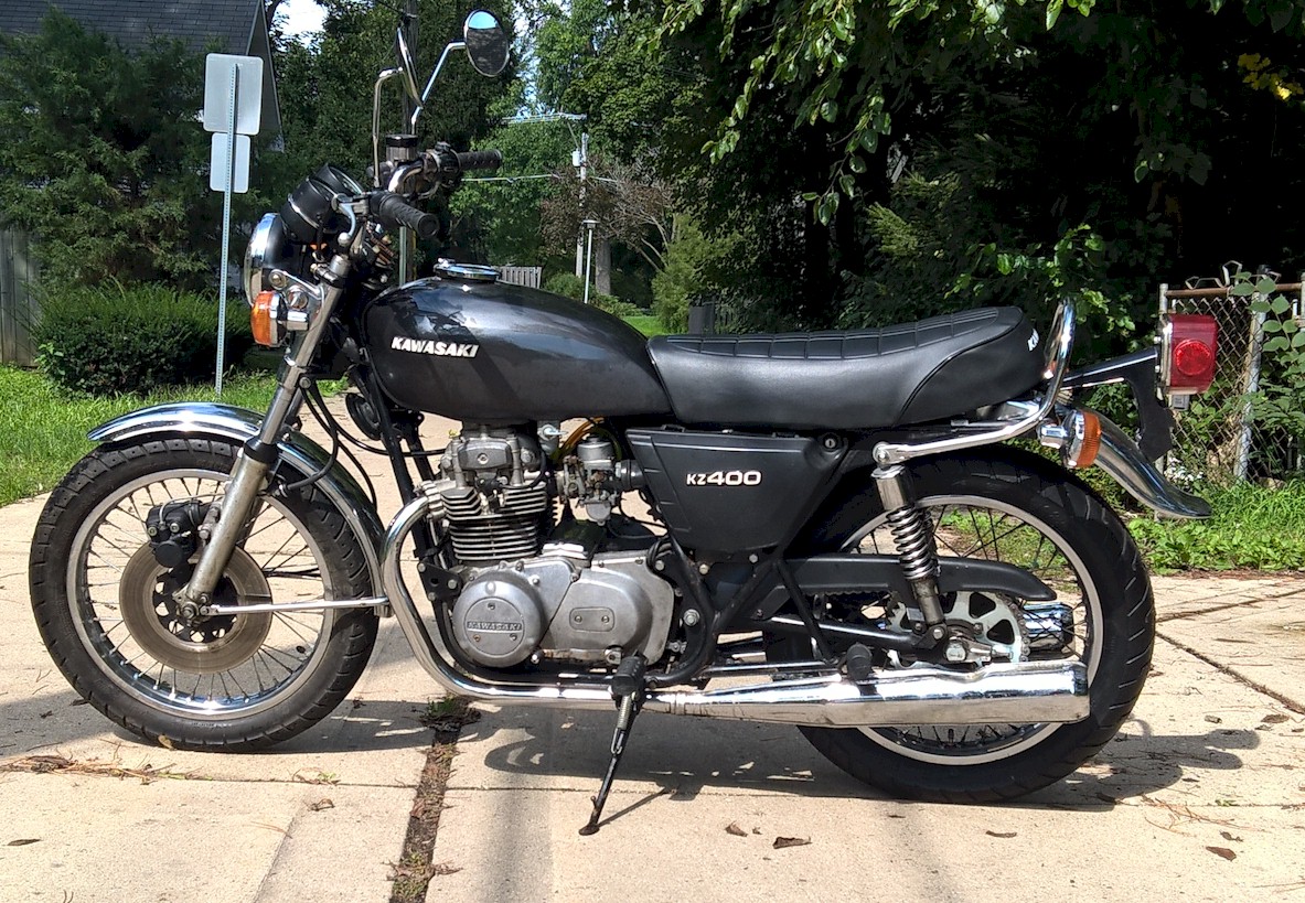

The bill of sale says 1976 D3.
Engine is K4E 055500
The bike had a starter clutch and front disk brake.
That freeze plug in the starter hole was put there by me temporarily.
Yes, I agree the 400's seem to take a lot of abuse. Maybe because they don't go for a lot of money. But they are a great first bike, what with being full size but very tame and predictable.

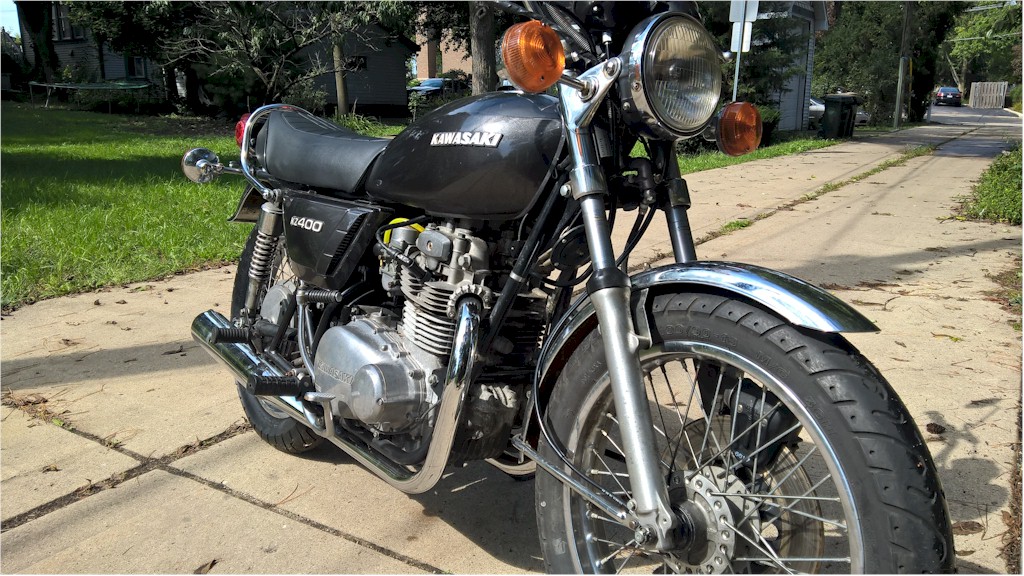

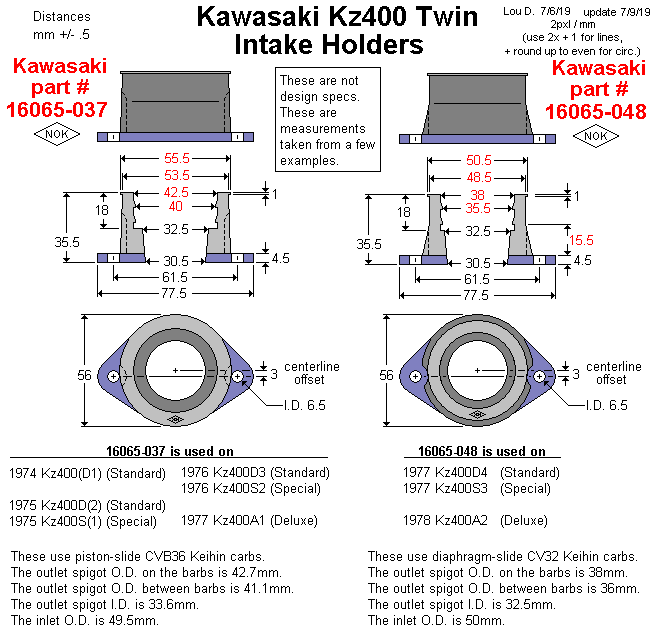

So we changed the oil on the D4, replaced the carb holders with new ones, and installed the D3 carbs on the D4. Along the way we played musical carbs so I made some drawing of the two motors/carb holders. I've posted these before but I wanted to put them here to have all in one place.

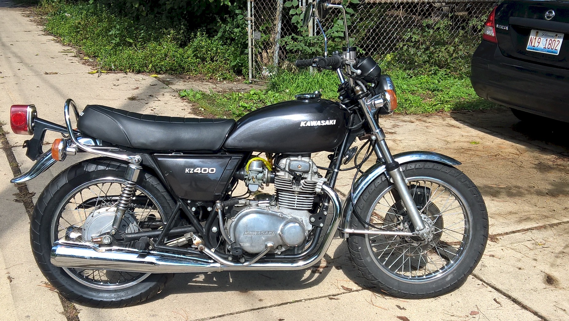

After doing a quick clean of the D3 carbs, D4 fired up nicely.
However, of course, because the D3 owner did stupid stuff, I discovered one of the enricher jets was drilled out to about 1/16". I guess that was the smallest bit they had? They couldn't just buy one? So the left carb has a drilled enricher jet. All the rest of the jets measured out to be stock. We will have to source one. Probably Jets R Us.
The bike still starts easily, but you have to take the choke off right away.

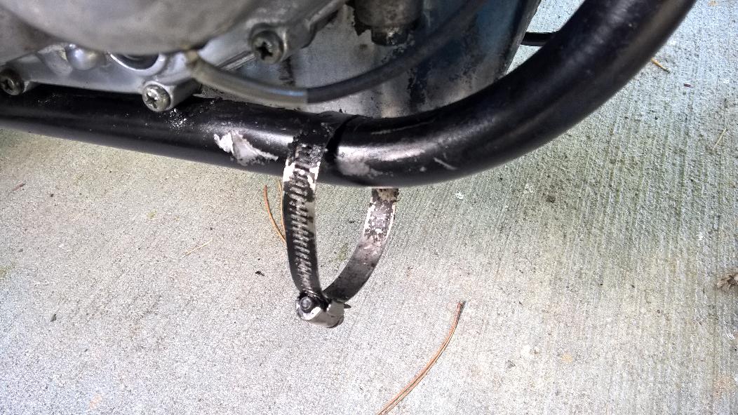

The D4 had cutoff header pipes for an exhaust system.
Here is what they used for an exhaust hanger:
My buddy scored a very nice stock system at a salvage place in Milwaukee, and he and his son installed it with no issues. New exhaust gaskets. Very nice. A bit quiet, but I bet the neighbors appreciate it.
My buddy's son also did a very nice job on recovering the seat. It was his first attempt... looks very nice. (I thought he just bought a new seat somewhere).
We also did new oring chain, sprockets, and rear tire.
It's coming along very nicely. I personally don't like that yellow Tygon fuel line. We will source some nice gray or black 1/4" lines that are not reinforced to keep with the stock look.

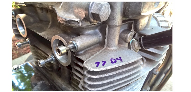

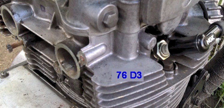

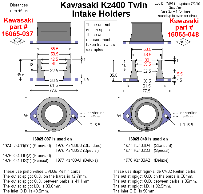

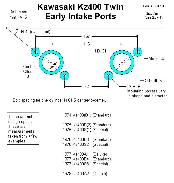

Along the way I documented some differences in the D3 and D4 head castings. I don't think the differences affect any functionality and parts should swap from one to the other with no problem.

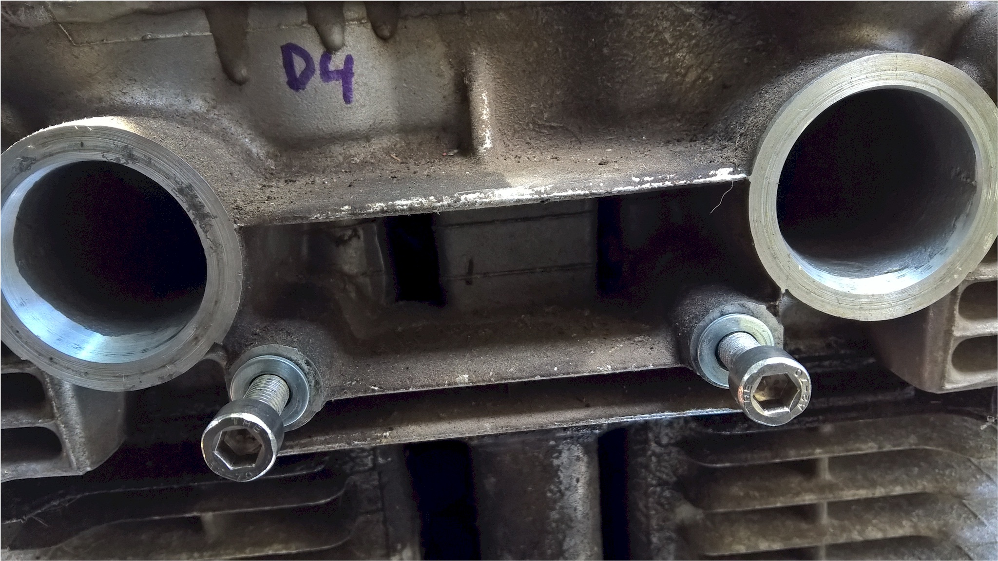

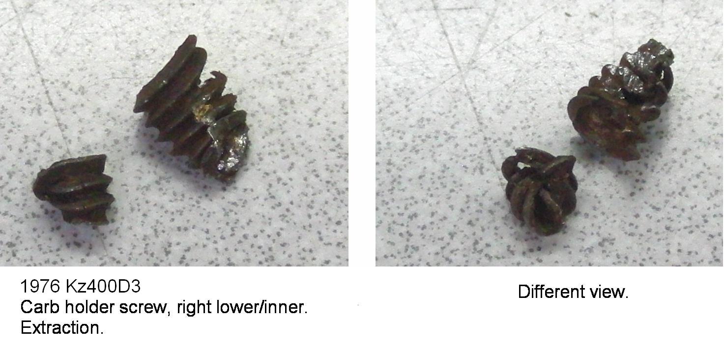

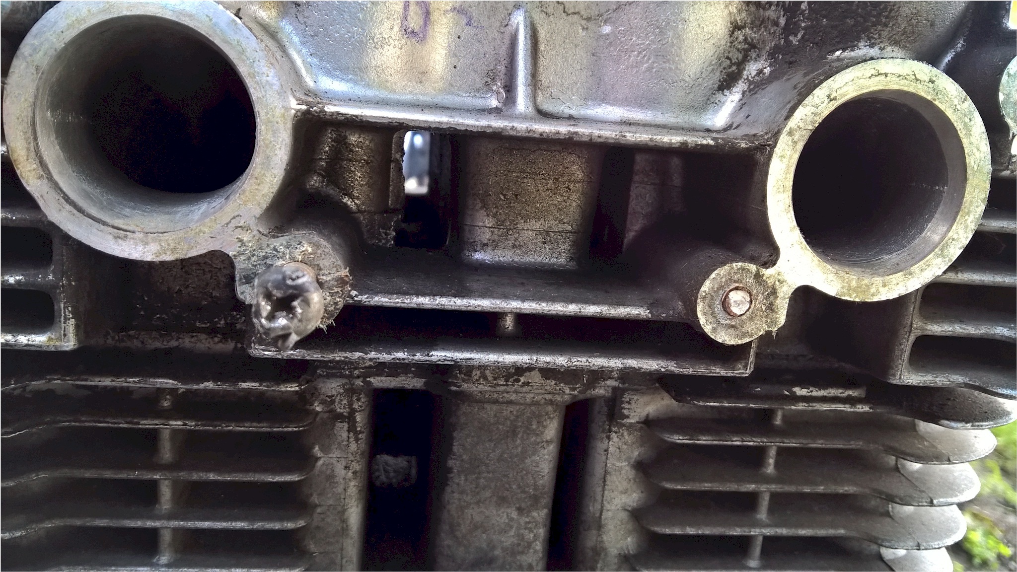

As can be seen in the head photos above, a couple intake screws were snapped off. One was snapped off almost a 1/2" into the hole. That was after the easyout was bale to get part of the bolt out, the bolt snapped inside the hole.
In the same photo you can see the mangled head of one of the other screws I was able to get out in one piece with a chisel.
I had to use a chisel on the D4 head screws as well, but all of those came out in one piece. Now they are replaced with stainless allens.
After a couple hours of very careful drilling I was able to crumple the remains into a little ball and pull it out with a tiny hook I made out of a small spring. I had to do this on two holes. The easyouts were not going to budge them and I didn't want a broken easy out debacle. The threads in the head survived in pretty good condition.
