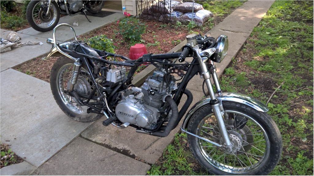

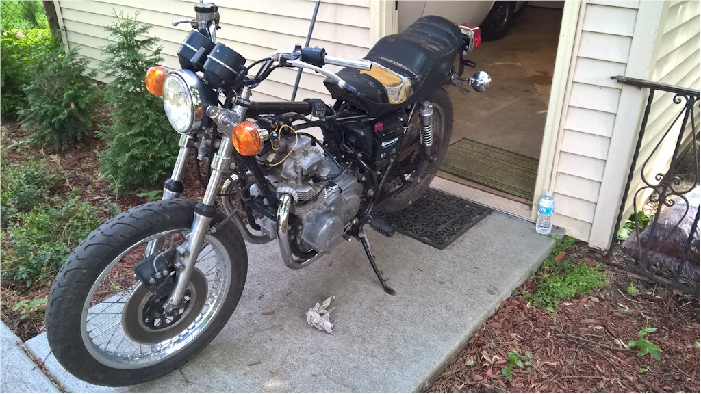

First, here is the D4, at least back in July or so. This photo makes it look rougher than it was.
Next is the D3. This photo makes it look way better than it was.

The D4 had a locked up front brake and desperately needed a rear tire and chains and sprockets. We also finished up an oil change that was started earlier. They drained the oil and noticed the drain plug seal was messed up and the oil filter was missing the washer for the spring, so we ordered those parts and buttoned it back up.
After getting the oil change done I decided to hop on and ride it. It actually started up with some coaxing and I managed to go up and down the alley. I could tell it wasn't revving fully so the carbs would be next. We didn't have the tire and sprockets yet.

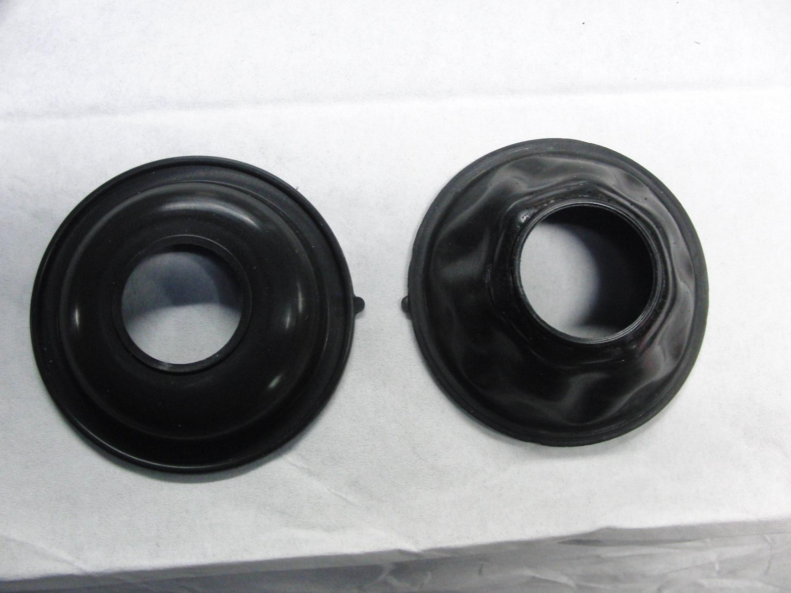

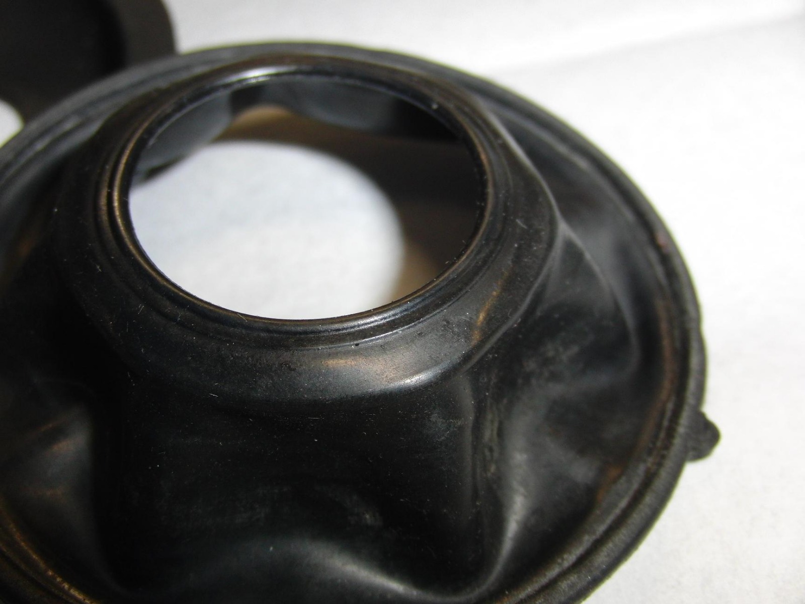

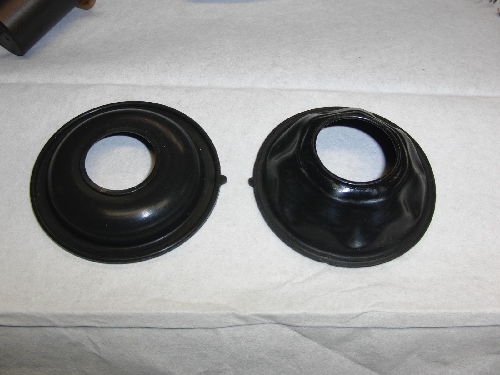

The D4 uses carbs Keihin Cv32 (or CVB32 ?) with rubber diaphragms and as I suspected they had little tiny rips right near the slide attachment. We scoured the internet for diaphragms, but couldn't come up with any direct replacement.

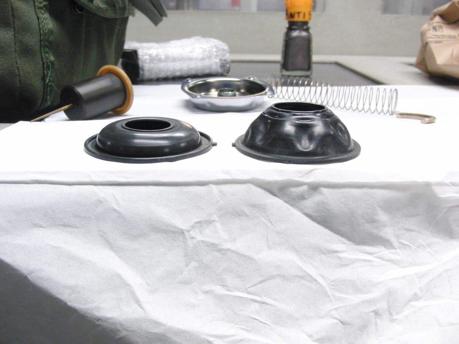

So we tried some diaphragms from a Honda model. These are meant to be put over the slide after removing the plastic securing ring.

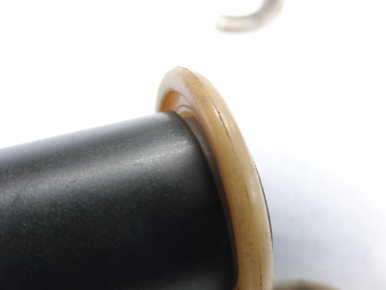

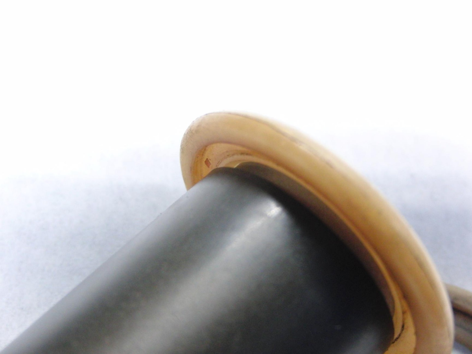

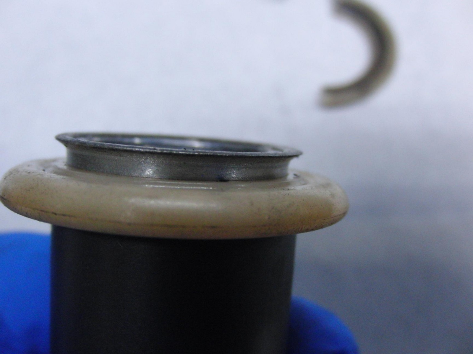

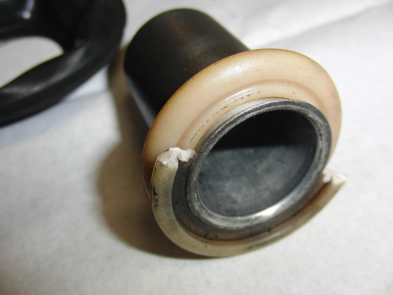

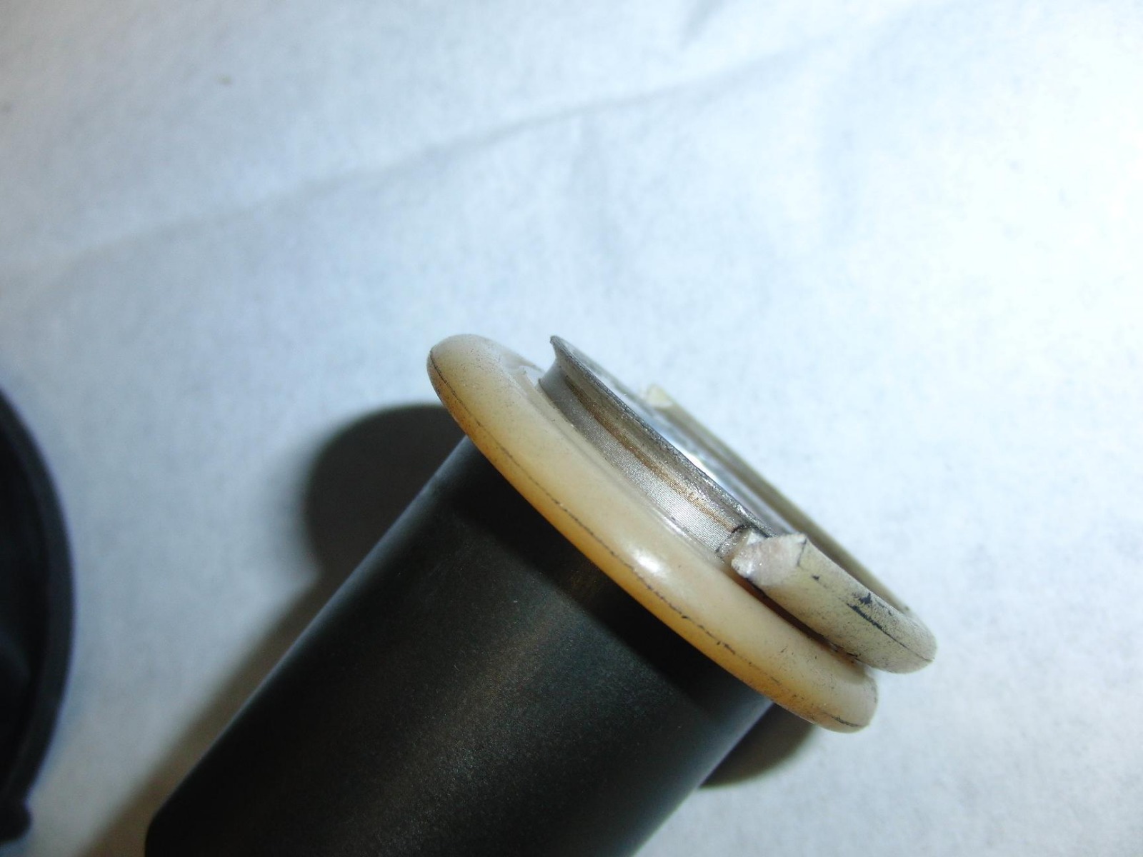

I'm posting these photos to anyone who might want to know what's under the securing rings without breaking them. The slide is machined very thin and then the lip is formed into a "rivet". The diaphragm has a molded-in oring on the lip, which gets sandwiched between the two plastic rings, which lock it in place and provide a smooth, round surface for the diaphragm to form against as it goes up and down. The factory systems is a very good system for longevity, but is not serviceable at all really.
The new diaphragm will just have a really fat, square oring at the lip which will grab the groove of the slide. I'm not a big fan of this plan as it does not make for a smooth curve for the diaphragm to move around. This will lead to a short life, I suspect. But there really is no other option unless you can get lucky and find a source for the original parts.

Well, it was a no-go. The new diaphragms didn't have enough "cup" to them. They are just simply too short to allow for the slide to move all the way.
There is also no way for the new diaphragm to hold the slide in the right rotational position. The old diaphragm held the slide securely so it could not rotate.
It's ok, I'm not a big fan of diaphragms anyway and we have piston-slide carbs from the D3 bike.

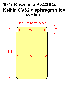

I was glad those carbs were not useable because it gave me an excuse to do two things I've wanted to do on Kz400's... one was to confirm the older piston carbs can be installed on the first-gen bikes that came with diaphragm carbs. And it also gave me an excuse to put on some new carbs. In our case we ended up with Chinese knockoff VM30 carbs that everyone on the internet says to absolutely do not use. I guess I like a challenge, or I'm just a sucker for punishment. We'll see.
For others who may see this, here are some dimensions for the 1977 Kz400D4 Keihin CV32 diaphragm carb slide.
The diaphragm's OD is 72mm.
The diaphragm's ID is about 24 mm to 25mm.
The diaphragm needs about a 19 or 20 mm dish I think.
The new diaphragm that did not work, I think had a nominal 13mm dish.

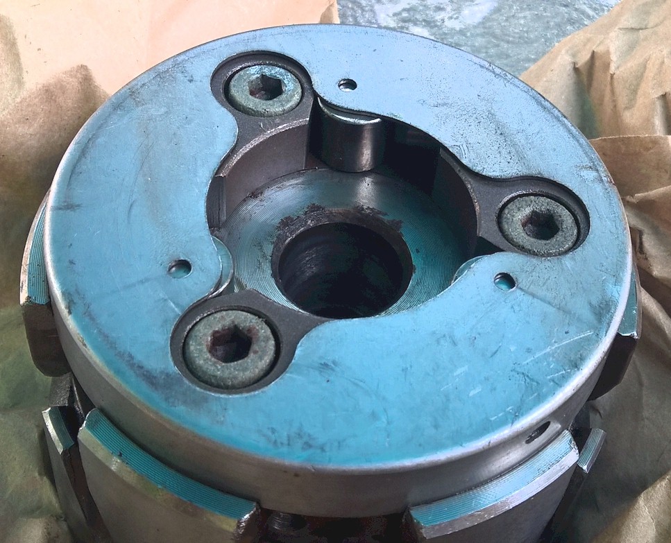

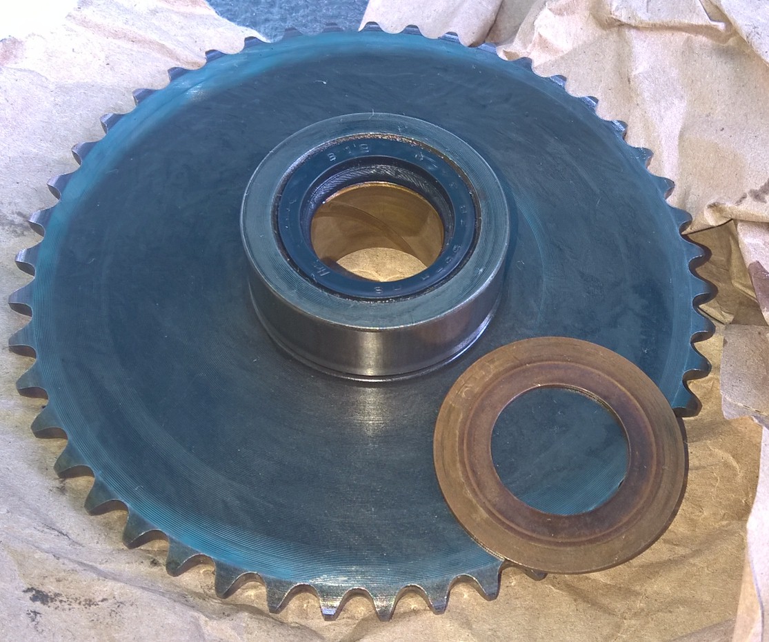

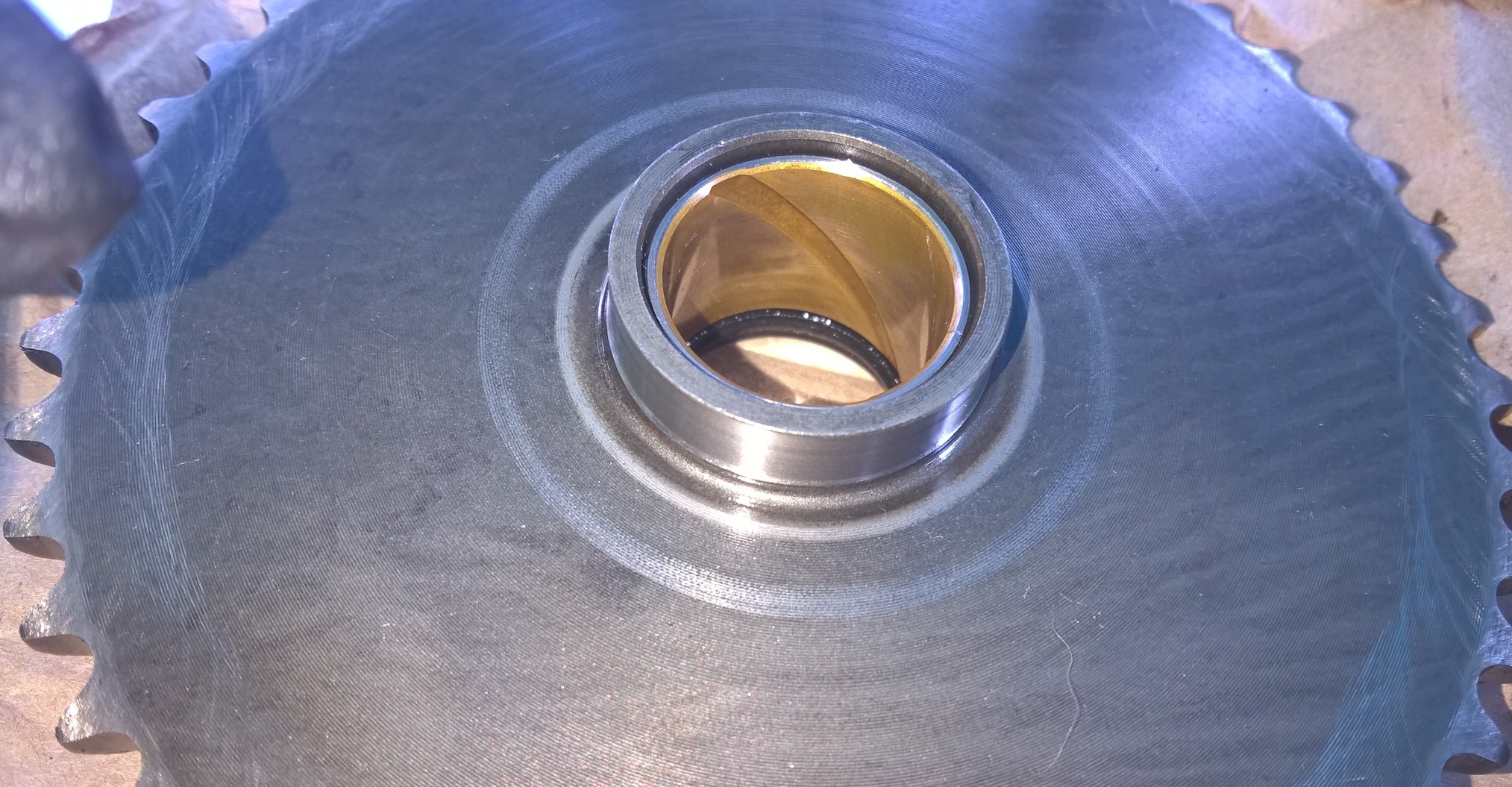

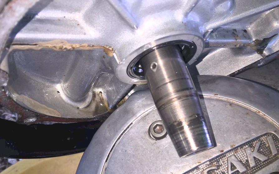

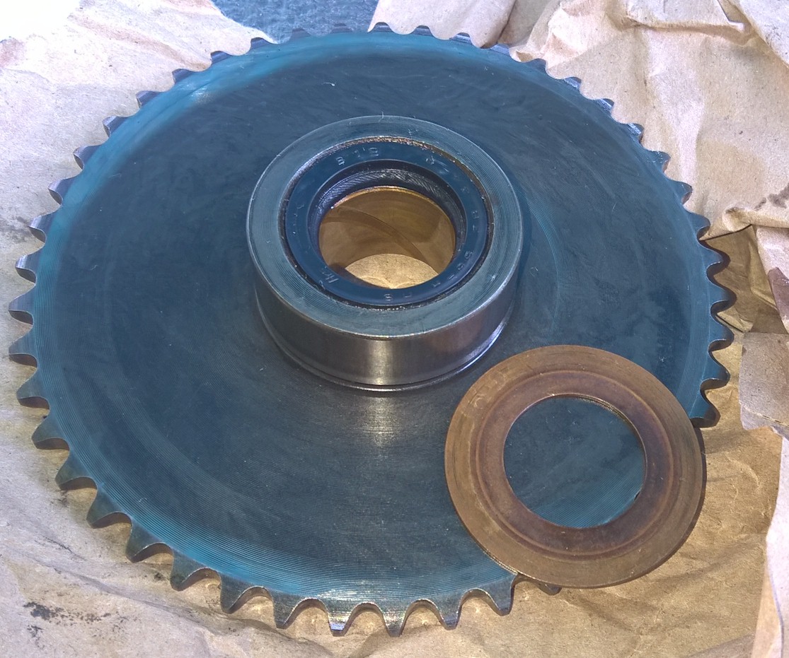

When I went to kickstart it, I noticed this bike did not feel like other Kz400's. I've spent a lot of time kickstarting 400's and they have always been a pleasure to kick. That is they feel smooth and have very little "kick-back". Meaning when you push your foot down, a firing will not push your foot back up.
This particular bike was painful. Almost every kick would try to throw you up over the seat. And if you weren't ready for it, your ankle was toast. So I looked at the timing. And yes it was far off, too -advanced, of course, so I put it back to where it should be. But I've had Kz400 that were too advanced before, and they didn't kick back like this one.
This bike is the first-bike for my buddy's son and this kickstarting is going to be very discouraging.

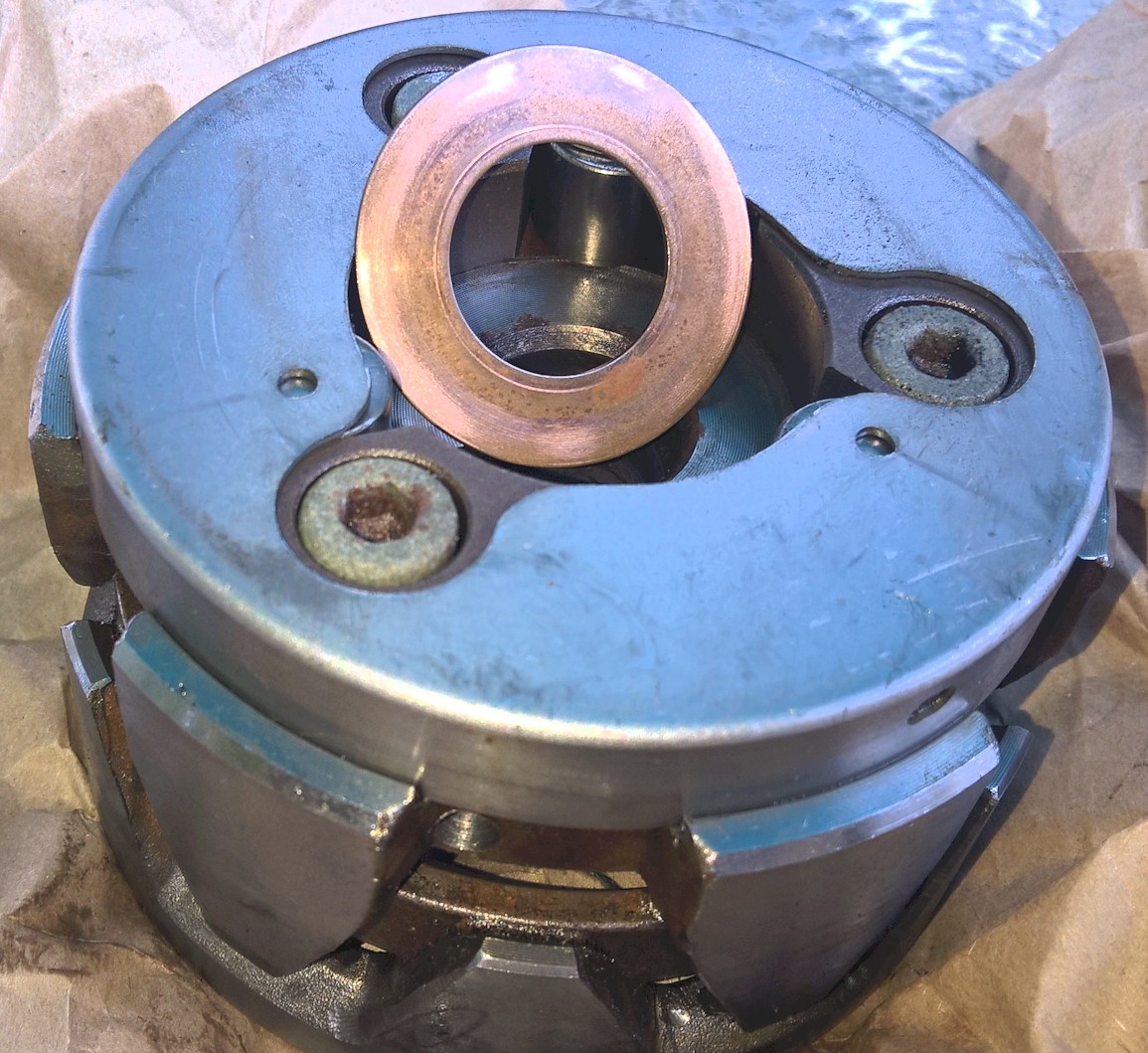

I also noticed a bit of noise from the starter area that sounded as if the engine was somehow still spinning after I know it stopped. So off comes the alternator cover. Here's the problem:
I know they did this because they turned it the wrong way, probably with an impact gun. RTFM! It shows it's a left-hand thread. Since they broke it off and decided not to fix it, guess how they attached the flywheel? Epoxy. Yes they used epoxy to hold a flywheel onto the crank. I was hearing the entire flywheel and starter clutch assembly freely spinning and moving about on the end of the crank. It's a miracle it didn't do much damage... a few scratches on the end of the crank.

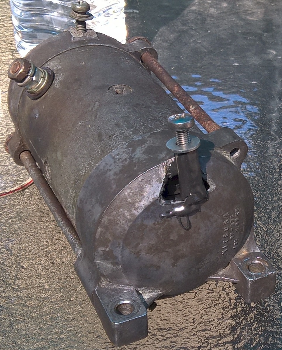

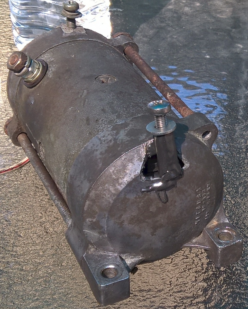

Along they way to looking at the alternator, I had to remove the starter. Yes it was only held on by one bolt because the other one is sheared off in the motor. I also fond they broke the case end of the starter motor. Here is how they fixed it:
Actually, if you look closely, you can see they broke the case at the other end of the starter too, but there was enough metal left to insert a bolt.
So now the battery and starter solenoid make sense. They were deep-cycling the battery as a total loss electrical system while only using the kickstarter. That would also explain why the huge battery would not hold much of a charge. it would go dead in a matter of minutes with no headlight and ignition-only.
This bike is turning into one of those bikes where everything you check is either broken or done incorrectly.
For example, just in case, I checked the nut for the kickstand... finger tight ready to fall off.
Shifter linkage... bolt loose, threads stripped.

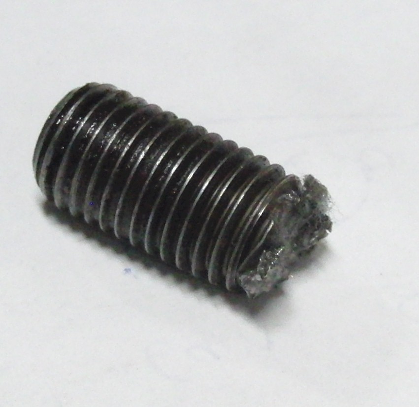

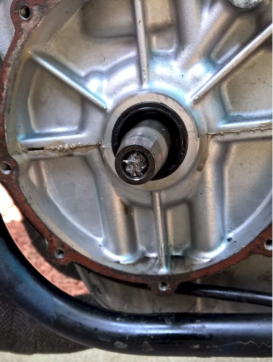

An hour later with a lot of new swear words... got that little bastard out with a some carefully crafted small chisels I ground from an old punch.

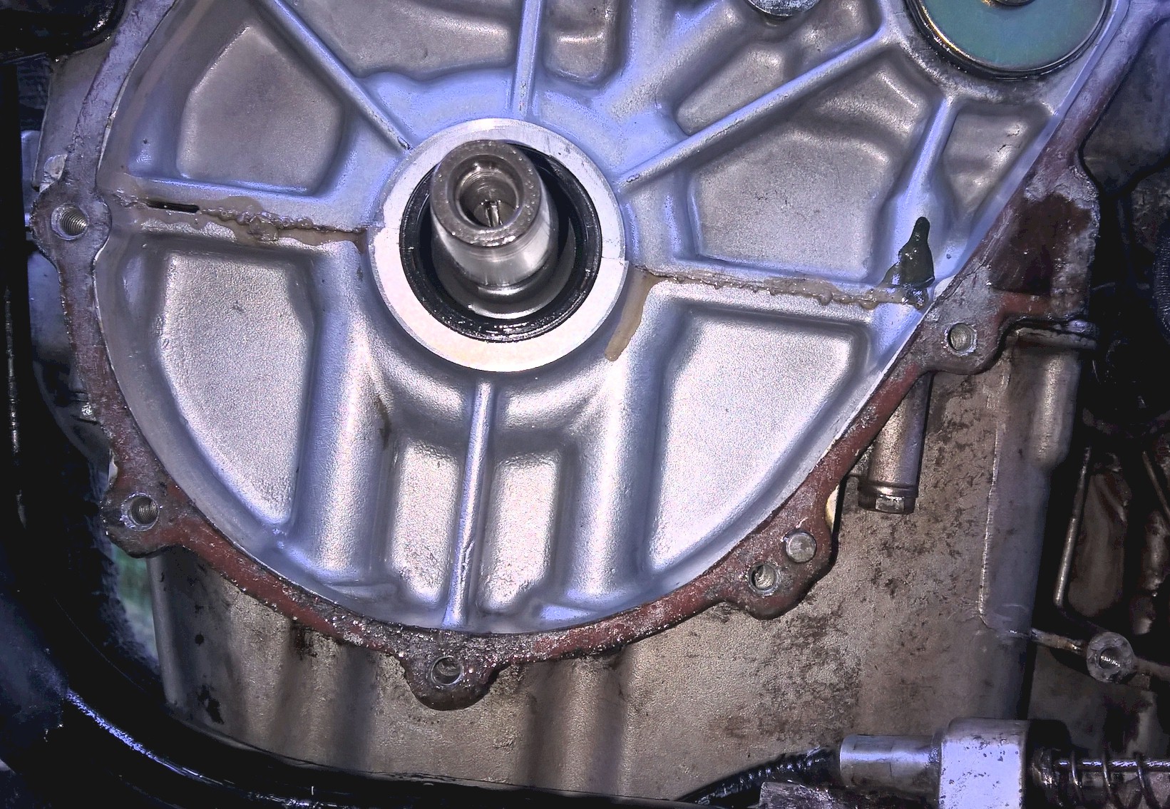

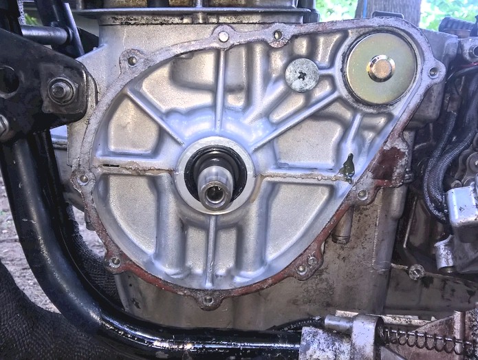

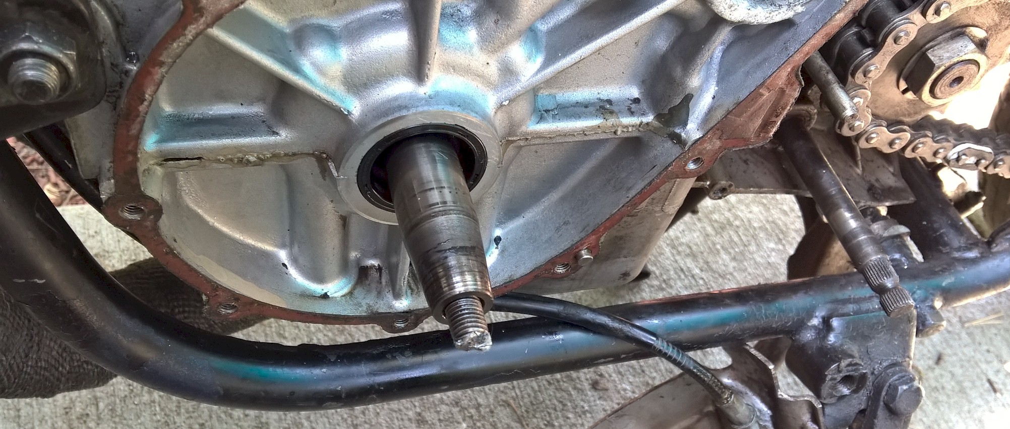

Also, there have been questions in the past about whether or not the alternator housing on a Kz400 should have oil in it. Well this one did because the flywheel was as free as a bird. But I believe it should not have oil. Any oil is the result of leakage past either of two seals. There is a seal between the crank and the starter clutch and other between the starter clutch and the crankcase. The crank has an oil hole used to lubricate the starter clutch bearing on the crank.
Notice there is not return hole from the alternator housing back to the crankcase.
