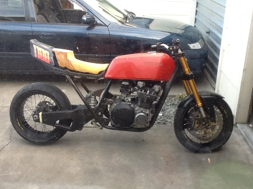

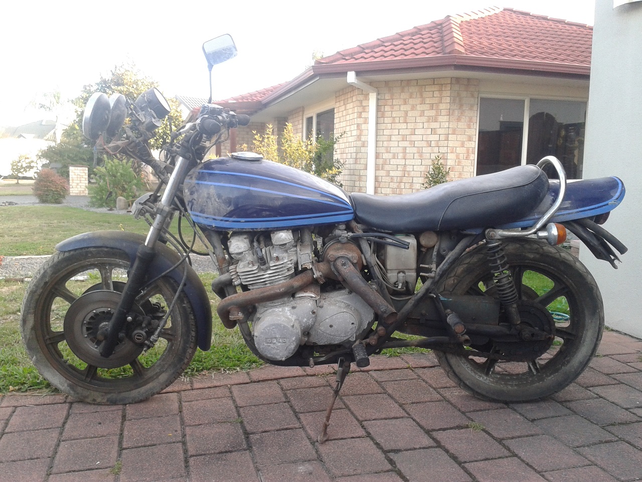

I have 2x 79 KZ1's. Ones turboed and the second is a half scratch built ST
The first one I acquired was the turbo which had been parked up for 10+ years in a chook shed and in very poor condition and been left in mine now for probably another 5 :S This was built back in the 80's and from what Ive heard was based on a drag setup but used on the road. Apparently it has Mtc forged rods and pistons and a welded crank? From the outside it has a big Rayjays turbo, Austin 1100 carb and water injection using god knows what vehicles fuel pump

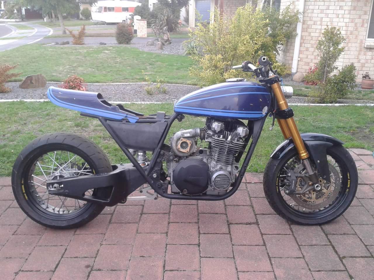

The second one the guy had a pretty cool vision but ran out of time & money etc. So this is an ST (shafty) frame for the wider swingarm pivet point which has a 2010 R1 swingarm, 2010 Zx6r forks, Ducati Sport Classic spoked wheels and GPZ1100 body work and more. In the photo thats an 1100 engine but since gone)
And the MERGE
I really dont know which way to head with this thing and totally understand this will be a ground up rebuild but most the funs in the build and have plenty of time on my hands after my recent accident that might be the end of my road riding days ...... for now!
I love building one offs so I want to keep things pretty close to the original styling but stray a little if you get what I mean. Bigger brakes, tyres and suspension are a must (I love racefit builds)
Do I mod up the engine with later model gear ie turbo, carb, fitting etc or try keeping it period, water injection, copper fittings etc?
I know this will possibly get me shot but I kinda dig the gpz tank and tail
Let us have it, what are your guys thoughts?????
Im not 100% sold on the R1 swingarm so any suggestions (if anyone has a chunky spondon lying round hit me up

And the MERGE

Like the direction you're going... and I secretly also love the 1100 tank and tail

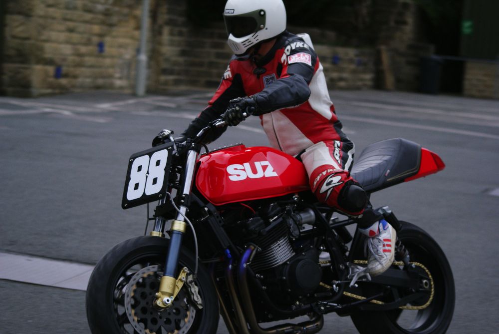

Dont get me wrong I absolutely love the original look but have always had a chub for this racefit gs1000

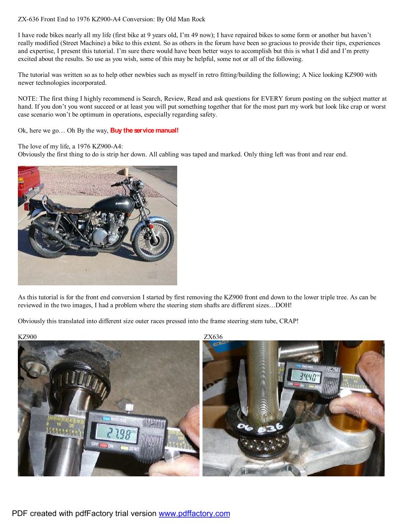

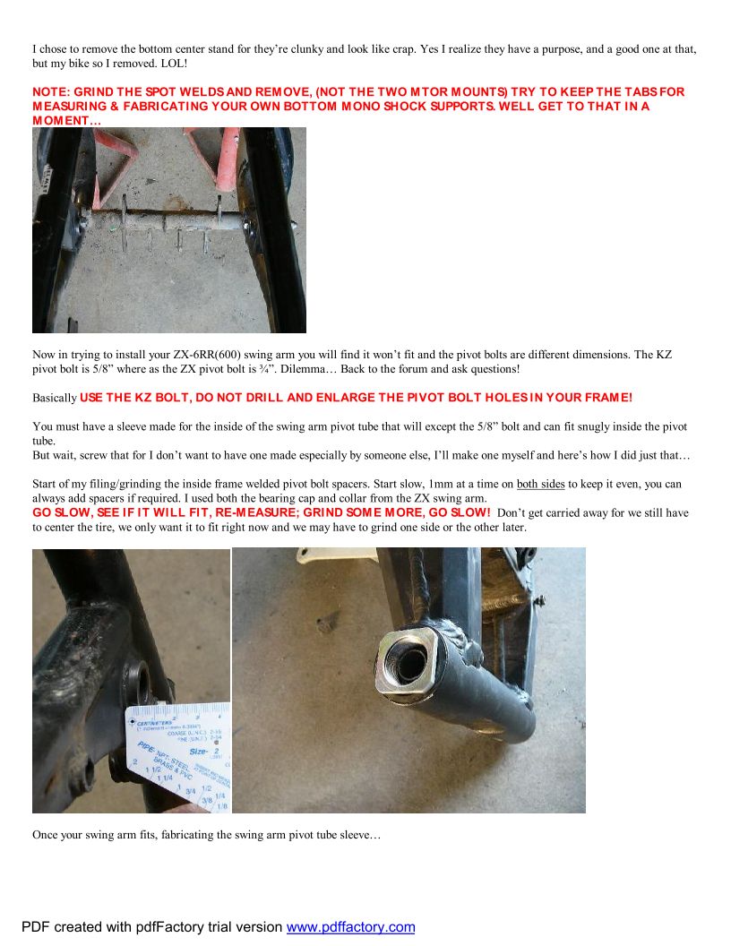

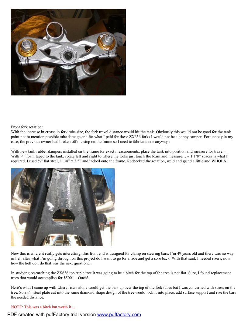

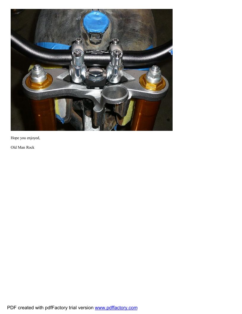

for Mr.Wizard: a front and rear end conversion howto by Old Man Rock

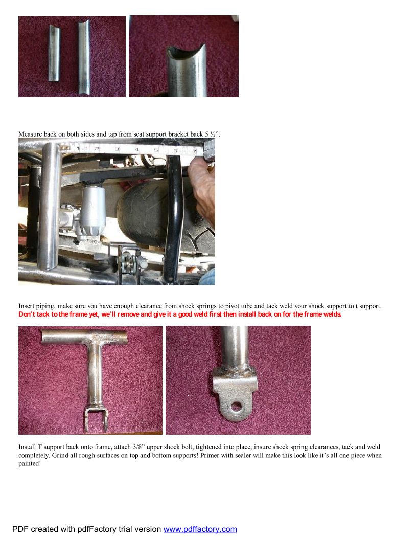

...and here are the rear end conversion pics
