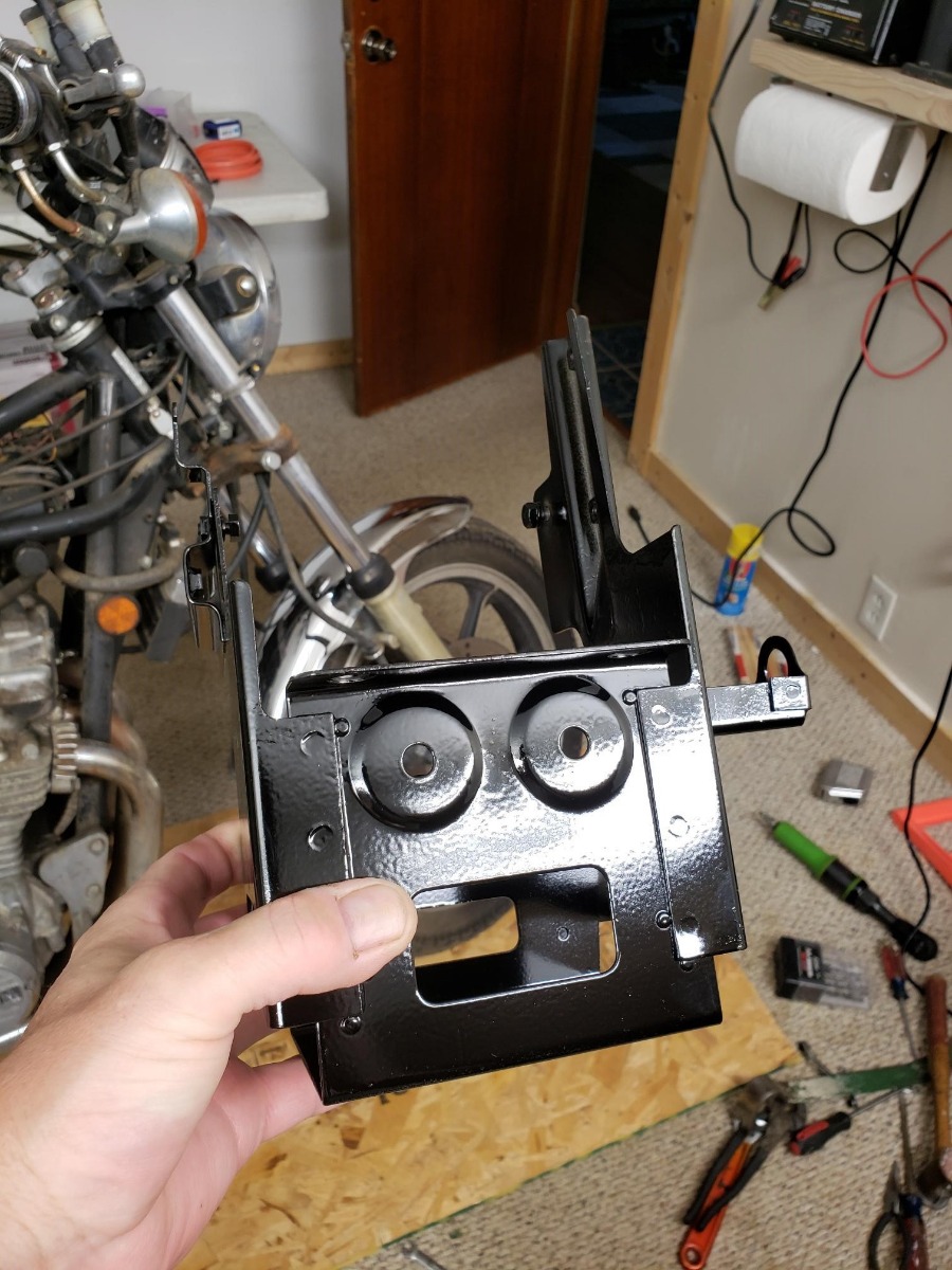

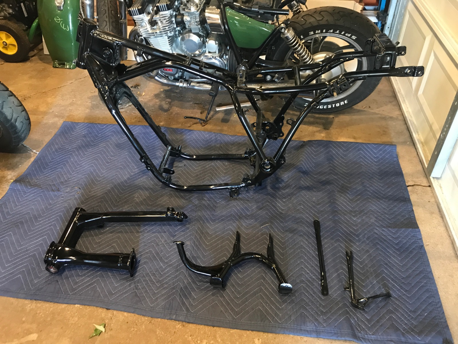

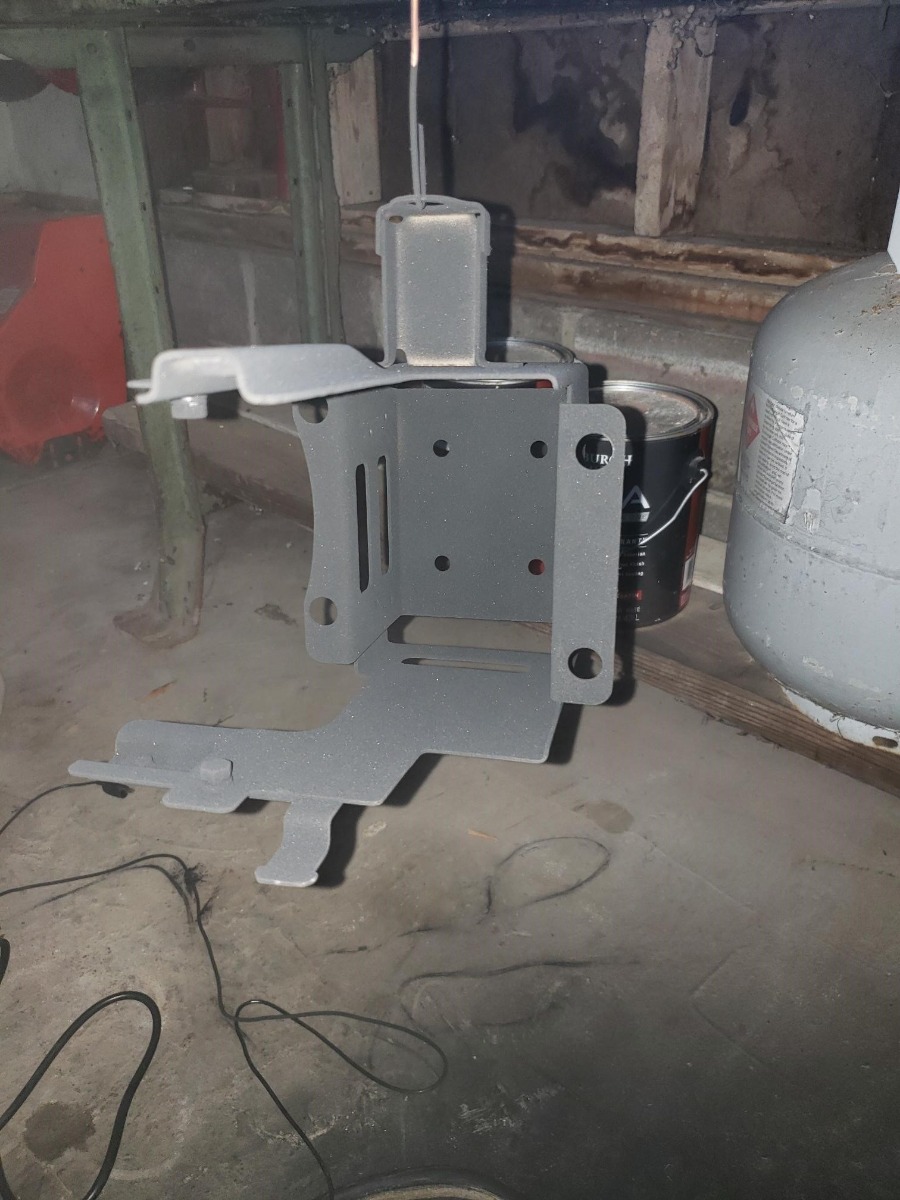

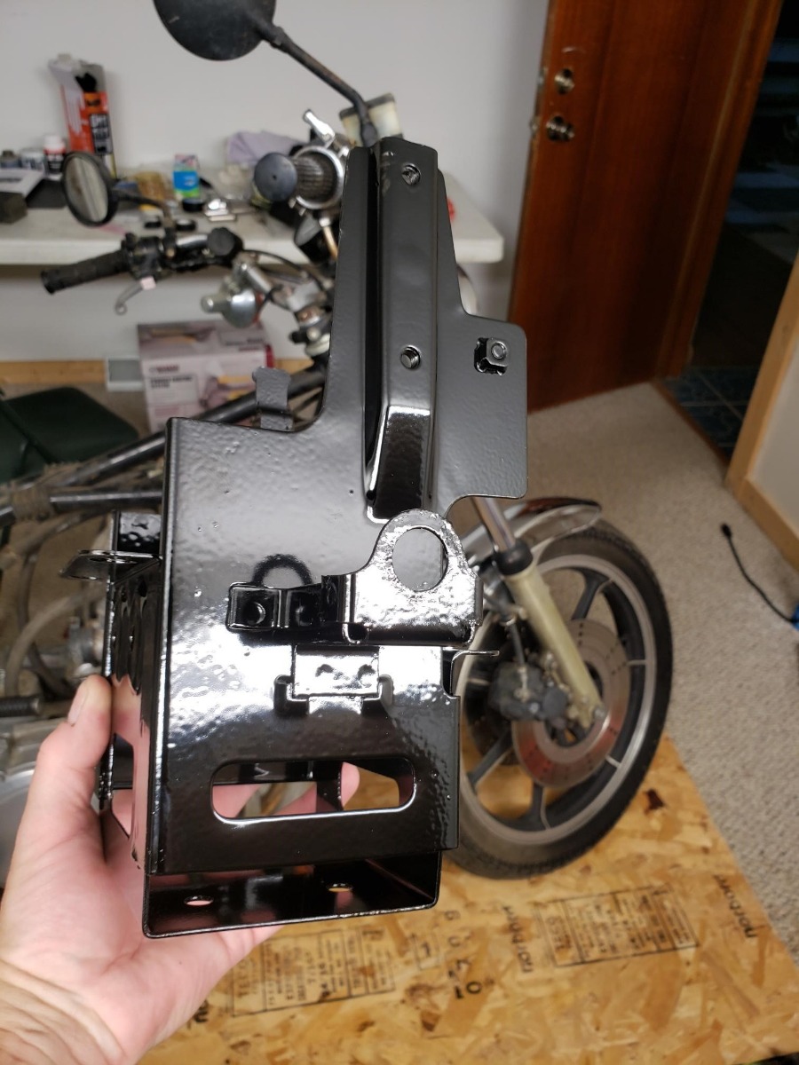

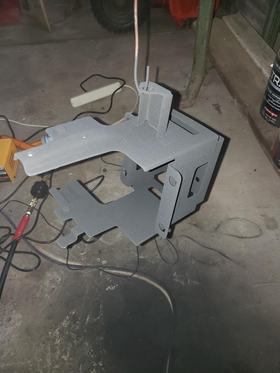

Well, here's my first attempt at powder coating. I'm pretty happy with the results, especially based on the condition that I started with. I have a LOT to learn, but it's a fun process.
Warner
Warner
