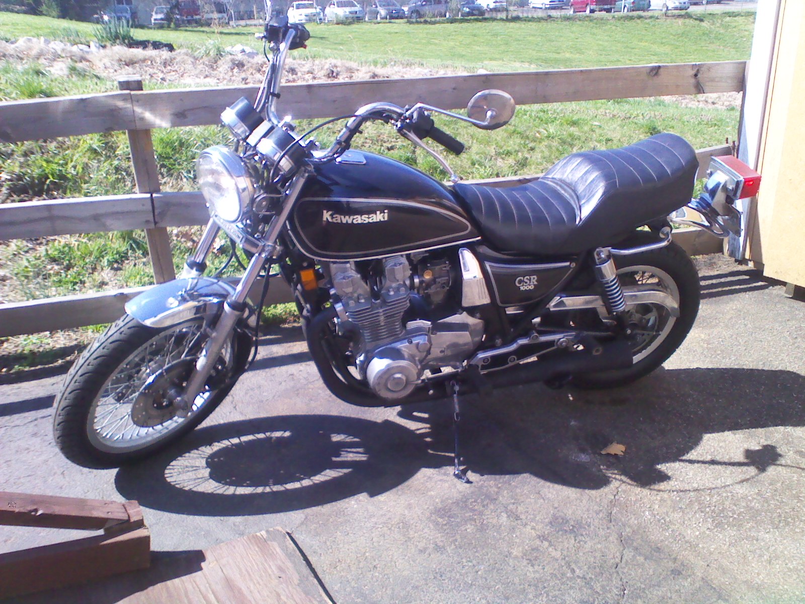

Hello,
I recently purchased a 1982 CSR 1000 that I will be doing some maintenance and small modifications to in order to get it ready for spring. This is actually my first personal roadbike. Never got my M license but I have a ton of riding experience. Yes, I'll get the license before springtime. Waiting on some parts, but here's how it currently sits.
The current plans are:
Removed the Clip-Ons and installing Clubmans
Raising the headlights and electronics up (PO had them moved down)
Clean up the cables/wiring
New pod filters/Tune the carbs
Eventually make a custom seat (no more king/queen)
Fab up some rear-sets
Wrap the Kerker 4-1 exhaust
Looking forward to browsing the forums and getting to know everyone!

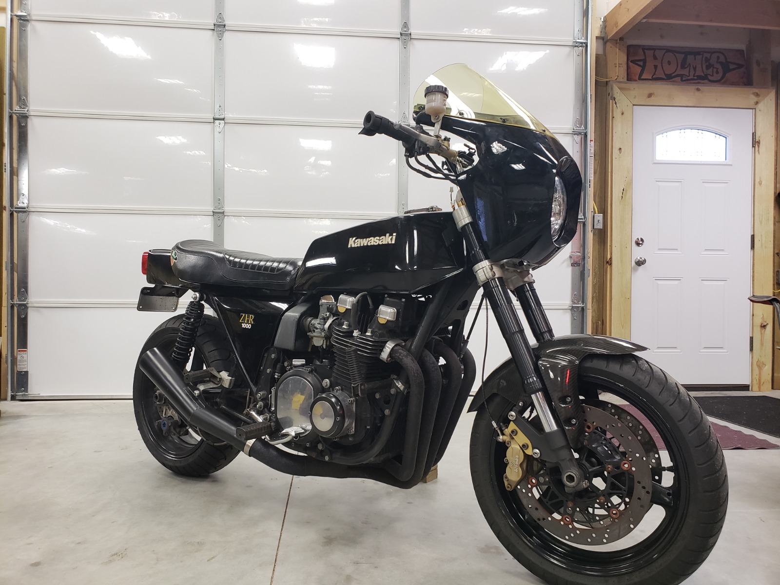

06 Mar 2019 12:46doomwizard wrote:531blackbanshee wrote: pipe wrap will finish that poor old kerker off.
You think? It seemed easier than refinishing with ceramic coating. Whats your reasoning for thinking it will finish it off? Moisture?
yes sir it is easier which is why you see it used so much..
but, the heat wrap holds moisture and the heating and cooling exacerbate the problem.
a media blasting and some header paint is pretty quick and easy,then in a few years depending on how you store your bike you may have to redo it.
a good ceramic coating is the best bet.but it's all in what you wanna spend your time and money on.
you currently have a nice clean bike and imho pipe wrap would cheapen and add an amateurish touch to it.
hard to beat a flat black kerker on these old beasts.
i submit my own bike as an example.
that's my .02 fwiw,

- Posts: 7447
- Thanks: 798
Re: doomwizards 82CSR1000
07 Mar 2019 06:57
thanks for the kind words.
as you can see in the pics it's time for a re-blast and paint on my header section.
my rear megaphone mount cracked.so i pulled this meg off of the shelf.but it was chrome,so i blasted and painted it black to match.now to get the big kerker emblem riveted back on.although i've been toying with having a stencil cut and painting the kerker back on this meg.a lil bigger and bolder perhaps :evil:
keep us posted on what you do with your bike.i think your is one of the better looking j-models i've seen.
