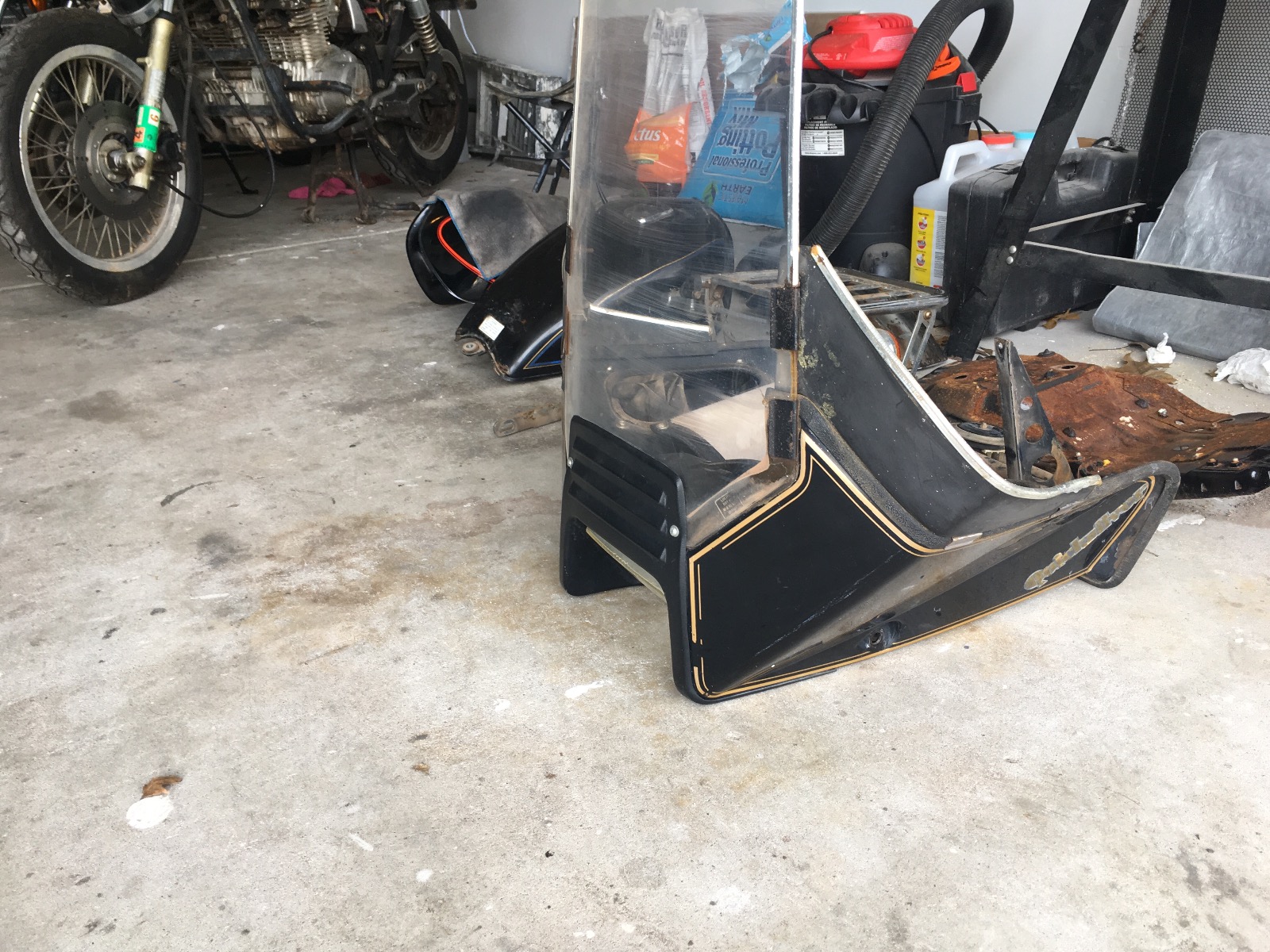

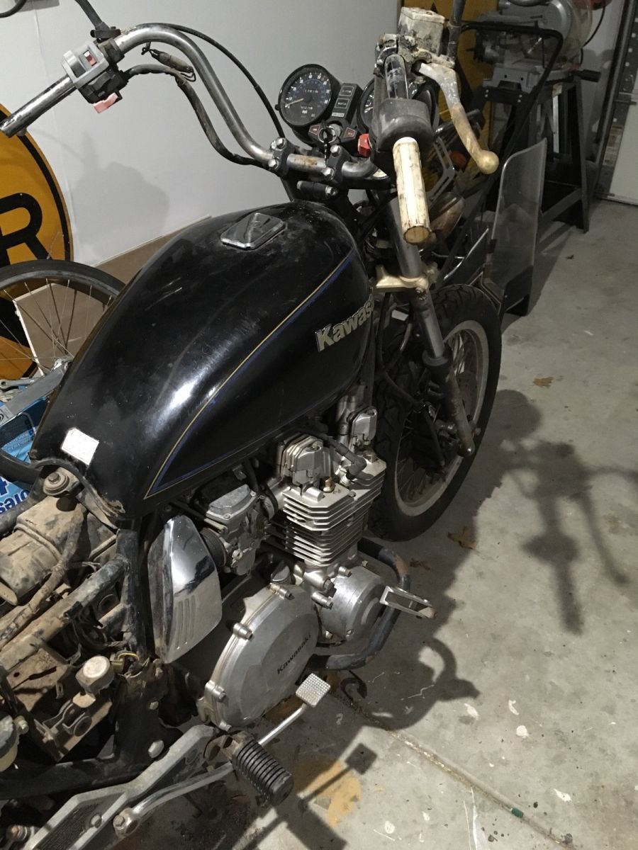

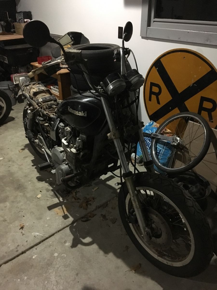

Picked up some euro style bars for the 82. Found an 80 kz1000 CSR parts bike for DIRT CHEAP. Picked it up, took the seat off and started working on a custom seat for the 82. Just got the parts bike running last night and I’m debating on selling or making it a hardtail chopper.
Attached are photos of the 80
