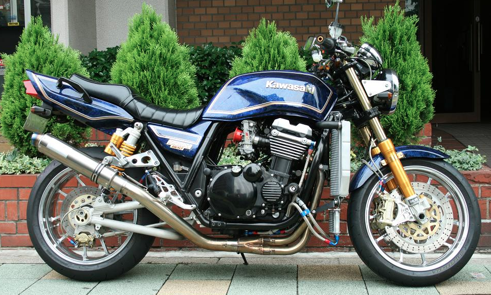

I would like to see a properly modded ZXR1100 which would more than satisfy your power craving. First mod would be a round headlight, please.

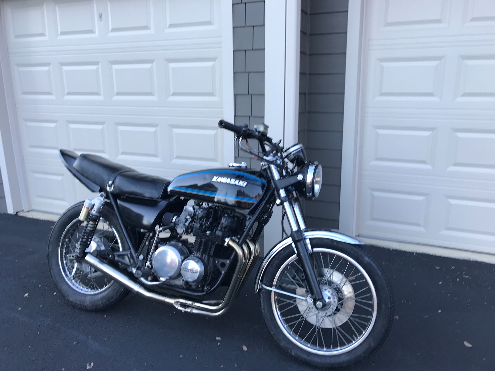

I follow this whole heartedly. I had a 2011 1100 hypermotard Ducati and loved it but the kz650 is just more fun.
If I can cast another vote build your kz650! I have. I don’t really like punching out the ccs on a bike for some reason it seems dishonest. Some people can build the 650 out to over 800 but it just seems like it would remove the soul of the bike.
BUT high compression and hot cams, in my opinion, simply amplify the soul!
My new vote is hot rod kz650! Attached image is my bike
