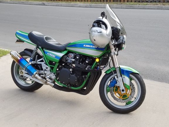

My son and I are starting a new project on a 1976 KZ900. This will be he's bike. I finished my bike a few years ago, I've attached a picture of it.
We will be upgrading the suspension so my question is what modern suspension will be the easiest to install on the old frame? I used ZX900 front end and a ZRX1200 rear end for my bike. We were thinking about using the front and rear from a 636 for his bike. Does anybody know if this is an easy swap to a 1976 KZ900 frame?

That's a very nice custom 1000. Sorry I can't answer your question about the frame mods. I'll let some of our more knowledgeable answer your question. I have a question for you: Did you know that your canister would blue the perfect color to match your painted blue accents?

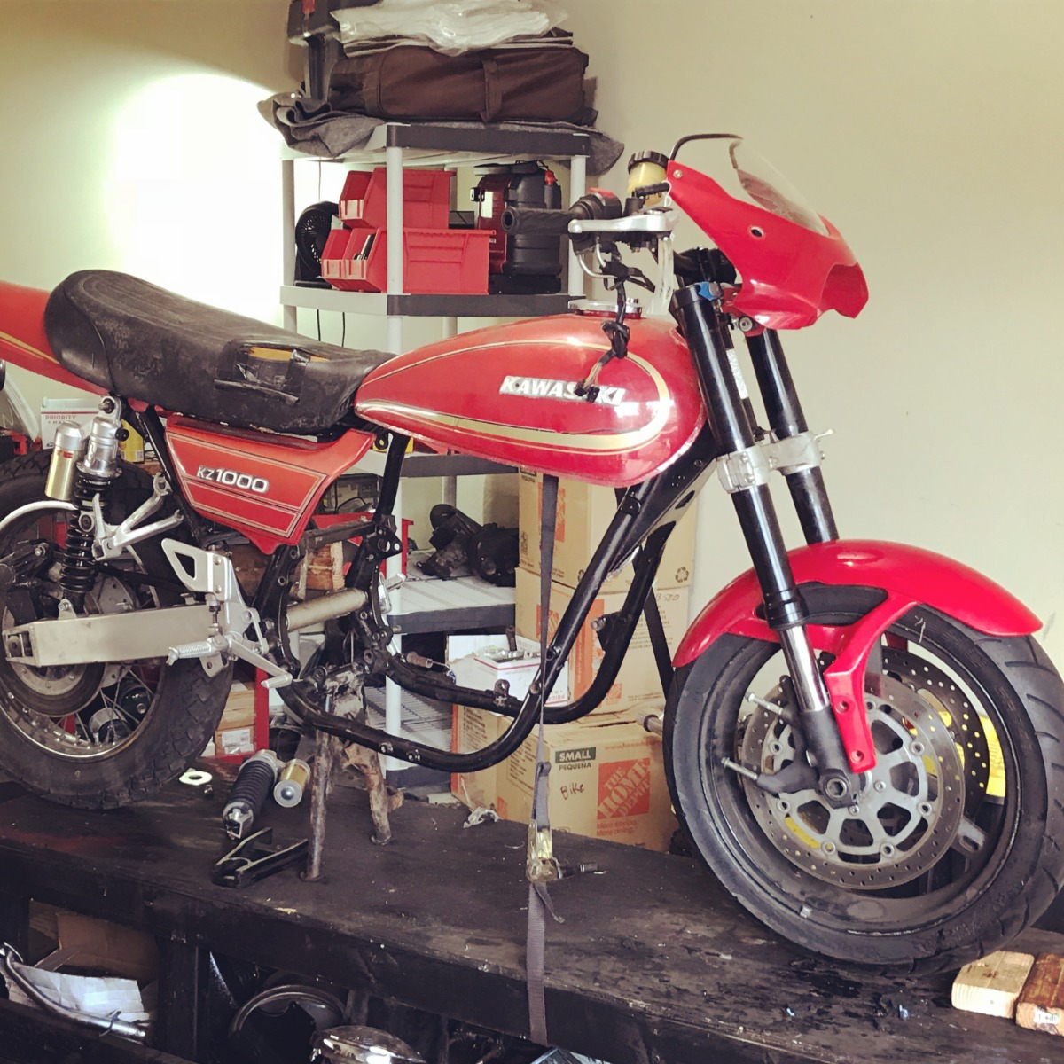

i've done several conversions using the zx6/636/1000 front ends and the main thing is they come up around 3 inches shorter than the kz stuff typically.
fork extenders and gullwing style dropped upper triples are a couple of the ways to go about getting some more length out of them.
hth,
here's a shot of my 80 Z1R with a r1 front end and my own dropped triple setup.

Thanks. I bought the canister before I painted the bike, and it was already that color.
