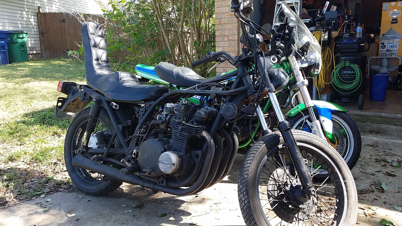

06 Dec 2018 11:39 - 06 Dec 2018 11:41TexasKZ900 wrote: My son wants to do more of a cafe type look, but with modern suspension. The tail of the frame is bent so we have to rework it anyway. We hope to keep a good project log with lots of pictures for KZRider.
Since this is a new project log for our build, it seems only far for everybody to see what we are starting with.... Please keep laughter to a minimum. :laugh: :laugh: :laugh:
