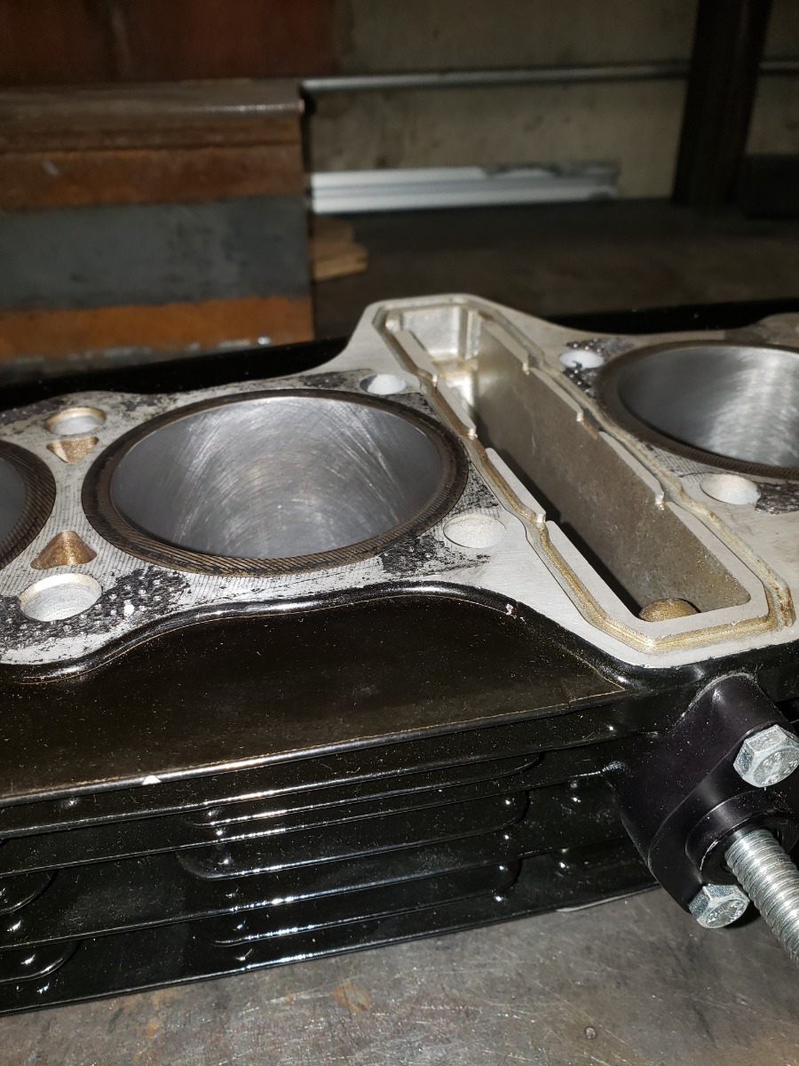

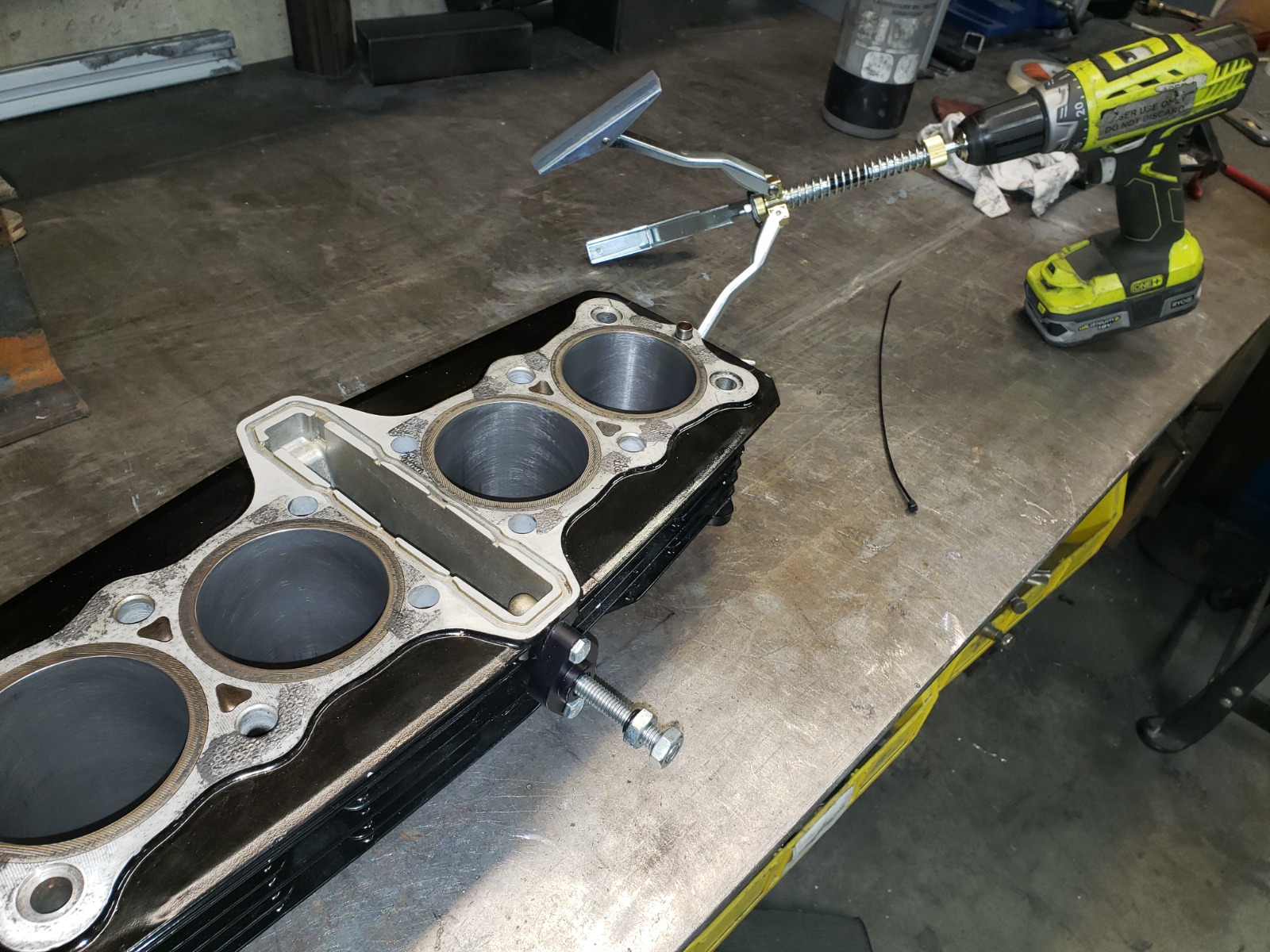

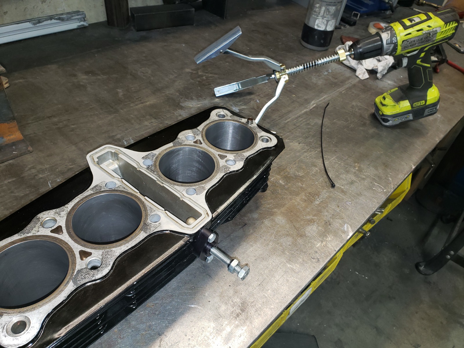

Well I picked up a honing tool and put a fresh crosshatch in my cylinders. Definitely took the uglyiness out of the two that were having piston slap, though after I was done I took my bore gauge to it and it does have a slight oval at the top of the cylinders. largest difference is .05mm at the top measurement. Now thats right at what the FSM calls out for a service limit on a stock bore, but in their requirements for a fresh bore they call out a maximum variance of .01mm. What do you think? Have I trashed those two sleeves?

If it was mine I'd bite the bullet and get the next size up piston kit and have the cylinders bored and honed to the next size. You can run what you got but it's not going to last.

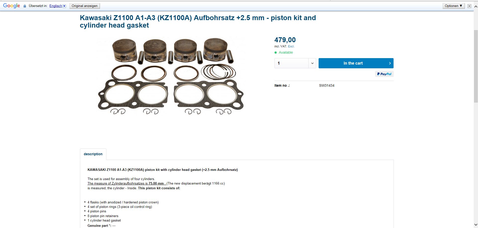

Here you can get a 1166 cc Piston kit for 500 Dollar if you don´t want to give your arms and legs away.
www.scheuerlein-motorentechnik.de/motorr...zylinderkopfdichtung

I appreciate the example Scirocco but I'd really prefer to go with a well known and trusted piston maker (not saying those wouldn't work just fine), plus I'd be losing my higher compression with that set. It is an option if it comes down to it. Also can't very the size of the valve reliefs (they look about stock size) so I'd probably have to fly cut those later for the OS valves and higher lift cam that'll be going in which would mean taking the jugs off AGAIN when I get that. :sick:
I'll check them out though.
