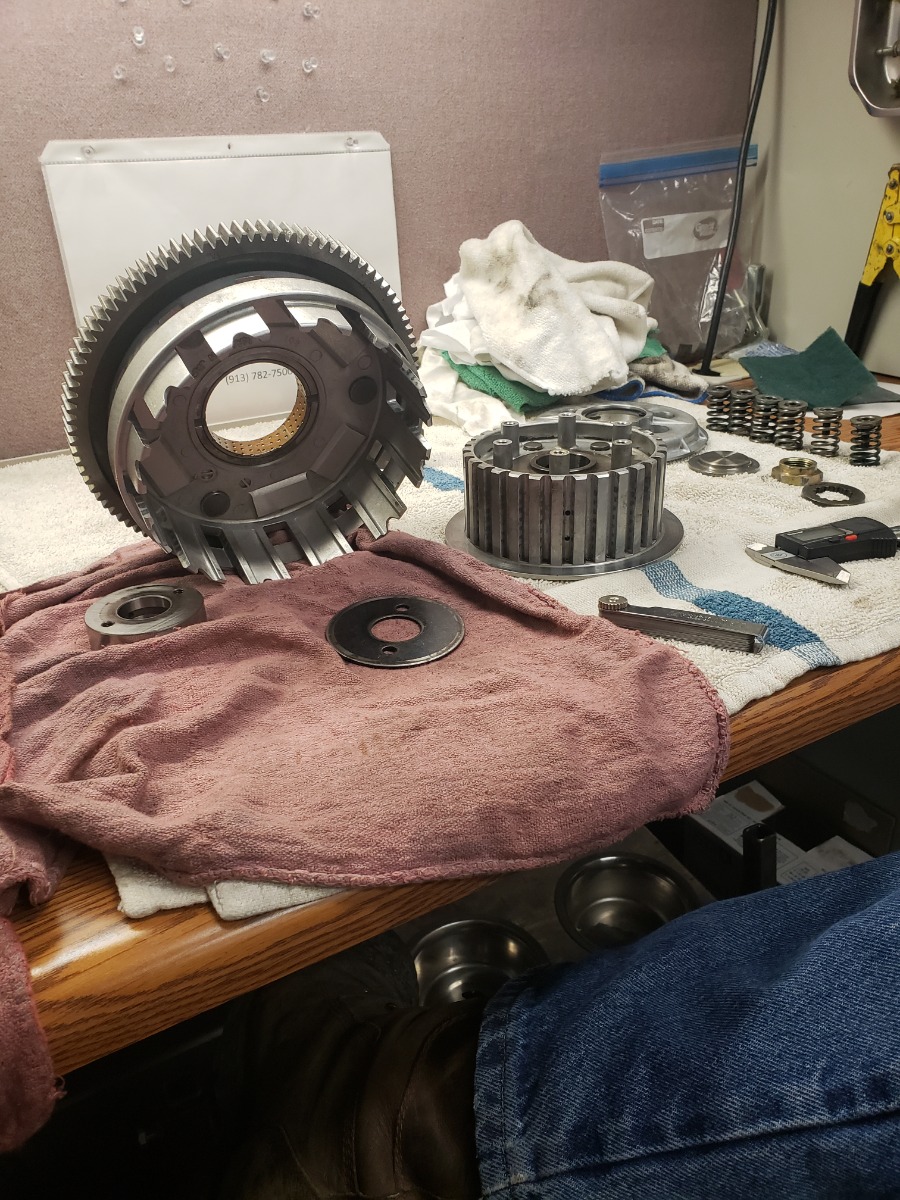

Well the looked fine. I don't have a way to measure the spring tension per FSM and the bike only has a total of 14.5k on it so I assumed (I know bad move) they'd be ok, the whole assembly showed almost no signs of wear and all measurements and clearances checked out.
Got stuck helping a buddy change his brakes he muffed up last night, but Ill pull the whole clutch basket this evening and go over everything, its been over a year since I had it out, might as well replace the springs while I'm there (like I should have done in the first place).

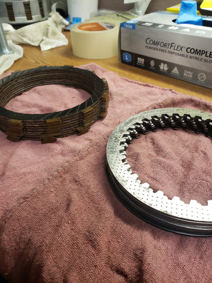

Well I pulled and checked out the clutch basket assembly and plates. Everything checks out great. friction plates are at about half life. I'll go ahead and order clutch springs since I have no way to test the tension on the ones I have. Tonight I'll deglaze my steel plates and drop the oil pan and see if I can figure more out. In summary I don't believe my clutch is the issue.

I was referring to the clutch basket springs NOT the clutch or clutch springs. Ive had the clutch basket springs actually break and come apart then bugger up the tranny gears. They make a terrible noise when they do. Not saying that is your problem but just something else to look for.
