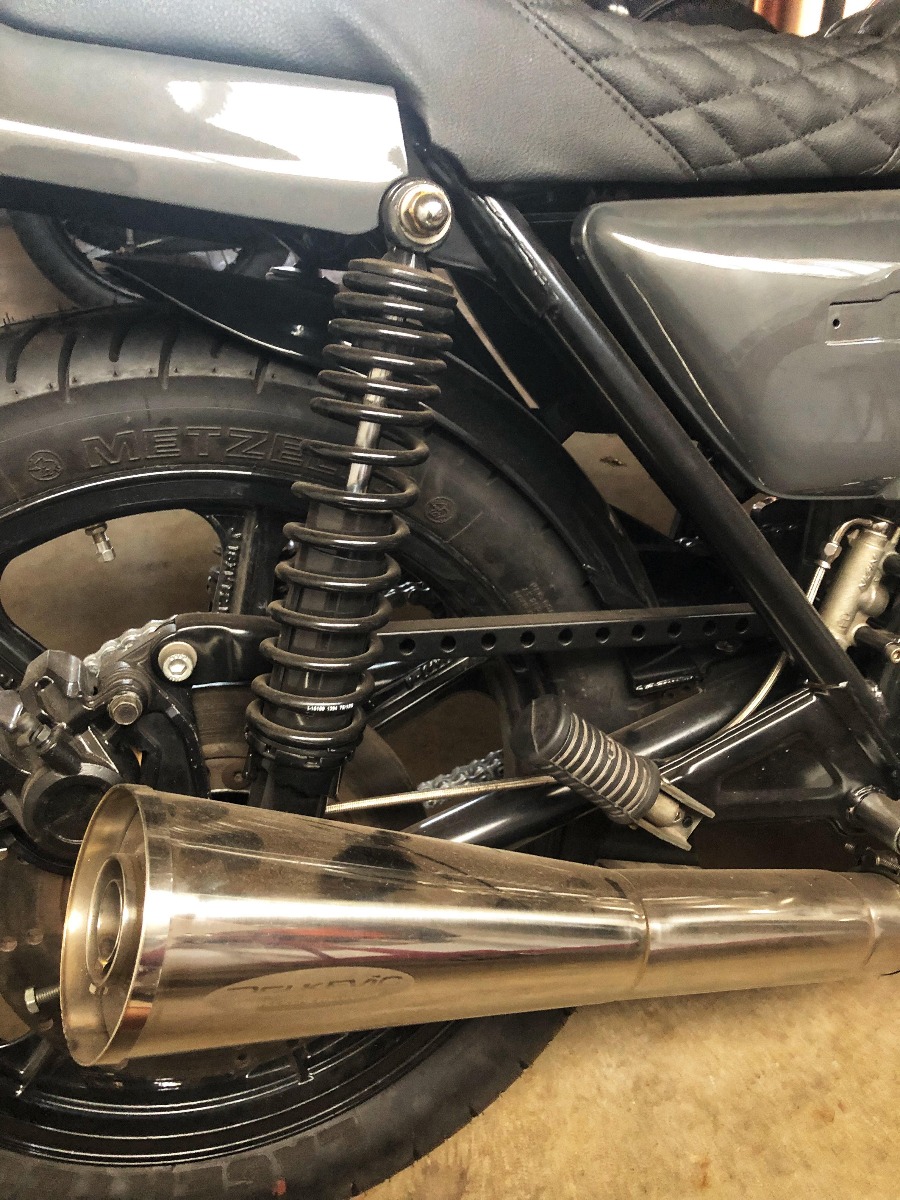

The subframe was modified to support a shortened tail section and brake light / license plate
Wheels were a junkyard find from an 80s-era 750
Progressive shocks from Dime City Cycle
We designed a new seat pan using card stock then water jet it out of aluminum.
A new seat was sculpted from Sargent Cycle Products foam.
We fitted a stainless exhaust from Delkevic and Dyna S ignition.

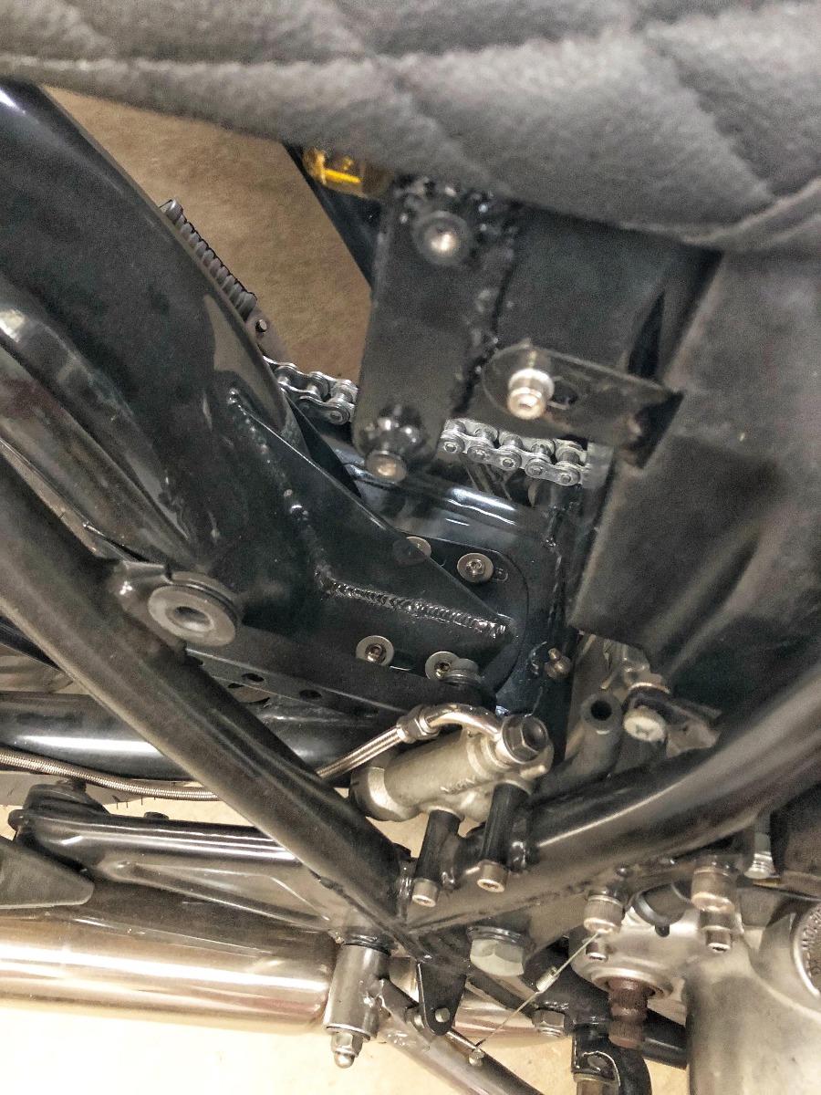

I had a pair of SV650 calipers kicking around from a past build and figured we could make them work with the later model KZ forks and wheel
I designed up a little adapter and some awesome guys at work donated a lunch break to get them machined.

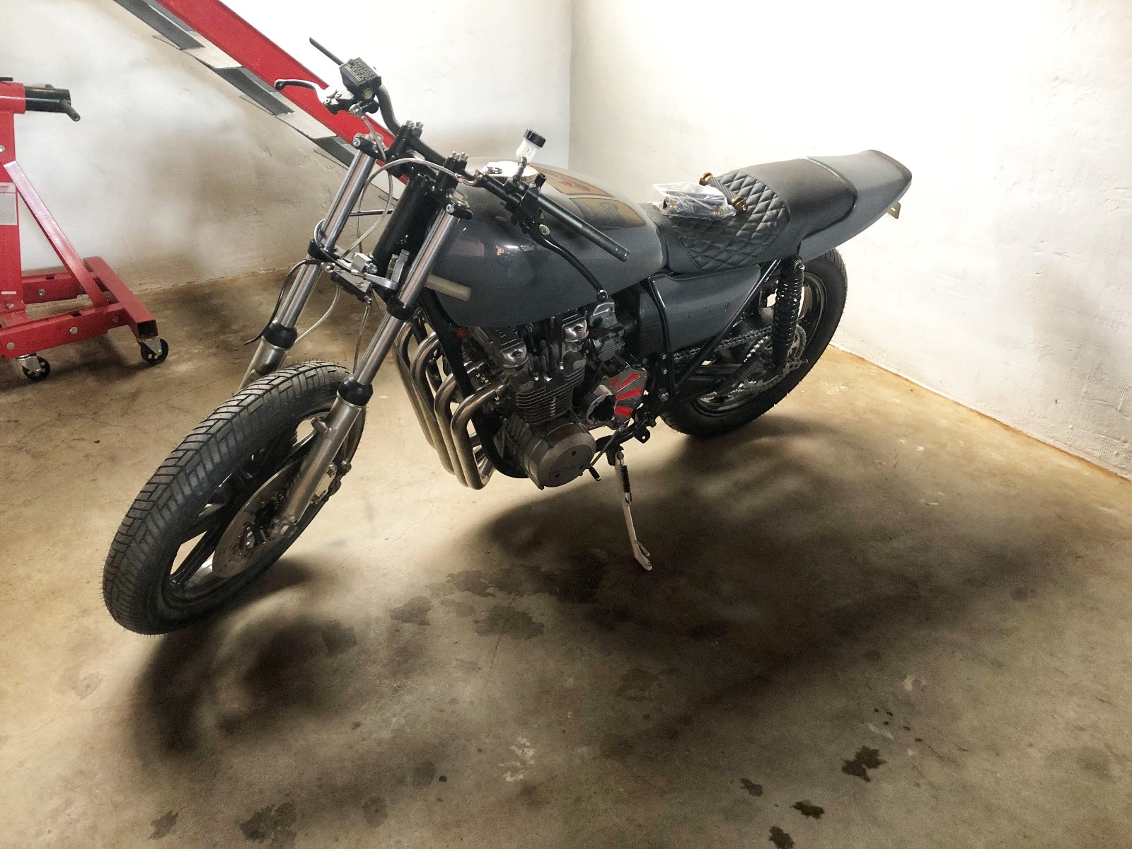

Most of the parts are back from the paint shop.
Still waiting on the headlight bucket and front fender

The inner fender was removed when the frame was modified, but I'm a fan of fenders and keeping the motor clean!
I have a new front fender from Airtech Streamlining, so the factory steel front fender was laying in the parts bin...
After some cutting, welding, and powdercoating, we have a tidy little hugger that mounts to the swing arm
