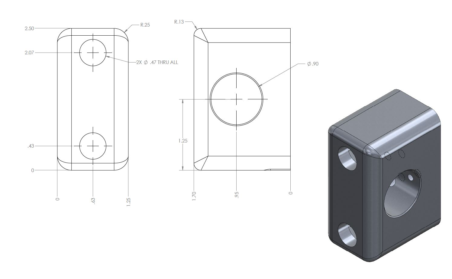

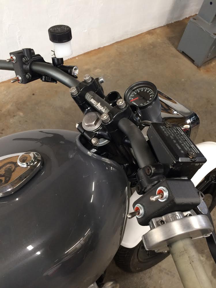

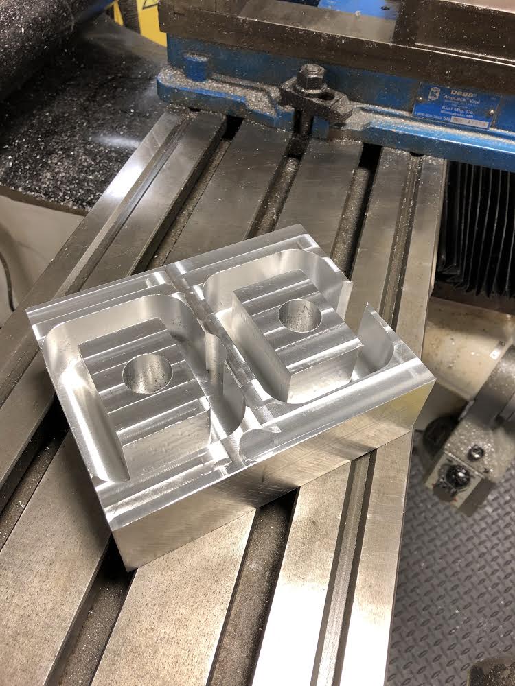

I didn't have a set of decent switches for the bike and the wiring harness had pretty much been destroyed by the previous owner. Now I'm working on a pretty minimalist setup with horn, headlight, tach, and kill switch. I drew up a switch pod that could house a set of beefy Honeywell toggle switches (apparently the same stuff used in 747 airplanes) and 3d printed a set to test fit.
It's not the most stylish item, but it's functional.
Using this as a learning opportunity - first time programming and running the CNC start to finish
- Togoster
- Posts: 374
- Thanks: 17
Re: '77 KZ650 Basket Case Full Build
26 Aug 2018 21:21
Toggle switches? Seriously?
You are really talented. Set your sights on motogadget.
They need some competition, maybe sell it to the Chinese to bring the cost down.
