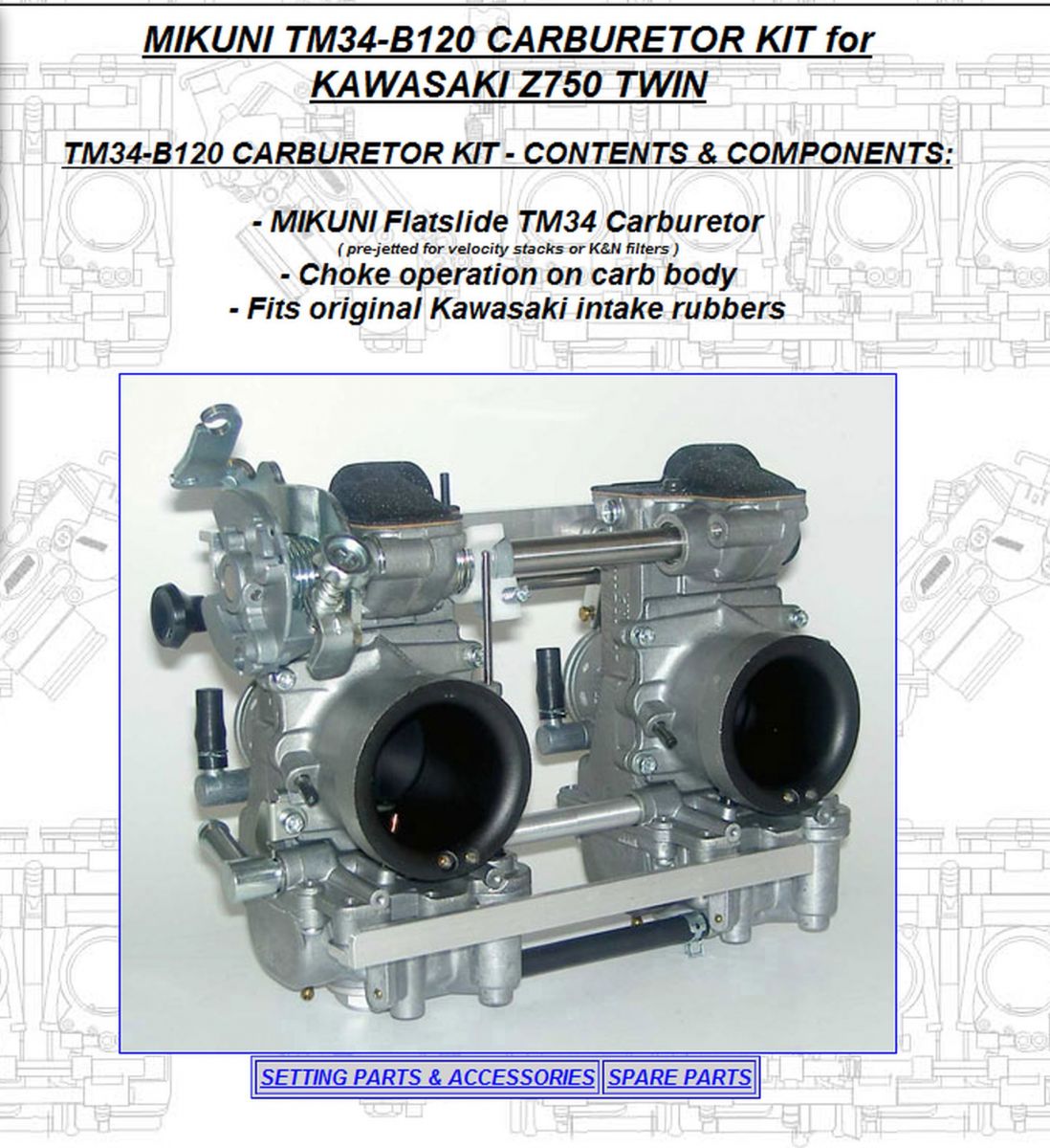

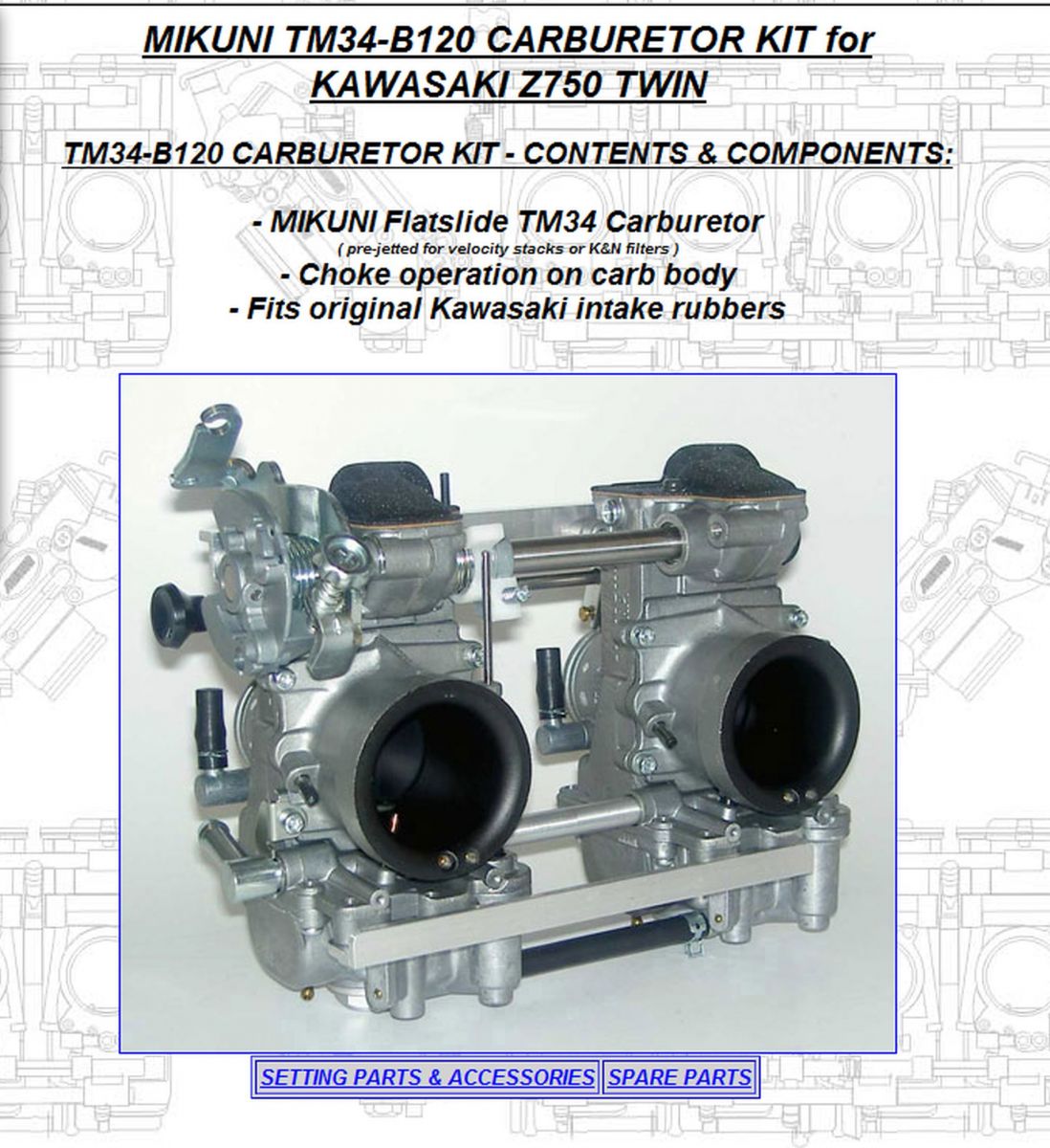

There is only one company making bolt on carbs for the twin. I forget the name at the moment but they're a Mikuni dealer out of Germany. IIRC they're VM 34 carbs but they are super exapensive because they are a legit rack with throttle/choke linkage. The other carbs I have seen people using are the individual vm34 carbs which are much cheaper. For some reason if you search "vm34" flat slide snowmobile carbs also pop up so make sure you get the round slide. They will require custom intake boots. Probably the easiest route is to get a set of the cv34 carbs and boots that came on the 82 and up bikes. Or if you wanna keep it funky run the original carbs.

The Mikuni dealer out of Germany is called Topham = www.mikuni-topham.de
www.mikuni-topham.de/ENGLISHSITE/Carbure...4-B120_Z750Twin.html
