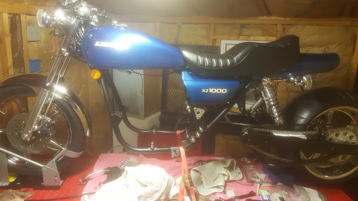

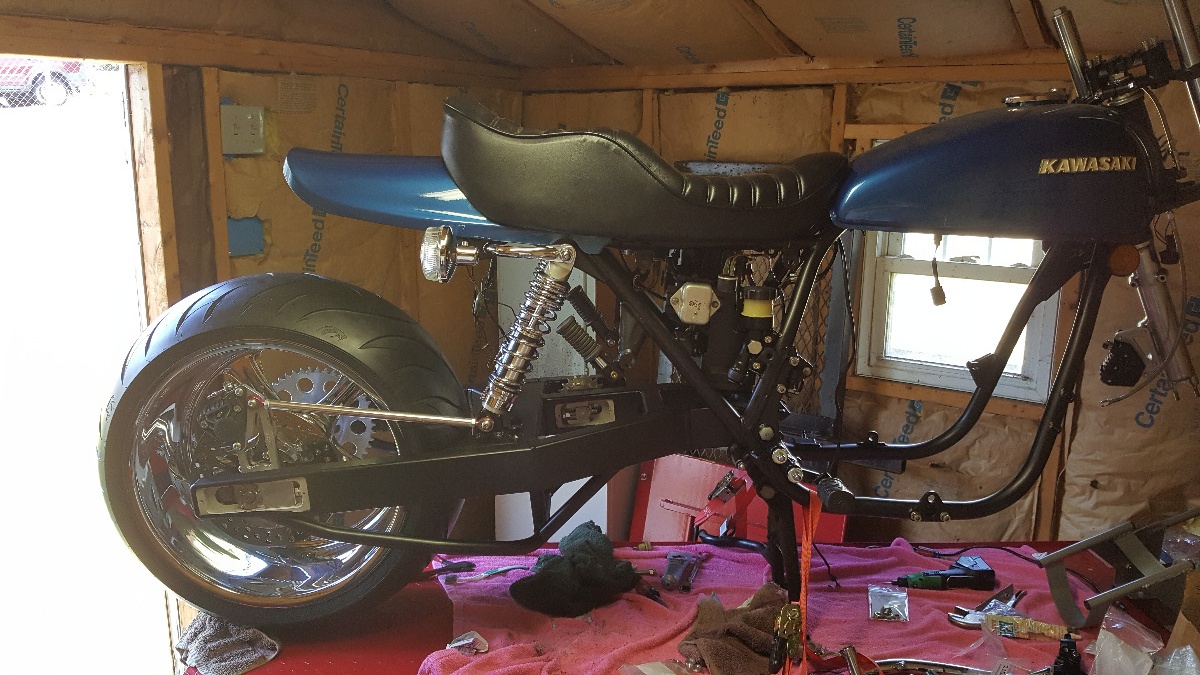

Well, Im finally getting it assembled. Frame, swingarm, and all of the small parts were stripped and powder coated satin black. Im doing every bolt and nut new. Im using mostly stainless hardware. As you see, It is stretched out 13" from stock. Myrtle West jackshaft swingarm from a GSXR 1000. It has air in arm for my air shifter. I had brackets welded to the arm to keep the twin shock setup instead of a mono shock. Made caliper stay from aluminum as alot of other things have been lightened to accommodate the added weight of the arm, 10.5" rim and 300 tire. 5 spoke front early GPZ305 rim sent to Pauls Chrome to be chromed and looks almost identical to the Rear Weld Racing rim. Gonna get started on the motor next. Have to get with my motor buddy for some help on that. So, what do ya guys think so far?

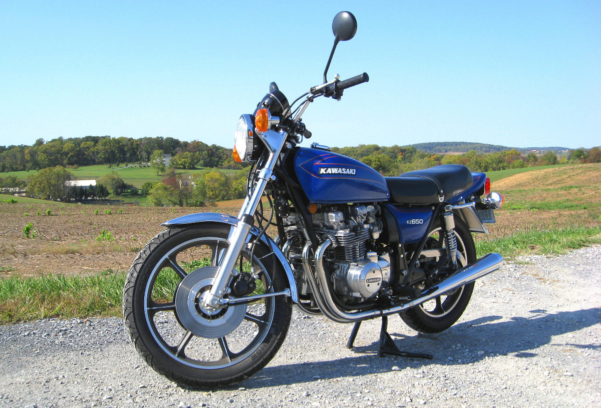

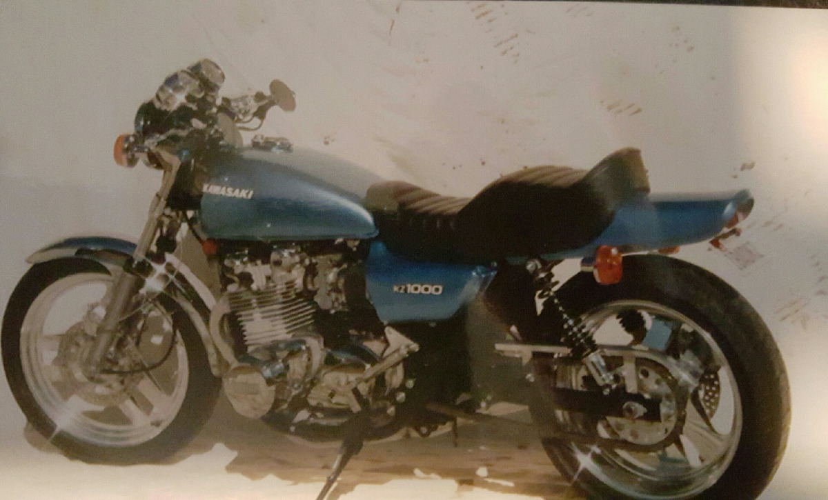

I hear ya Ed. This is the one I had and raced in 1998. ran 10.90 blowing the rear tire off of it.

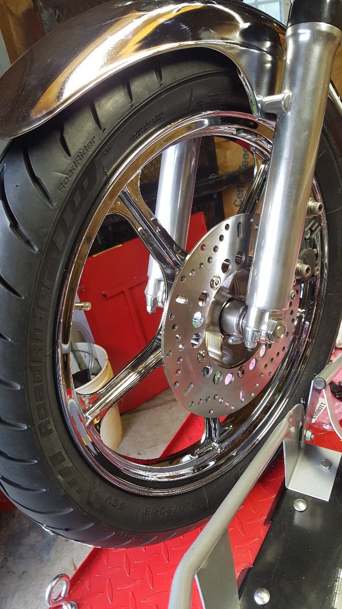

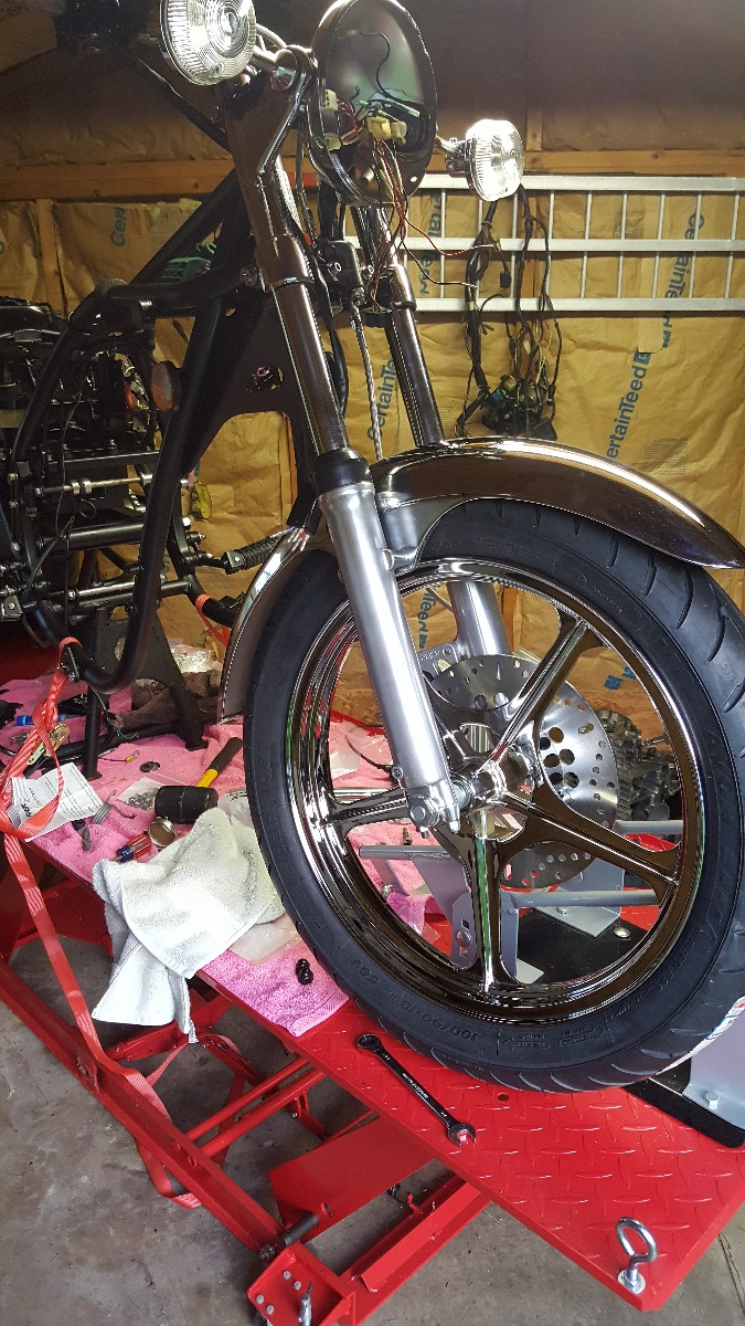

Got my front wheel on the bike today. It's a front wheel from an 84 GPZ305. I found a new EBC stainless rotor in United Kingdom. I sent the wheel to Paul's Chrome in Evans City, Pa. They do incredible work. The rim actually had a rough finish on the spokes. The smoothed that all out and did triple show finish, and removed the Kawasaki lettering and the OEM logos in the castings you can see.

pretty much rolling chassis is done. a little wiring yet but bracket for air shifter components is under the seat and handlebars drilled and wires inside of them.
