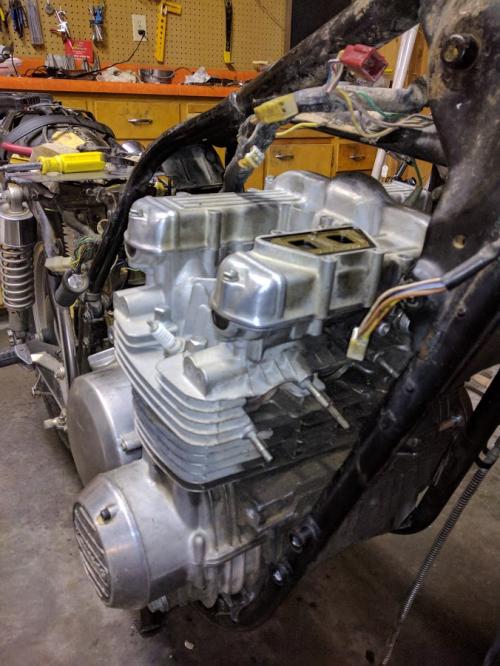

Managed to get the engine in the frame with the valve cover on! It has to be done in a very particular way and unfortunately the valve cover probably wont slide out underneath the main hoop with the engine in the frame. I'll have to check again.
I got the rear upper mounts sorted. Just reused the stock mounting plates with new holes drilled. Ill need to go back and weld the old ones shut. The stock left side spacer bushing can be reused on the top mount which was super handy for verifying my sprocket alignment.
I also found that moving the engine forward a bit and rotating it backwards makes it sit quite a bit better,
Lastly, I got these carb spacers drawn up in SolidWorks (the 550 carbs have a different spacing). The plan is to get them 3d printed and then soak them in epoxy to make them air tight. The goal here is cheap so no 300+ carbs for me!

So, you will have to remove the engine to check valve clearance?
I am not sure about epoxy on the carb holders. The rubber needs to be soft in order to seal against the head and around the carbs.

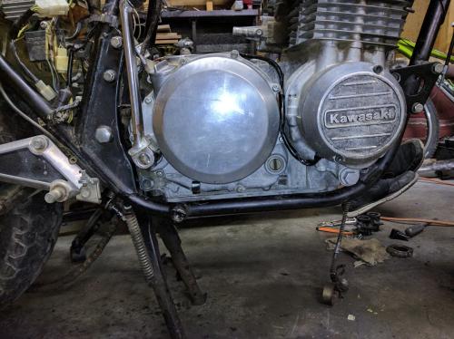

left side of the engine
Attachment not found
Right side.
Carbs mounted. 550 carbs on 650 so the goal here is to turn in the idle screws and just get it running.
Heres a quick overview of the mounts:
Upper front right: reused old mounting plate with new hole drilled. had to space it out a bit due to the wider engine.
Upper front left: cut old mount, drilled frame, welded in new bushings, and made new bracket.
Upper rear mounts: drilled new holes in previous brackets.
Lower front: cut out and trim, reweld in proper place.
Lower rear left: cut off tab, trim tab to fit, reweld
Lower rear right: cut off tab. made removable plate mount with spacer.
I started by trimming the inner sides of the front lower mounts so the engine would sit center. The rear upper left mount can be used with the old 550 spacer to align the rear of the motor. this lines the chain up perfectly as well.

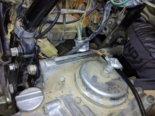

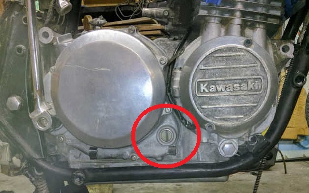

There was some goofy stuff going on with the oil light (I know i had pressure because it was coming out of the clutch rod hole) but that turned out to be atleast partly a missing ground. I say partly because i couldnt get any reading from the sensor with a multi meter. The 650 sensor was closed (~1ohm of resistance) with no pressure and open (Megaohms +++) with pressure like i expect a oil pressure switch to act. However the 550 switch has no resistance measurement at any state. Is this normal? do the 550 switches work differently or is the 550 switch bad?
Next thing to deal with is the clutch rod. The 550 has a 8.05mm bushing with a 7.95mm rod. The 650 has a 7.05 bushing with what i'm guessing should be a 6.95mm rod (as i don't have this clutch rod). I don't know if the clutch rod bushing (which is visible with the gear plate taken off) is removable without splitting the case. If it is, i can swap that to the 650 and use the stock 550 rod. Otherwise i can just throw the 550 rod in a lathe. Also, since the 550 transmission can go in the 650, the rod lengths should be the same....?
Thoughts on these oil and clutch rod situations?
