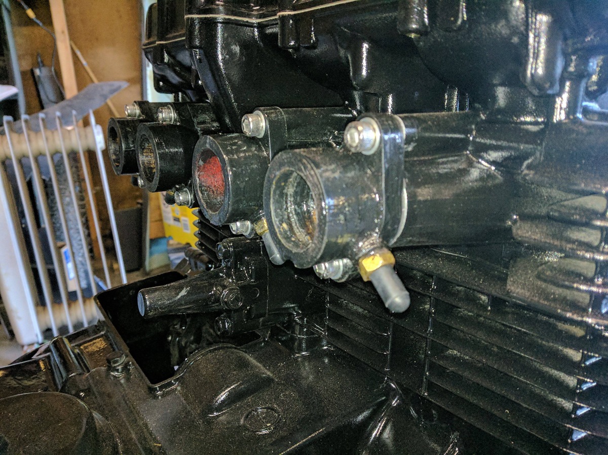

Still been making progress. Made a paint booth in the garage and kept it warm with an electric heater while painting and a kerosene heater in between sessions. I decided on a black with red accents design like the W800 black edition. I used regular rusotleum (the quart cans) and laid it down with a harbor freight HVLP. The actual painting went great but the issue is the dang oil based paint. The only way to dry it is to wait a year or bake it in an oven which is obviously not possible for larger stuff. Paint was peeling off under bolt heads during assembly and some paint would come off just from routing the wiring through. I sanded it well and cleaned it before paint so i've learned my lesson. Next time will be 2k epoxy primer (i have two gal of the stuff for undercoating a Saab 95 which i should've used here) and single stage black. Super frustrating after all the time i put into it.
Tank before basecoat. Don't worry i fixed the runs! The tank did turn out nice in the end so ill bake it and hope it stays that way.
Here she is about a week ago, since then i've put the all the wiring and accessories on the bike.
Also checked the valve lash. Before (Yikes!):
After. The kz550 was happy to donate all the shims i needed. neat!
Did the timing with no issues thanks to turns out the 79 650 manual is hard to find online.
Today im gonna take the motor to the car wash and get the rest of the motor clean so it can be painted with VHT. I was doing it by hand with aluminum cleaner (acid) and it was jsut too much of a pain to get all the crap in the fins.
Attachment not found

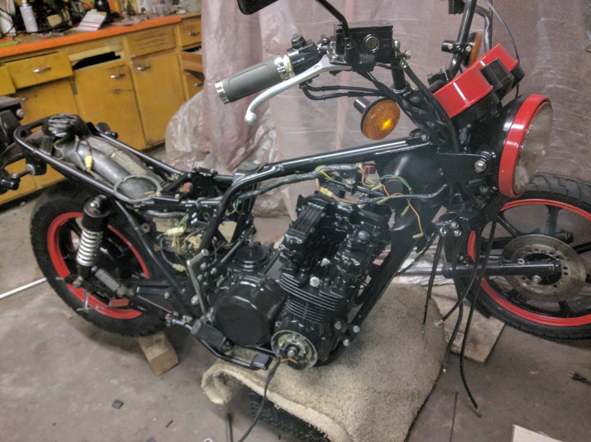

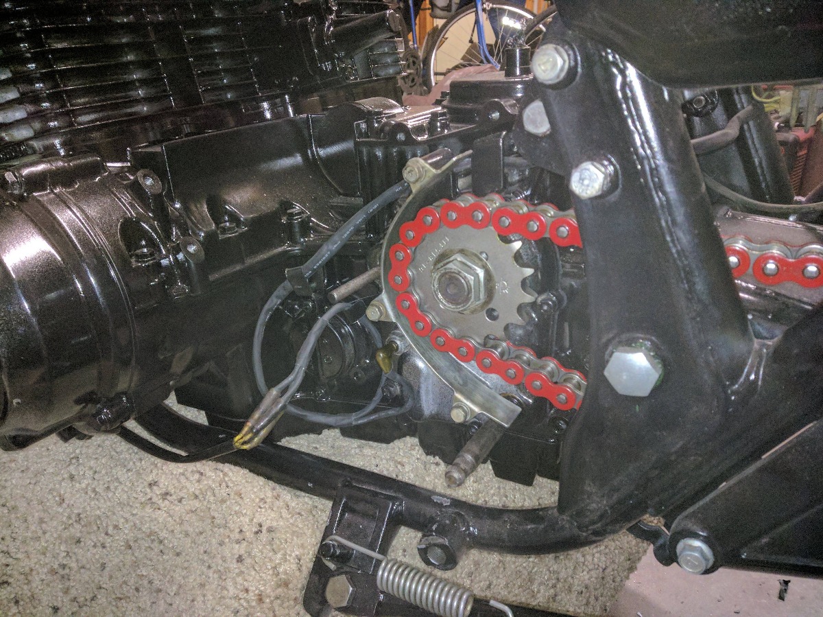

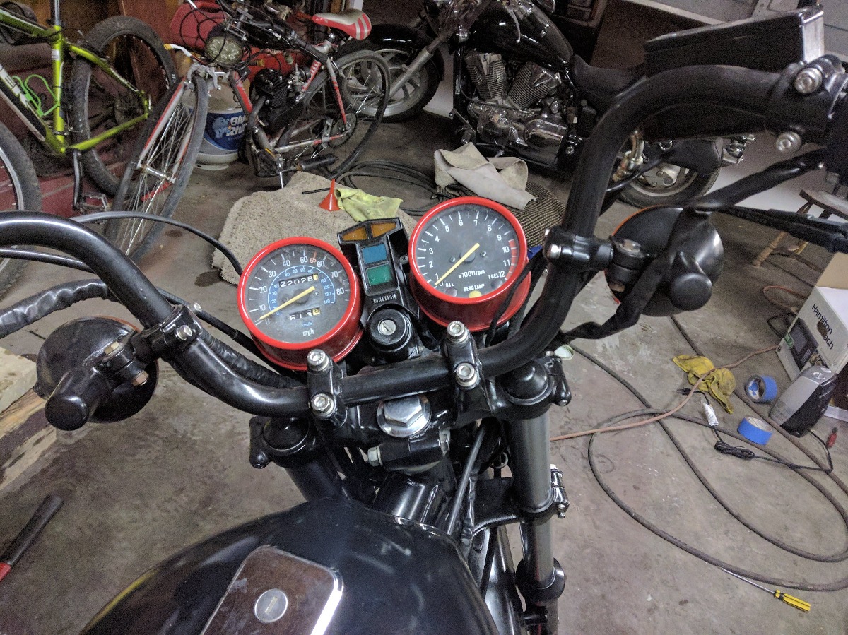

Part 1/2: Time for an update on the assembly of the bike.
First thing to do was get the motor in the frame. The forks should've been put on first, but you know, waiting for parts. I laso got the new tires mounted on the rims...That was fun.
Installed the new chain, They had a red one so why not eh? Had to cut out two links and steal the masterlink from the old chain. This is a stock kz550 ltd replacement chain/sprocket set and will give me a bit higher top speed due to the 650 gearing.
Installed my diy carb boots. These are much sturdier than the first revision so we'll see if they hold up
Cleaned the advancer which was stuck and probably caused some of the weird power loss that I had. I also replaced the phillips with nice allen bolts.
$100 of stainless allen bolts which will replace side cover bolts, turn signal mounts etc.
Bit more assembled
Bit more assembled

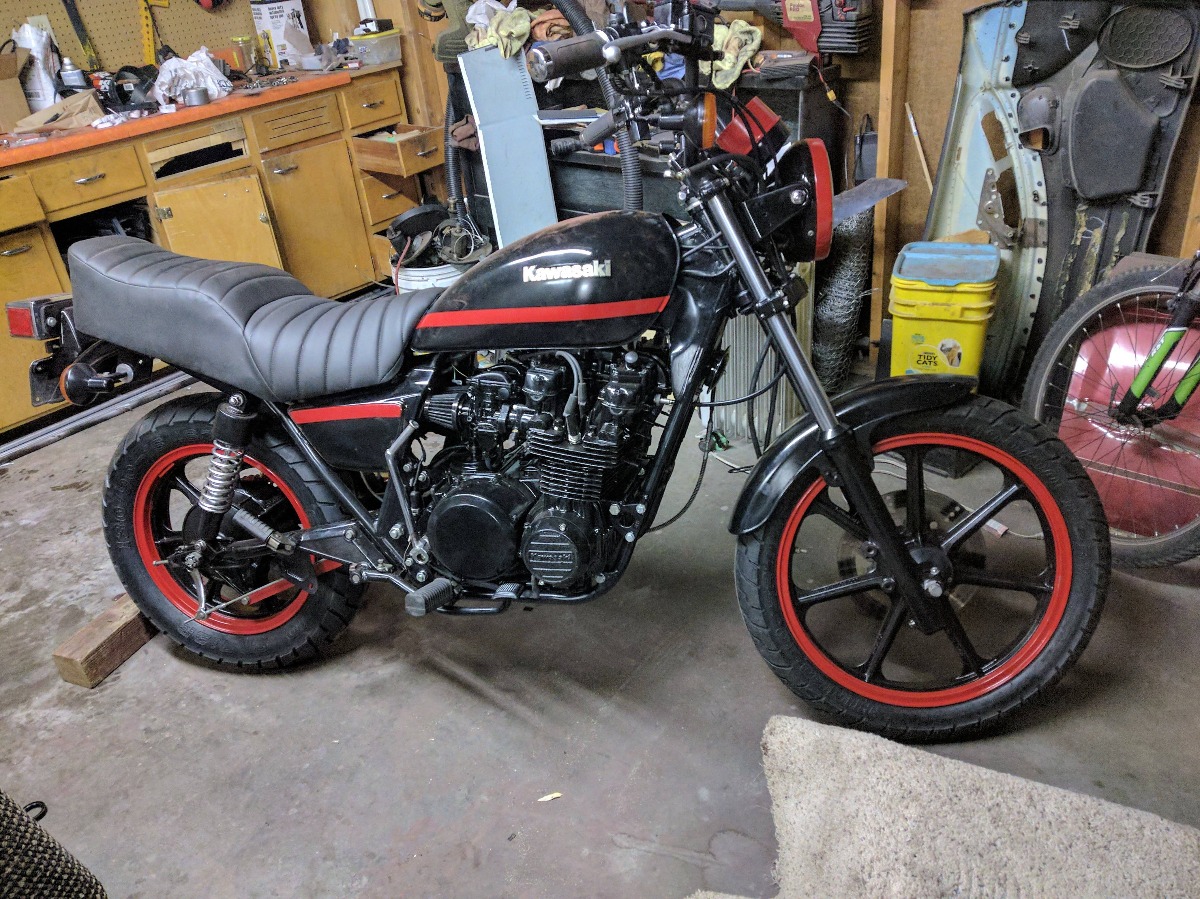

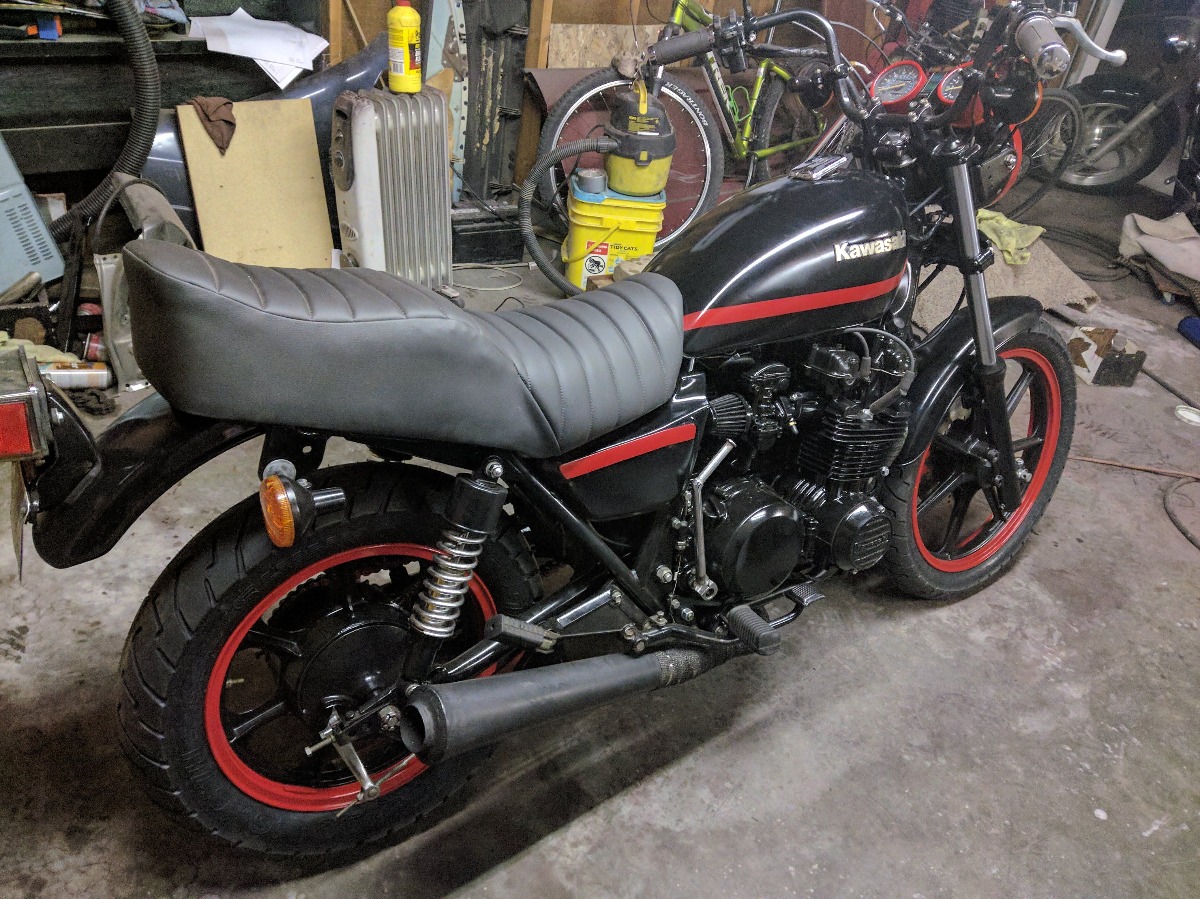

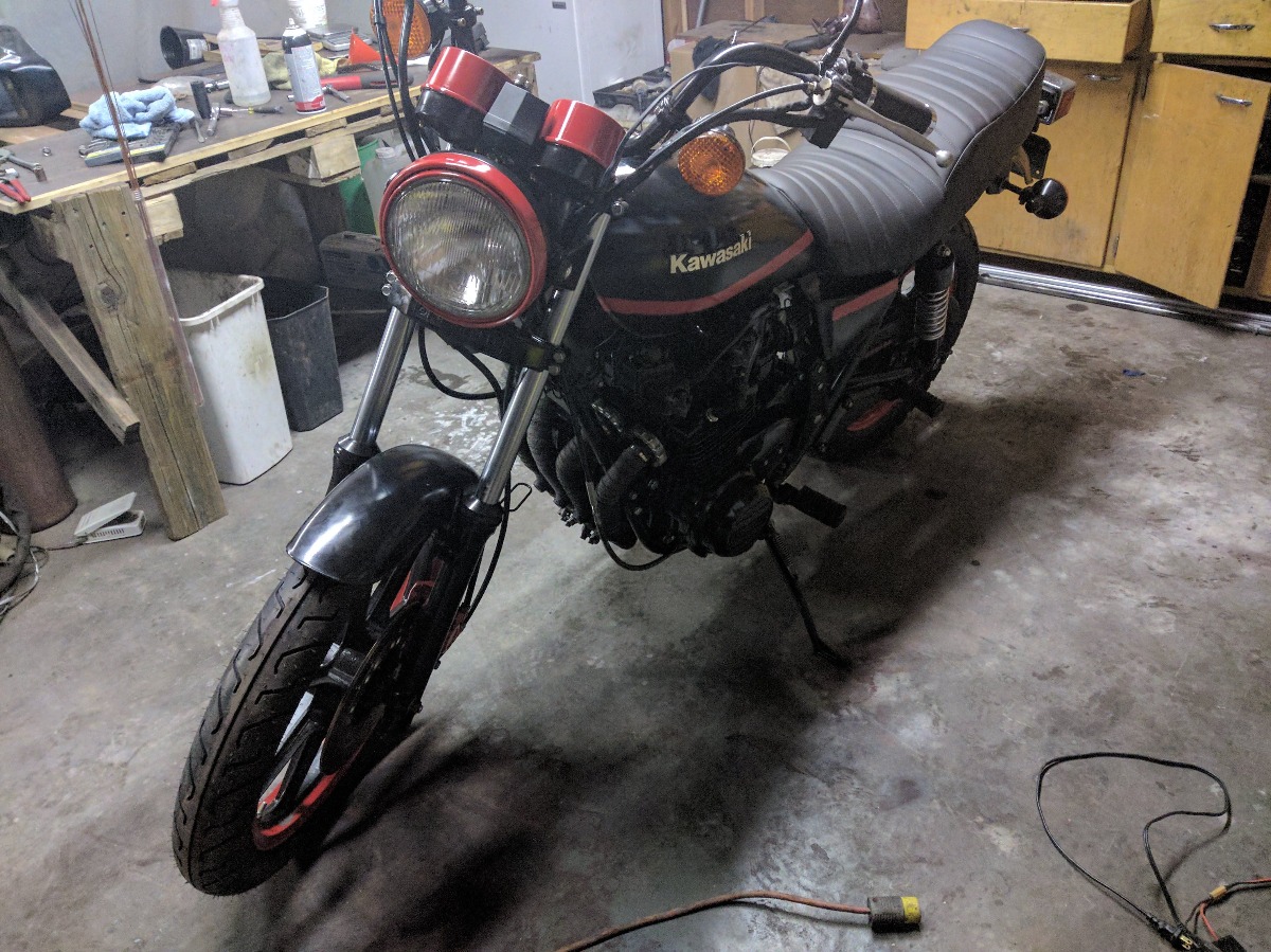

Part 2/2:
Forks installed. It looks fantastic but the LTD seat, ignition cover and alternator cover need some red to tie them in to the color scheme. Tailight needs to go as well. But those can be done later. Paint needs to be touched up, but again, at a later time.
I plan to finish the last few things (clean tank, install exhaust, install front caliper) and start it up today. The bad thing is that i'm already dreaming of the next build! i'm thinking another kz550 frame, newer water cooled 1200 motor, forks/swingarm swap.
Aggghhh this forum. It wouldn't let me post and kept deleting the image links in the post... im guessing there's a picture limit, but it didn't give any errors!
