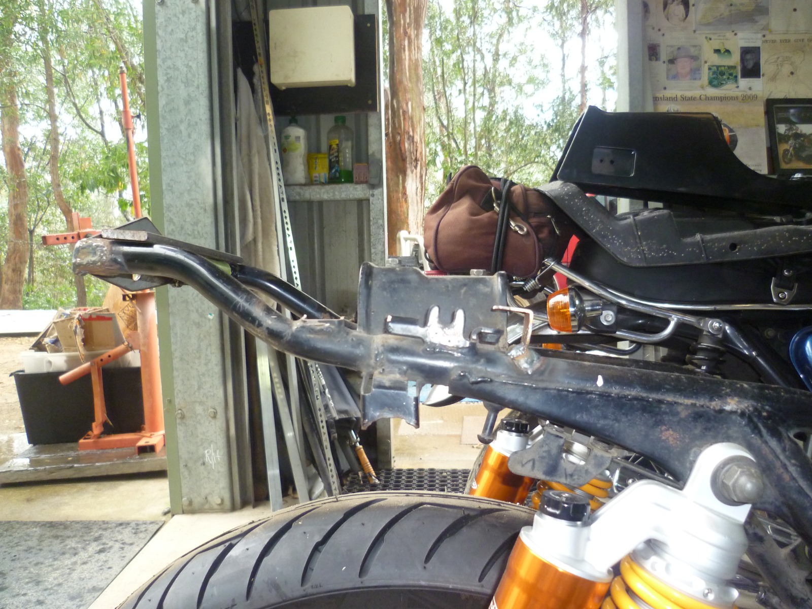

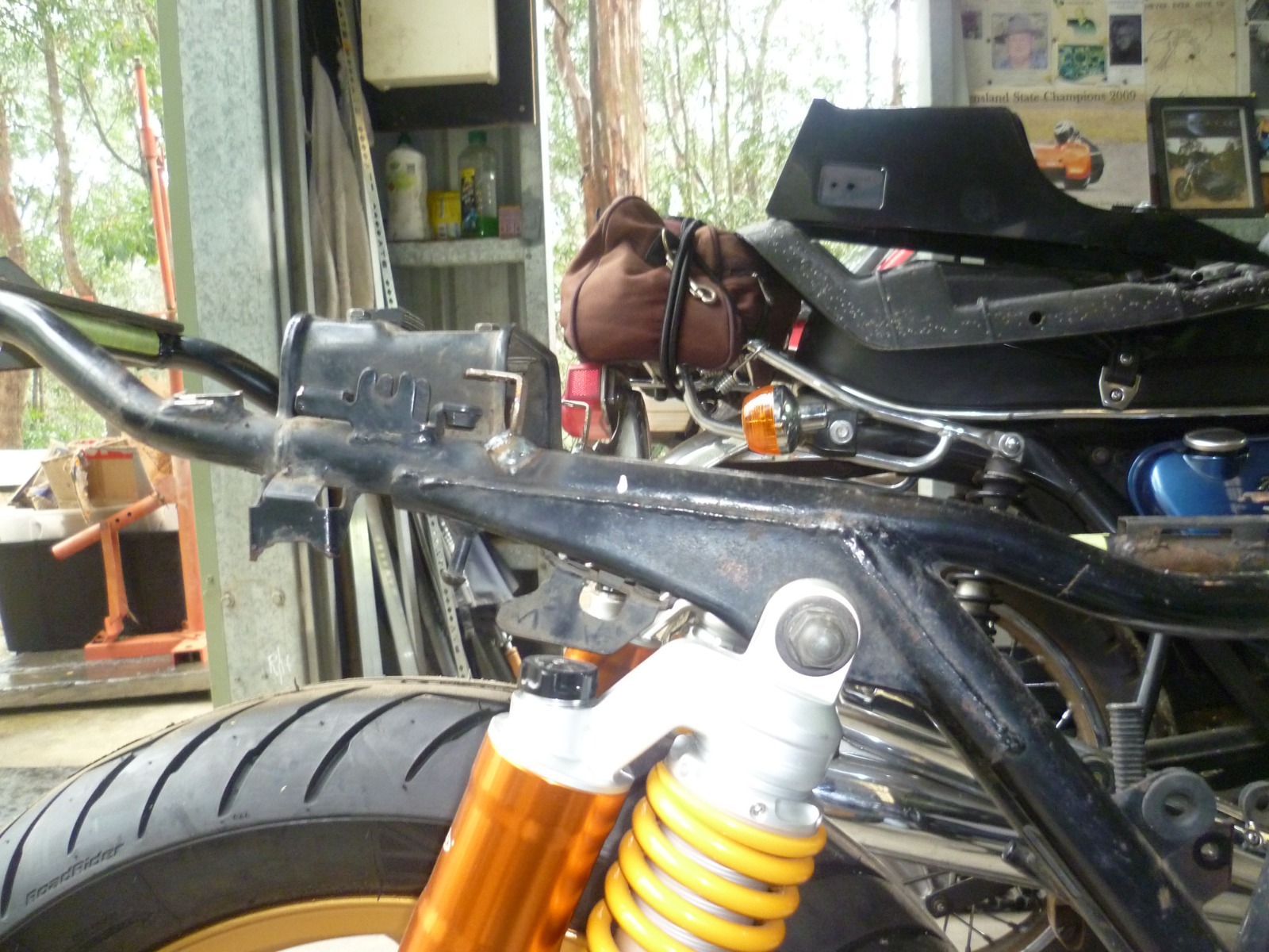

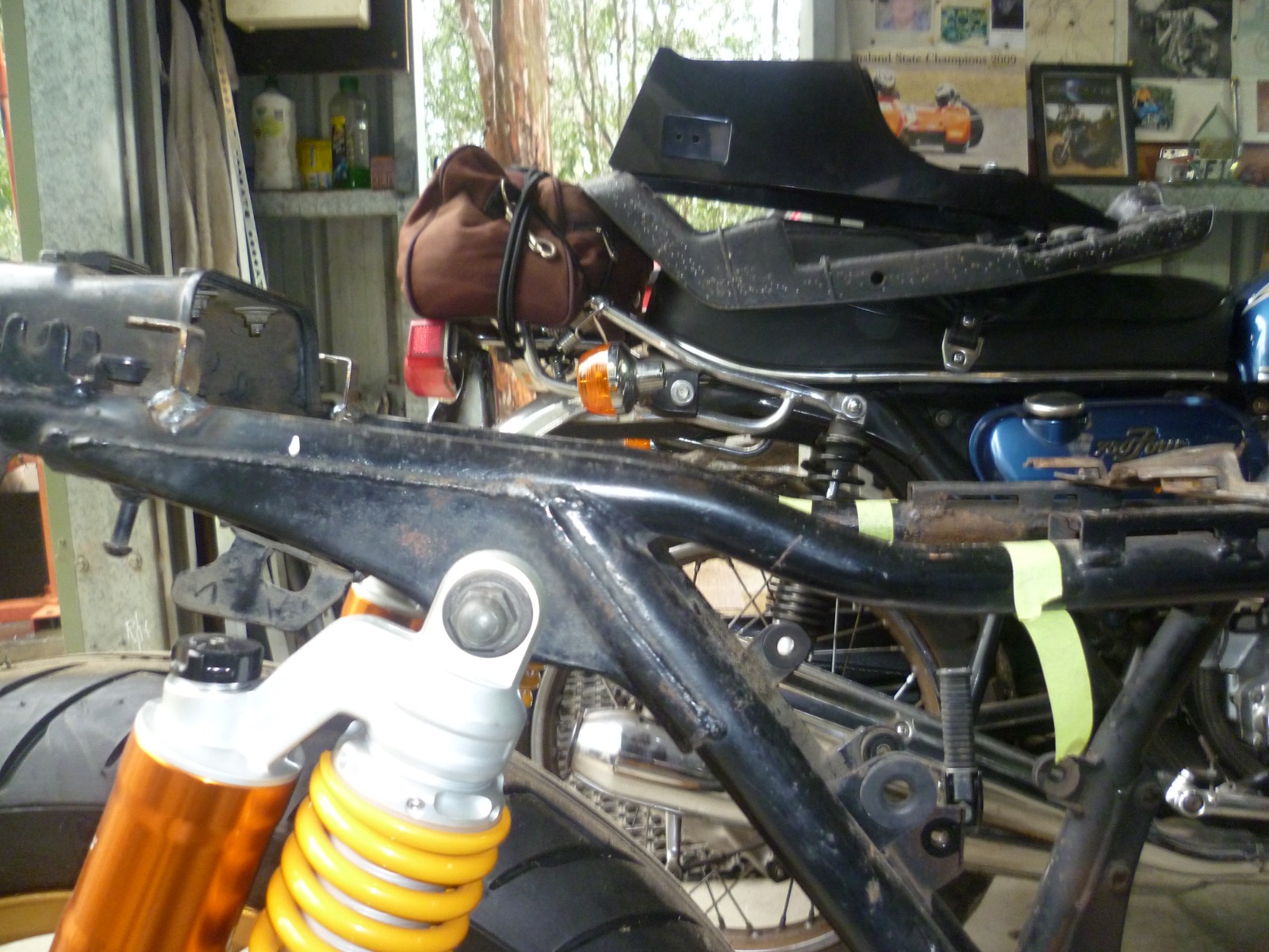

11 Aug 2021 03:32
If you like, I'll take some pics of that section of the frame on my bike, I have modified the very rear of my frame to take a different tail light but the section you are concerned about is all as it should be. Won't be able to do it till Friday {Aus time} , Thursday for you...
